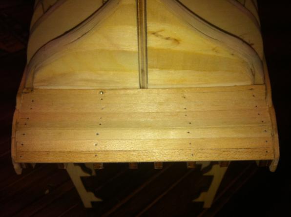

as john says, the rearmost rib needs to be as flat as possible all the way up, from your photos it seems to curve away from the false keel/stern at the top. if you still cannot get 5 planks in don't worry too much you might just have to put 4 full planks and a slightly thinner 5th plank.

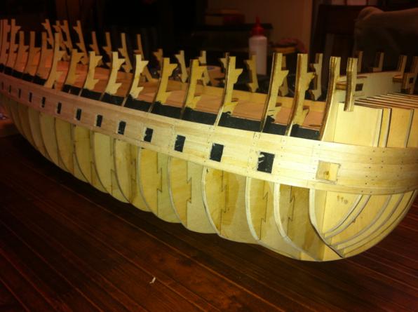

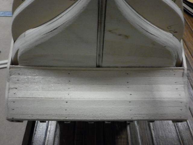

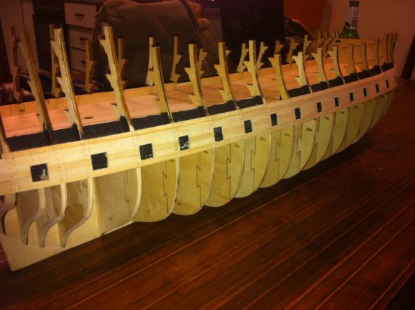

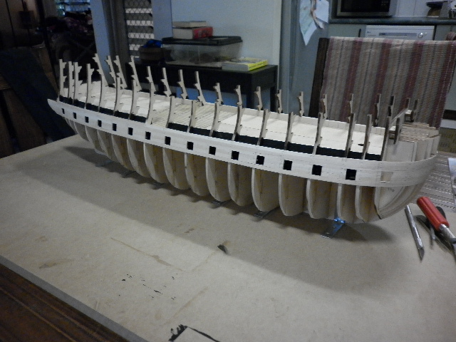

Thanks to all for the info on the gallery planking, I have added a smaller plank and and sanded the stern even more, will post some more pics later, however I need some more expert help from the professionals!
I have now completed one side of cutting out the gun ports but got a bit over zealous whilst whittling away and some of my gunports look slighlty askew IE some are measured out to 13mm or 12.5 mm high.
Is there an easy way of fixing this?

#23 Posted : 20 September 2012 13:12:28
Joined: 30/03/2011
Posts: 1,344
Points: 4,079
Hi Tigershark. You are are going to frame them at a later stage,so you can fill in and adjust then. Hope this helps. Never fear I had to do the same.
Rgds, Hans

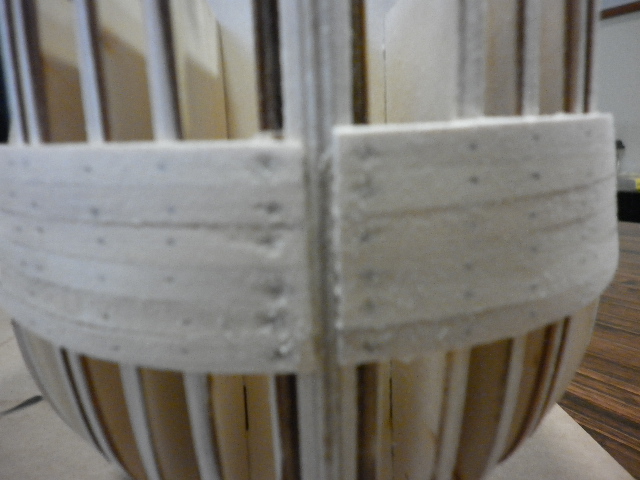

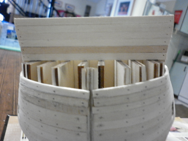

I have now finished cutting the gunports for both sides and just waiting on the postman for my next delivery Bored, hopefully this week sometime.
I am pretty happy how my model has turned out so far! But as always rookies will make mistakes.
I made the mistake of pushing in my very first nail at the centre of the bow all the way in so I decided to do the rest of them. Was not happy with the end result so after a bit of peserverance I managed to dig them out and cut the ends off, this will hopefully look better once final sanding has finished but at the moment the craters are not very flattering.
The only issue I have now is my planking has not turned out as even on both sides, one side is slightly higher than the other,see the bow picture, I will be choosing my planks wisely and look for slightly thicker planks to even this up over the next few issues.
Tigershark attached the following image(s):

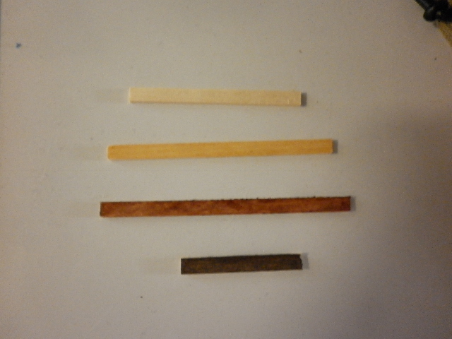

Also started colour testing some different stains and varnish for when the hull is complete.
Top is the Natural colour, then Honey, Aussie Jarrah and Brazilian Roast however this is only the first coat, and it recommends to add three. Having seen Edgar's launch i am now going to try and stain my own launch, however might be a bit ambitious considering it is already built, will hopefully have some pics of the finished product later on.

as far as staining goes looking at the colours you have i would go for the honey colour for aove the waterline, the aussie jarrah below waterline, and the brazilian roast for the wales.
aussie jarrah great for the masts, brazillan roast perfect for the fighting tops.
where the magazine recommends walnut the brazilian roast would be perfect, and the jarrah for any oak staining.
but all thats just my opinion, you go ahead and sort yourself out, i'm sure it will all look great.BigGrin

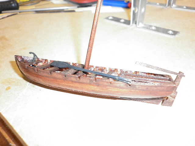

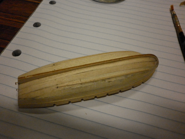

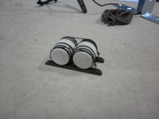

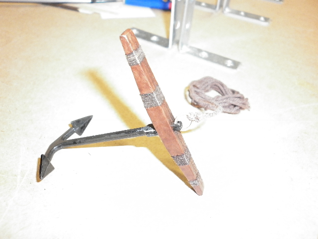

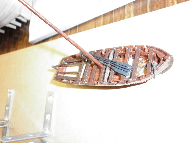

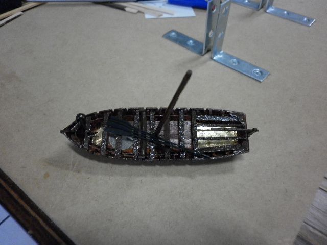

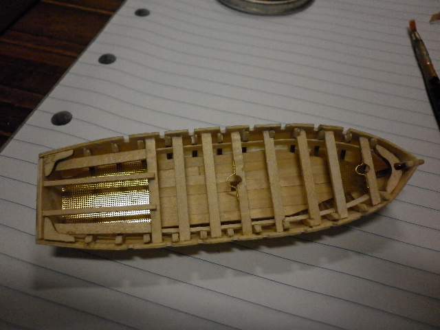

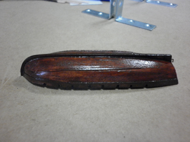

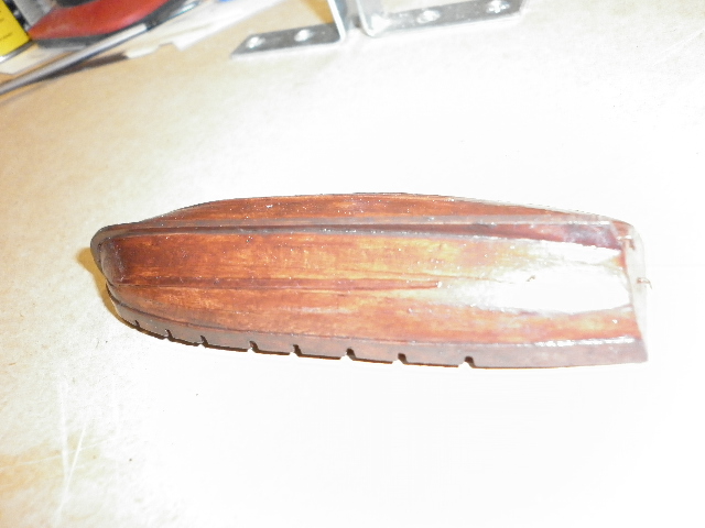

#33 Posted : 28 October 2012 03:19:49
Joined: 09/08/2012
Posts: 59
Points: 163
Location: Darwin
BigGrin Thanks for the kind comments Ian, Mike and Chris.
Thanks for the link Karl but as you can see I went for a woodstain finish so it looks nowhere like the real deal, however I am happy with the finished product as it looks better than the plain version. Would suggest to anyone else who is going for a stained finished to stain the parts before assembly when it comes to fiddly parts like the launch. I went fo a jarrah look and added some brazilian roast to enhance other parts, I have attached some before and after shots as well as some shots with flash so they mat look slightly different. Also took the oppurtunity to stain the anchor and the barrel supports.
Cheers Tony
Current Build
HMS Victory, HMS Victory Cross Section
