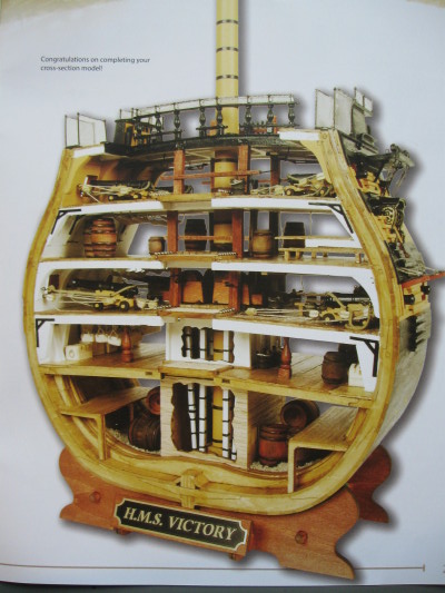

HMS Victory cross-section
This unique 1/72 scale cross-section of Admiral Nelson's flagship show's a slice of life on board the premier warship of the Georgian era, and is based on authoritative drawings and reference photographs of the real HMS Victory, to which special access for this project was granted by the Royal Navy.
The section spans the hold, orlop, three gun decks and cockpit/quarterdeck, and includes accurately modelled rib frames showing how these were built up.
Kit Content:
● Interior and exterior hull planking
● Decking, wooden gratings, companionway ladders & pump well
● Stub mast, chainwales, photo-etched brass grates & hammock cranes
● Die-cast metal chain pumps & elm-tree pumps
● Ship's ballast & die-cast metal Entry port canopies
● Provison barrels, shot lockers & cannonballs
● Four die-cast metal 32-pounder cannon & wooden gun carriages
● Four die-cast metal 12-pounder cannon & wooden gun carriages
● Gunners tools, storage chests & hammock netting
● Hammocks & mess tables
● Wooden buckets & pillars
● Gun rigging threads & tackle
Also includes a display stand and photo-etched brass nameplate.
Overall model dimensions: 325mm high (inc stub mast), 220mm wide, 87.5mm deep.
You can construct the cross-section as a natural wood finish, or finish with woodstain and paint to reflect its period colours (not included).
The pump well has an 'open view' section and you also have the option to depict a 'day or night' crew quarters.
The instructions cover the painted option which the official build diary will follow and day option.

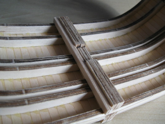

Assembling the keel and keelson - Start by assembling the keel and keelson, parts 10 and 11, supplied this issue.
Separate the two halves of the keel and sand off any marks left where they were joined to the fret. Glue the faces together with a thin coat of PVA glue. Make sure the two parts are perfectly aligned and clamp the halves together.
Glue the two halves of the keelson together in a similar way. Allow the glue to dry thoroughly, then sand the charring (laser ash) off the ends of the keel and keelson, as they will be visible in the finished model. It is not necessary to sand the long edges.
Assembling the framework - Let the keel and keelson dry fully, then use them and the dowel rods supplied to join all the rib frames you have assembled. Use the spacer jigs supplied to ensure that everything is in the correct position.
Glue rib 2 to the keel, which fits on the end closest to the double slots, and the engraved joint lines must face outwards.
Make sure the frame is exactly vertical and also square to the keel and fully seated in the slot. Allow the glue to dry thoroughly before continuing.
Glue rib 3 to the keel. Use the spacer jigs supplied to make sure that the spacing at the top of the frame is correct, and ensure that the holes in both ribs are aligned so that the dowels can pass through them easily later on, and again ensure that the frame is fully seated in its slot.
Add ribs 4 to 8 in the same way. The engraved lines on rib 8 must face outwards.
Glue the keelson over the ribs and on top of the keel. (Don’t worry about the visible part numbers as they will be covered by the "limber plank" later in the build).
Cut a 94mm length of dowel and feed it through the lowest holes. Use a jig to ensure the frames are correctly spaced, and then glue the dowel in position, (apply a drop of superglue to each joint. Capillary action will draw the glue into the joint).
Then repeat on the other side of the model.
Cut two more 94mm lengths of dowel and select parts 3c and 7c. (These two parts are identical.) Push the dowels through the next rows of holes in the frames, slipping parts 3c and 7c into place as you do so. These
parts are positioned directly above the main frames 3 and 7.
Insert two spacer jigs at the top and bottom of the newly added sections of frame to gauge the spacing. Then glue the lower dowel in place. Do not glue the upper dowel just yet.
Repeat on the other side of the model with parts 3d and 7d. Allow the glue to dry completely before continuing.
Cut another 94mm length of dowel and take parts 5c and 6c. Remove the upper dowel that you left unglued earlier. Then replace it, sliding on parts 5c and 6c in the appropriate places over ribs 5 and 6. Now insert the new dowel in the next hole up. Gauge the spaces with the jigs and then glue the lower dowel in place. Do not glue the upper dowel yet.
Repeat on the other side of the model with parts 5d and 6d, and allow the glue to dry thoroughly before continuing.
Take parts 3e, 4c and 7e. Take care to get 3e the right way round, so it slopes the same way as the others. You will also need another 94mm length of dowel, then fit the dowels through the three frame parts as shown. Use a jig to make sure the spacing is correct, then glue both dowels in place.
Repeat on the other side of the model and allow the glue to dry thoroughly.
Carefully sand the projecting ends of the dowels flush with the faces of ribs 2 and 8 to complete the framework.
Don't discard what remains of the fret, as it will make a useful temporary brace when you attach the planking in the next stage. Roughly cut one end of the fret as shown, and glue a scrap of wood across the gap to stiffen it. Allow the glue to dry before using the fret as a brace.

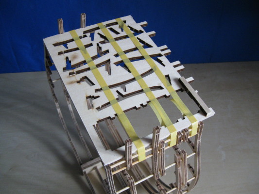

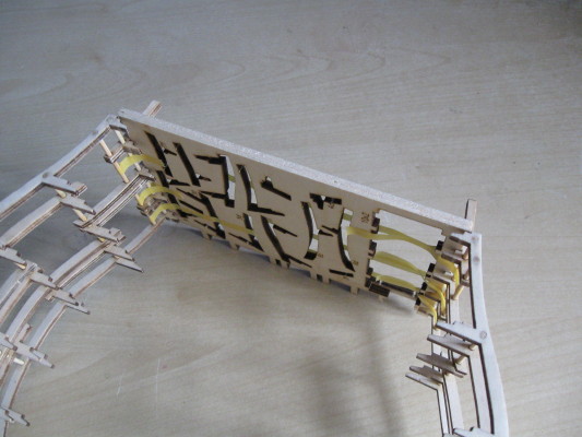

Bracing the framework - It’s important to make sure that the upper ends of the ribs stay in alignment while you add the planks, so start by fixing a temporary brace across the top.
Take the piece of fret that you saved from Issue 123 (see Quick Tip, page 13). The brace is just the right width to fit flush across the uppermost deck brackets on both sides of the ribs.
Tape it across the open top of the framework, making sure that the flat edge lines up perfectly with rib 8 at both sides. This will act as a brace to ensure that the frame does not twist.

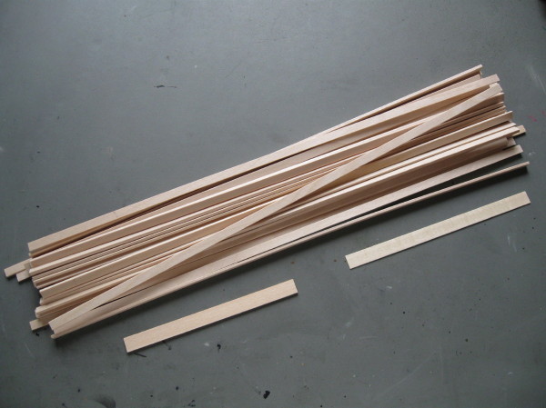

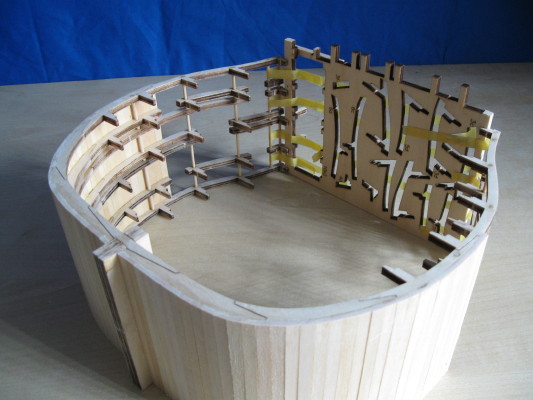

Starting the outer planking - The planks supplied are sufficient for planking the bottom of the hull up to the level of the gun ports on the lower gun deck. Planks above this level will not be continuous, as they are cut around the gun and entry ports.
As the ribs are thin and narrow, pinning through the planks would likely split them. The method used is slower, because you need to allow the glue to dry, but you will get a much neater result.
Cut a piece of 2x5mm plank long enough to overhang the outer ribs by a couple of millimetres (about 93-94mm long). Chamfer the inner edge so that it sits flat against the keel.
Apply wood glue to the ribs and the edge of the plank and glue it in place adjacent to the keel. Hold it in place by pushing pins into the ribs to trap the edge of the plank at an angle. Working this close to the keel, you will find it easier to use dressmaking pins or fine glassbead head modelling pins.
Ensure the pins don’t split the ribs – especially the outer faces of ribs 2 and 8, and be sure to apply glue to the edges of the planks as well as the ribs.
Remove any excess glue immediately, especially in the angle between the keel and the plank. You can add a matching plank on the other side of the keel, but allow the glue on these strips to dry before continuing the planking.
Continue to apply more planks to the outside of the hull in the same way. You will need to chamfer the edges of the planks where they go round the curve of the hull.
Continue to apply planks on both sides of the hull until you have a plank that overlaps the top of ribs 3 and 7, which form the bottom of the lower gun port.
When the glue is thoroughly dry, sand the ends of the planks flush with the faces of ribs 2 and 8. Be careful not to sand the ribs themselves. To support the model while you sand the side of rib 8, you can either temporarily remove the brace or allow the projecting end of the brace to overhang the edge of your worktop.
That completes the planking on the outside of the cross-section up to the level of the lower gun deck ports.

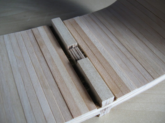

Planking the hold - With the first of the outer planks in place, you can turn to planking the lower area inside the hull, which will form the hold. The planking here is slightly more complex, as the thickness of the timber varies and there is also a drainage channel along the bilges. The wood supplied includes a veneer for finishing off the keelson.
You need to leave a 3mm gap in the planking either side of the keelson to form the drainage channel known as the limber passage. Cut two 93mm lengths of 1.5 x 5mm strip and place them on edge against the keelson as temporary spacers. (They will be used again later).
Cut a 93mm length of 2 x 5mm wood and glue it to the frames alongside the spacers from Step 1, being careful not to glue the spacers in place. Pin the strip in position and allow the glue to dry thoroughly, then remove the spacers.
Repeat the above on the other side of the model, using the same spacers. The strips can be recycled later to plank the hull, so don’t discard them after removal.
Glue another two strips of 2x5mm wood to each side.
Using 1.5mm strips, continue to plank the rest of the hold in the same way as you planked the outside of the hull.
Continue planking until there is a gap of between 5 and 10mm between the top plank and the bottom of the deck supports. This gap will be filled in later.
Sand the ends of the planks flush with the frames. Be careful not to sand the frames themselves as you could remove the laser-etched joint lines.
Sand the top of the keelson to remove most of the laser charring.
