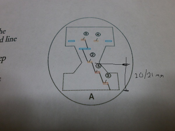

I am having the same problem with printing out the template. It would be easier if I knew how big it is meant to be. Just the overall height would help.
#5 Posted : 04 July 2012 22:11:22
BigGrin Hi Brian
this is how i did it,i measured on the bridge from the flag deck to ladder deck position no2[ the deck thats between the double rangefinders on port and starboard]its 20/21mm i think from memory. i then used picture resising software till i got the template to match the measurment i had, abit long winded to do but it worked for me.
