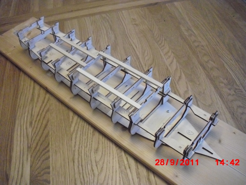

Welcome to the forum, with the Akagi and the Yamato models i waited till i had all the hull base plates then added all the hull formers in 1 go,remember to check that all the formers are not warped in any way[a good soak in water for 10/20 mins and clamping between two pieces of wood overnight will ussaly cure this problem].Also you will need a good dry dock to fix the hull too untill the majority of the planking is compleat[this stops you building the dreaded banana boatCrying ]i used a piece of 6 by 2 by 43 inches for the Akagi i got from my local woodmill for £5.00.Also take your time and look on other peoples build diarys if your stuck/unsure of anything,or failing that ask the question there are loads of people on here to give advice,finaly enjoy your build and il look forward to seeing your build diary when u get started

Hi Mightyleeds a big warm welcome to the forumBigGrin
Andys advice is spot on, the Dry Dock is the most important, here is what it looks like:-
MikeBigGrin
