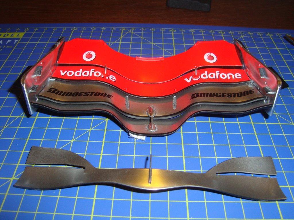

Part 1 attempted and mistake number 1
1) used super glue and made a mess..
Will have to order another 1st copy....
I would have got away with it if the middle flap didn't slip ...... Ahhh well lesson learned

It looks from your photo as though you have quite a lot of white 'Blooming' or 'Clouding' around all of the glue points on your wing and not just where the middle stay has slipped as you pointed out?? I don't know if you are aware so I'll say it anyway, but most 'Super Glues' give off a really aggressive vapour whilst curing, which WILL attack the exposed surfaces of any plastic around the glue joint and particularly any pre-painted surfaces, which looks like the result in your photo?? It is fine to use if the surface is to be painted later, but if it is already pre-painted as it is here, (or clear plastic) Superglue will ruin the paint everytime unless used in very small amounts (and I mean tiny spots)!!
When you get your replacement Issue 1, as a fellow modeller wanting to help, I would advise you to use ABS glue everywhere, without exception, that it says to use ABS in the instructions and even then sparingly with a 'Cocktail stick' to both surfaces (I use the same one as Mike has advised above - 'Evo-Stik Pipe Weld' - and it works fine). I would only use 'Superglue' WHERE it says so, as in where a metal part (such as the middle stay) needs to be bonded to an ABS plastic part and again very sparingly with 'cocktail sticks' and preferably a 'non-running' Gel type such as the one Mike has shown. Personally, I use Slo-Zap (Thick) which most good model shops will stock. I only prefer this as, although it does basically the same job as Mikes' Loctite, you get a lot more in the pot for about the same money !!
If you stick to those methods and what it says in the instructions, you should find a better result?? Oh, and I would second Mikes' advice and wear some 'Lint-free' gloves (Ebay) when handling the model and DON'T get glue on your fingers !! I hope that is helpful advice for you and I wish you good luck with the restart. BigGrin ThumpUp

thsanks guys, I had ABS available and my brain wasn't in gear LOL I did take my time but the superglue was as you said kev gave of a vapor that melted areas and wasn't cool..
So superglue only for metal areas or hard to glue areas now ....
Thanks for your support.. I ordered two copies of part 1 to be safe and will attempt it again on the weekend....
