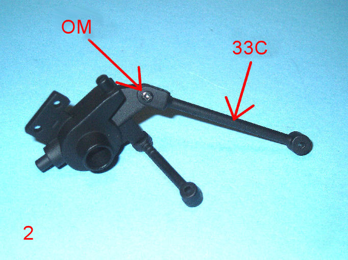

Pic 2: Fix the longer arm 33C to the hub with 1 x OM screw.

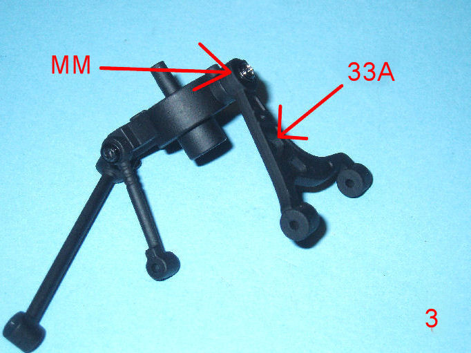

The suspension arms will cross over each other – this is correct.
Pic 3: Fit the upper arm 33A as shown and fix with 1 x MM screw.

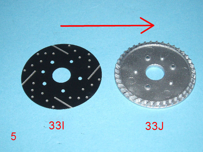

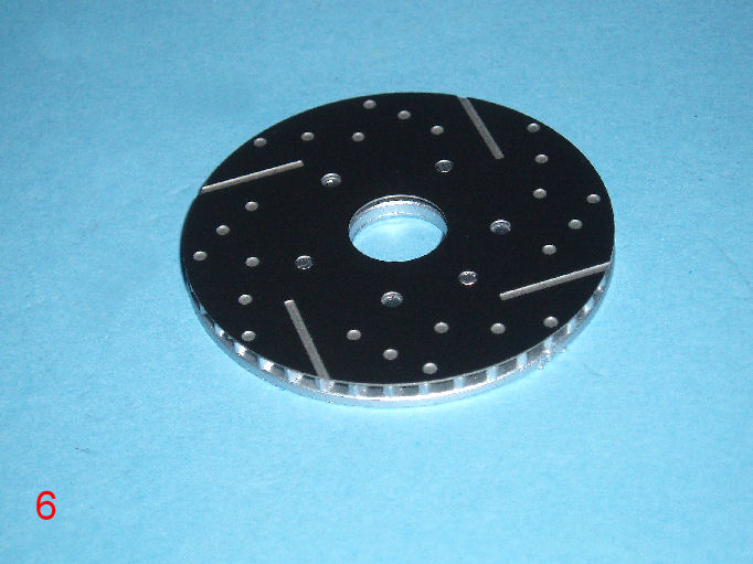

Pic 5: Locate the disc parts 33I and 33J.
33I will go on top of 33J.
Pic 6: Peel the backing from 33I and stick it to 33J, aligning all the locating pins and holes.

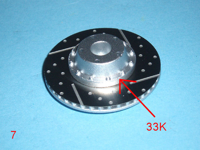

Pic 7: Press-fit the hub 33K onto the assembled disc.

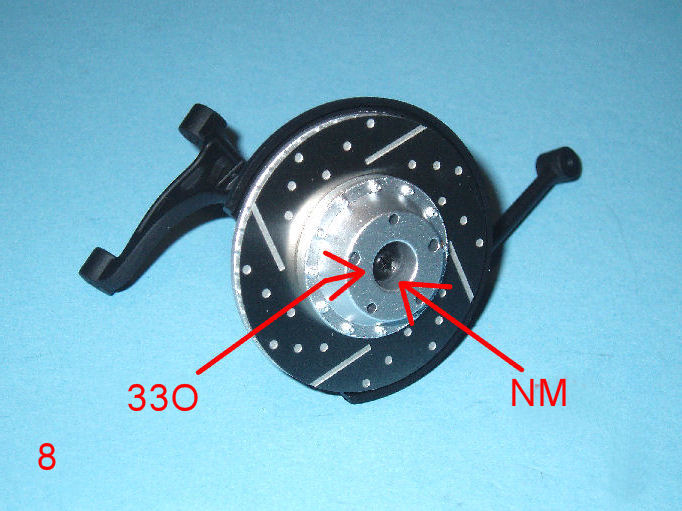

Pic 8: Fit the disc to the main hub as shown using a washer 33O first, then a fixing screw NM.

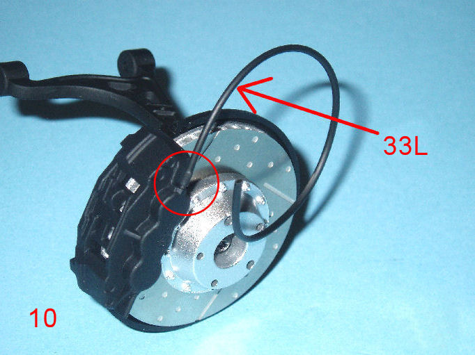

Pic 10: Fit the brake tube 33L to the pin on the caliper.

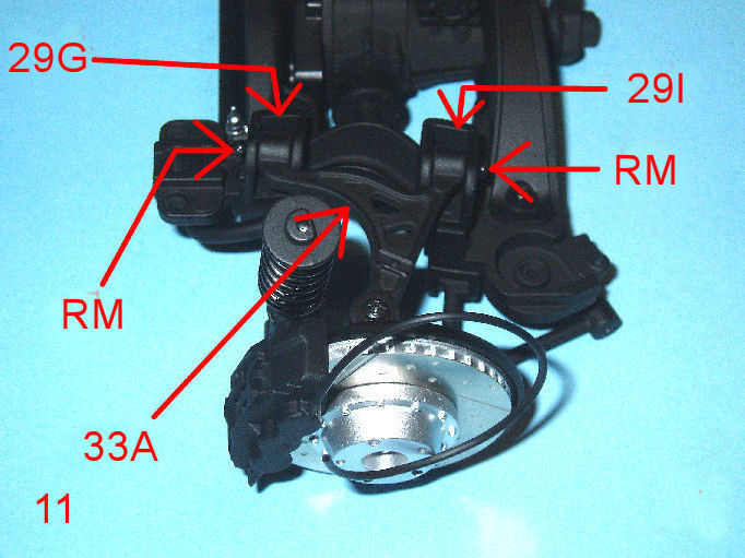

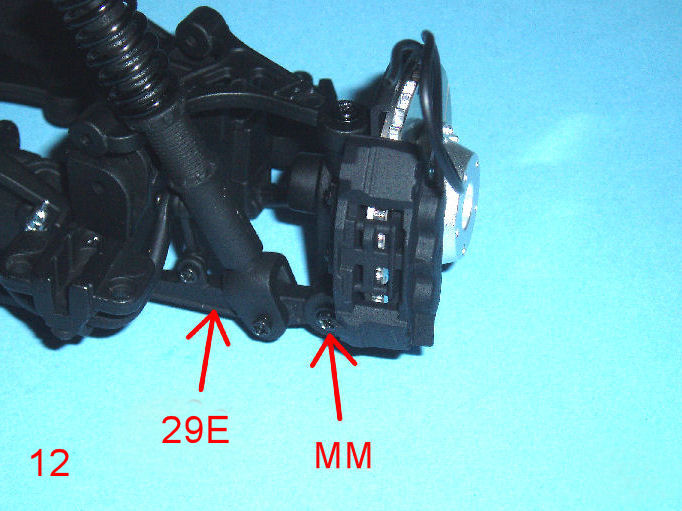

Pic 11: Retrieve the rear axle assembly and fit the hub in place as shown with the upper arms locating in the brackets indicated.
Fix the arms using 1 x RM screw in each from the outside.
Pic 12: Fix the bottom of the hub to the suspension arm using 1 x MM screw.

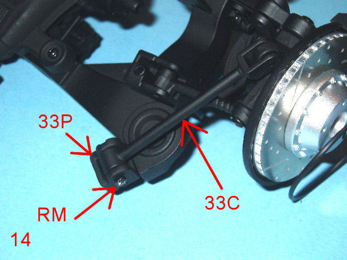

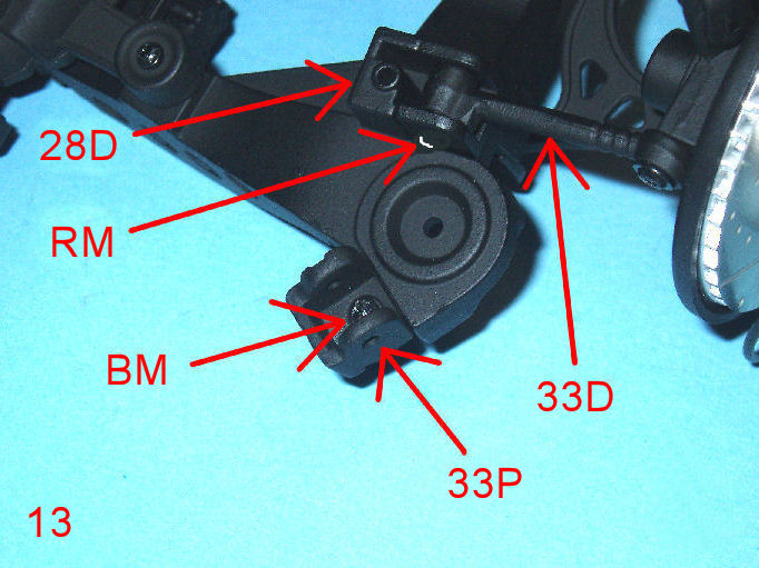

Pic 13: Turn the assembly over and fix the short arm 33D into the bracket 28C indicated using 1 x RM screw.
Next, fix the bracket 33P where shown using 1 x BM screw.
Pic 14: Fit the arm 33C into the bracket and fix with 1 x RM screw.

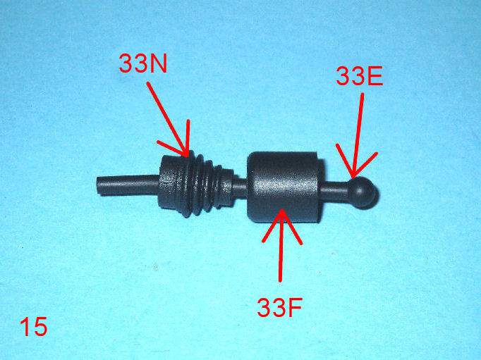

Pic 15: Locate the drive shaft parts33E, 33F and 33N.
Fit them together in the order shown.

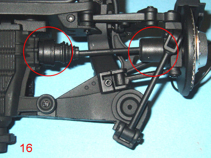

STAGE 33C:
Pic 16: Wiggle the assembled shaft in place between the differential and the hub, and then push the rubber parts 33F and 33N over each end to hold it all in place.

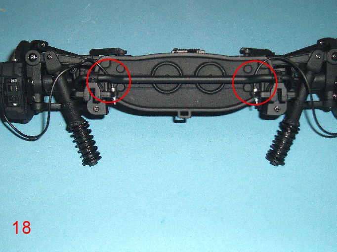

Pic 18: Connect the brake pipes as indicated to the silver connectors.

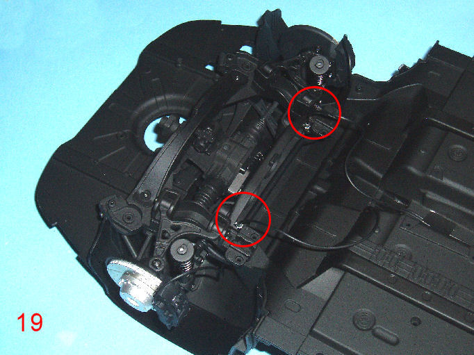

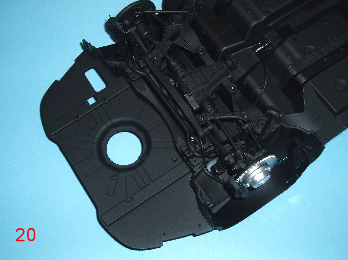

Pic 19: Retrieve the main car assembly and place it upside down.
Lay the assembled rear axle on top, also upside down so you can connect the brake lines inside the transmission tunnel.

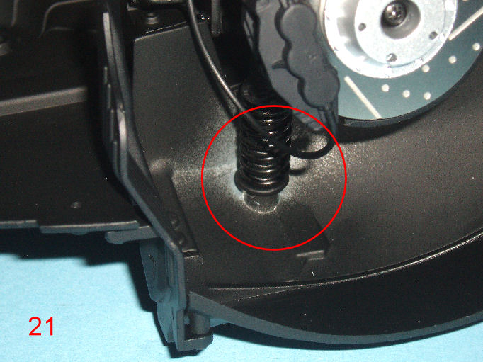

Pic 20: Roll the rear axle over, making sure the shock absorbers fit into the locations in the wheel arches.
Pic 21: Detail of the shock absorber location.
The other side must be the same.

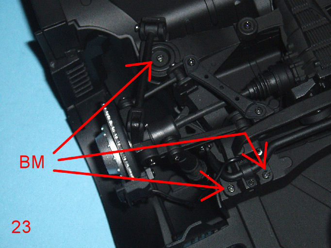

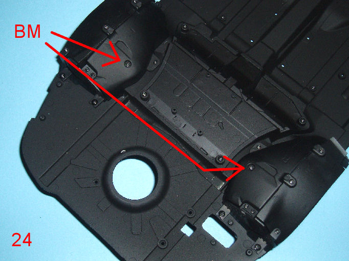

Pic 22: Fix the rear axle assembly to the car using 3 x BM screws in the locations shown.
Pic 23: Fix the other side in the same way.
Pic 24: Turn the model the right way up and fix the tops of the shock absorbers using 1 x BM screw in each.
