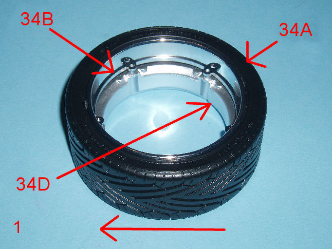

STAGE 34:
Right rear wheel.
Pic 1: NOTE: The printed instructions suggest soaking the tyre 34A in hot water to soften it.
This is not necessary as the wheel parts fit easily enough with the tyre ‘cold’.
Press the wheel rim parts 34B and 34D into the tyre 34A.
Note the direction of the tread pattern in relation to the wheel parts.
Make sure the screw tabs inside are in line.

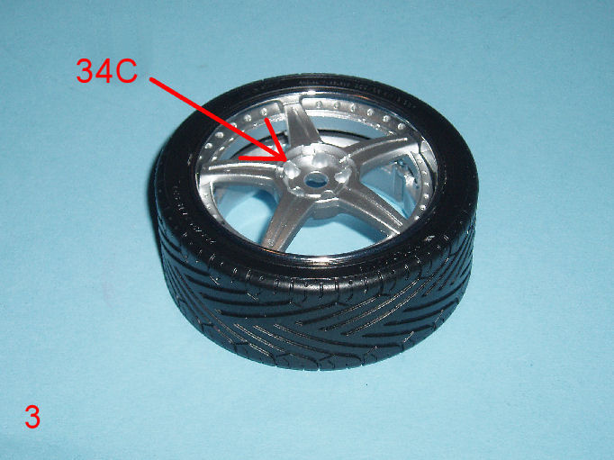

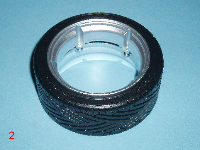

Pic 2: View from the other side.
Pic 3: Fit the outer rim 34C in place, again making sure the screw fixing tabs and holes are all in line.

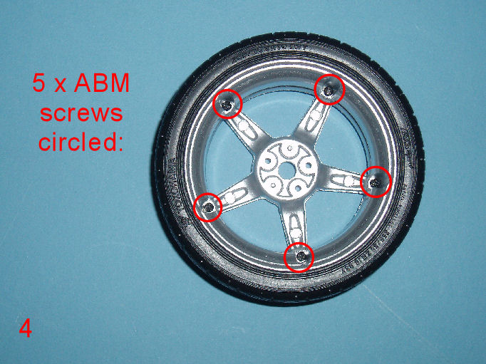

Pic 4: From the other side, fix all the parts together with 5 x ABM screws.

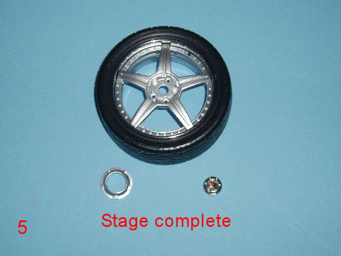

Pic 5: Store all parts safely for now.
