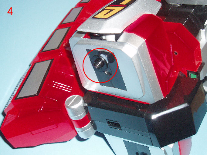

STAGE 108A:
Tyrannosaurus left leg 6.
Pic 1: Fit the clear rings 108.7 into the recessed side of the black rotation discs 108.6.
Pic 2: Remove the black square part under the main body but keep the PWB screw. Do the same on the other side.
Pic 3: Replace the square part removed with the circular assemblies from step 1. The clear ring 108.7 is uppermost.
Fix using the removed PWB screw.
Pic 4: Do the same on the other side.
Pic 5: Retrieve the leg assembly and fit the internal knee 108.3 as shown.
Fix with 1 x PWB screw.

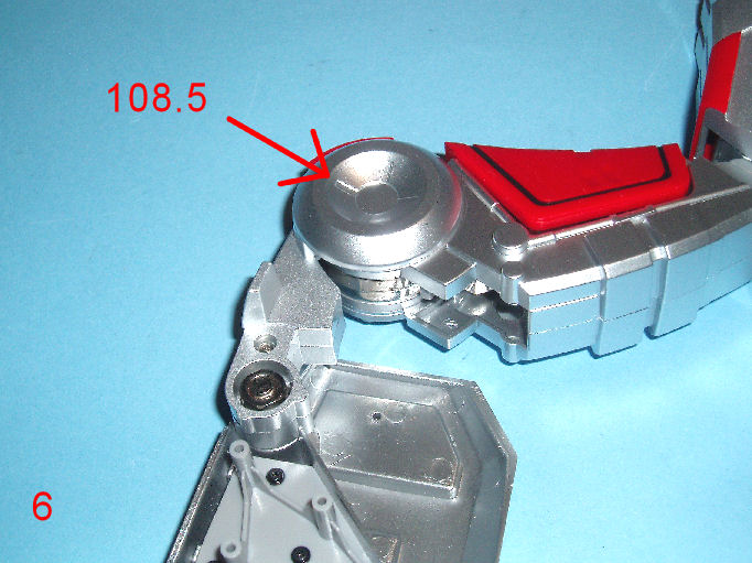

Pic 6: Press-fit the cap 108.5 into the knee joint.

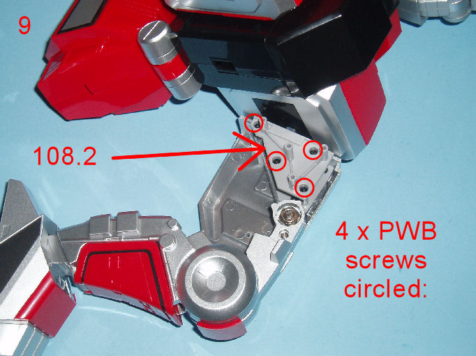

Pic 8: Fit the circular recess in the top of the leg assembly over the round rotation joint on the left of the body, fitted in step 3.
Pic 9: From the inside of the leg, fit the retaining bracket 108.2 and fix with 4 x PWB screws.
Pic 10: Fit the trim piece 108.4 as shown.
It will only fit one way.
Pic 11: Fit the inner thigh panel 108.1 and fix with 4 x PWB screws.
Store the model safely for now.

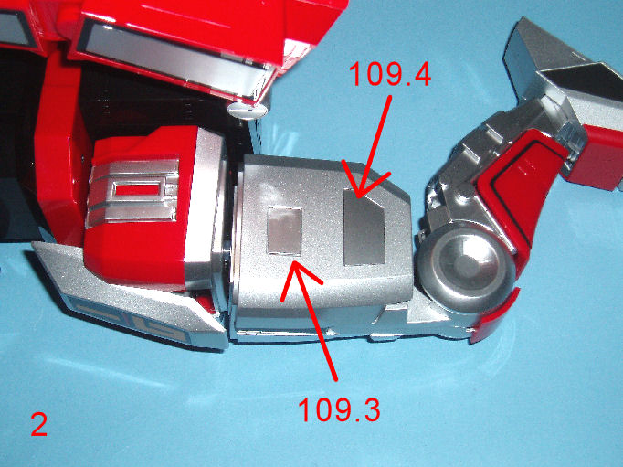

Pic 1: Fit the thigh cover panel 109.1 to the leg as shown and fix with 2 x PWB screws.
Pic 2: Press-fit the trim panels 109.3 and 109.4 in place as shown.
Pic 3: Fit the thigh cover panel 109.2 to the leg as shown and fix with 2 x PWB screws.
Pic 4: Press-fit the trim panels 109.3 and 109.5 in place as shown.

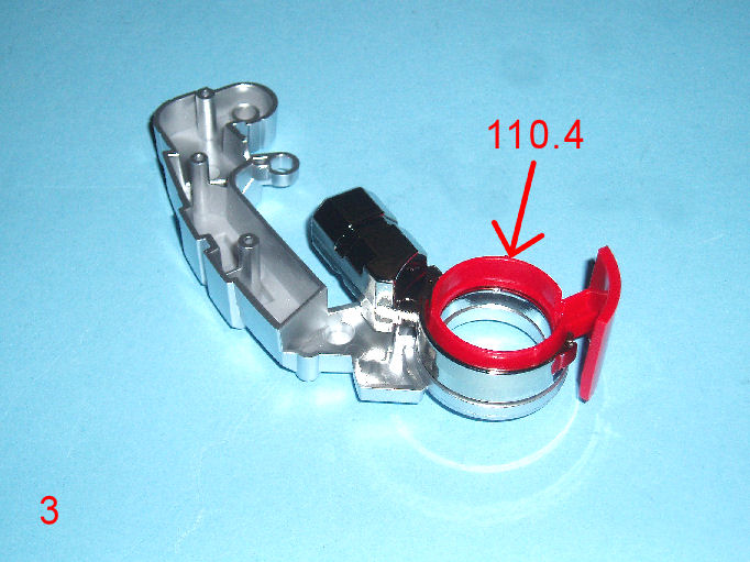

STAGE 110:
Tyrannosaurus right leg 1.
Pic 1: Fit the hexagonal end of the spindle 110.5 into the hole on the foot connector 110.3.
Pic 2: Fit the knee joint 110.1 into the calf 110.2 as shown.
Pic 3: Fit the knee cap 110.4 to the knee assembly.
Pic 4: Store the parts safely for now.

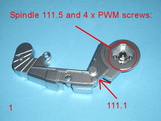

Tyrannosaurus right leg 2.
Pic 1: Fit the knee joint spindle 111.5 into the leg 111.1 from behind and fix with 4 x PWM screws.

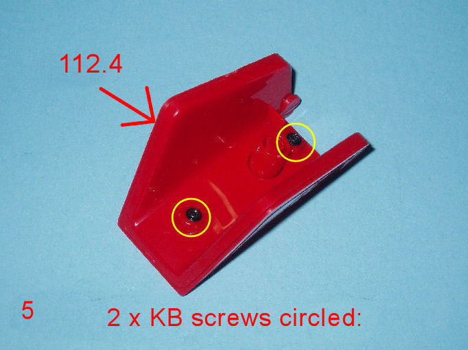

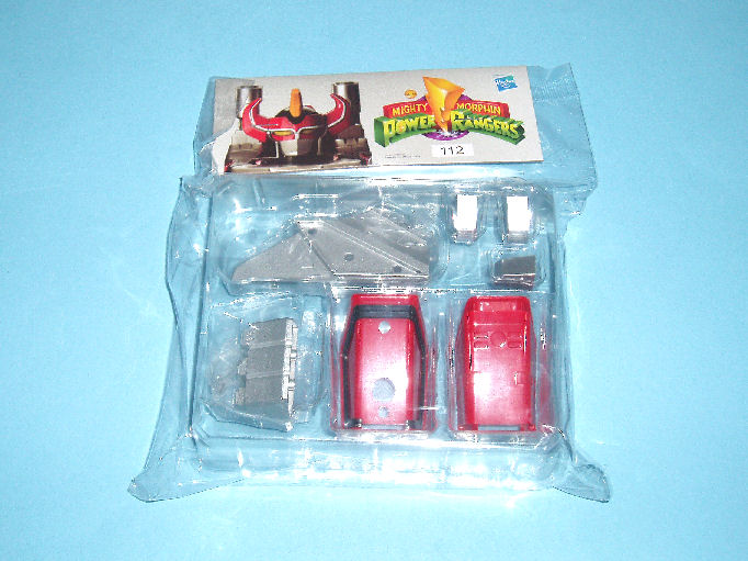

STAGE 112:
Tyrannosaurus right leg 3.

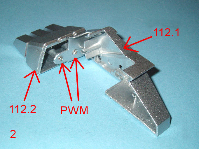

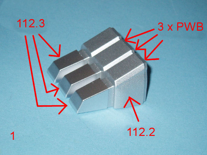

Pic 1: Fit the 3 x toes 112.3 to the foot 112.2 and fix from the inside with 3 x PWB screws.
Pic 2: Fit the assembly to the foot 112.1 and fix with 2 x PWM screws.
Pic 3: Fit the shin parts 112.6 and 112.7 together as shown.
Pic 4: Fit the shin part 112.5 inside the assembly.
Pic 5: Fit the shin part 112.4 inside the assembly and fix with 2 x KB screws.
Pic 6: Retrieve the leg assembly and fit the shin in place as shown.
Fix with 1 x KB screw through the grey connecting piece.

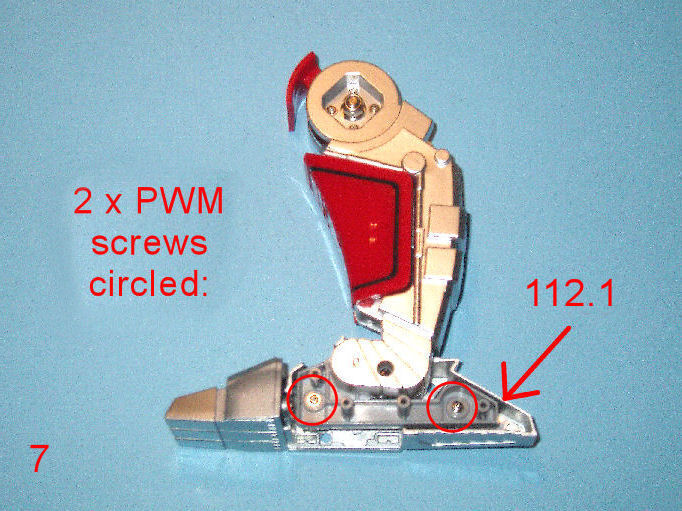

Pic 7: Fit the foot assembly 112.1 to the connecting piece on the end of the leg assembly and fix with 2 x PWM screws.
Store safely for now.

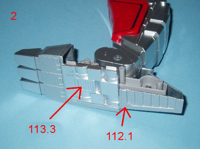

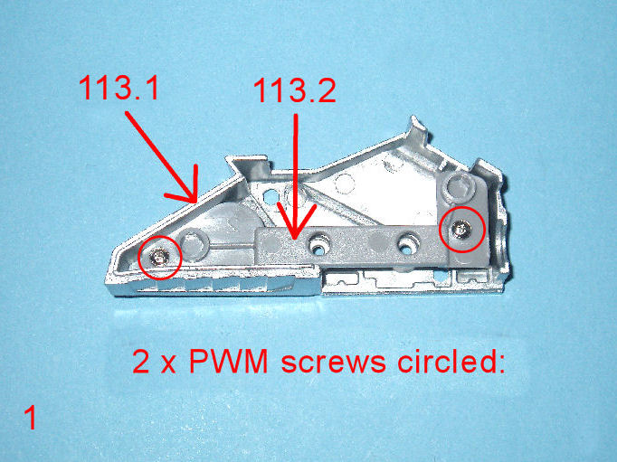

#7 Posted : 21 December 2025 11:36:53
Posts: 5,210
Points: 15,782
STAGE 113:
Tyrannosaurus right leg 4.

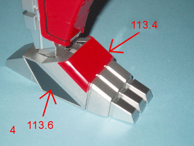

Pic 1: Fix the connecting piece 113.2 inside the foot 113.1 using 2 x PWM screws.
Pic 2: Retrieve the assembly from the previous stage and fit the panel 113.3 in place as shown.

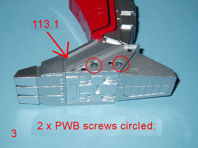

Pic 3: Fit the foot part 113.1 to the assembly and fix with 2 x PWB screws.
Pic 4: Press-fit the trip pieces 113.4 and 113.6 in place.
Pic 5: Press-fit the trim piece 113.5 in place.
Store the assembly safely.

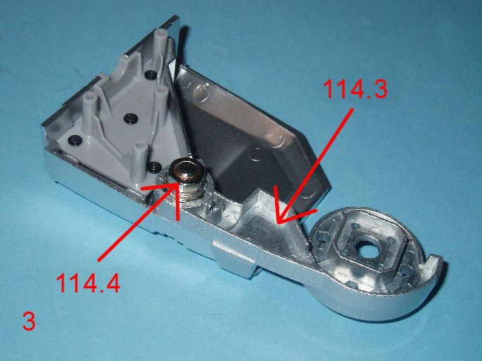

#8 Posted : 21 December 2025 13:54:22
Posts: 5,210
Points: 15,782
STAGE 114:

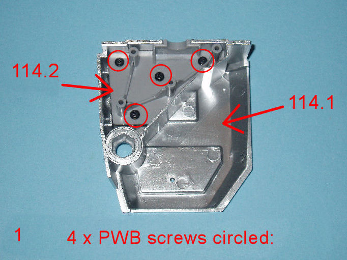

Tyrannosaurus right leg 5.

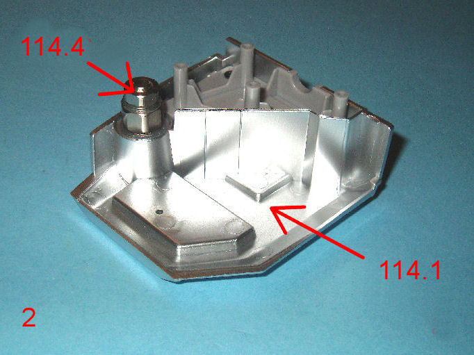

Pic 1: Fit the internal plate 114.2 into the thigh 114.1 and fix with 4 x PWB screws.
Pic 2: Press the wide end of the spindle 114.4 into the hexagonal hole in the thigh 114.1.
Make sure it is pushed fully in place.
Pic 3: Fit the internal knee 114.3 over the spindle 114.4 as shown.
Pic 4: Retrieve the leg/foot assembly from the previous stage and fit the knee joint 114.3 over the metal spindle as shown.
Fix using 4 x PWM screws.
Store the leg safely for now.
