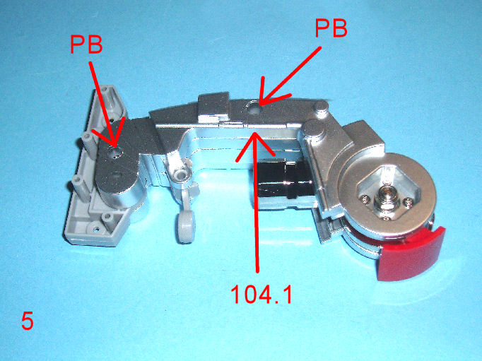

STAGE 104:
Tyrannosaurus left leg 2.

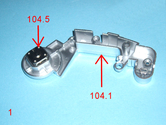

Pic 1: Fit the knee joint spindle 104.5 into the right calf 104.1 as shown.

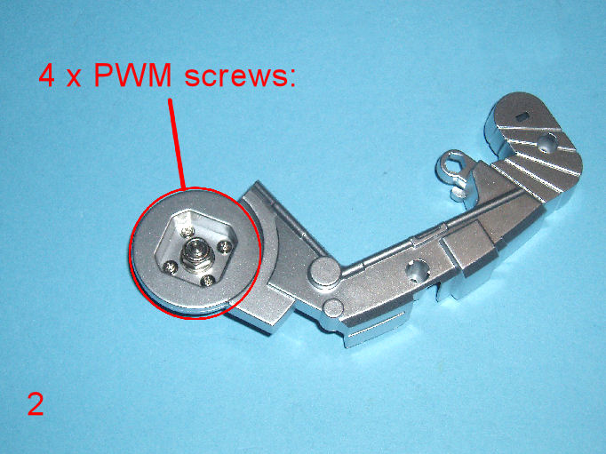

Pic 2: From the other side, fix the parts with 4 x PWN screws.
Pic 3: Fit the internal part 104.4 into the knee joint where indicated.
It will only fit one way.

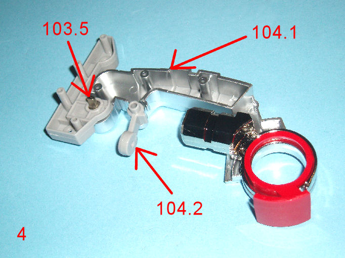

Pic 4: Retrieve the leg assembly from stage 103 and fit the metal spindle 103.5 into the locating hole in the leg 103.2.
Fit the connecting piece 104.2 to the assembly as shown.
Pic 5: Fit the calf 104.1 to the assembly and fix with 2 x PB screws.
Pic 6: Press-fit the screw cover 104.3 in place.
Store the assembly safely.
