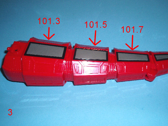

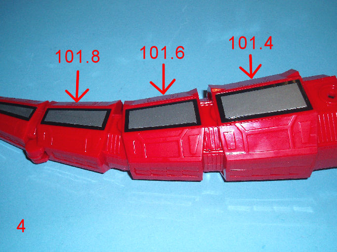

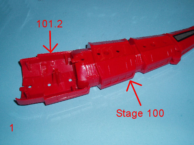

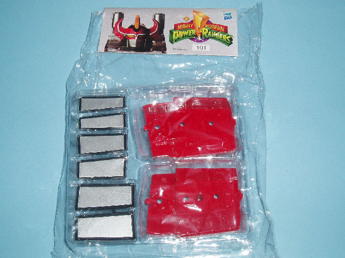

STAGE 101:
Tyrannosaurus tail 2.
Pic 1: Retrieve the tail assembly from stage 100 and fit the lower panel 101.2 as shown.
Pic 2: Fit the upper panel 101.1 in place and fix with 1 x PB screw through the centre hole.
Pic 3: Fit the trim panels 101.3, 101.5 and 101.7 to the left side of the tail.
Pic 4: Fit the trim panels 101.4, 101.6 and 101.8 to the right side of the tail.
Store the assembly safely.
