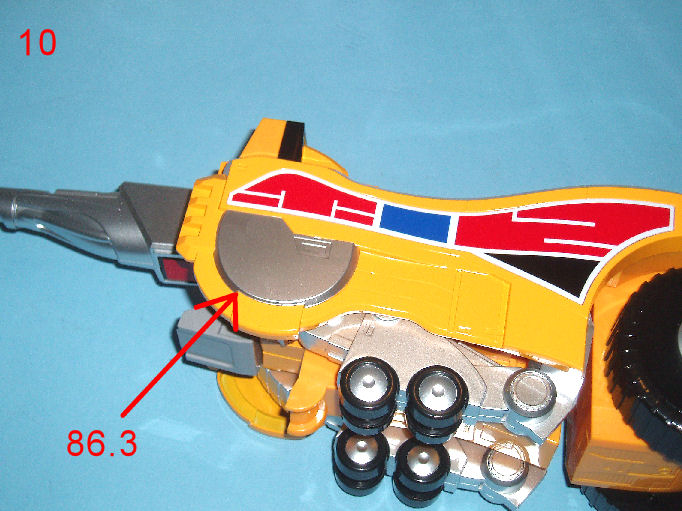

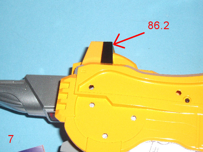

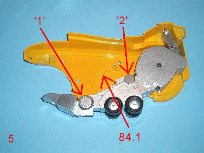

STAGE 86:
Sabretooth Tiger body 5.

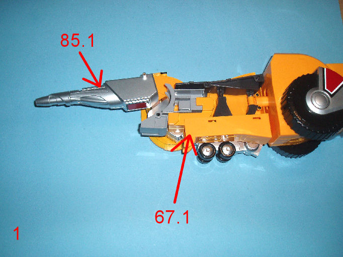

Pic 1: Retrieve the Sabretooth tiger body 67.1 and fit the tail 85.1 in place as shown.

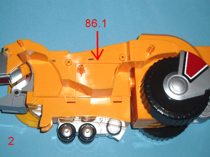

Pic 2: Clip-fit the middle panel 86.1 in place on the main body.
It will only fit one way.

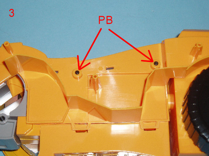

Pic 3: Fix the upper part with 2 x PB screws.

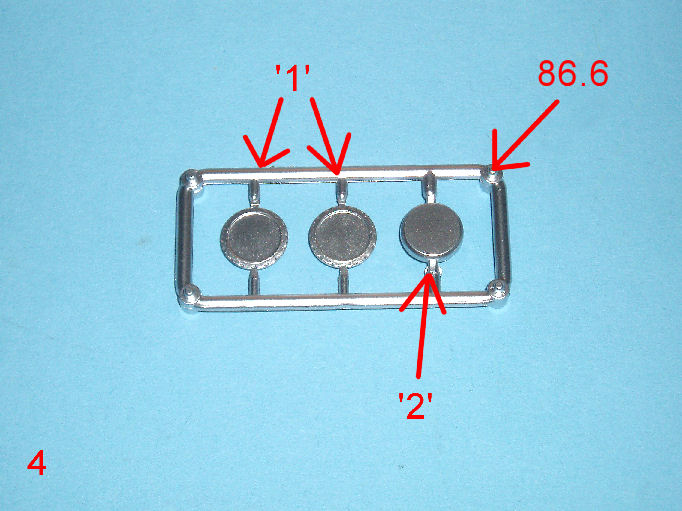

Pic 4: Locate the wheel centre sprue 86.6. The parts are identified as ‘1’ and ‘2’.
Pic 5: Retrieve the body assembly 84.1 and press-fit the wheel centres ‘1’ and ‘2’ as shown.
Pic 6: Turn the assembly over and fit the other wheel centre ‘1’.
Fit this assembly to the main body and fix with 3 x PB screws.
Pic 7: Press-fit the trim part 86.2 in place.

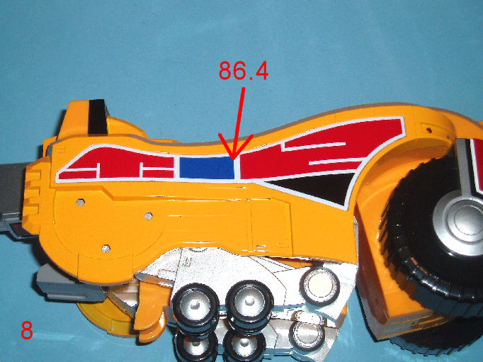

Pic 8: Press-fit the side panel 86.4 in place.

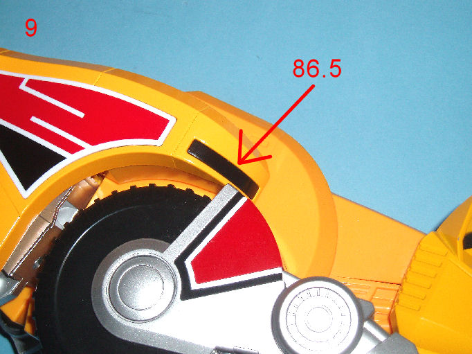

Pic 9: Press-fit the trim part 86.5 in place.
Pic 10: Press-fit the trim part 86.3 in place.
Store the model safely for now.

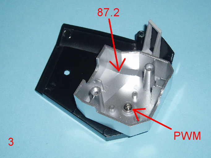

STAGE 87:
Mastodon left front leg 2.

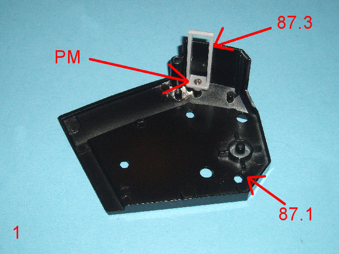

Pic 1: Fit the connecting piece 87.3 to the outer cover 87.1 and fix with 1 x PM screw.

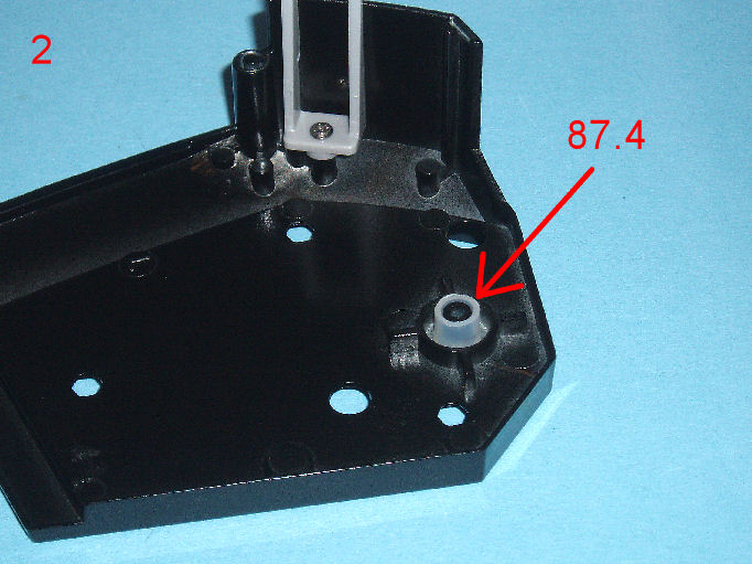

Pic 2: Fit the rubber sleeve 87.4 as shown
Pic 3: Fit the inner cover 87.2 in place and fix with 1 x PWM screw.
Store safely for now.

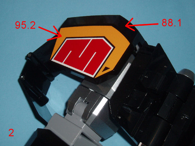

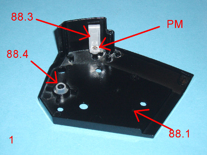

STAGE 88:
Mastodon left front leg 3.
Pic 1: Fit the connecting piece 88.3 to the outer cover 88.1 and fix with 1 x PM screw.
Fit the rubber sleeve 88.4 as shown.

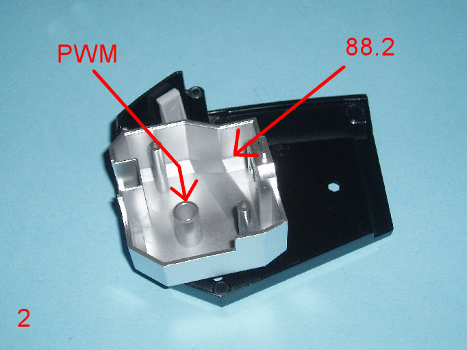

Pic 2: Fit the inner cover 88.2 in place and fix with 1 x PWM screw.

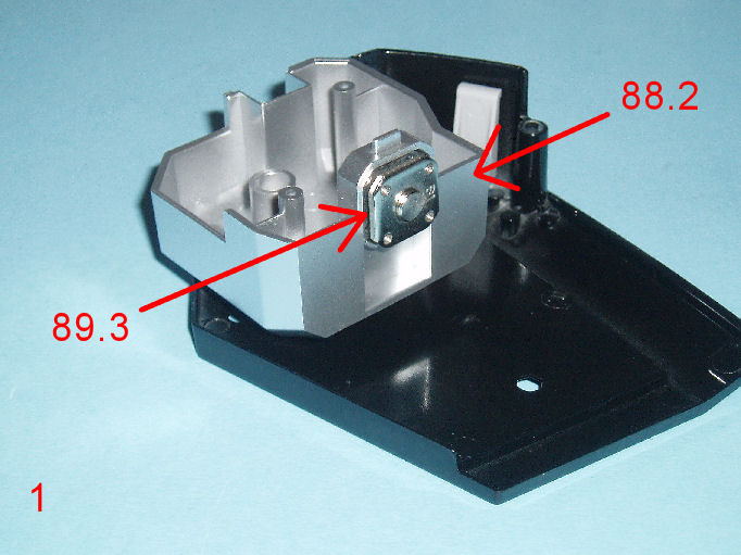

STAGE 89:
Mastodon left front leg 4.
Pic 1: Fit the rotation joint 89.3 into the front leg assembly from the previous stage.

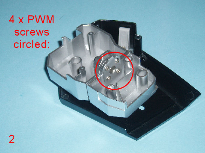

Pic 2: Fix from the other side with 4 x PWM screws.
Pic 3: Retrieve the leg assembly from stage 87 and fit the joint housing 89.1 in place as shown.
Fix with 3 x PWB screws.

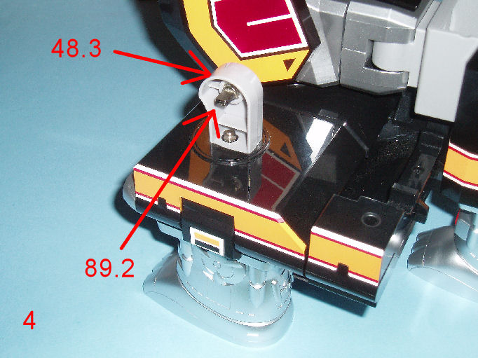

Pic 4: Retrieve the Dinozord assembly and fit the metal spindle 89.2 into the articulation piece 48.3 as shown.
Store everything safely for now.

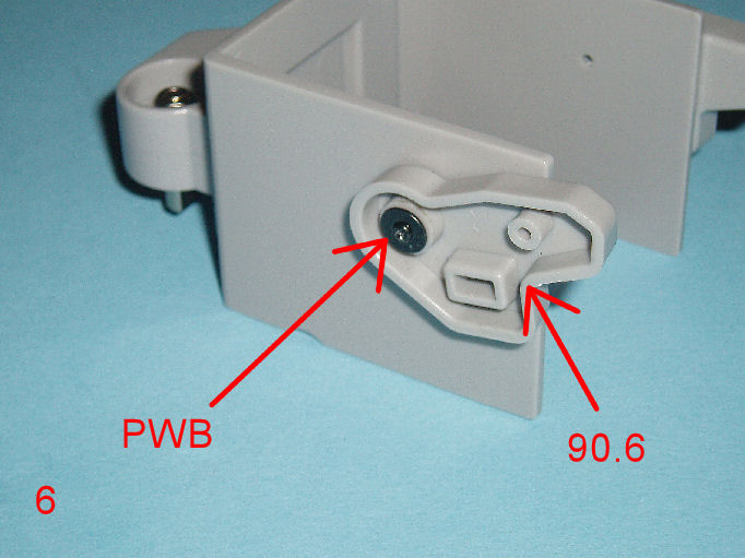

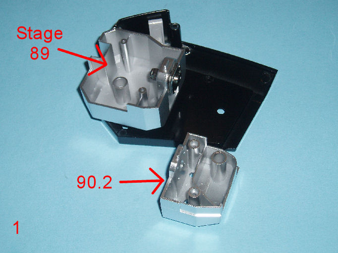

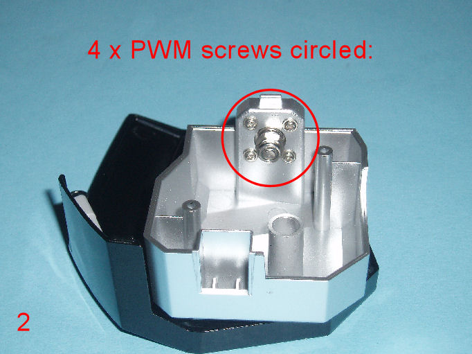

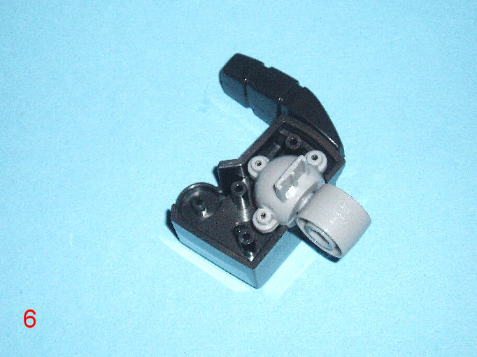

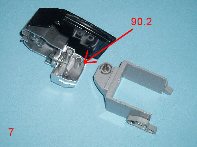

STAGE 90A:
Mastodon body 2.
Pic 1: Retrieve the assembly from stage 89 and the inner cover 90.2.
Pic 2: Fit the parts together as shown and fix with 4 x PWB screws.

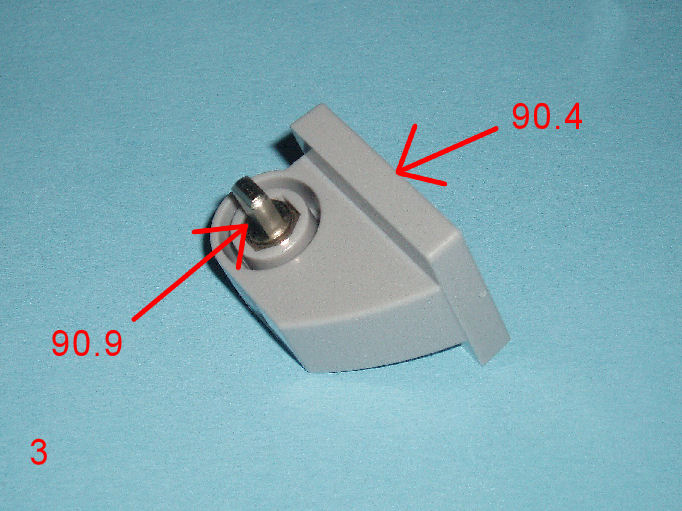

Pic 3: Fit the spindle 90.9 into the rotation part 90.4.
Pic 4: Fix the assembly to the inner body 90.5 with 1 x PB screw.
Pic 5: Fit the side connecting piece 90.7 in place as shown and fix with 1 x PWB screw.
Pic 6: Fit the side connecting piece 90.6 in place as shown and fix with 1 x PWB screw.

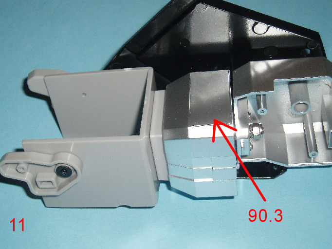

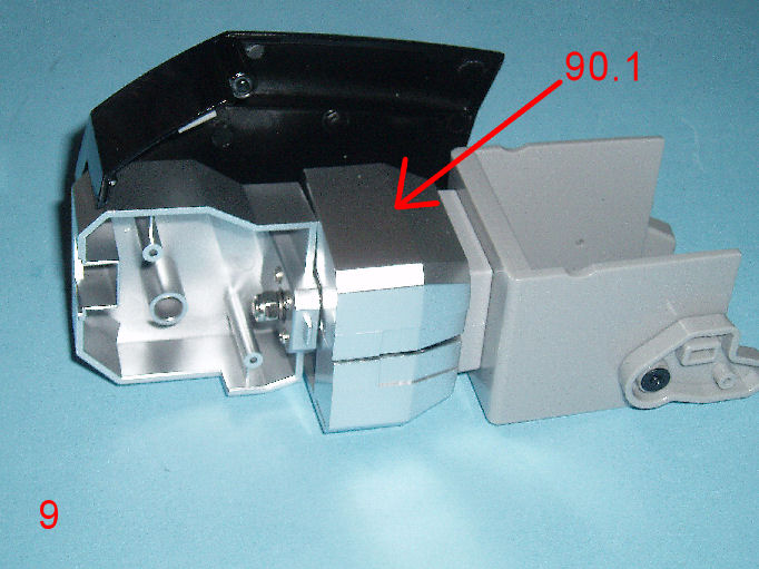

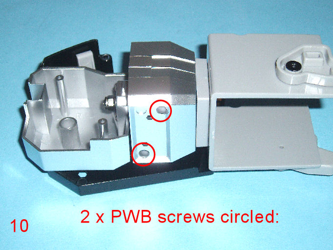

STAGE 90B:

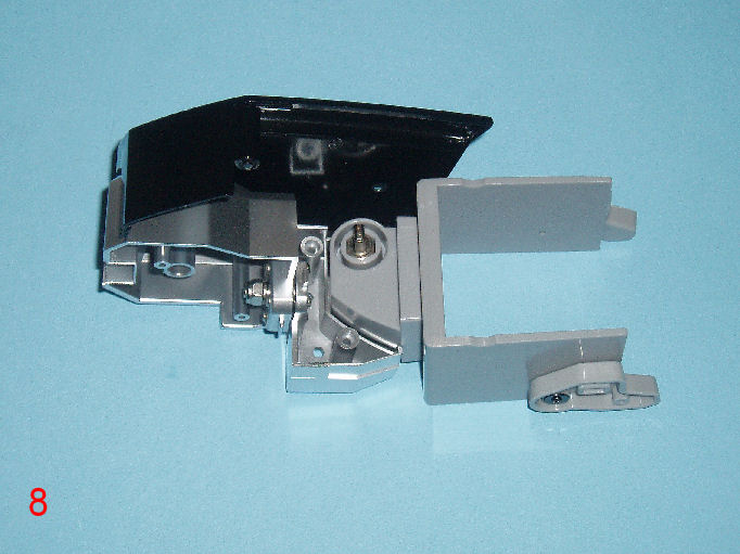

Pic 7: Retrieve the assembly from steps 1 and 2.
Pic 8: Fit the inner body part in place as shown.
Pic 9: Fit the outer cover 90.1.
Pic 10: Fix from underneath with 2 x PWB screws.
Pic 11: Press-fit the cover 90.3 in place.

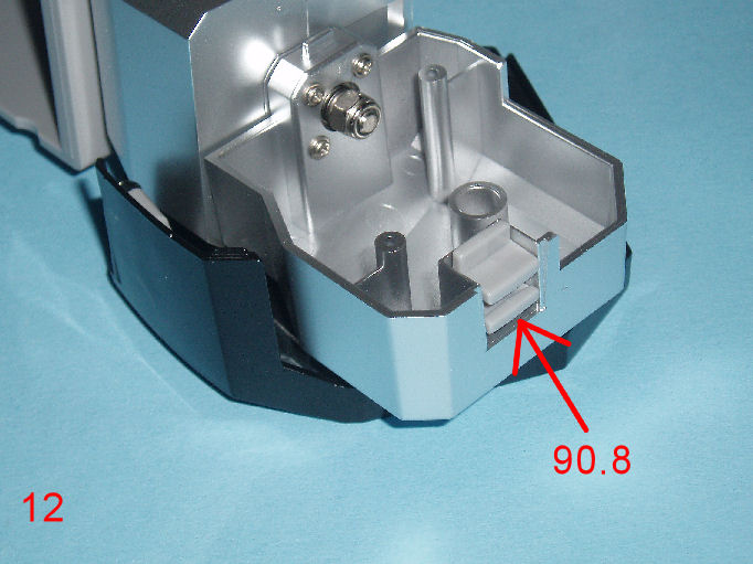

Pic 12: Fit the head connector 90.8 in place as shown.
Store the assemble safely.

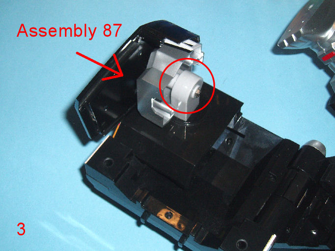

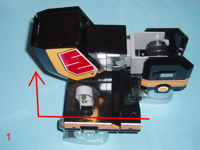

#7 Posted : 11 December 2025 16:41:27
Posts: 5,176
Points: 15,677

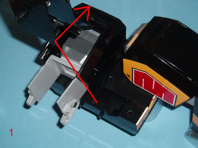

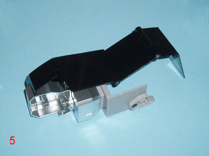

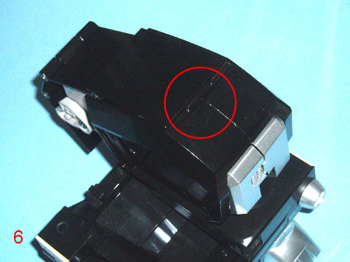

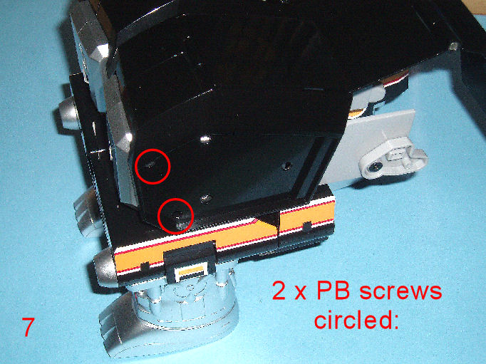

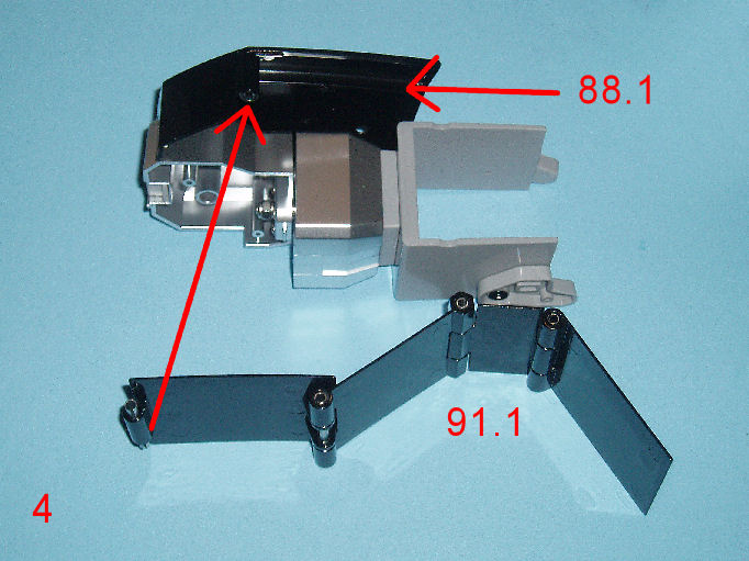

STAGE 91:
Mastodon back 3.
Pic 1: Retrieve the main assembly and twist the base through 90 degrees for better access to the grey joint post.
Pic 2: Once in this position, tilt the body section up and away from the base.
Pic 3: With the upper body out of the way, fit the spindle on assembly 87 into the joint post as shown.
Pic 4: Retrieve assembly 88 and locate the upper body 91.1.
The spindle indicated will fit in the hole on the body side panel.
Pic 5: Shows the parts fitted together.
Pic 6: Fit this assembly to 87 as shown, locating the opposite spindle on the upper body in the locating hole in the side panel.
Press the parts firmly together.
Pic 7: From the outside, fix the parts using 2 x PB screws.

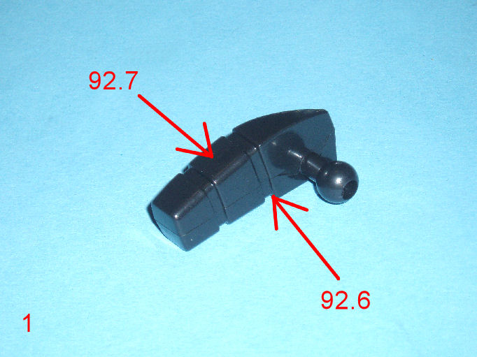

Megazord right hand.
Pic 1: Press-fit the thumb parts 92.6 and 92.7 together.
Pic 2: Fit the thumb into the hand housing 92.1 as shown and locate the cover 92.3 which will fit inside.

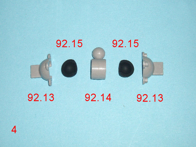

Pic 4: Locate all the joint parts 2 x 92.13, 92.14 and 2 x 92.15 and lay them in the order of assembly as shown.
Pic 5: Assemble the parts and fix together with 3 x PWB screws.

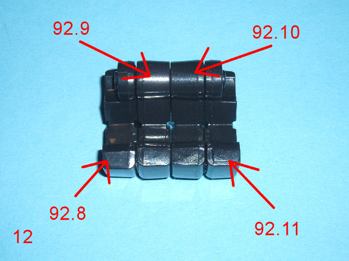

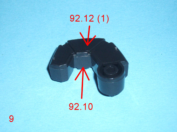

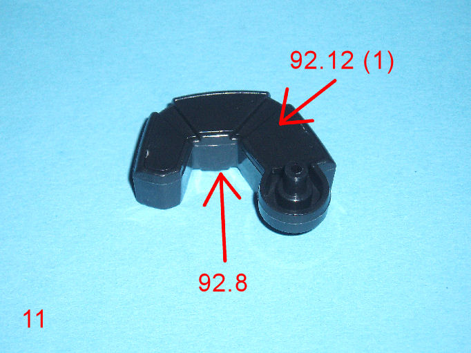

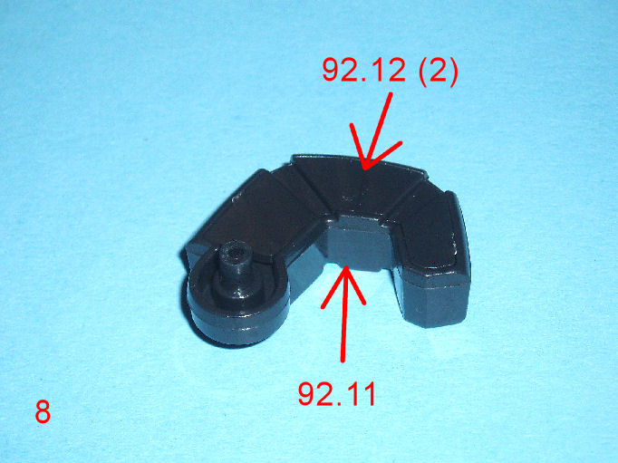

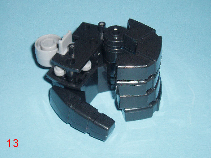

Pic 8: Press-fit the finger 92.11 and 92.12 (marked with a ‘2’) together as shown.
Pic 9: Press-fit the finger 92.10 and 92.12 (marked with a ‘1’) together as shown.
Pic 10: Press-fit the finger 92.9 and 92.12 (marked with a ‘2’) together as shown.
Pic 11: Press-fit the finger 92.8 and 92.12 (marked with a ‘1’) together as shown.
Pic 12: Press-fit the fingers together in the order shown.
Pic 13: Fit the fingers to the hand assembly as shown.

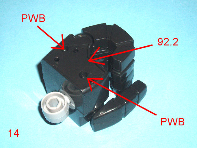

Pic 14: Fit the outer hand 92.2 as shown and fix with 2 x PWB screws.
Pic 15: Fit the outer cover 92.5.

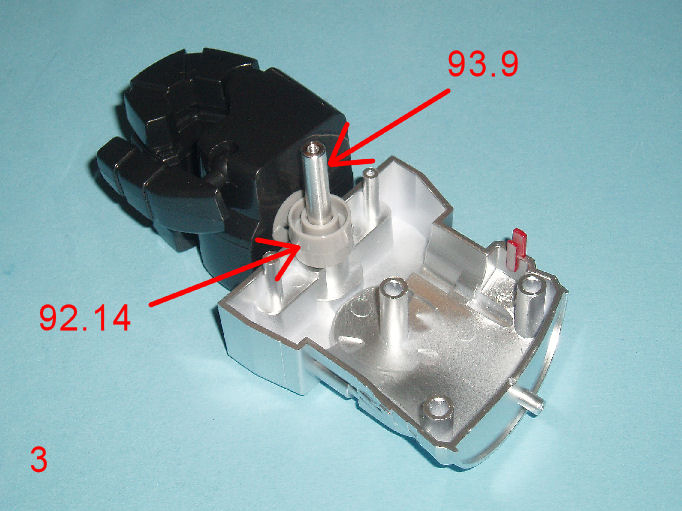

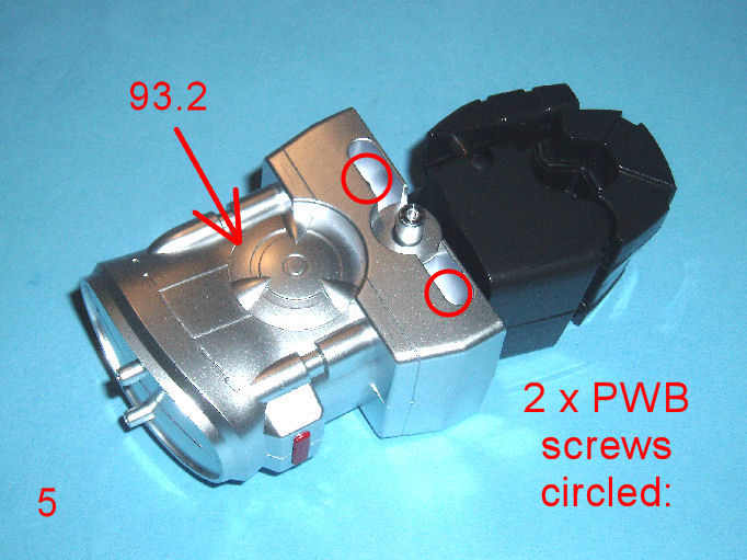

STAGE 93:

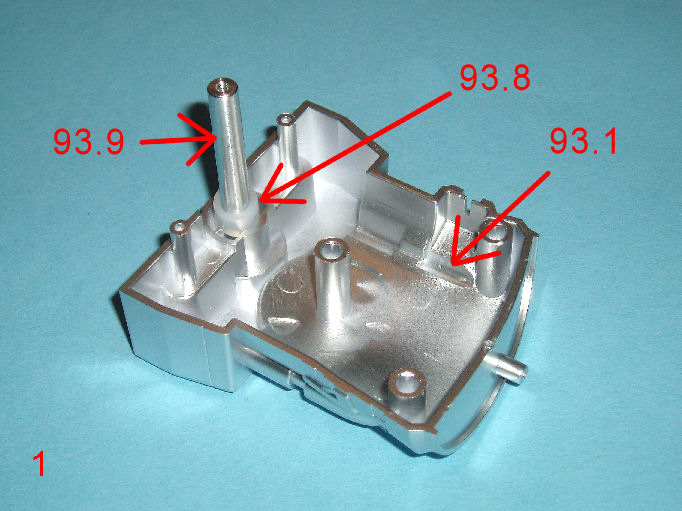

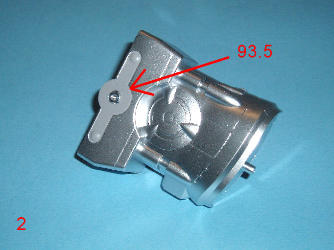

Dinozord left rear leg.
Pic 1: Fit the spindle 93.9 into the leg part 93.1 with the squared end going in first. Then slide the rubber sleeve 93.8 over the spindle.
93.1 is easily identified as it does NOT have two screw holes in the upper recessed area.
Pic 2: Fit the bracket 93.5 from the other side.
Pic 3: Retrieve the hand assembly from the previous stage and fit the joint 92.12 over the spindle 93.9.
Make sure the hand is facing the right way.
Pic 4: Slide the rubber sleeve 93.8 over the spindle.

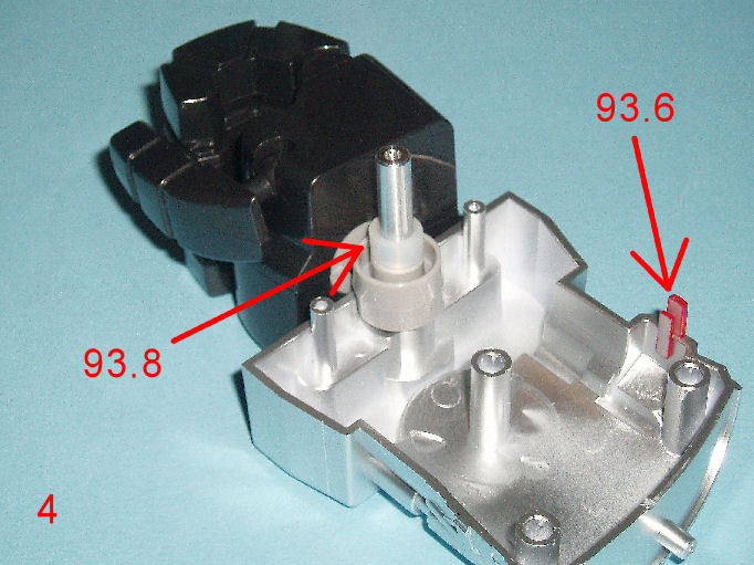

Fit the small red trim 93.6 as shown.
Pic 5: Fit the other leg part 93.2 in place and press the parts firmly together.
Fix using 2 x PWB screws.
Pic 6: Fit the outer bracket 93.5 as shown.

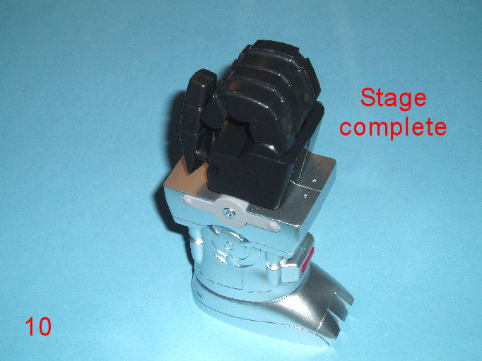

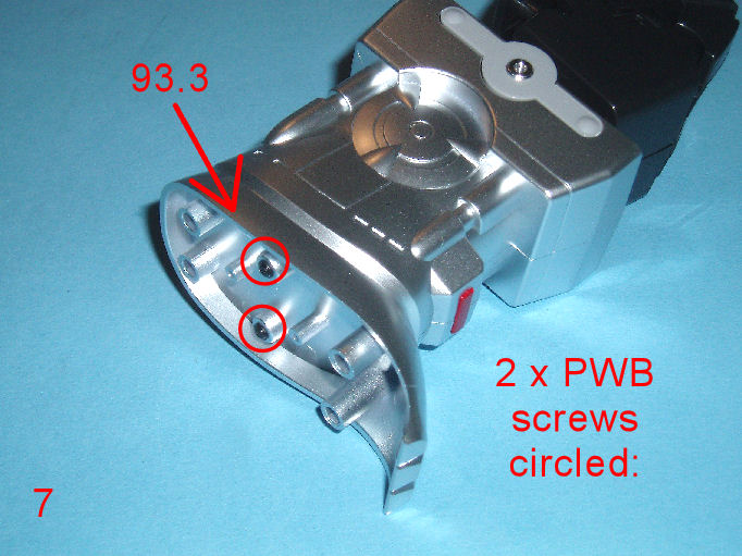

Pic 7: Fit the foot 93.3 in place and fix with 2 x PWB screws.
Pic 8: Fit the bracket 93.7 to the foot and fix with 2 x PWB screws.

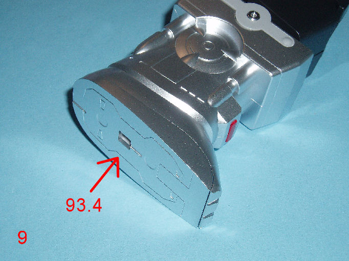

Pic 9: Press-fit the base 93.4 firmly in place.
Pic 10: Store the assembly safely for now.

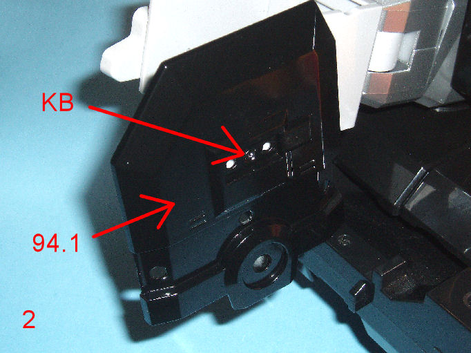

Pic 3: Fit the leg assembly from stage 92 in place and fix with 1 x PM screw through the side panel.

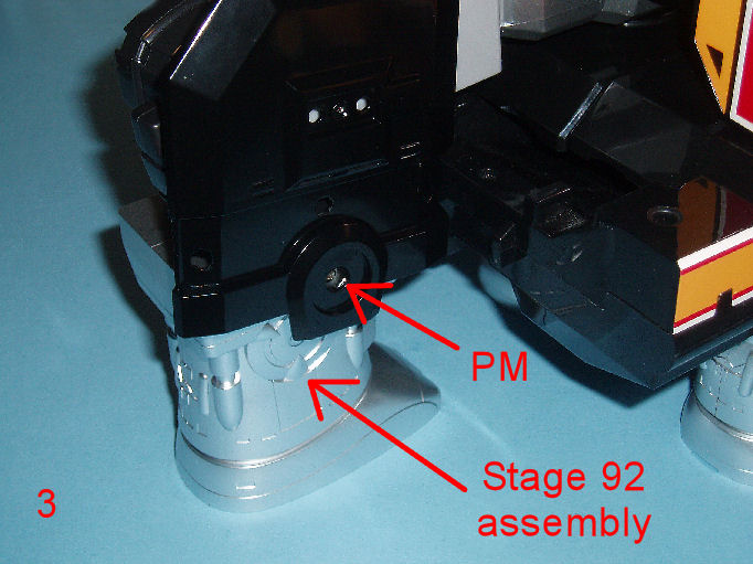

#12 Posted : 14 December 2025 15:17:32

Points: 15,677

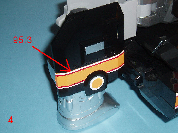

STAGE 95:

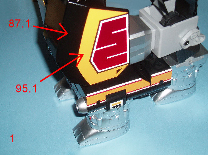

Dinozord body 3.
Pic 1: Press-fit the side trim 95.1 onto the body panel 87.1.
Pic 2: Press-fit the side trim 95.2 onto the body panel 88.1.

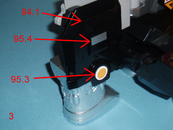

Pic 3: Press-fit the trim parts 95.3 and 95.4 in place on the side panel 94.1.
Pic 4: Press-fit the trim strip 95.3 onto the body panel 94.1.

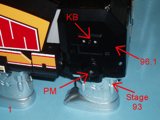

STAGE 96
Dinozord left rear leg 3.

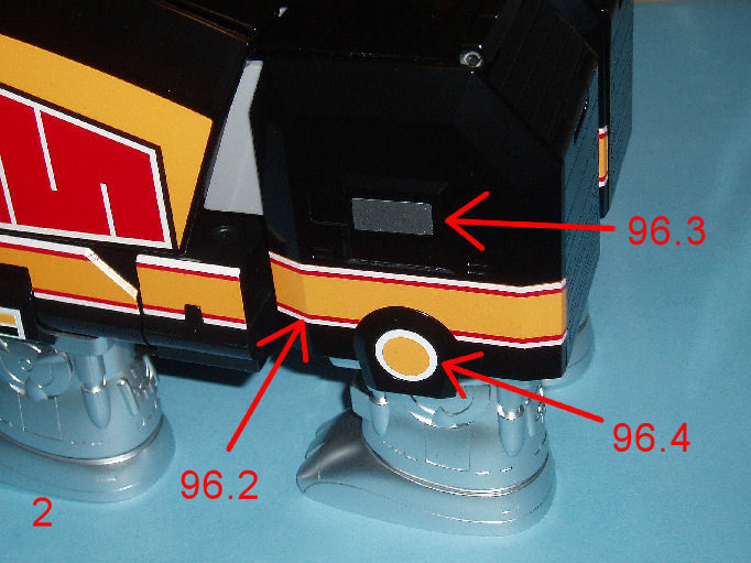

Pic 1: Fit the side panel 96.1 to the rear leg assembly from stage 93 and fix with 1 x KB screw and 1 x PM screw.

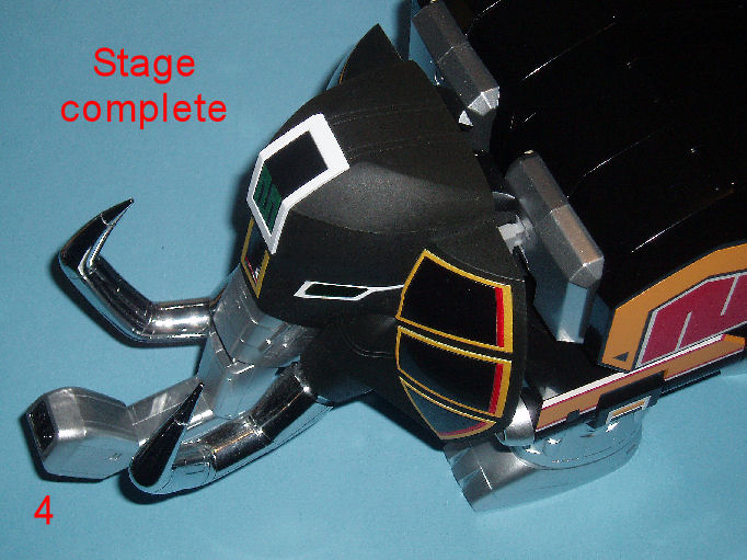

Pic 2: Press-fit the trim pieces 96.2, 96.3 and 96.4 in place as shown.

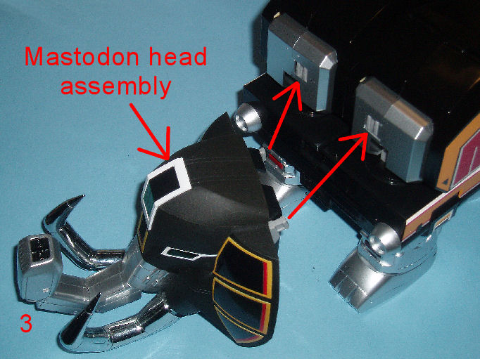

Pic 3: Retrieve the Mastodon head assembly.
The tabs on the back of the head will locate in the grey slots on the body where indicated.
Pic 4: Shows the head fitted in place.
Store the model safely.
