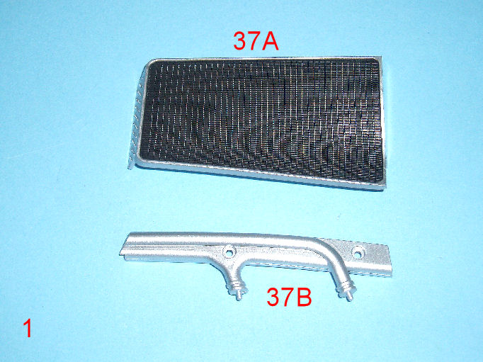

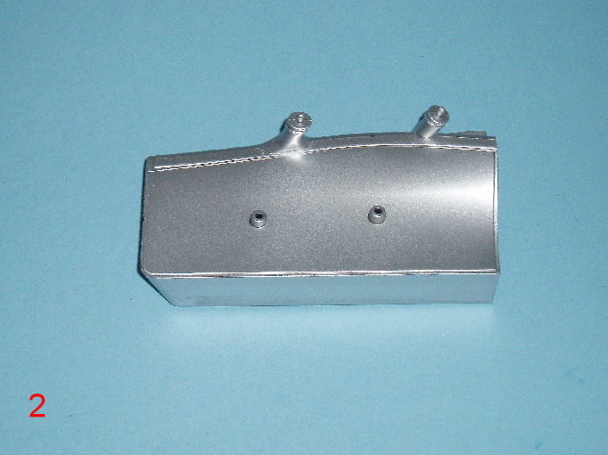

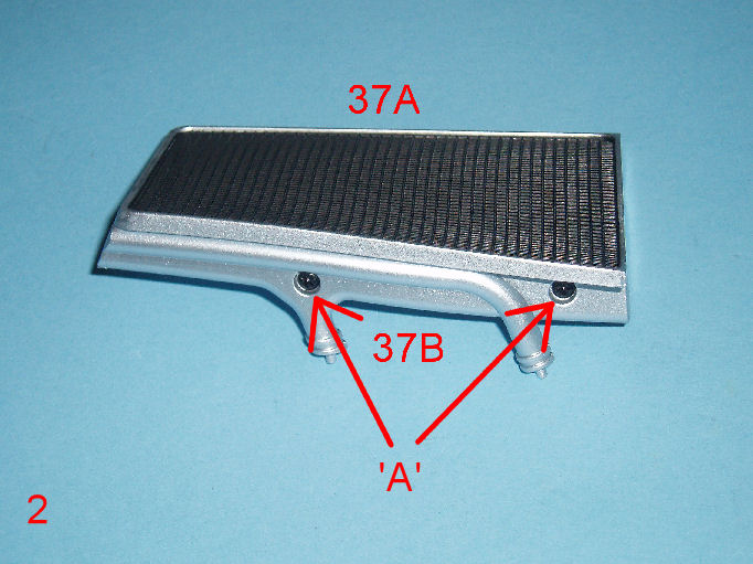

Left radiator.
Pic 1: Locate the radiator parts 37A and 37B.
Pic 2: Fit the parts together as shown.
They will only fit one way.
Fix using 2 x ‘A’ screws.
Store the assembly safely.

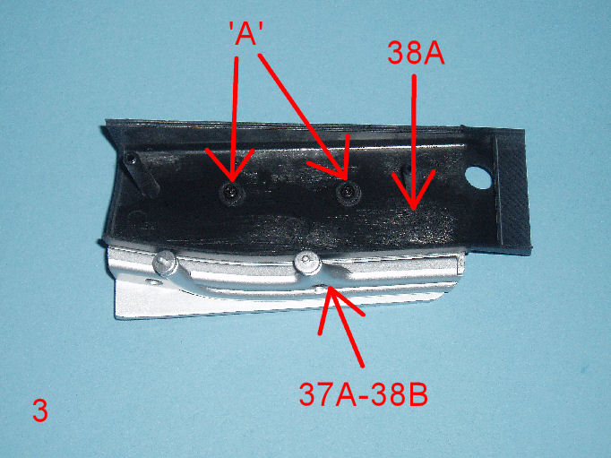

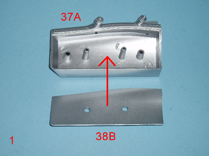

STAGE 38:
Left radiator 2.
Pic 1: Retrieve the radiator assembly from the previous stage and locate the cover panel 38B.
It will fit where indicated.
Pic 2: Press-fit the parts together.
Pic 3: Fit the structural panel 38A over the radiator assembly.
It will only fit one way.
Fix with 2 x ‘A’ screws.
