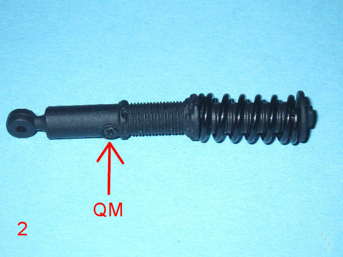

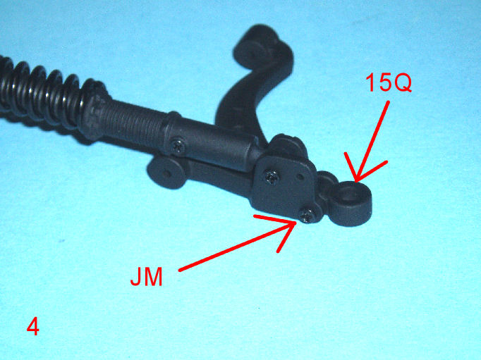

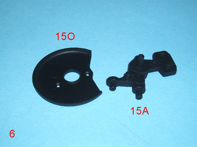

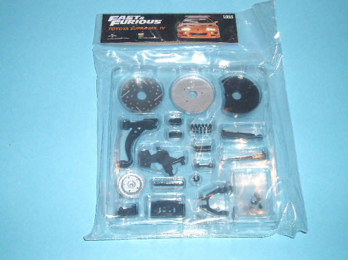

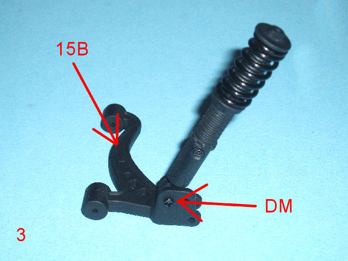

STAGE 15A:
Left front suspension.

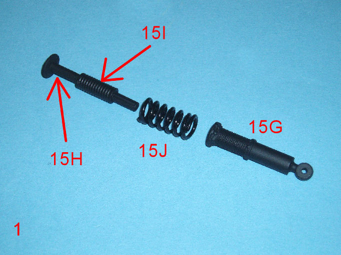

Pic 1: Locate the shock absorber parts 15G, 15H, 15I and 15J.
They will fit together in the order shown.
Pic 2: Assemble the parts and fix with 1 x QM screw.
Pic 3: Fit the shock absorber to the lower arm 15 and fix with 1 x DM screw.

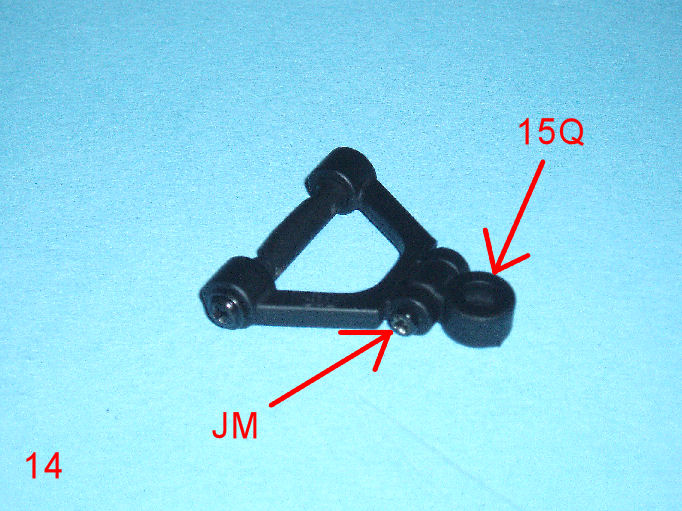

Pic 4: Fit the outer link 15Q as shown and fix with 1 x JM screw.
Pic 5: Fit the upper link 15F and fix with 1 x AM screw.

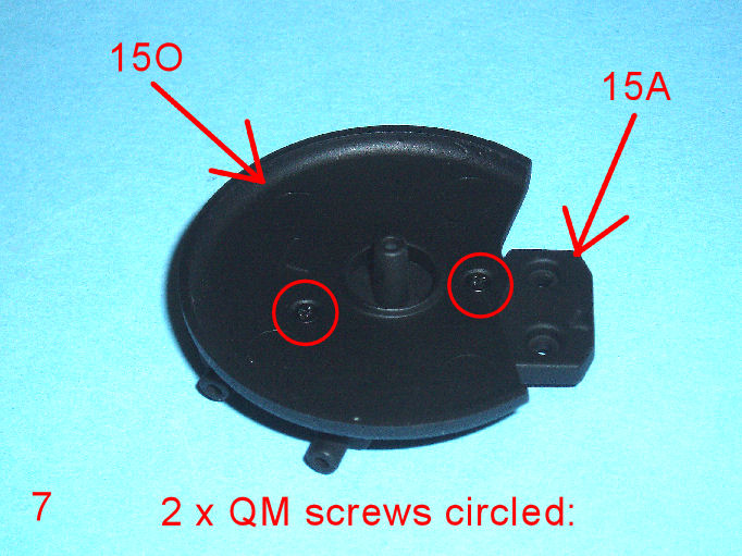

Pic 6: Locate the hub upright 15A and the brake back plate 15O.
Pic 7: Fit the parts together as shown and fix with 2 x QM screws.

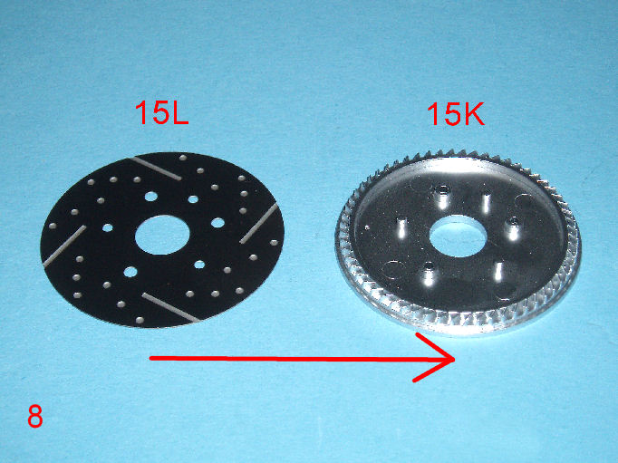

Pic 8: Locate the disc parts 15K and 15L.

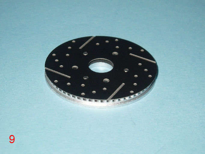

STAGE 15B:

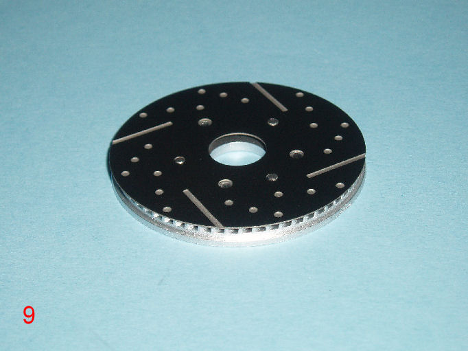

Pic 9: Peel the backing paper from 15L and stick it to the front of 15K, aligning the holes and pins on the parts.
They will only fit one way.

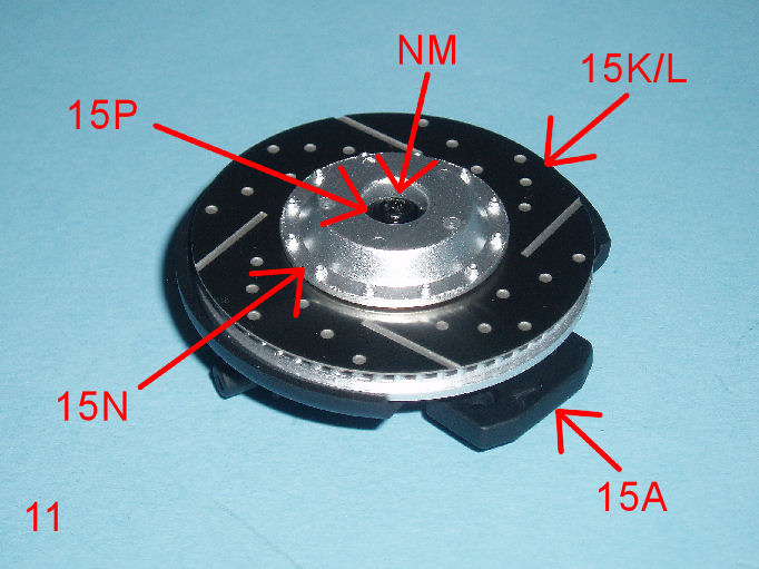

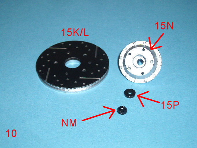

Pic 10: Locate the hub parts 15N and 15P, and 1 x NM screw.
Pic 11: Assemble the disc and hub upright as shown, fixing the parts with the NM screw.

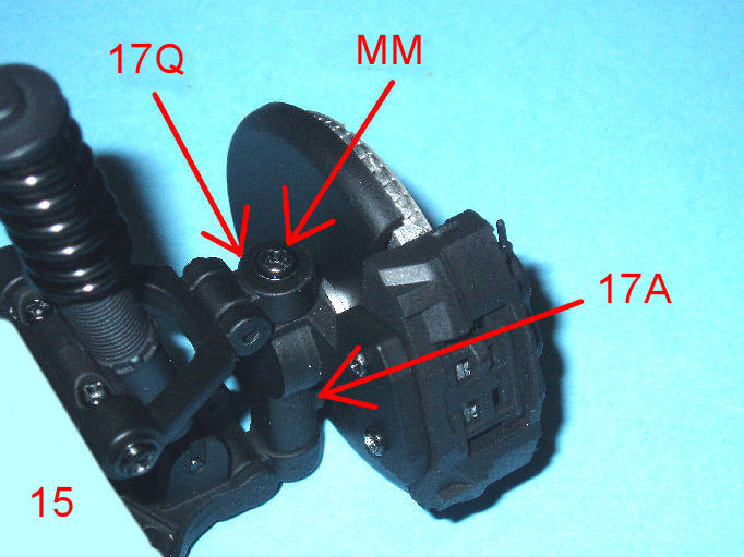

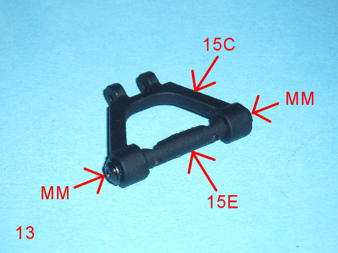

Pic 13: Fit the tube 15E into the top link 15C and secure at each end with 1 x MM screw.
Pic 14: Fit the outer link 15Q and fix with 1 x JM screw.

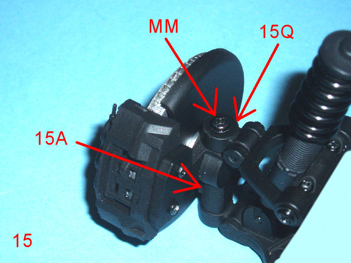

Pic 15: Fit the assembly over the shock absorber and onto the upright as shown. Make sure the top link 15C has the word ‘TOP’ uppermost.
Secure with 1 x MM screw.
Pic 16: Fit the lower arm 15B to the bottom of the upright 15A and fix with 1 x MM screw.

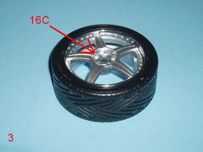

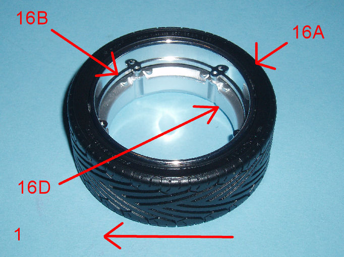

STAGE 16:

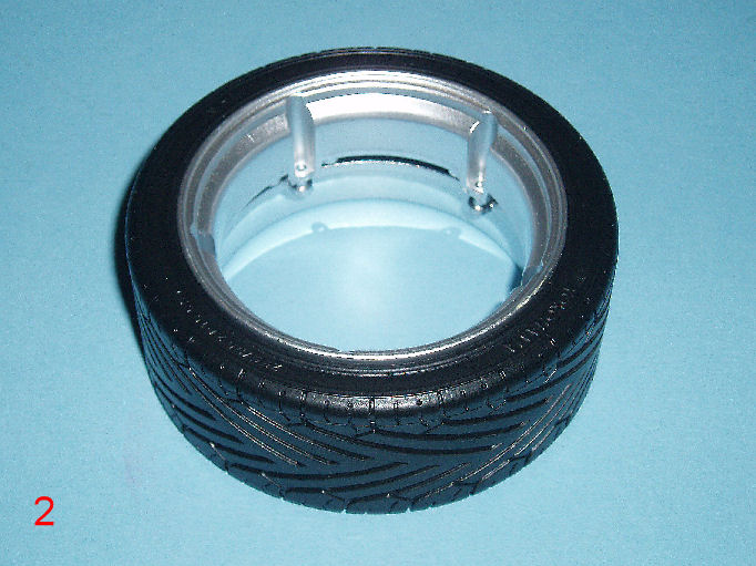

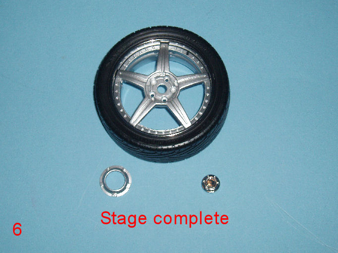

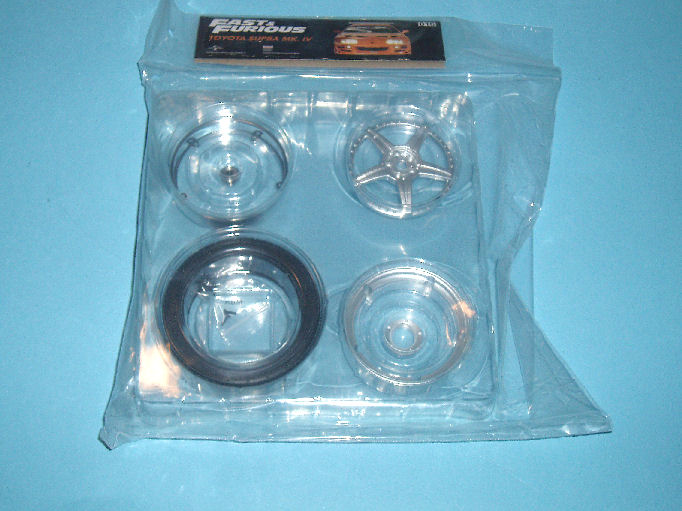

Right front wheel.
Pic 1: NOTE: The printed instructions suggest soaking the tyre 16A in hot water to soften it.
This is not necessary as the wheel parts fit easily enough with the tyre ‘cold’.
Press the wheel rim parts 16B and 16D into the tyre 16A.
Note the direction of the tread pattern in relation to the wheel parts.
Make sure the screw tabs inside are in line.
Pic 2: View from the other side.
Pic 3: Fit the outer rim 16C in place, again making sure the screw fixing tabs and holes are all in line.
Pic 4: From the other side, fix all the parts together with 5 x ABM screws.
Pic 5: Store all parts safely for now.

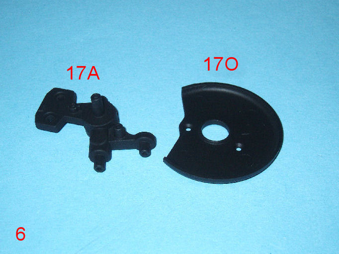

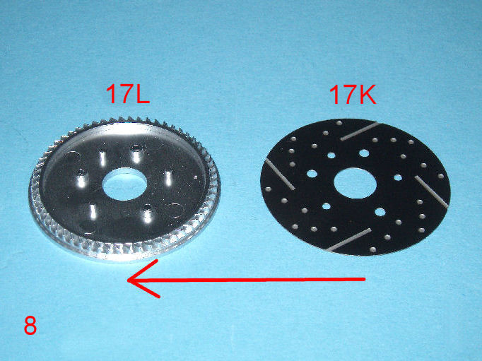

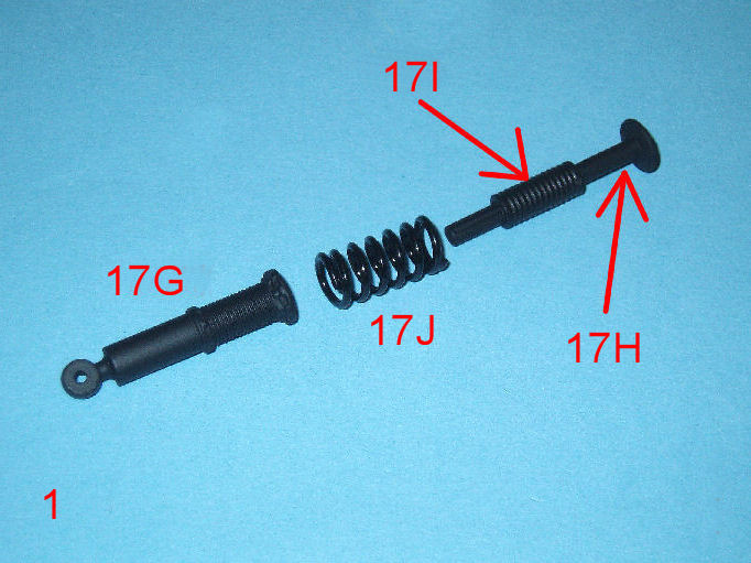

STAGE 17A:

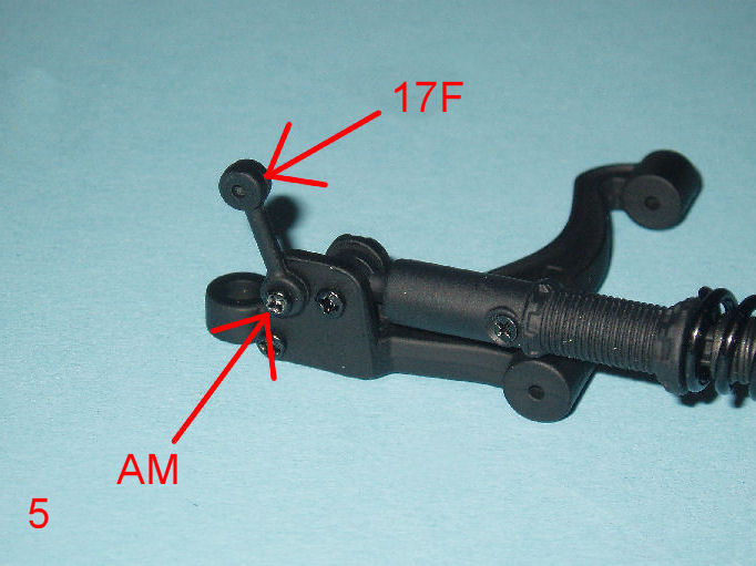

Right front suspension.
Pic 1: Locate the shock absorber parts 17G, 17H, 17I and 17J.

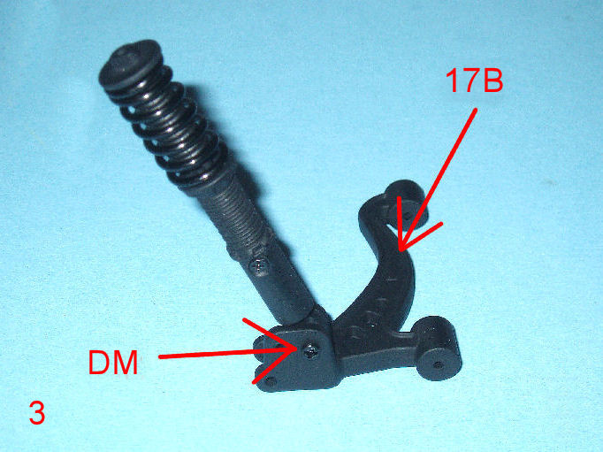

Pic 3: Fit the shock absorber to the lower arm 17 and fix with 1 x DM screw.

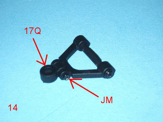

Pic 4: Fit the outer link 17Q as shown and fix with 1 x JM screw.

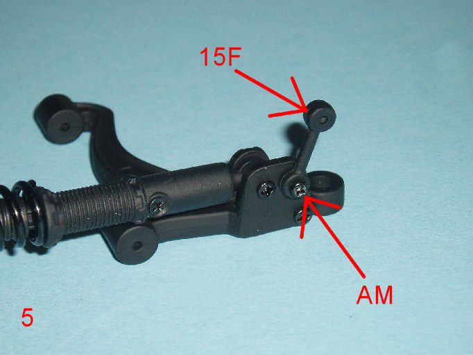

Pic 5: Fit the upper link 17F and fix with 1 x AM screw.

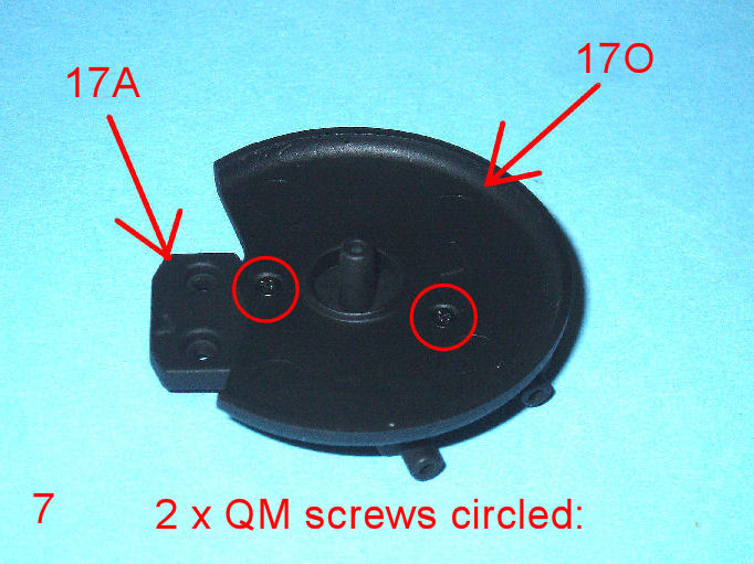

Pic 6: Locate the hub upright 17A and the brake back plate 17O.
Pic 8: Locate the disc parts 17K and 17L.

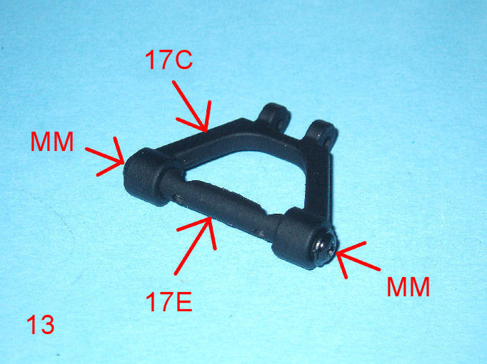

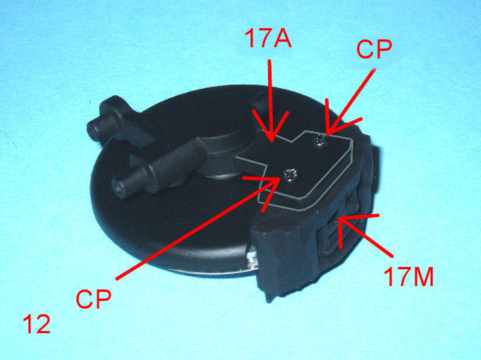

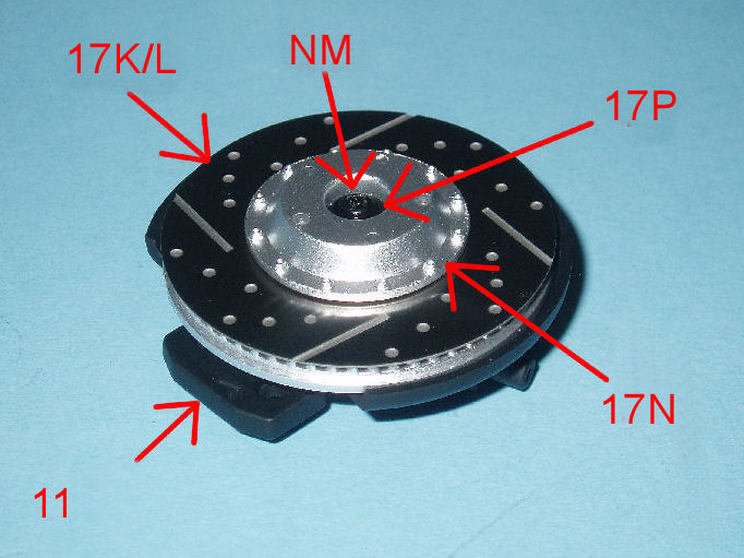

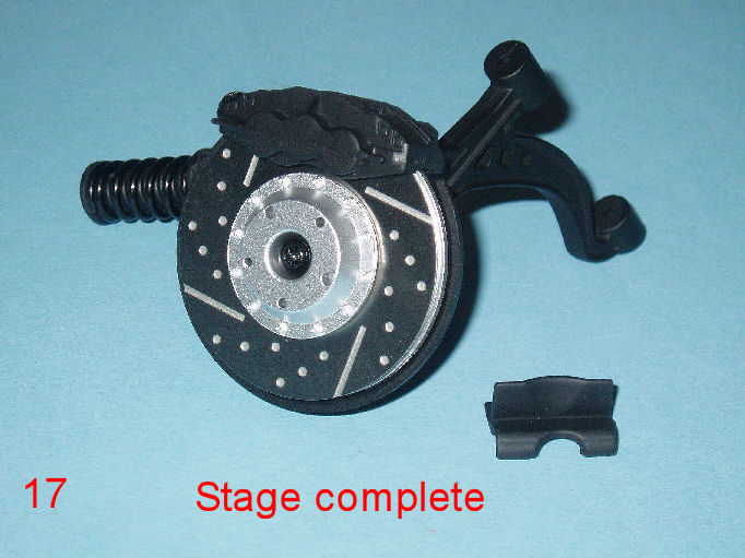

STAGE 17B:

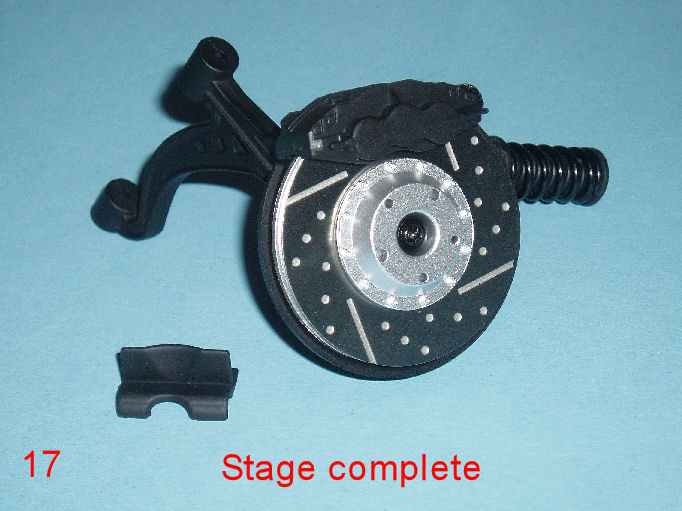

Pic 9: Peel the backing paper from 17L and stick it to the front of 17K, aligning the holes and pins on the parts.

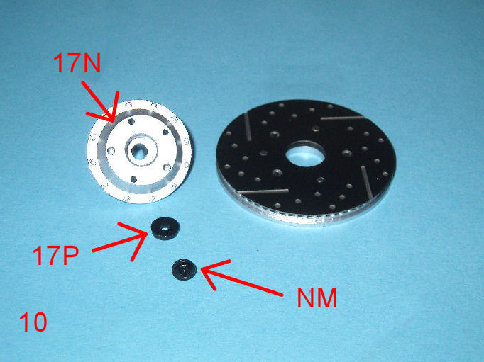

Pic 10: Locate the hub parts 17N and 17P, and 1 x NM screw.
Pic 12: Turn the assembly over and fit the caliper 17M to the upright as shown, fixing it with 2 x CP screws.
Pic 13: Fit the tube 17E into the top link 17C and secure at each end with 1 x MM screw.
Pic 14: Fit the outer link 17Q and fix with 1 x JM screw.
Pic 15: Fit the assembly over the shock absorber and onto the upright as shown. Make sure the top link 17C has the word ‘TOP’ uppermost.
Pic 16: Fit the lower arm 17B to the bottom of the upright 17A and fix with 1 x MM screw.
Pic 17: Store all parts safely for now.

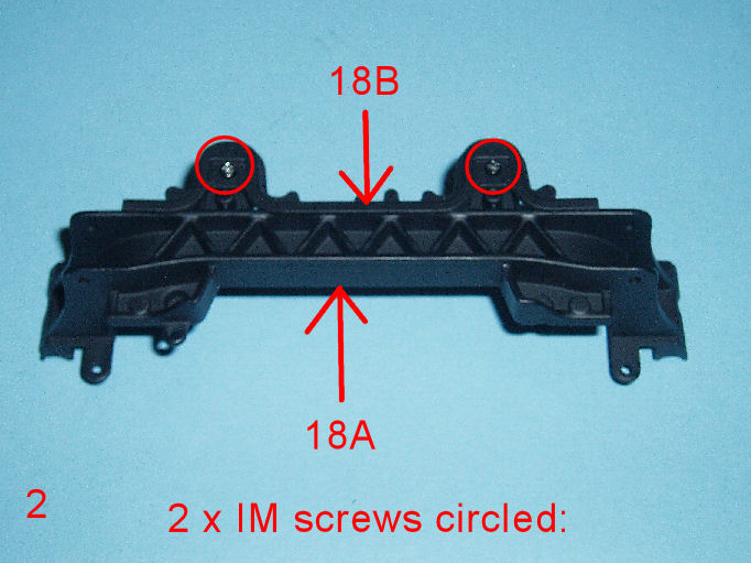

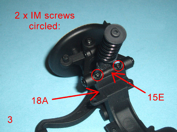

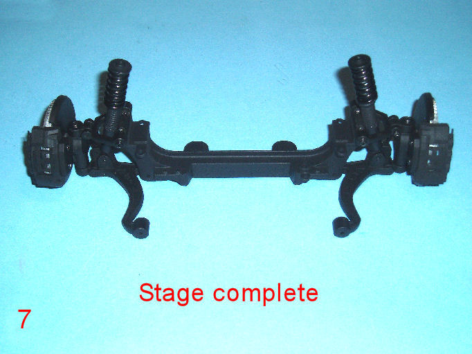

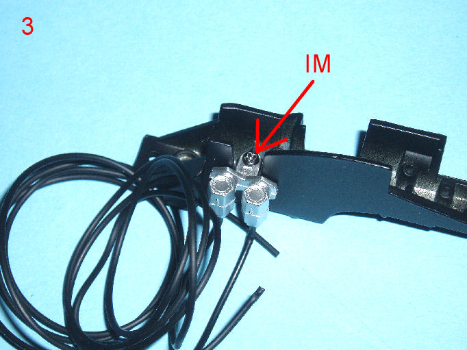

STAGE 18:

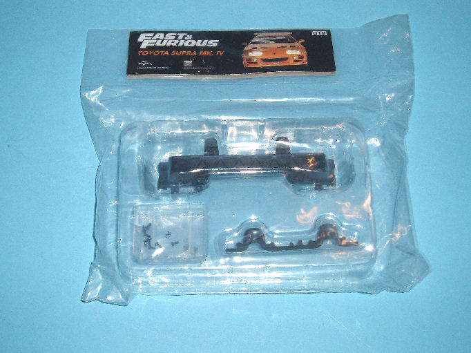

Front cross member.

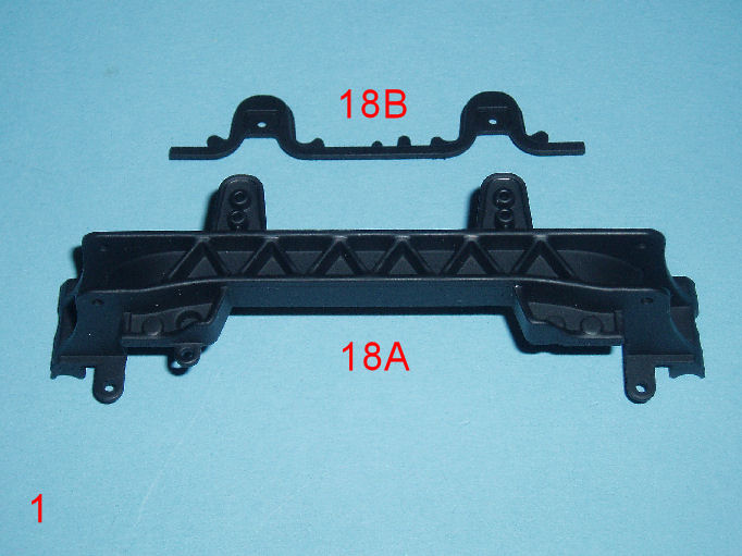

Pic 1: Locate the cross member parts 18A and 18B.

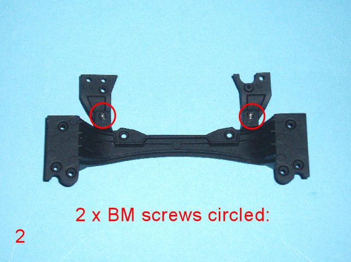

Pic 2: Fit the parts together as shown and fix with 2 x IM screws.

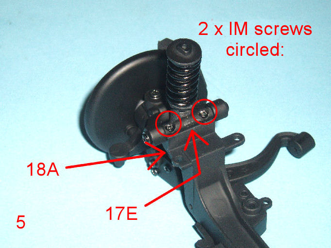

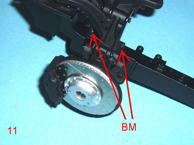

Pic 3: Fit the front left suspension assembly in place as shown and fix with 2 x IM screws.

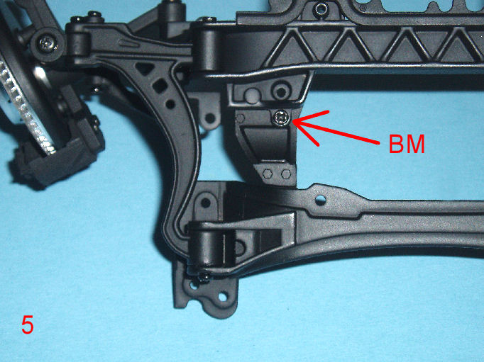

Pic 4: Fit the lower arm in place on the frame as shown and fix with 1 x BM screw from the front.
Pic 5: Repeat with the assembly on the right side, fixing with 2 x IM screws.

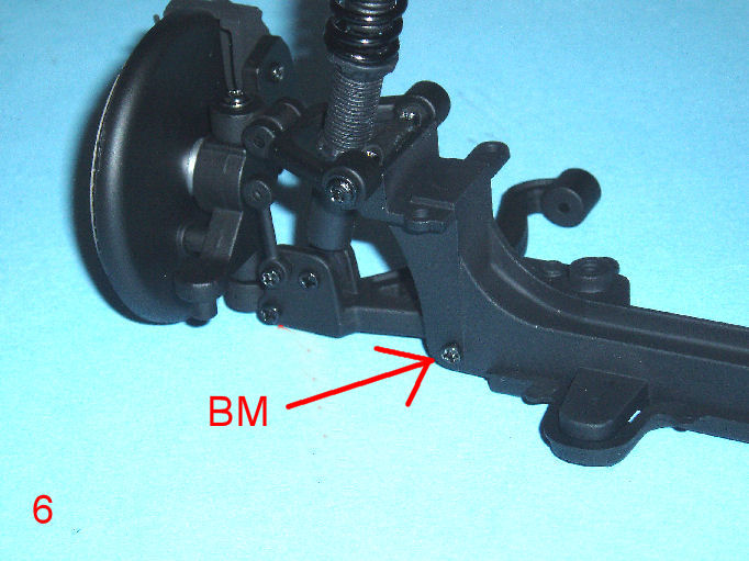

Pic 6: Fit the lower arm in place on the frame as shown and fix with 1 x BM screw from the front.
Pic 7: Store the assembly safely for now.

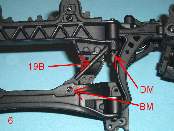

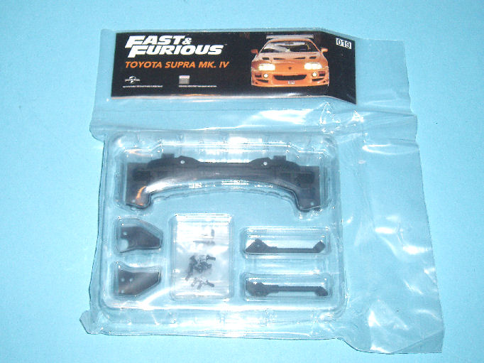

STAGE 19:
Front cross member 2.
Pic 1: Locate the cross member parts 19A, 19D and 19E.
They will fit in the positions shown.
Pic 2: Fit the parts together and fix with 2 x BM screws.
Pic 3: Retrieve the main front cross member and fit the new assembly in place as shown.
Fix with 3 x BM screws where indicated.

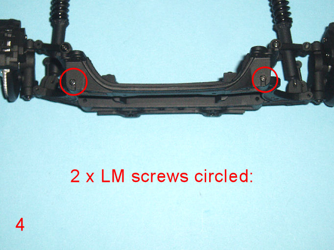

Pic 4: Fit the lower suspension control arms into the frame and fix with 1 x LM screw in each.
Pic 5: From underneath, secure the right cross member with 1 x BM screw.
Pic 6: Fit the angled bracket 19B in place as shown and fix with 1 x DM screw at the front and 1 x BM screw on the cross member.

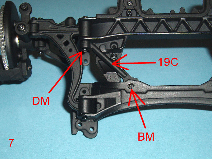

Pic 7: Fit the angled bracket 19C in place as shown and fix with 1 x DM screw at the front and 1 x BM screw on the cross member.
Store the assembly safely.

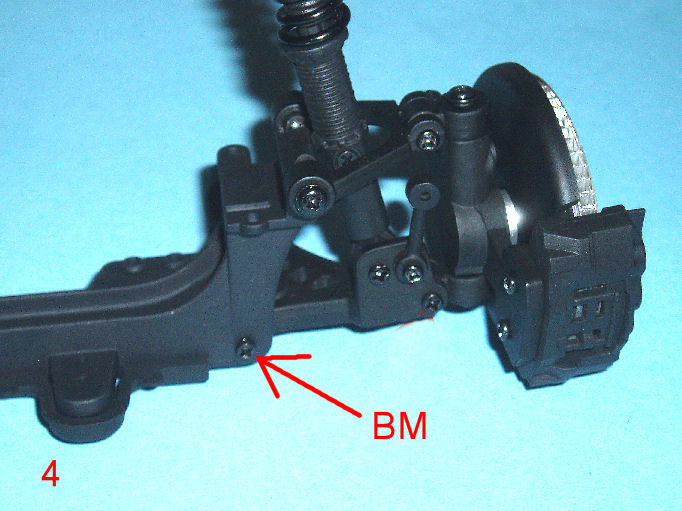

#8 Posted : 13 December 2025 11:03:48
Posts: 5,176
Points: 15,677

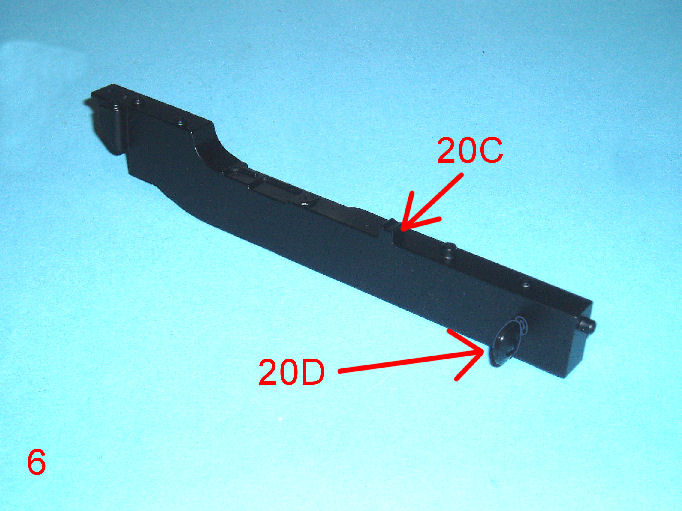

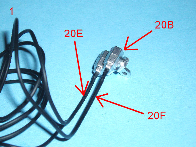

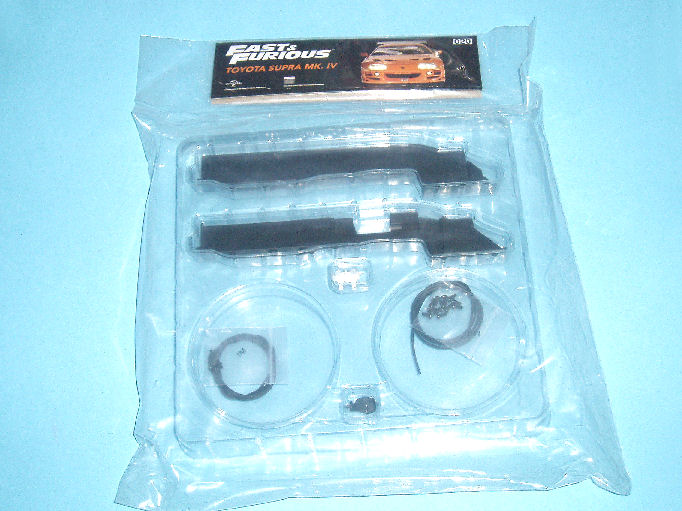

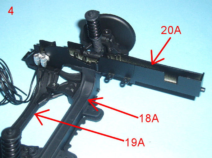

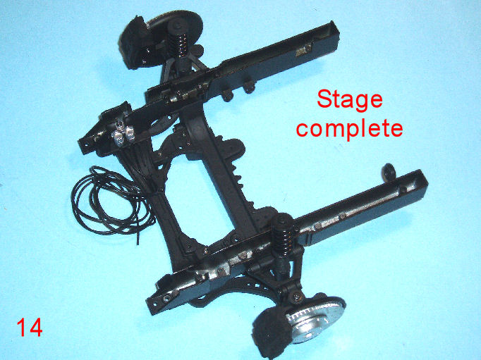

STAGE 20A:
Front side members.

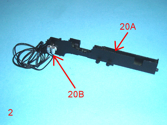

Pic 1: Fit the two lines 20E and 20F to the filters 20B.
Both lines are the same.
Pic 2: Fit the filters to the side member 20A as shown.
Pic 3: Fix the parts using 1 x IM screw.
Pic 4: Retrieve the front cross member assembly and fit the frame 20A in place as shown.
Pic 5: At the front from underneath fix the parts with 3 x BM screws.

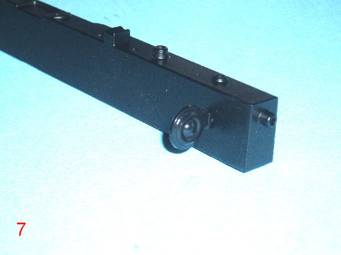

Pic 6: Press-fit the horn 20D into the frame 20C.
Pic 7: Detail of the parts.
#9 Posted : 13 December 2025 11:06:49
Posts: 5,176
Points: 15,677

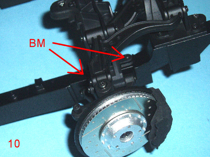

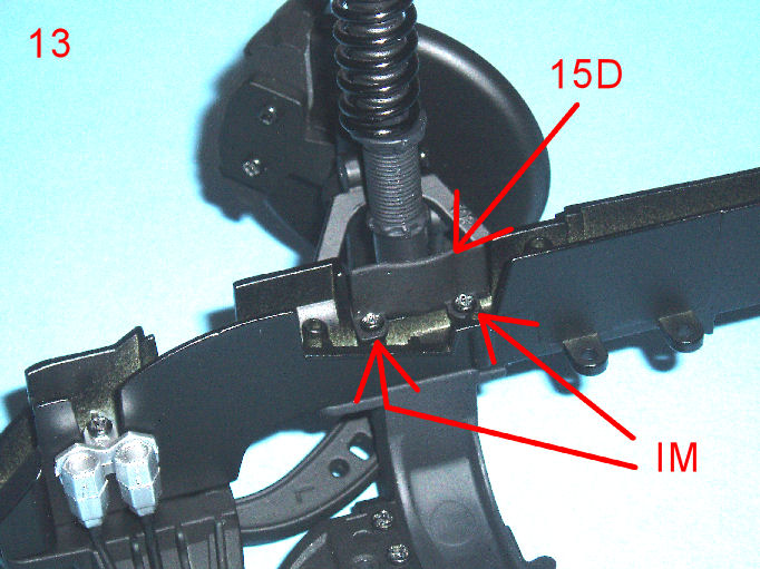

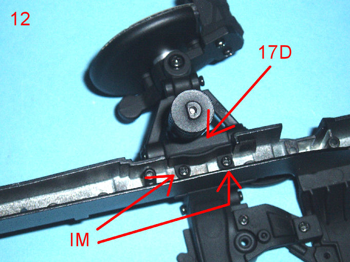

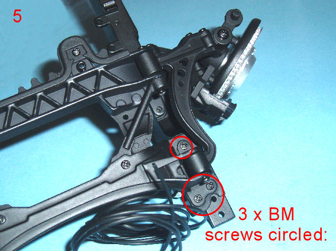

STAGE 20B:

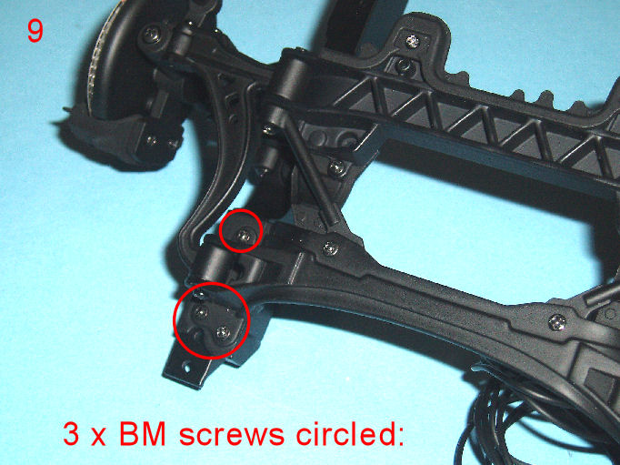

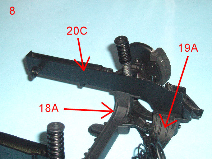

Pic 8: Fit the frame to the other side of the cross members as shown.
Pic 9: At the front from underneath fix the parts with 3 x BM screws.
Pic 10: From underneath, fix the side member with another 2 x BM screws.
Pic 11: From underneath, fix the other side member with 2 x BM screws.
Pic 12: Retrieve the support bracket 17D saved from stage 17 and fit it to the right side frame as shown and fix with 2 x IM screws.
Pic 13: Retrieve the support bracket 15D saved from stage 15 and fit it to the left side frame as shown and fix with 2 x IM screws.
Pic 14: Store the assembly safely.
