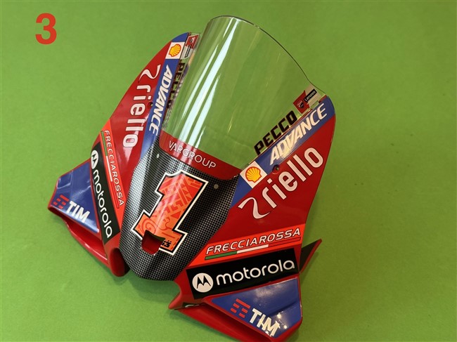

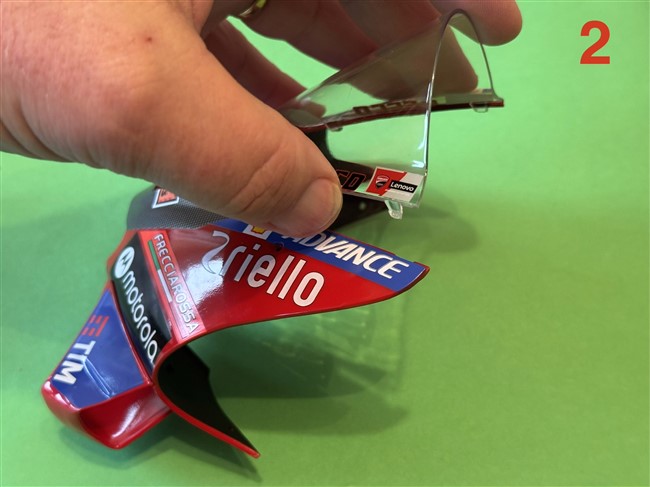

Retrieve the windshield assembly (1A) and attach the windshield upper section (3A). The windshield 3a has 5 tabs that go into the associated recesses on part 1A, picture 2.
Picture 3 shows the complete assembly for this issue.

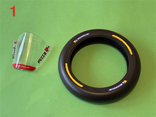

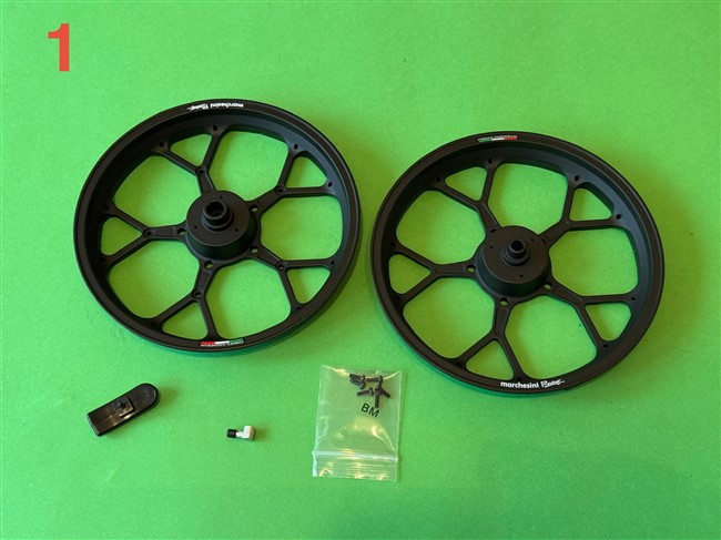

Picture 1 shows the parts for this issue.
Before we start to attach the inner wheel to the tyre, I would recommend warming the tyre in some hot water to soften it. This will make it much easier to attach both inner parts.

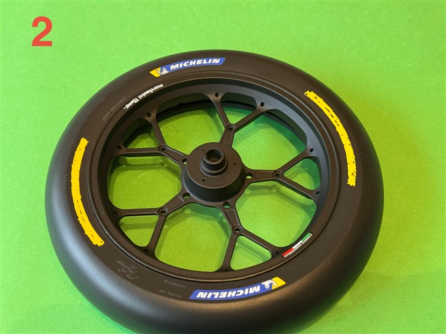

Lay the front tyre down with the side that shows the wording “POWER Slick” facing up, picture 2. Insert the rim (4A) so that the Italian flag on the rim lines up with the “POWER Slick” on the tyre. This is shown much better in picture 4.

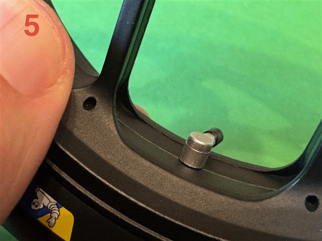

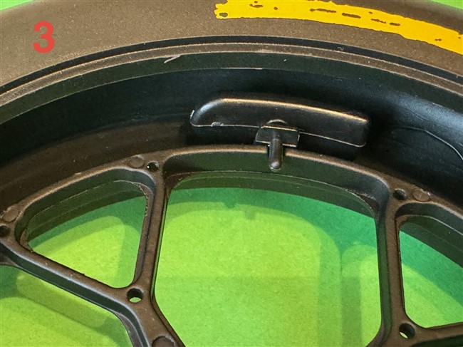

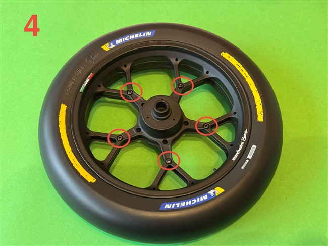

Turn the assembly over and locate the seat for the inflation valve support on the inside of the rim, picture 3. Now place the other rim (4B) aligning the spoke to the other rim. Turn the assembly over again and connect the two rims using 5 x BM screws. Work the screws by applying them opposite to each other until all four screws are in place and tighten each one up a little at a time until all five are tight, picture 4.
Finally, attach the inflation valve by push fitting it in place, picture 5.

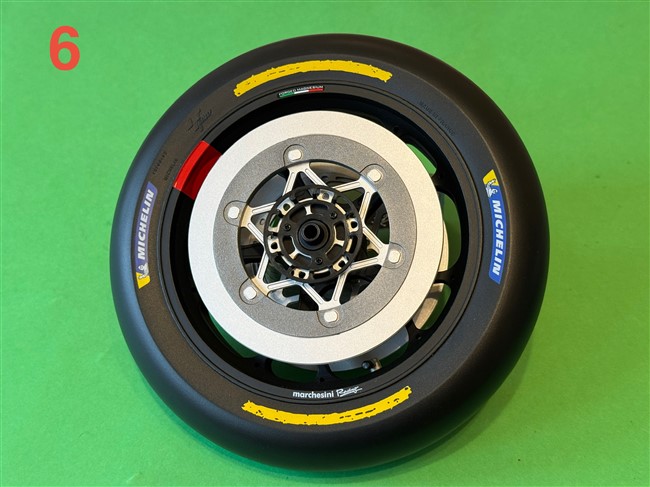

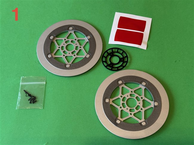

Issue 5

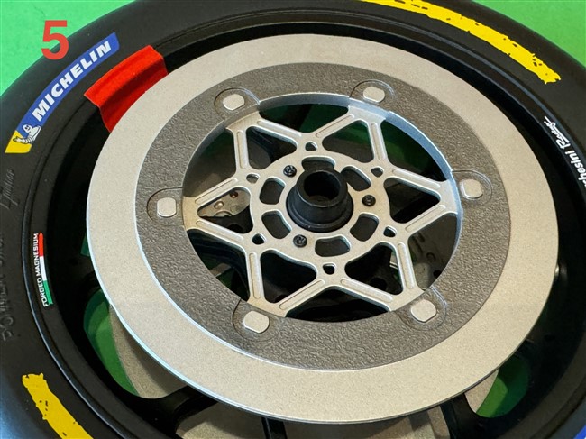

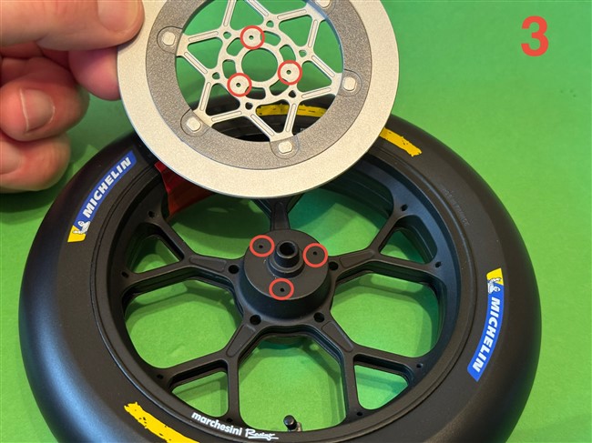

Before we start to with this issue, please note that the labelling of the discs in the parts list is the wrong way around to what is assembled in the different stages. Note 5A should have the smaller central hole than part 5B.
Peel one of the two red stickers and place it on the tyre as illustrated in picture 2.

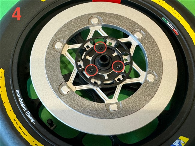

Take the disc (5A) the one with the smaller hole in the centre, picture 3. Line up the three holes to the ones on the rim, Next, place the spacer (5C) over the disc, again lining up the three holes, and secure them both in place using 3 x LM screws, picture 4.
Turn the assembly over and fit the remaining disc (5B) with the larger centre hole, on the rim as before using 3 x LM screws, picture 5.
Picture 6 shows the complete assembly for this issue.
