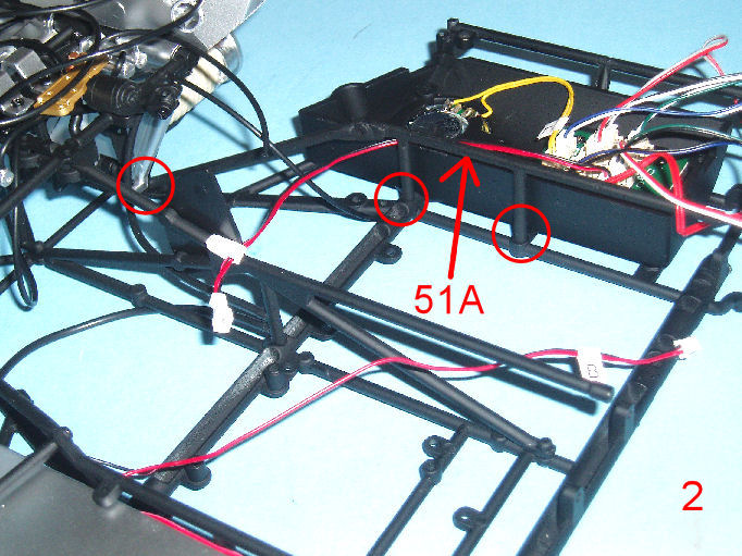

Pic 2: Fit the reinforcing bar 51A to the main frame as shown.
Pic 3: Holding the part in place, turn the model over and fix the parts using 3 x AM screws where indicated.

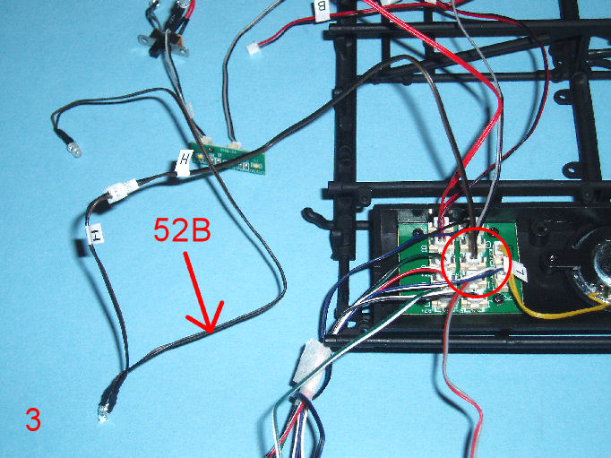

STAGE 52A:
Wiring.

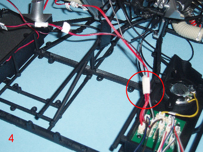

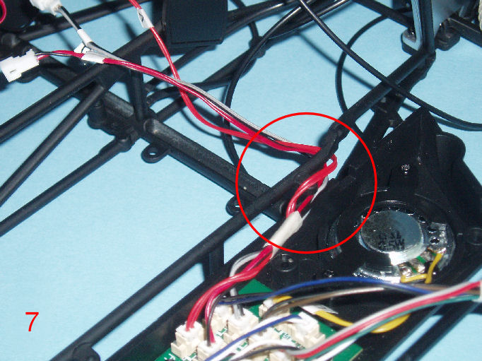

Pic 1: Connect the wire 51C saved from stage 51 to the socket shown on the PCB 52C.
Pic 2: Connect plug ‘G’ to the socket ‘G’ on the main PCB.
Pic 3: Locate wire 52B (‘H’) and connect the plug to socket ‘H’ on the main PCB.
Pic 4: Gather together the wires ‘A’, ‘B’ and ‘G’.
Tape them together with masking tape as shown for now.

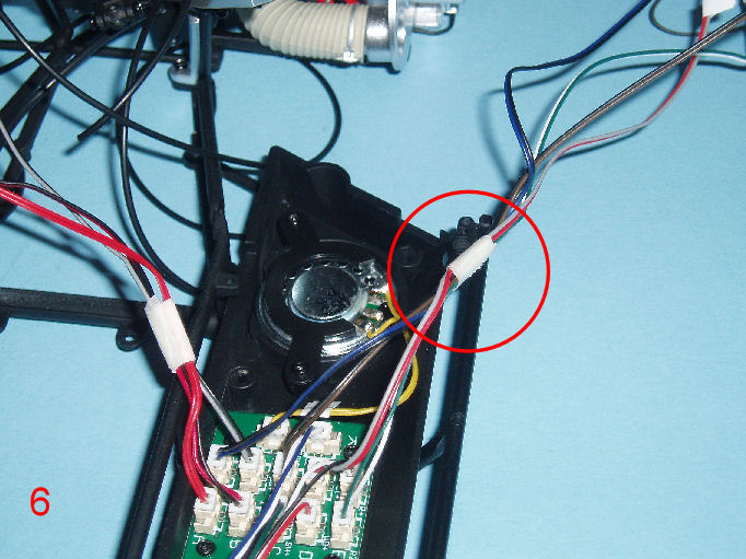

Pic 5: Gather together the wires ‘C’, ‘D’, ‘J’ and ‘K’.
Pic 6: Gather together the wires ‘E’, ‘F’, ‘H’ and ‘I’.

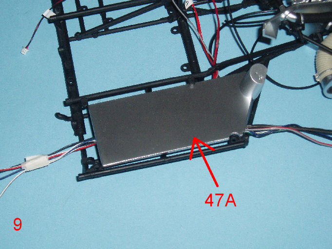

STAGE 52B:
Pic 7: Pass the first set of wires ‘A’, ‘B’ and ‘G’ through the frame as shown.
Pic 8: Feed the other sets of wires out of the tank in the slots as shown.
Pic 9: Fit the tank lid 47A in place.

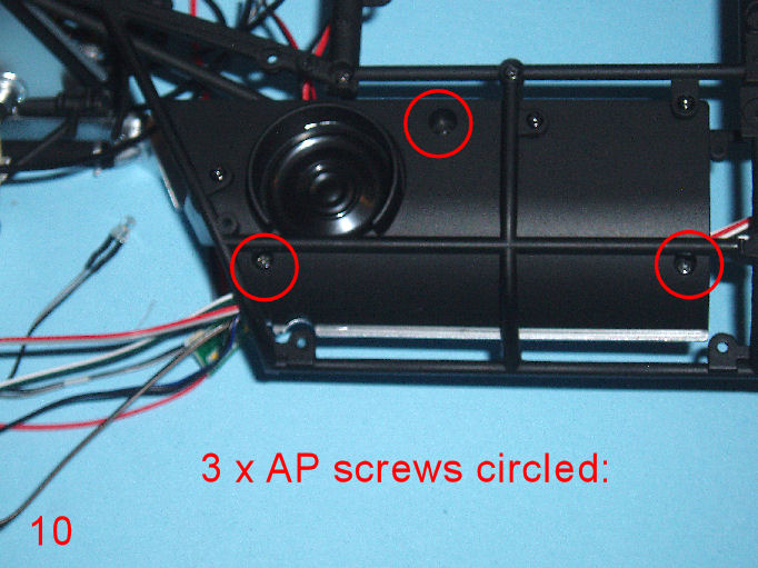

Pic 10: Fix from underneath with 3 x AP screws

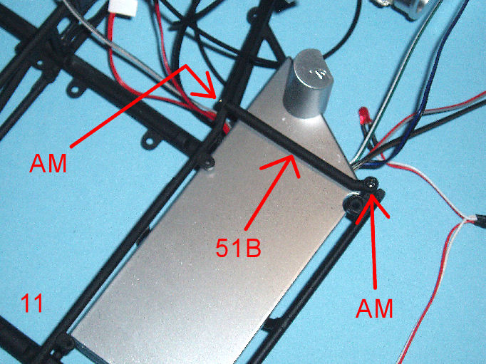

Pic 11: Fit the cross-bar 51B saved from stage 51 in place as shown and fix with 1 x AM screw at each end.
You can now re-test all functions again if you wish.
Store the model safely for now.

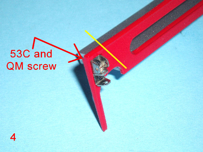

Pic 1: Fit the 2 x clips 53C to either side or the rear frame 53A, using the lower pairs of holes. Note the clips are sideways with the longer sloping sides inside.
Fix with 1 x QM screw in each.

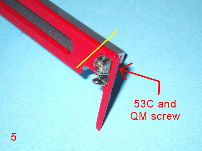

Pic 4: Fit the 2 x clips 53C to either side or the rear frame 53A, using the upper pairs of holes. Note the clips are vertical with the longer sloping sides at the top.
Pic 5: Detail of the right side.

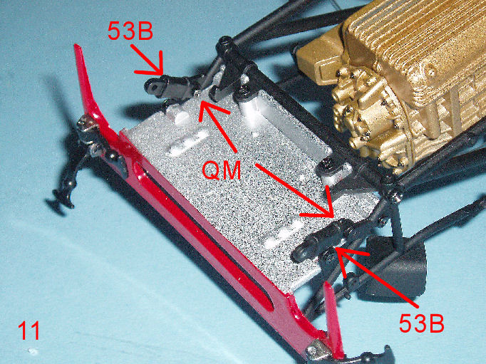

Pic 11: Fit the 2 x brackets 53B to the panel as shown and fix from the inside using 1 x QM screw in each.

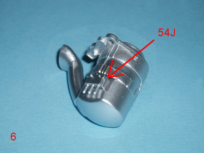

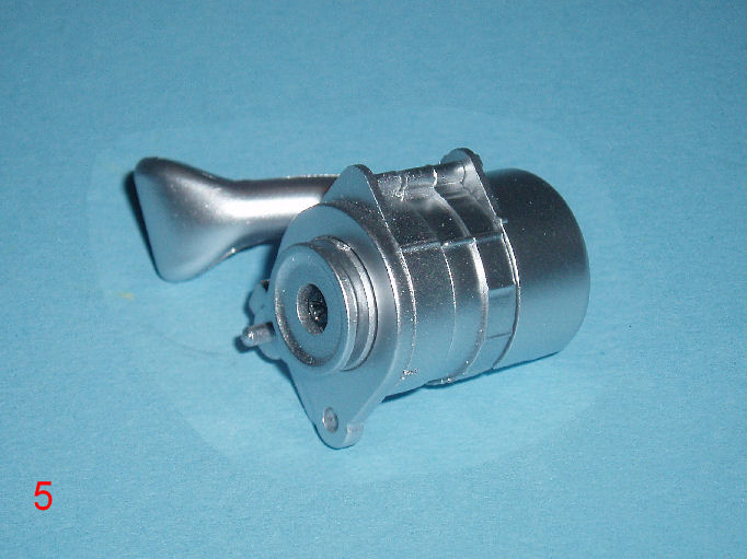

Pic 1: Fit the two alternator air intake parts 54F and 54G together.

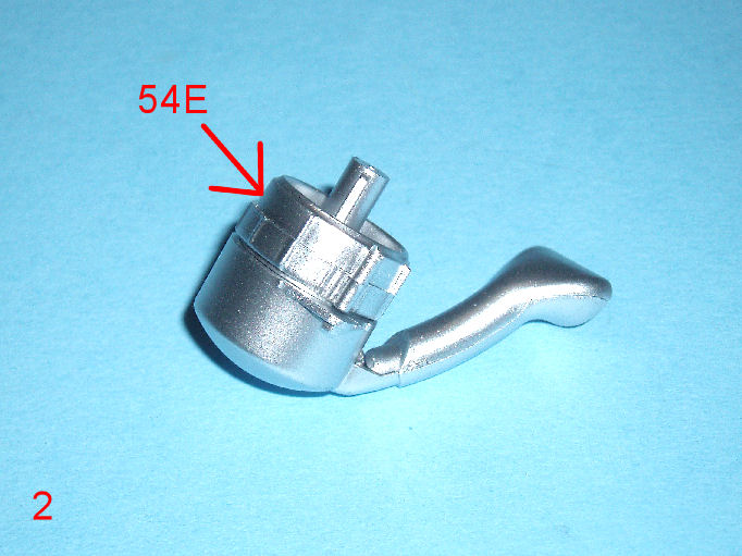

Pic 2: Fit the alternator body 54E as shown.
Pic 3: Fit the alternator base 54 D in place.
It will only fit one way.
Pic 4: Locate the pulley parts 54I and 54H, and 1 x AP screw.
Pic 5: Fix the parts together as shown.
Pic 6: Fit the connector 54J in place.
You might find it to be a loose fit so you may wish to use some adhesive.
This is at the builder’s discretion.

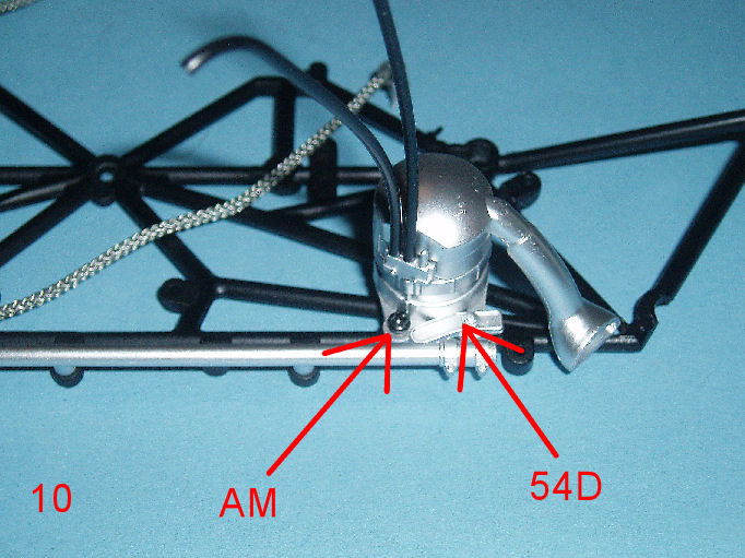

Pic 10: Fit the alternator assembly to the frame and fix with 1 x AM screw.

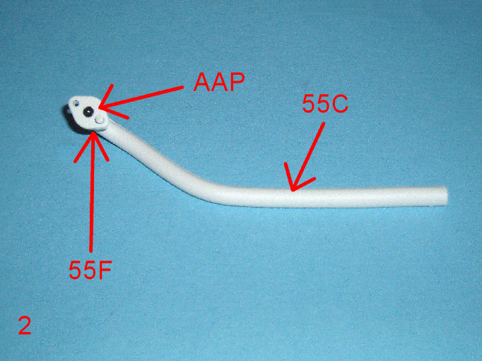

STAGE 55:
Left exhaust.

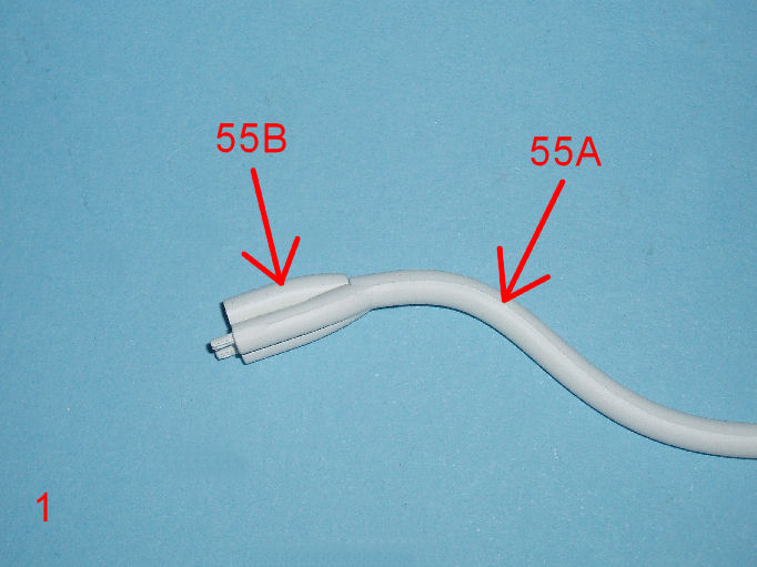

Pic 1: Press-fit the exhaust parts 55A and 55B together.
Pic 2: Fit the flange bracket 55F onto pipe 55C at the angle shown.
Fix with 1 x AAP screw.

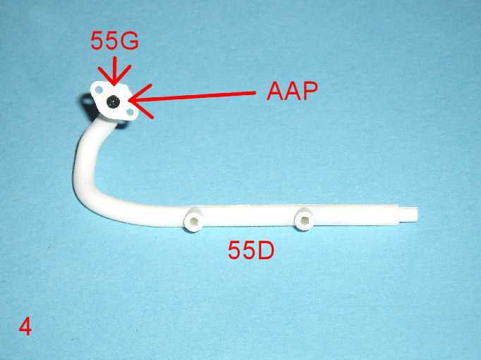

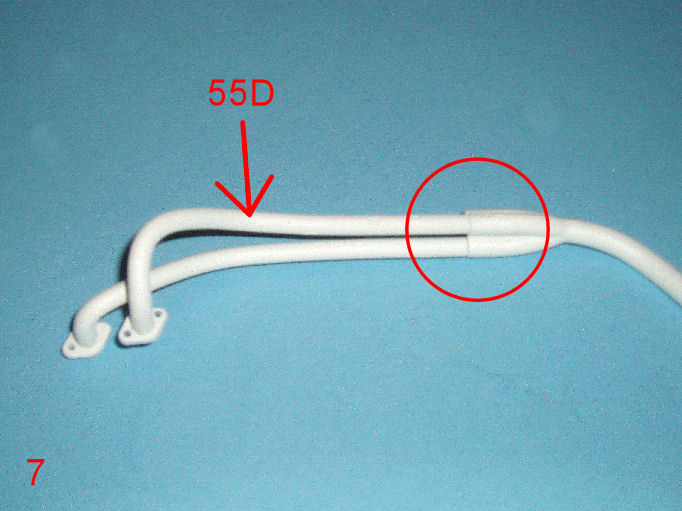

Pic 4: Fit flange 55G to pipe 55D as shown and fix with 1 x AAP screw.
Pic 5: Fit flange 55G to pipe 55E as shown and fix with 1 x AAP screw.
Pic 6: Press-fit pipe 55C onto the lower pin on pipe 55A as shown.
Pic 7: Press-fit pipe 55D onto the upper pin on pipe 55A as shown.
Pic 8: Press-fit pipe 55E into the hole in the end of 55A.
NOTE: The printed instructions incorrectly show 55E to go behind the other two pipes.
It must go between them as indicated otherwise the exhaust will not fit onto the engine later on.

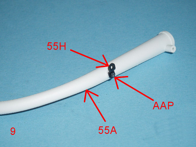

Pic 9: Fit the small bracket 55H to pipe 55A as shown and fix with 1 x AAP screw.

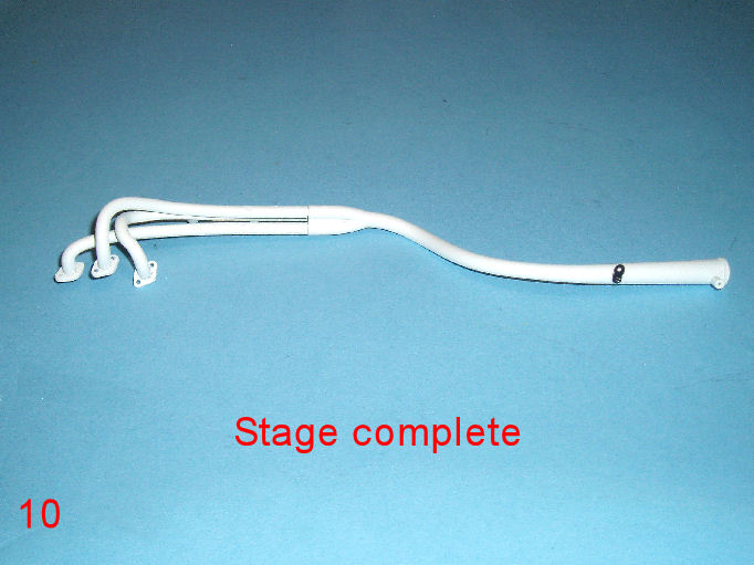

Pic 10: Store safely for now.

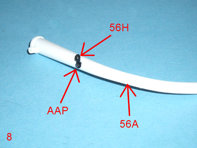

Right exhaust.
Pic 1: Press-fit the exhaust parts 56A and 56B together.
Pic 2: Fit the flange bracket 56F onto pipe 56C at the angle shown.
Flange 56F is identified by having a pin on its face.

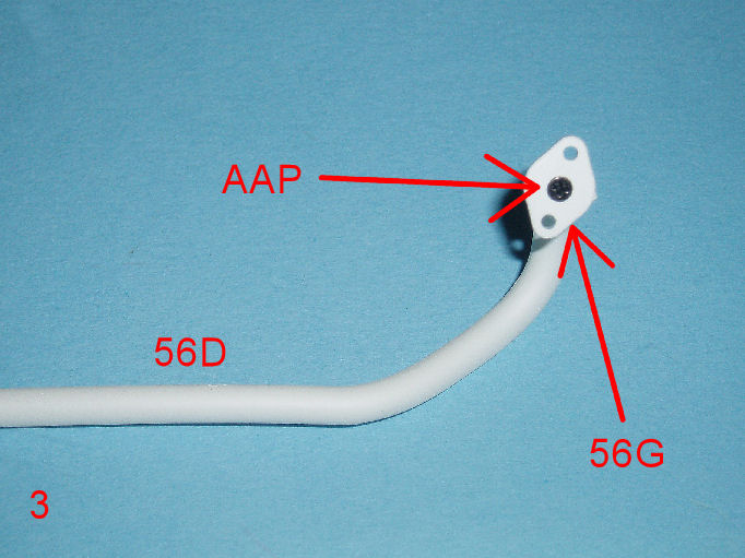

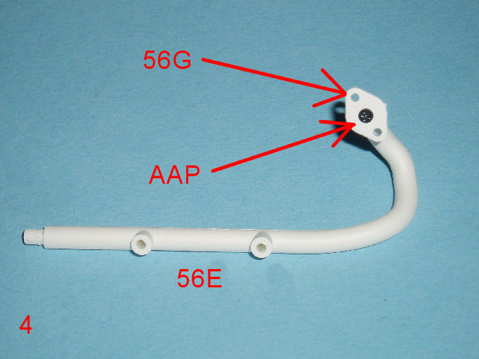

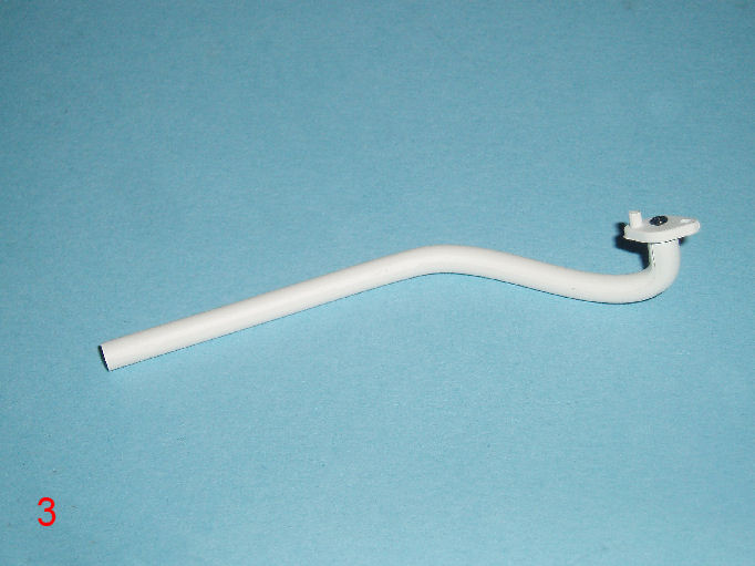

Pic 3: Fit flange 56G to pipe 56D as shown and fix with 1 x AAP screw.
Pic 4: Fit flange 56G to pipe 56E as shown and fix with 1 x AAP screw.

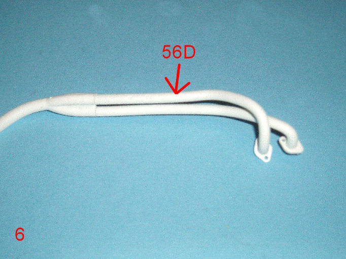

Pic 5: Press-fit pipe 56C onto the lower pin on pipe 56A as shown.
Pic 6 Press-fit pipe 56D onto the upper pin on pipe 56A as shown.
Pic 7: Press-fit pipe 56E into the hole in the end of 56A.
Pic 8: Fit the small bracket 56H to pipe 56A as shown and fix with 1 x AAP screw.
Pic 9: Store safely for now.
