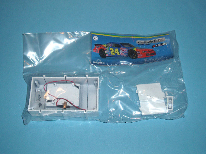

STAGE 45:
Battery box.

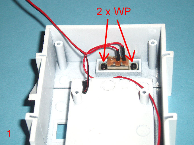

Pic 1: Locate the battery box 45A and fit the switch in place inside.
Note that the two red wire connections are on the right.
Fix the switch with 2 x WP screws.

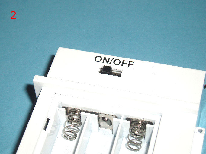

Pic 2: From the other side, the switch should be in the ON position.

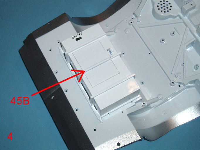

Pic 4: From the other side, fit the cover 45B in place.

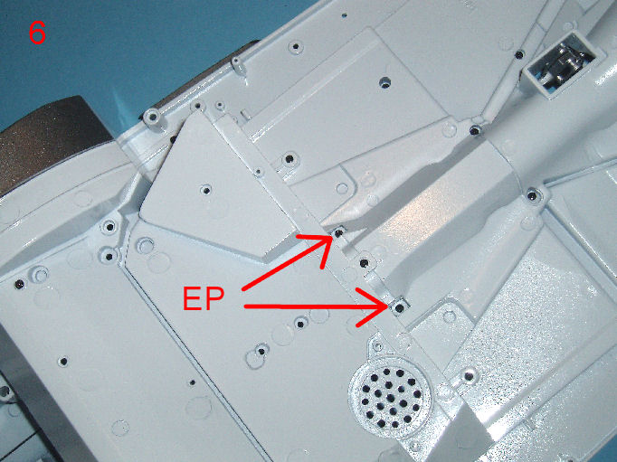

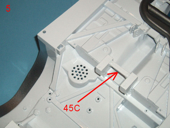

Pic 5: Fit the rear cross member 45C in place as shown.
Pic 6: From the other side, fix with 2 x EP screws.
Store the model safely.

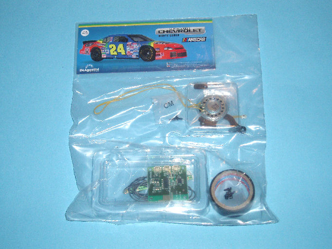

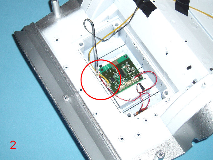

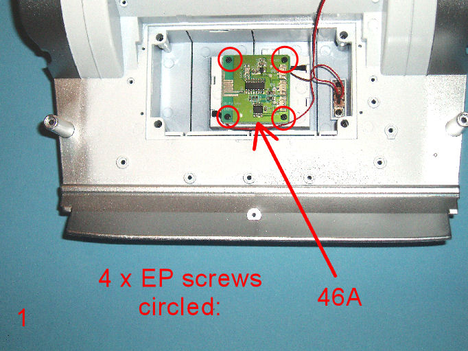

STAGE 46:
PCB and speaker.

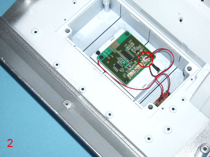

Pic 1: Fit the PCB 46A into the battery box in the position shown.
Fix with 4 x EP screws.

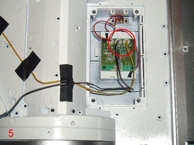

Pic 2: Connect the on/off switch wire to the socket indicated.

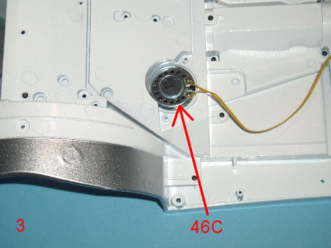

Pic 3: Position the speaker 46C as shown on the floor of the car.

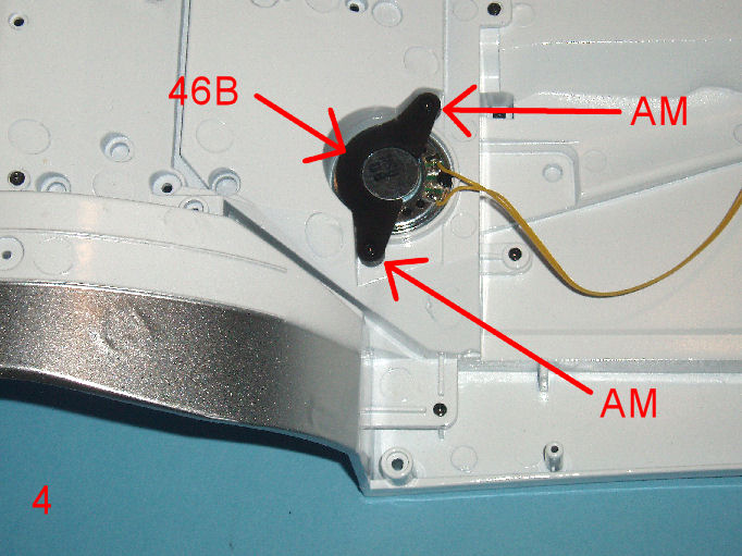

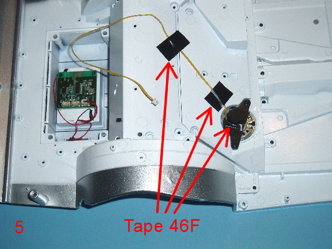

Pic 4: Fit the retaining bracket 46B and fix with 2 x AM screws.
Pic 5: Carefully fold the yellow wires back over the speaker and tape it down in the positions shown using pieces of 46F tape.

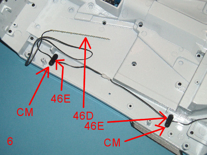

Pic 6: Fit the LED wire 46D along the side of the floor as shown and fix it down using 2 x brackets 46E and 2 x EM screws.
The white connectors on the wires should be central between the brackets.
Pic 7: Fit the yellow and grey wires side by side and tape them as shown with a piece of 46F tape.
Store the model safely for now.

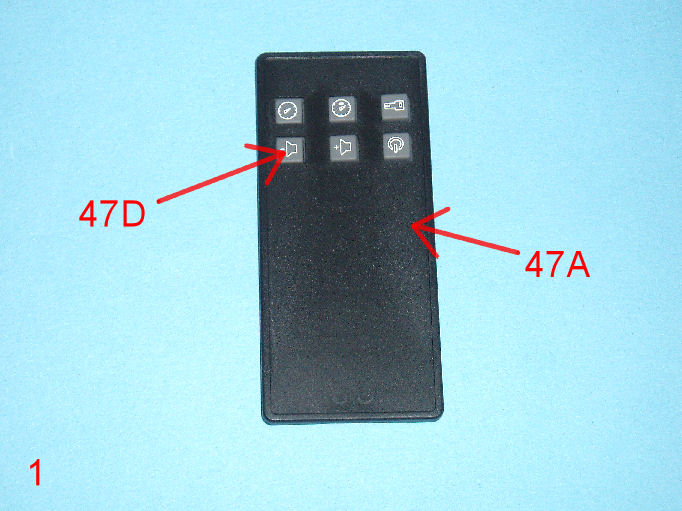

Remote control.

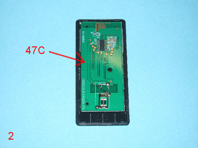

Pic 1: Fit the rubber pad 47D inside the casing 47A as shown.
Pic 2: Fit the control board 47C inside the casing.
It will only fit one way.
Pic 3: Clip the rear cover 47B onto the casing.

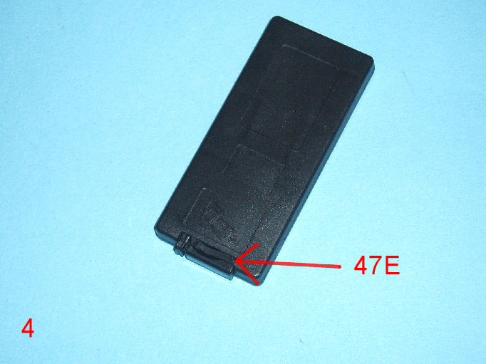

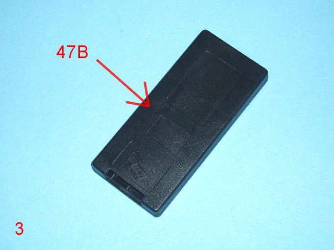

Pic 4: Fit the battery holder 47E into the casing as shown.
Pic 5: Connect the yellow and grey wires to the correct sockets on the PCB as shown.

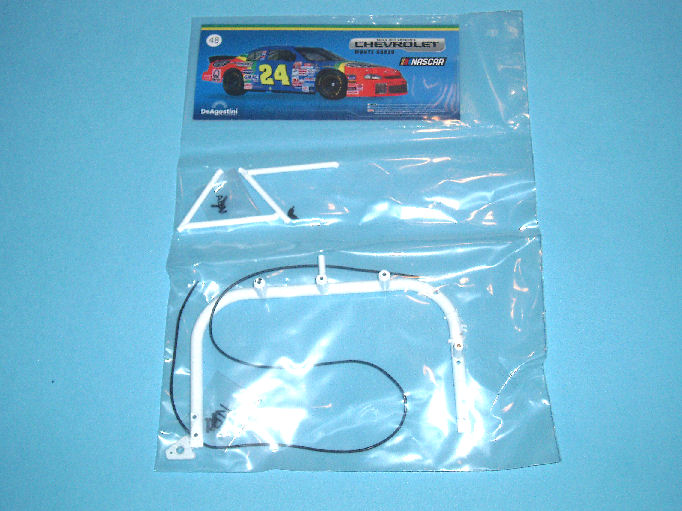

STAGE 48A:
Rear subframe loop.

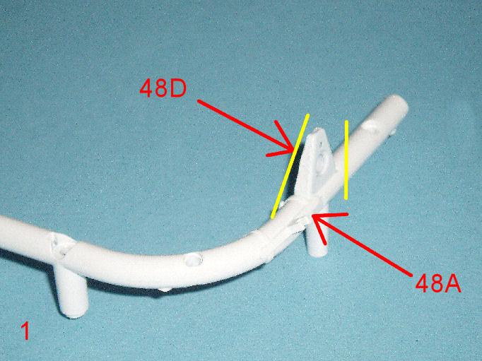

Pic 1: Fit the bracket 48D to the subframe 48A.
Note that the sloping side should be on the inside if the frame.

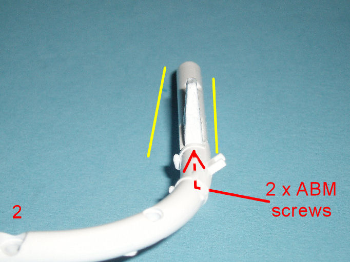

Pic 2. Another view showing the angle of 48D. Fix from the other side with 2 x ABM screws.

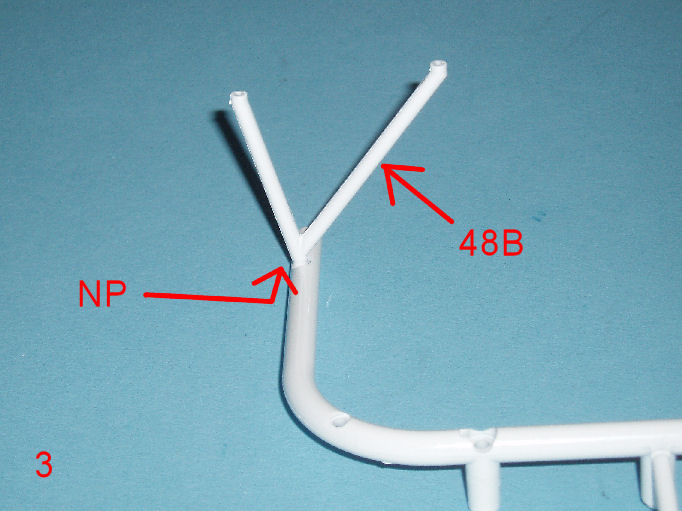

Pic 3: Fit the brace 48B on the frame side as shown with the longer leg inwards.

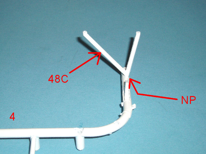

Fix from underneath with 1 x NP screw.
Pic 4: Fit the brace 48C on the frame side as shown with the longer leg inwards.

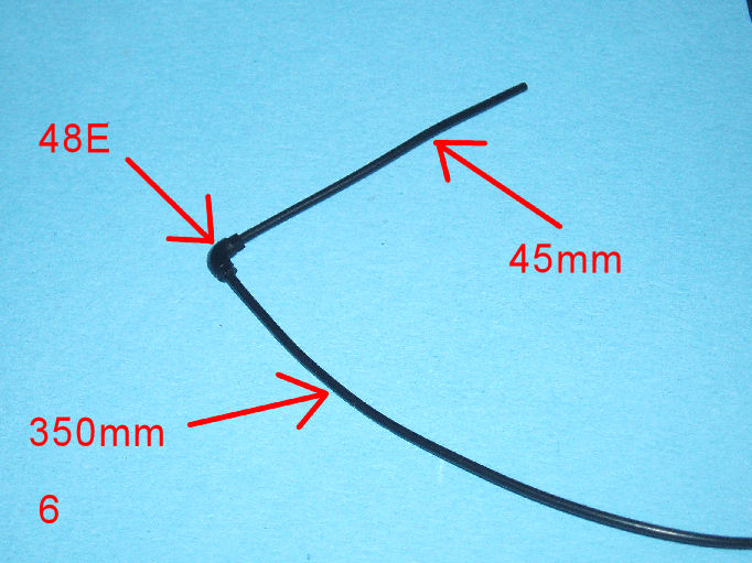

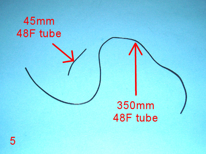

Pic 5: Cut the tube 48F into two lengths: 45mm and 350mm.
Pic 6: Fit the coupling 48F to the tubes as shown.

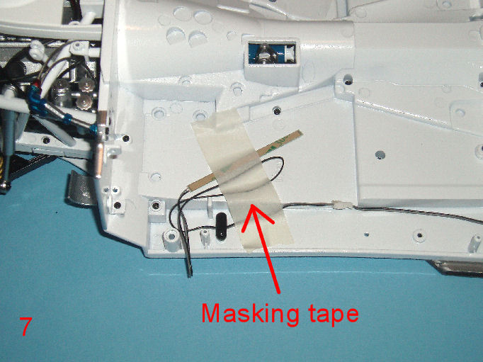

Pic 7: It would be advisable to tape the LED strip on the main assembly using a piece of masking tape to prevent it falling away when the model is turned over.
This is at the builder’s discretion.

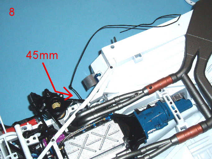

Pic 8: With the model upside down, fit the 45mm piece of tube to the pin on the brake reservoir 41B.

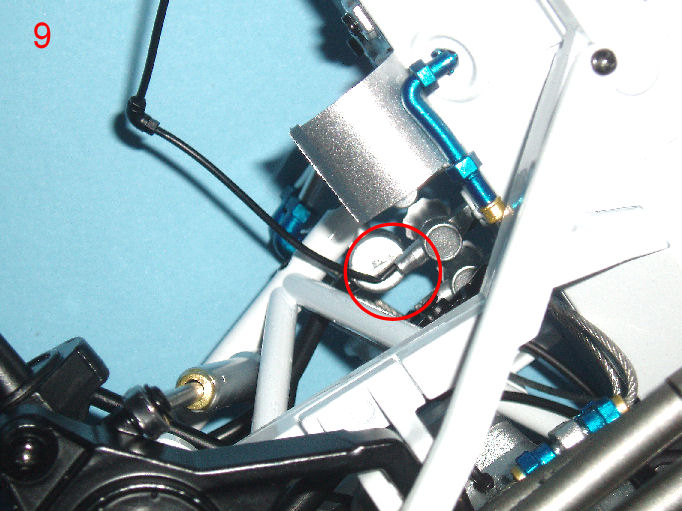

Pic 9: Shows where the pipe connects.

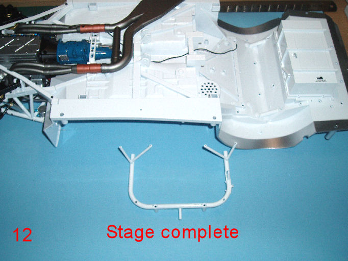

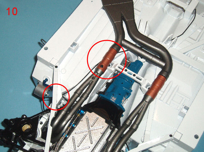

Pic 10: Feed the 350mm piece of tube up through the frame and under the exhaust.
Pic 11: Feed the pipe under the cross-members as shown.
Pic 12: Store the model and parts safely for now.

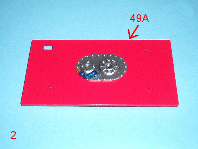

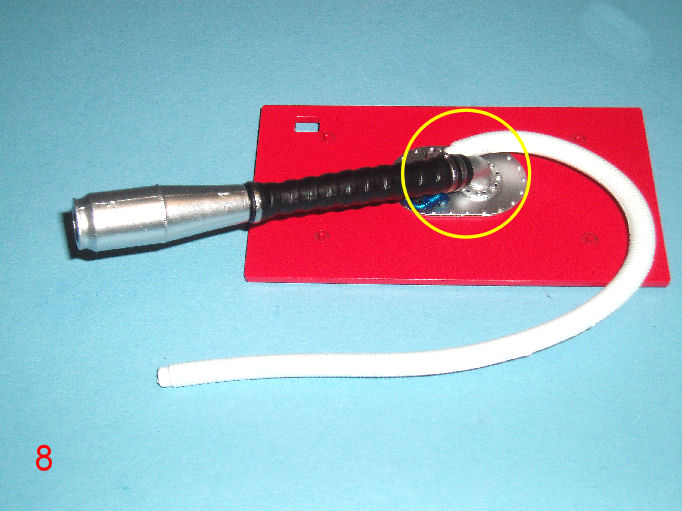

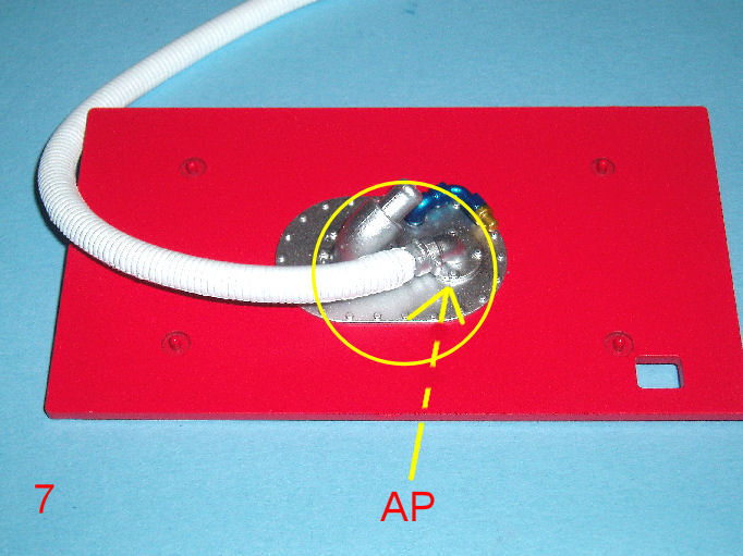

STAGE 49:
Fuel cell and hoses.

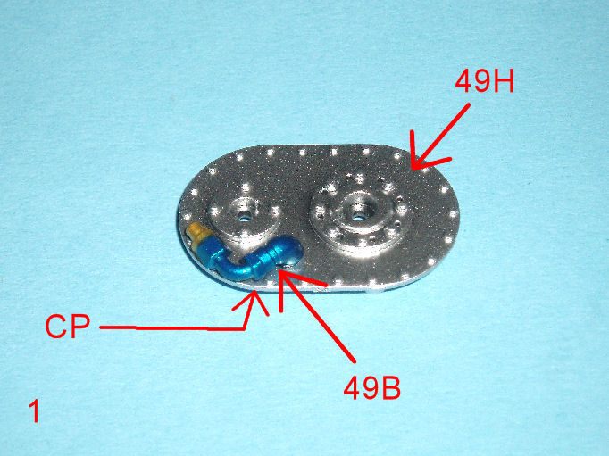

Pic 1: Fit the connector 49B to the top plate 49H and fix from underneath with 1 x CP screw.
Pic 2: Fit the assembly to the top plate 49A as shown.
Pic 3: Fix from underneath with 3 x AP screws.

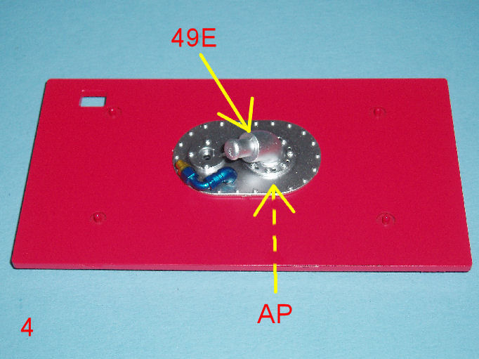

Pic 4: Fit the filler elbow 49E as shown and fix from underneath with 1 x AP screw.

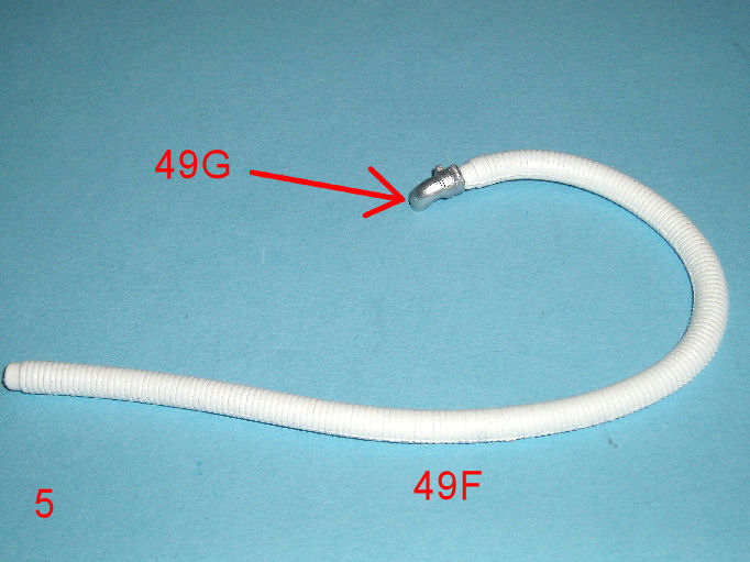

Pic 5: fit the elbow 49G to the end of the hose 49F.

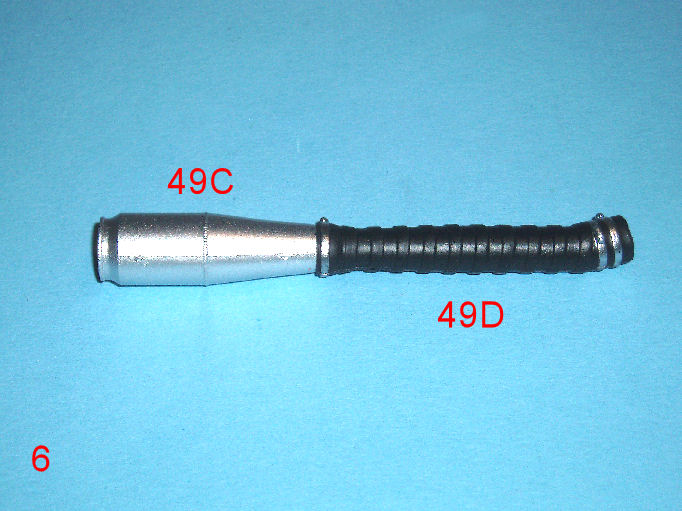

Pic 6: Fit the filler neck parts 49C and 49D together as shown.
Pic 7: Fit hose connector 49G to the top plate as shown and fix from underneath with 1 x AP screw.
Pic 8: Press-fit the filler pipe assembly in place as shown.

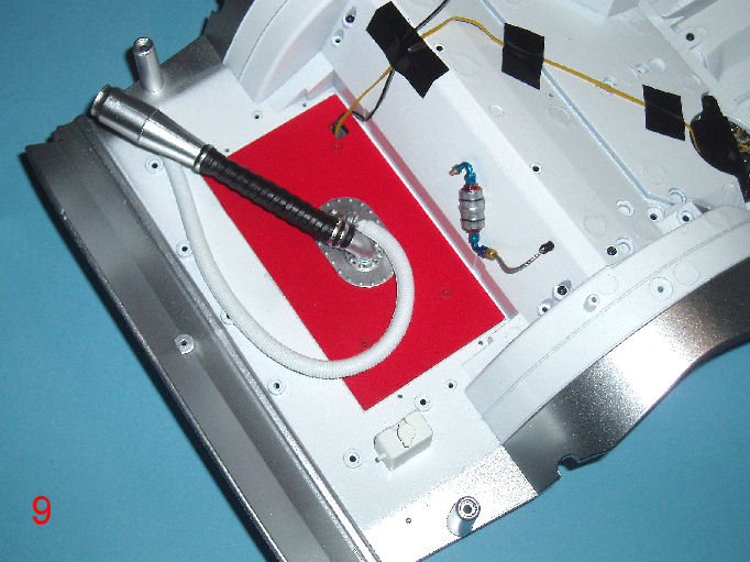

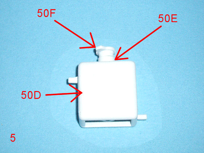

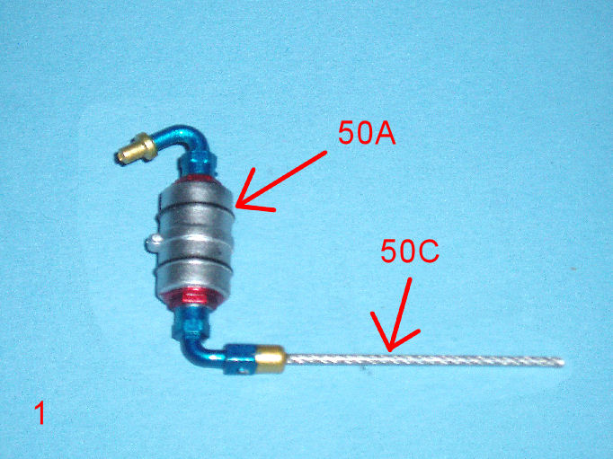

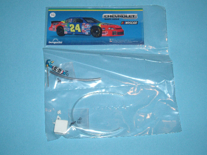

STAGE 50A:
Fuel filter.

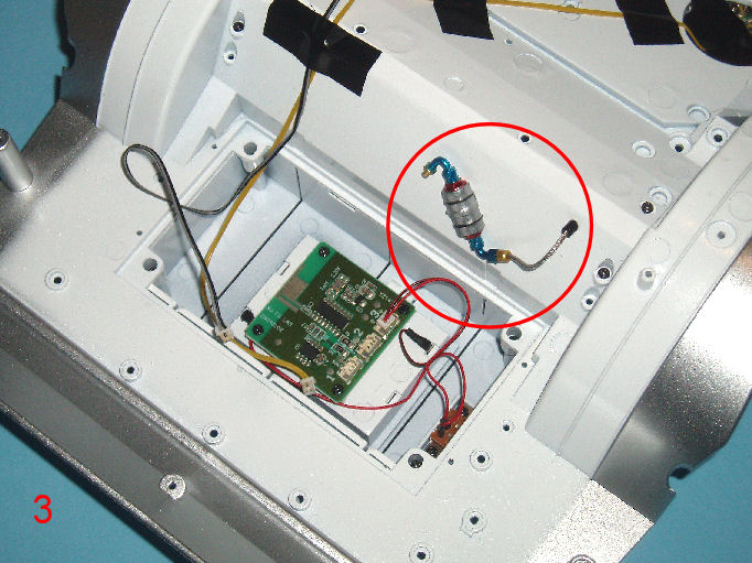

Pic 1: Fit the hose 50C to the filter 50A as shown.
Pic 2: Retrieve the main assembly and unplug the yellow and black wires from the PCB.
Pic 3: Fit the fuel filter to the axle housing wall as shown and feed the braided hose into the black fitting on the wall.
Pic 4: Fix the filter with 1 x AP screw from the other side.

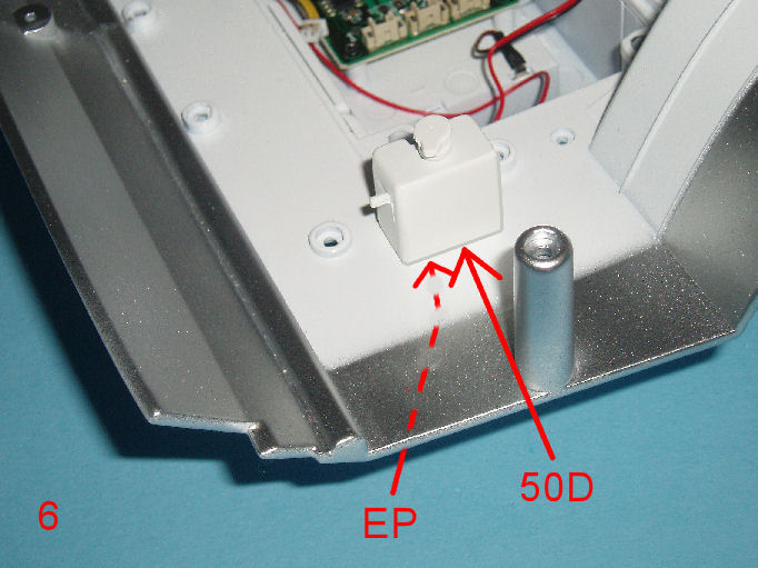

Pic 5: Assemble the overflow reservoir parts 50D, 50E and 50F as shown.

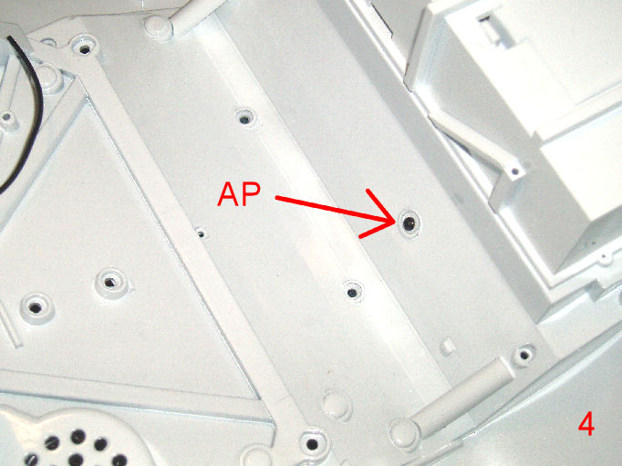

Pic 6: Fit the reservoir to the floor as shown and fix from underneath with 1 x EP screw.
#8 Posted : 07 December 2025 12:00:15
Posts: 5,176
Points: 15,677
STAGE 50B:

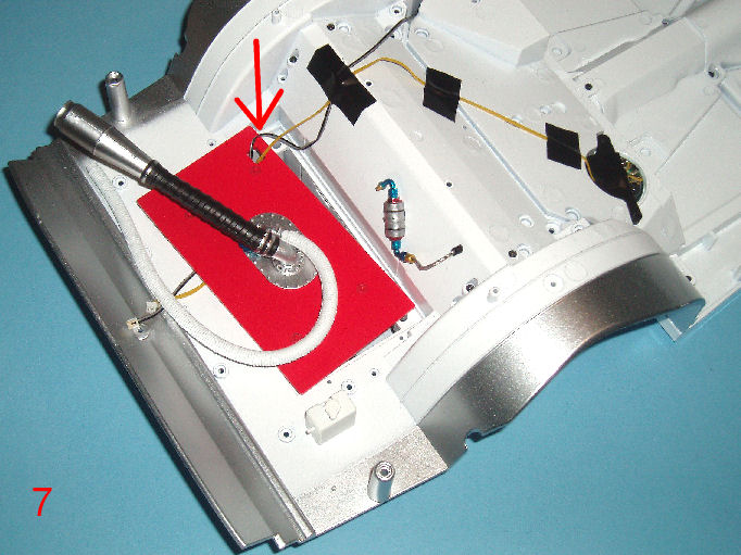

Pic 7: Pass the yellow and black wires through the hole in the upper left of the tank cover.

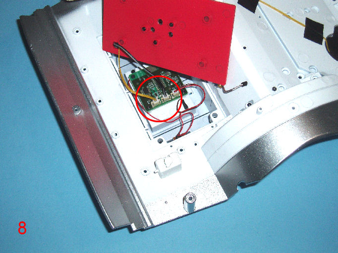

Pic 8: Reconnect the plugs to their respective sockets.
Pic 9: Fit the tank cover in place as shown.

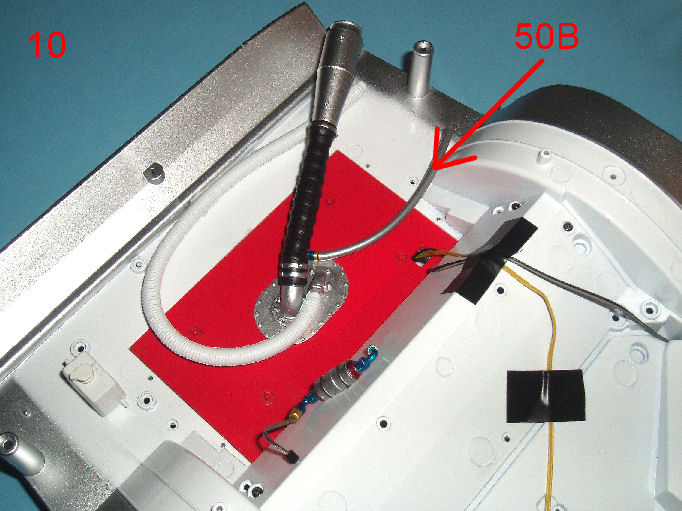

Pic 10: Fit the silver hose 50B to the end of the blue connector.

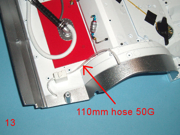

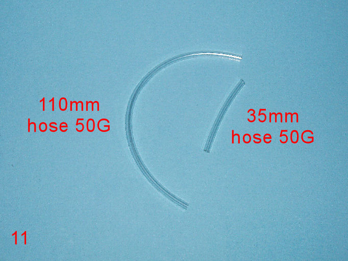

Pic 11: Cut the clear pipe 50G into two lengths:
35mm.
110mm.
Pic 12: Fit the short 35mm hose to the reservoir and floor as shown.
Pic 13: Fit one end of the longer 110mm hose to the pin on the other side of the reservoir.
The other end remains free for now.
