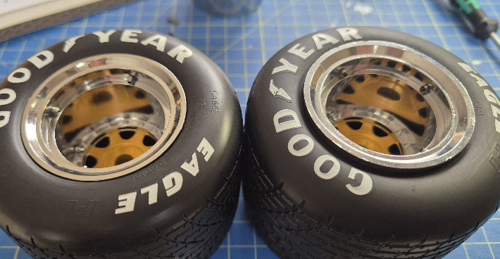

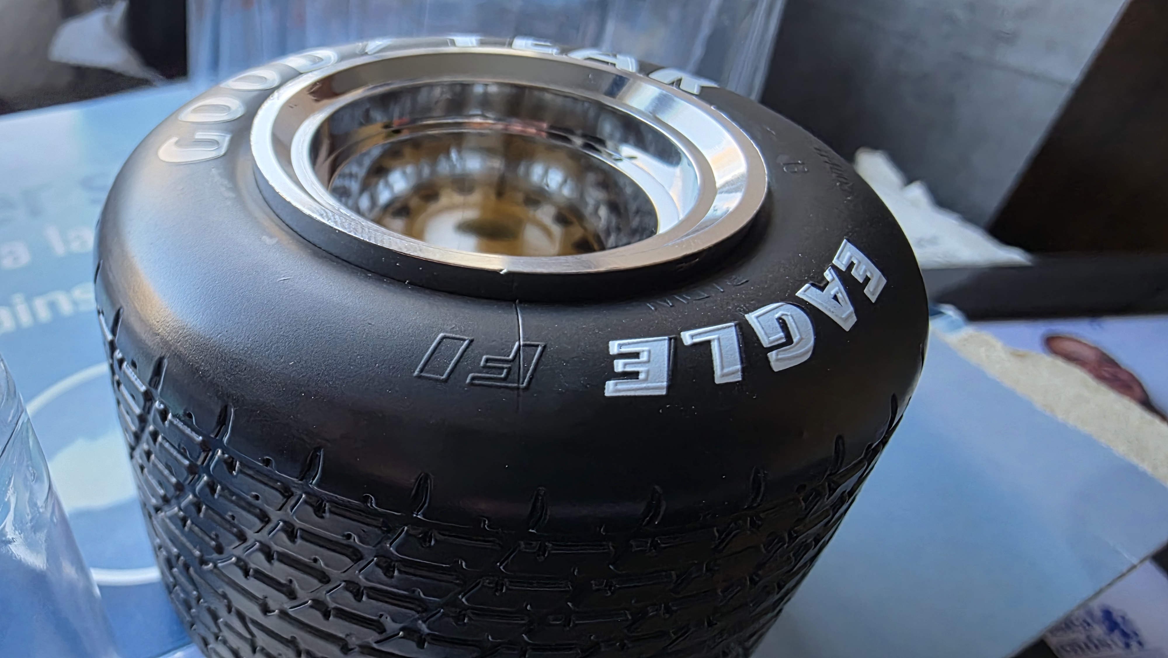

I went to build stage 103, the right rear wheel, and found that the outer barrel is too large and won't sit in the tyre. I tried everything, taking it apart, trimming the tyre a bit but no luck so I removed the left wheel which was fine and took that apart to find that the same barrel on this side was smaller. In the pics the correct left wheel is on the left and the incorrect right wheel is on the right.
Steve279021 attached the following image(s):

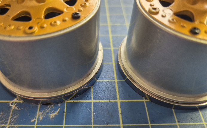

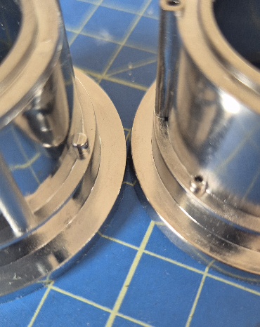

The 2 barrels side by side
Dodge charger build complete
#3 Posted : 17 October 2025 14:18:37
Posts: 5,183
Points: 15,698
Yes, that doesn't look right.
I had no problems with that stage so I suggest you contact c/s for a replacement.
Shouldn't be an issue.
Roy.

Maybe i should ask for a stage 99 as 99 and 103 are the same but if they give me another 103 then I could get the same problem

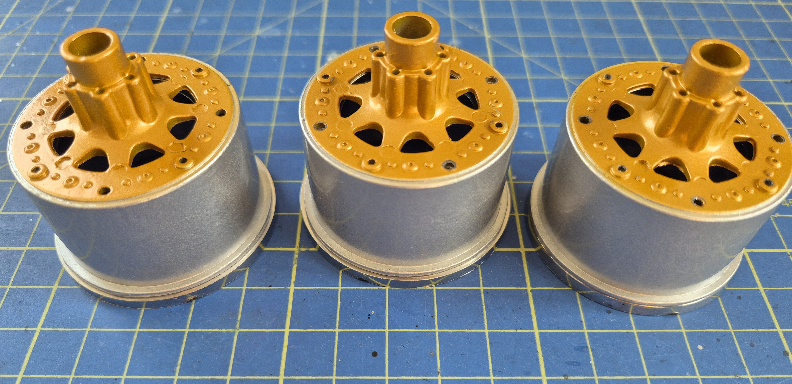

This is ridiculous, they've sent me another 103 and again, it's the same!!
In this pic, the one on the right is the stage 99 and the other 2 are the 2 103 stages.

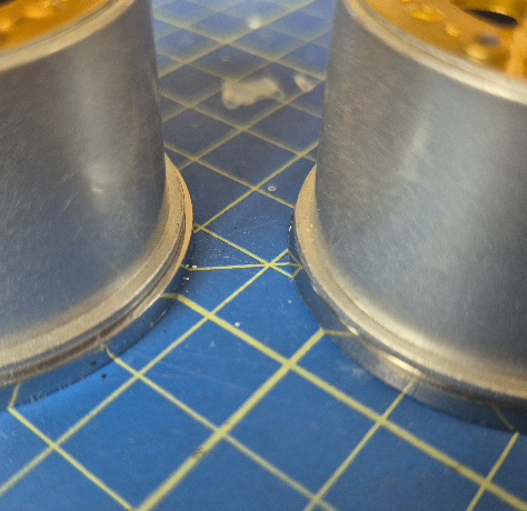

I've tried to get some better pics roy. Basically the plastic inner barrel is too large in stage 103 but correct size in stage 99.
Stage 99 is on the right

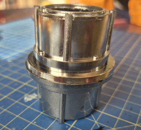

Again, stage 99 on the right

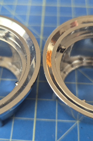

Stage 99 on top

UPDATE: I've received another stage 99 as a replacement for the 2 faulty stages 103. This part is the correct size so it seems that there is an issue just with stage 103. Which is odd as it is an identical stage. So who knows. Maybe others need to check this out too
