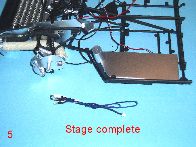

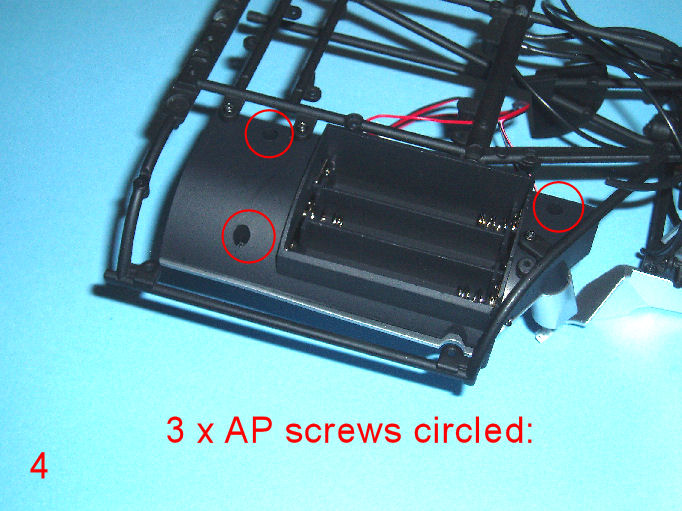

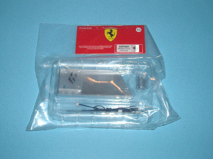

STAGE 45:

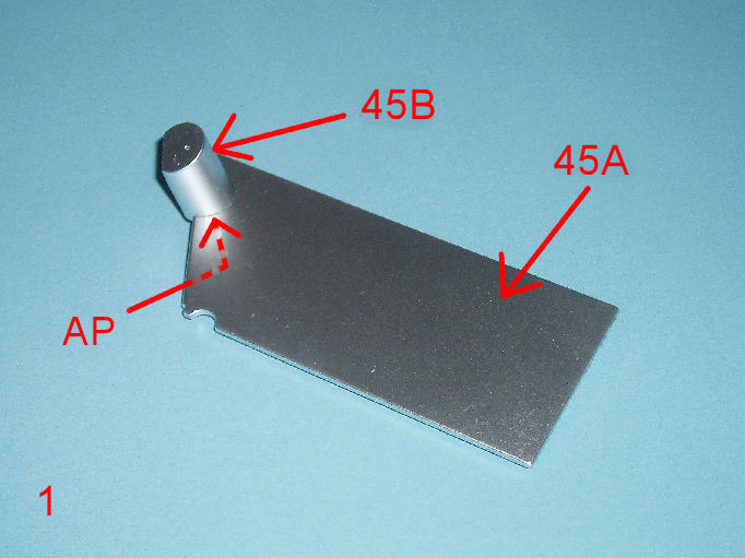

Left tank top.
Pic 1: Fit the tank top parts 45A and 45B together as shown and fix from underneath using 1 x AP screw.
Pic 2: Retrieve the front frame assembly and make sure the battery box wires run through the grooves in the box as highlighted.

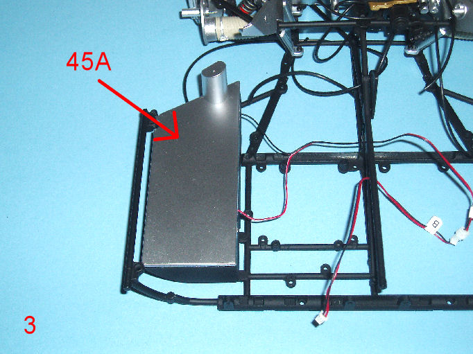

Pic 3: Fit the tank top in place as shown.

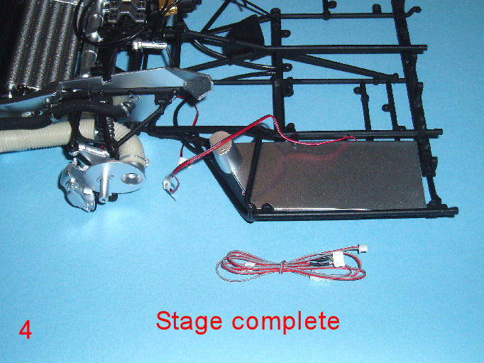

Pic 4: Fix from underneath using 3 x AP screws.
Pic 5: Store the assembly and unused wiring for now.

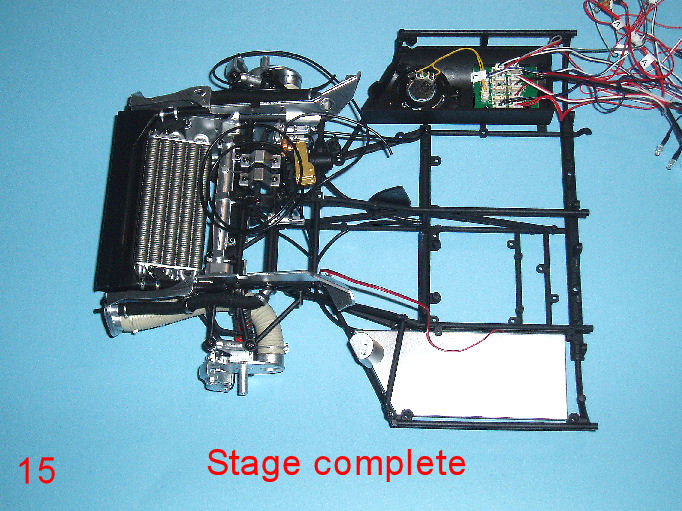

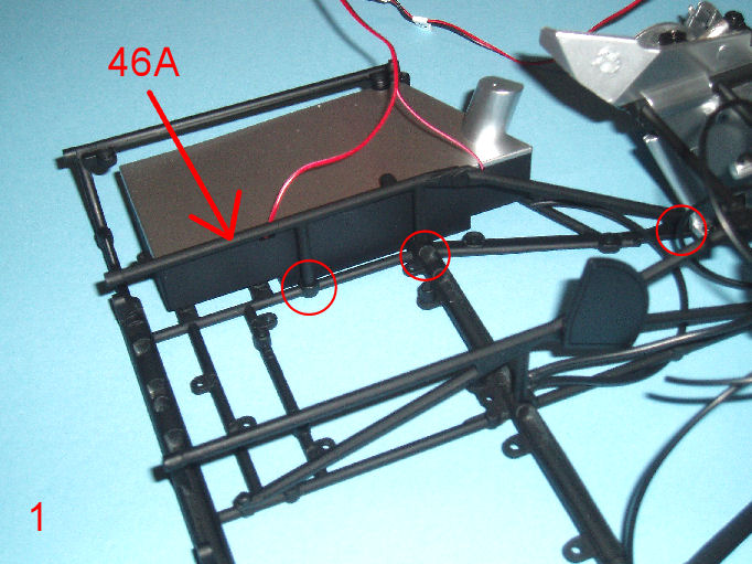

STAGE 46:
Left tank frame.
Pic 1: Retrieve the assembly from the previous stage and fit the upper frame 46A in place as shown.
The ‘legs’ will locate where indicated in red.
Pic 2: Fix the frame 46A in place from underneath using 3 x AM screws.

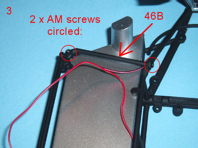

Pic 3: Fit the frame cross-bar 46B in place and fix with 1 x AM screw at each end.
Pic 4: Store the assembly and unused wiring safely for now.

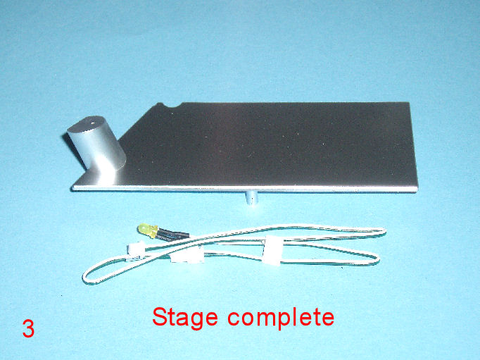

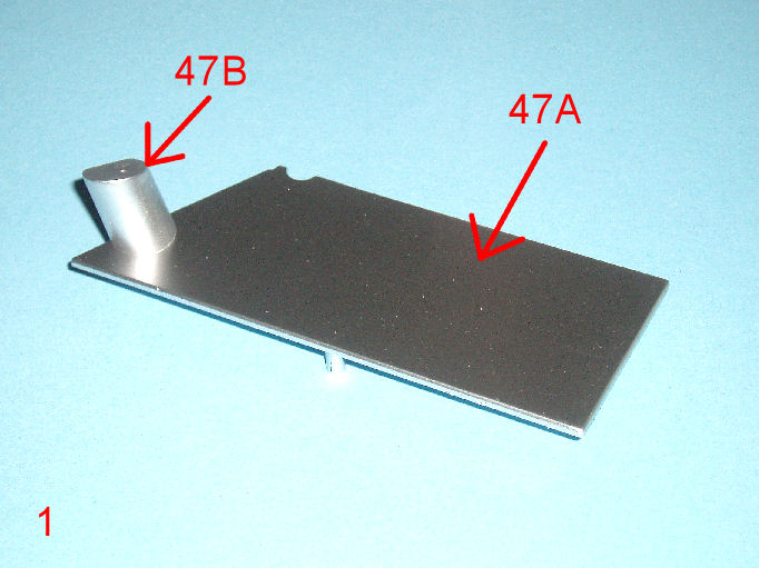

STAGE 47:

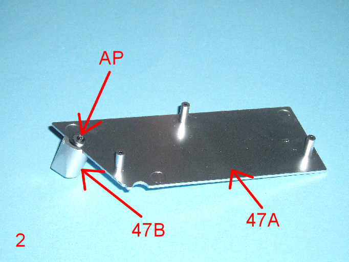

Right tank top.
Pic 1: Fit the tank top parts 47A and 47B together as shown.
Pic 2: Fix the parts together from underneath with 1 x AP screw.
Pic 3: Store the assembly and unused wiring safely.

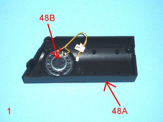

STAGE 48:
Right tank and speaker.

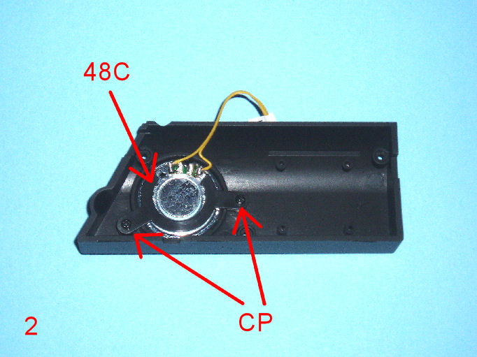

Pic 1: Fit the speaker 48B into the right tank 48A as shown.
Pic 2: Fit the retaining ring 48C in place and fix with 2 x CP screws.

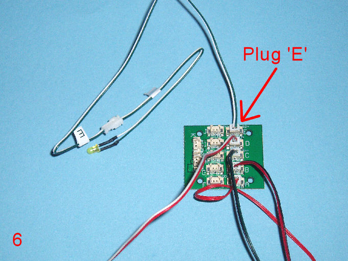

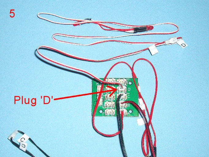

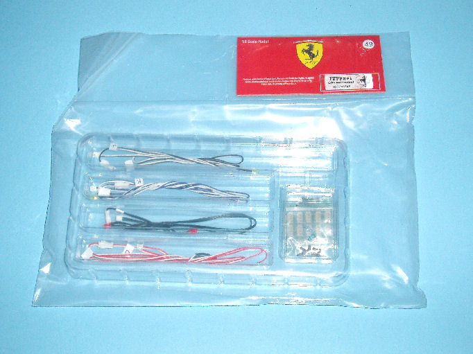

STAGE 49A:
Control unit and wiring.
Pic 1: Locate the PCB 49A and the switch wire ‘A’ saved from stage 44.
Fit the plug into the socket marked ‘A’.

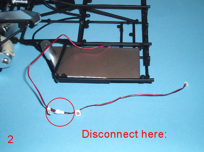

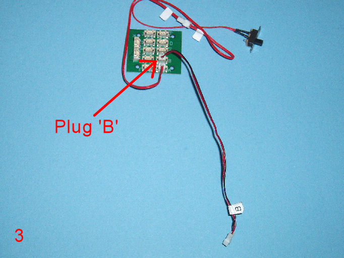

Pic 12: Retrieve the main chassis assembly and disconnect the wire ‘B’ where shown.
Pic 3: Fit the plug ‘B’ into the socket marked ‘B’.

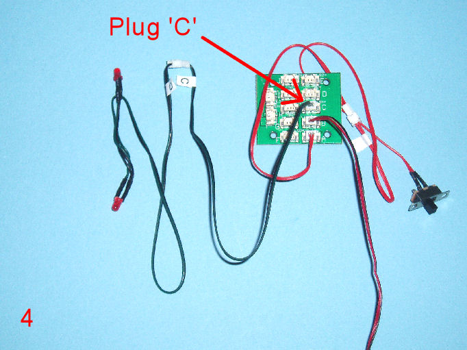

Pic 4: Locate the wire ‘C’ from this stage and fit the plug into socket ’C’.
Pic 5: Locate the wire ‘D’ from this stage and fit the plug into socket ’D’.
Pic 6: Retrieve the wire ‘E’ saved from stage 47 and fit the plug into socket ‘E’.

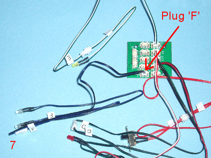

Pic 7: Retrieve the wire ‘F’ saved from stage 45 and fit the plug into socket ‘F’.

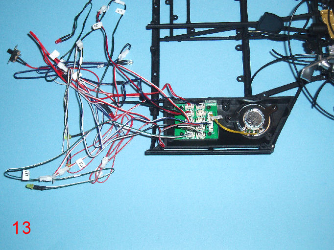

STAGE 49B:

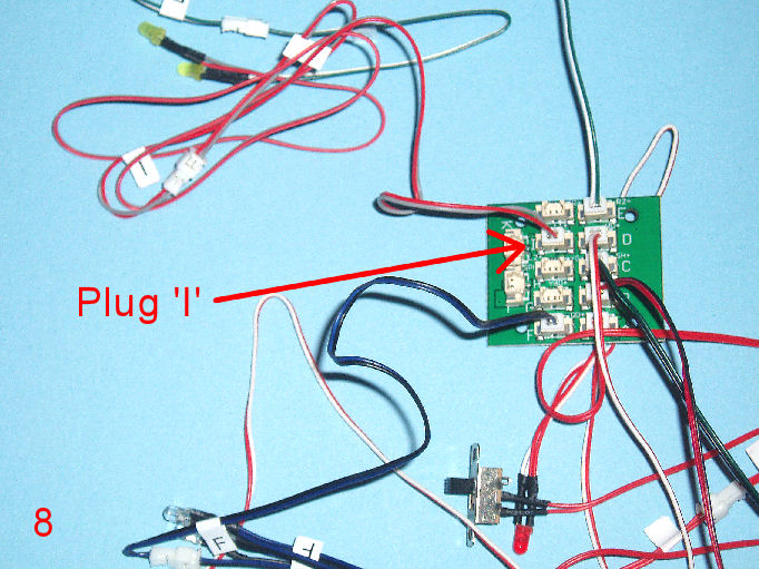

Pic 8: Retrieve the wire ‘I’ saved from stage 46 and fit the plug into socket ‘I’.

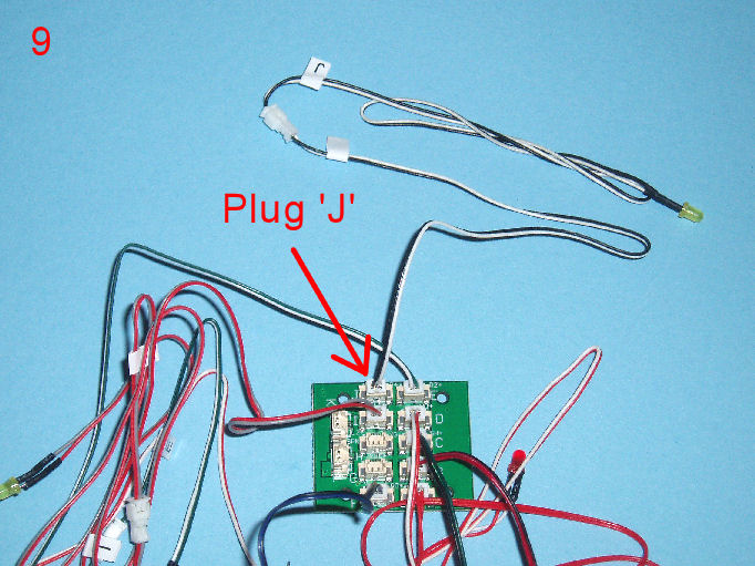

Pic 9: Locate the wire ‘J’ from this stage and fit the plug into socket ‘J’.

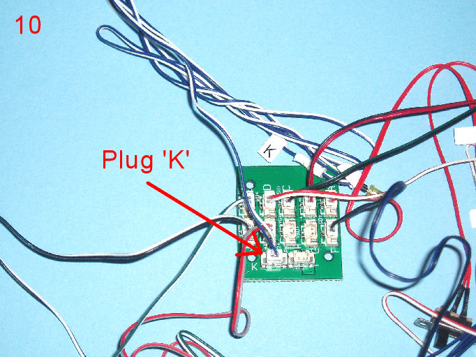

Pic 10: Locate the wire ‘K’ from this stage and fit the plug into socket ‘K’.

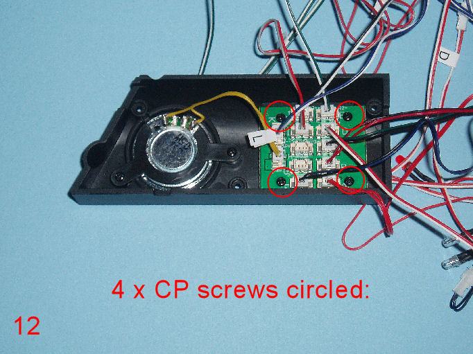

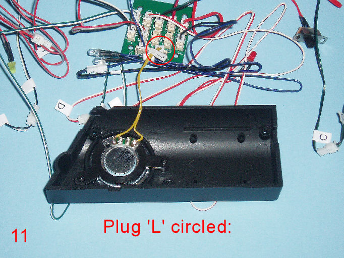

Pic 11: Connect the speaker wire ‘L’ to the socket marked ‘L’.
Pic 12: Fit the PCB into the tank as shown and fix with 4 x CP screws.
Pic 13: Fit the tank unit into the chassis as shown.
Pic 14: Turn the assembly over and fix the tank in place with 3 x AP screws.

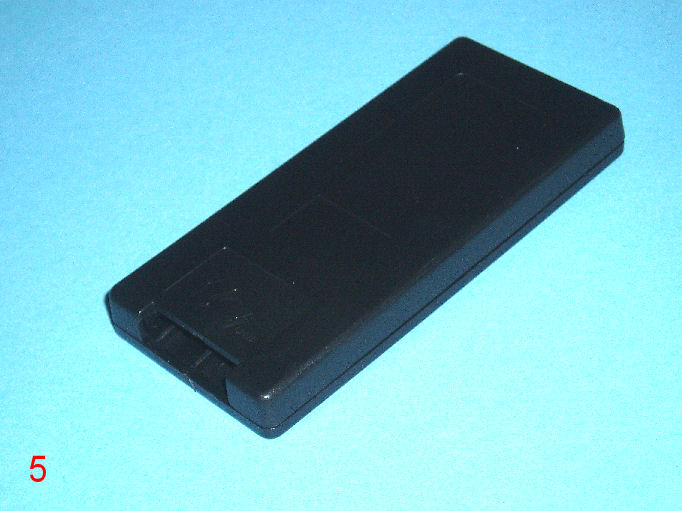

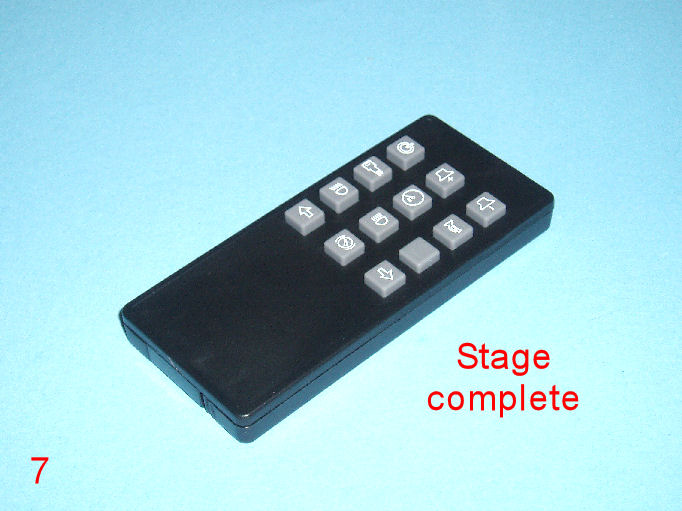

STAGE 50:
Remote control.

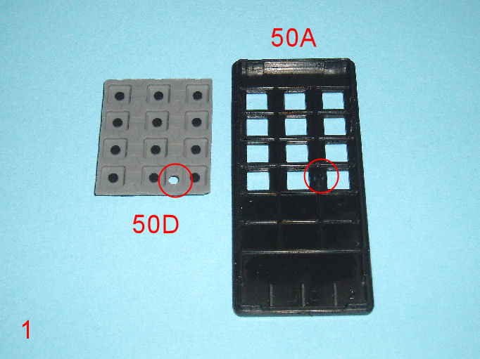

Pic 1: Locate the rubber button panel 50D which will inside the upper shell 50A as shown.
Pic 2: Fit the parts together.

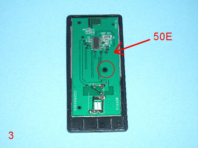

Pic 3: Place the control board 50E inside.
It will only fit one way.

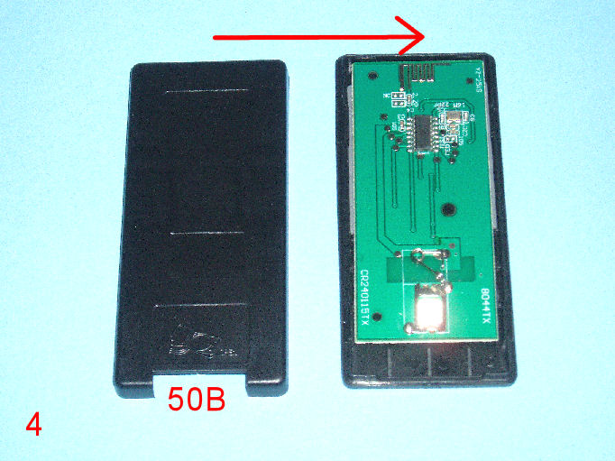

Pic 4: Locate the rear case 50B. It will fit on the assembly where indicated.
Pic 5: Snap-fit the parts together.
Pic 6: Fit the button battery holder 50C into the slot in the remote control where shown.
Pic 7: Store the unit until later.
Pic 8: The remote control functions.
