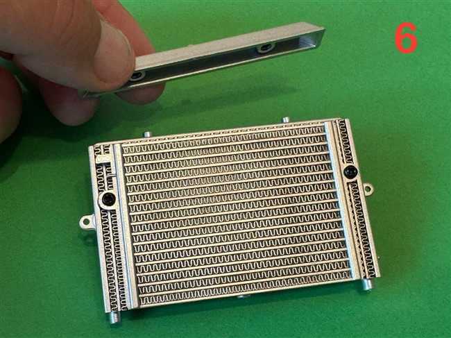

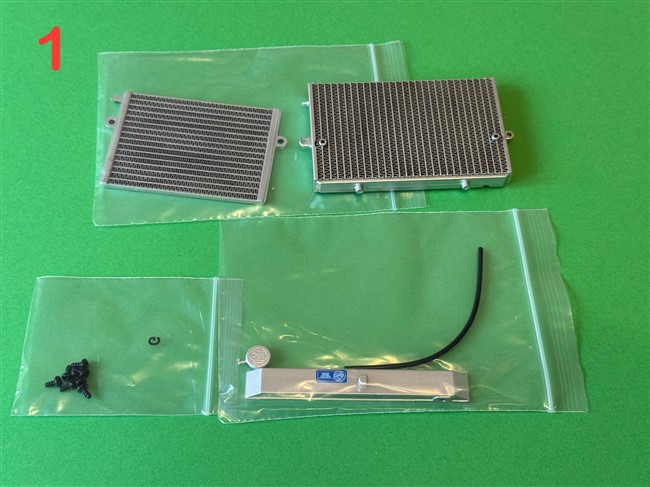

Picture 1 shows the parts for this issue.

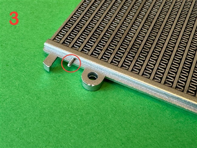

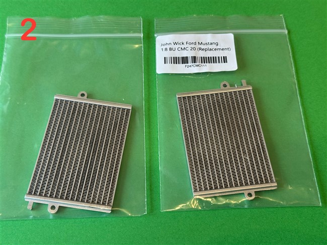

Before we start with this issue, you will see that you have been supplied with a replacement air conditioning radiator (20B), picture 2. The difference between the original and the replacement is that the replaced part has a small pin on the side as shown in picture 3.
Fit the two radiators (20A & B) together using 2 x type “G” screws, picture 4.

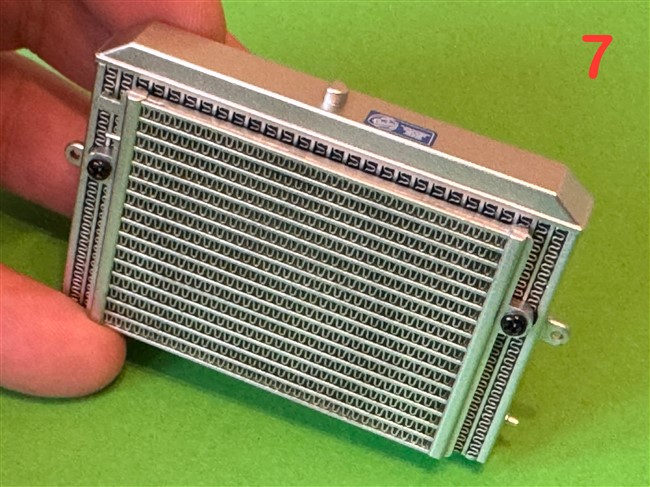

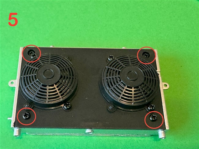

Take the fan assembly from the previous issue and attach it to the back of the radiator as shown in picture 5 using 4 x type “G” screws. Push fit the radiator header (20C) onto the top of the radiator, pictures 6 and 7.

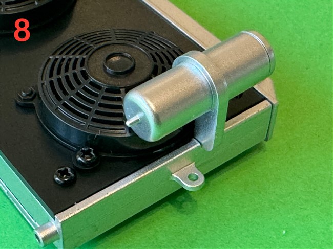

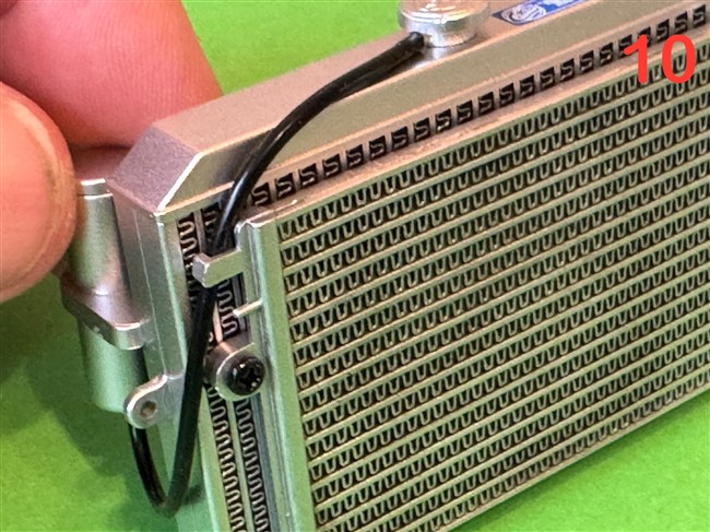

Retrieve the expansion tank from the previous issue and attach it to the side of the radiator as shown in picture 8. Place the radiator cap on the top of the radiator, picture 9, then place the hose between the radiator cap and the expansion tank, picture 10.

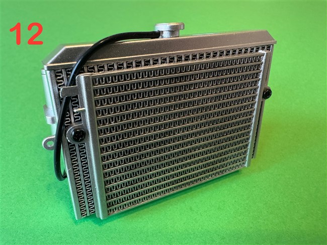

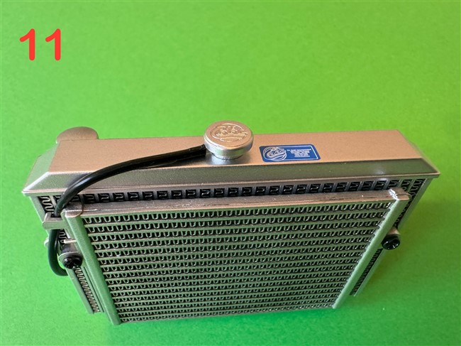

Pictures 11 and 12 show the complete assembly for this issue.
