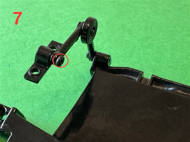

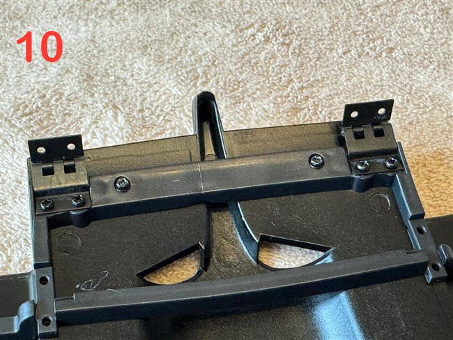

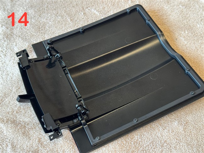

#1 Posted : 12 October 2025 19:56:39
Issue 107

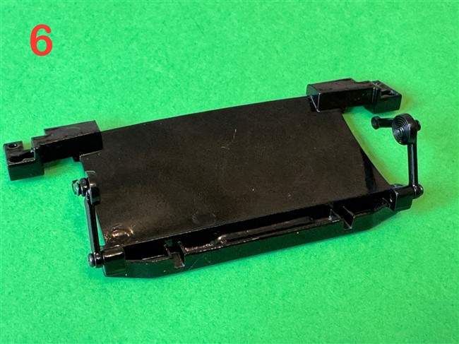

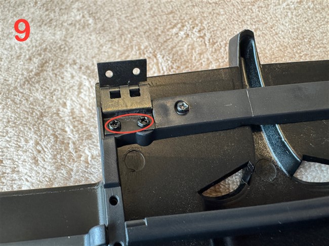

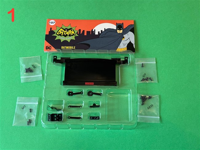

Fitting the Hinges

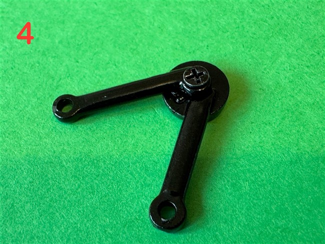

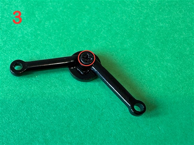

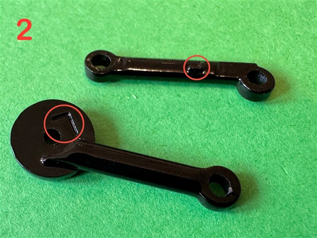

Take the front left hinges (107C &D). These are marked with the letter “L”, and secure the two by using an TM screw, pictures 2 and 3. Do the same with the right-side hinges, marked “R” (107E & F), picture 4.

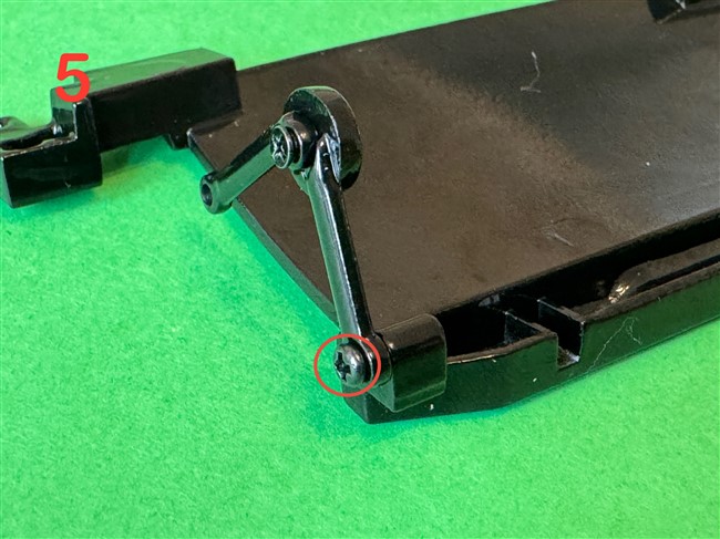

Using 2 x AM screws fit both the left and right hinge assemblies to the hood extension (107G), pictures 5 and 6.

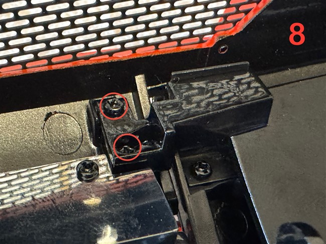

Fit the front left and right hinges parts (107A & B) using an AM screw, pictures 7 and 8.

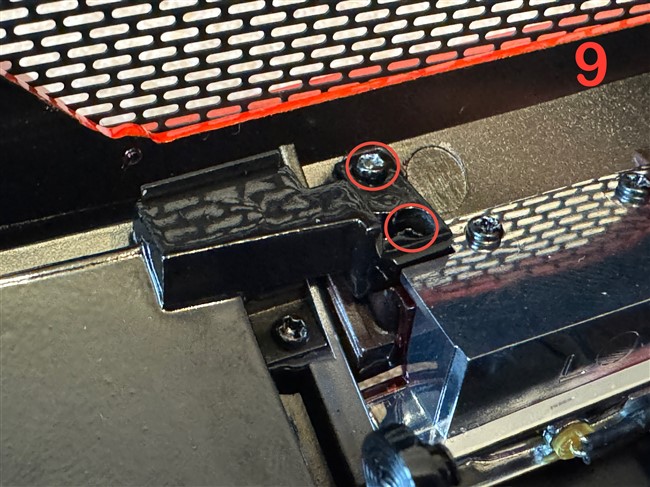

Next, secure the two hood connection plates (107H) to the underside of the hood using 4 x AKM screws, pictures 9 and 10.
Use four more AKM screws to attach the hood extension to the two hood connector plates, picture 11.

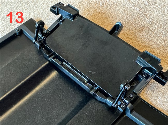

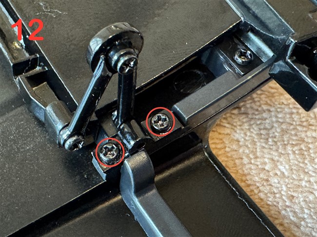

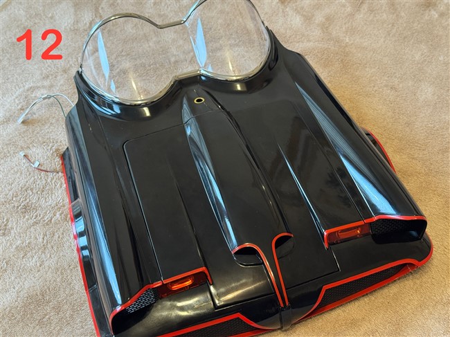

Finally, attach the two hinge parts “A” to the underside of the hood as shown in pictures 12 and 13.
Picture 14 shows the completed assembly for this issue.

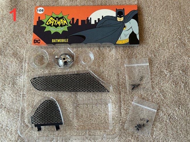

#2 Posted : 14 October 2025 10:47:40
Issue 108
Fitting the Headlight
Begin by slotting the headlight lens (108D) into the headlight rim (108E), picture 2. Push fit the headlight rim into the headlight reflector (108C), picture 3.
Fit the headlight grille (108B) into the recess of the front body panel using 2 x ZM screws as shown in picture 4.
Attach the headlight assembly behind the grille using 2 x AM screws, picture 5.
Finally, attach the front left grille (108A) to the front body panel using 3 x ZM screws as shown in picture 6.

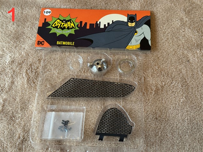

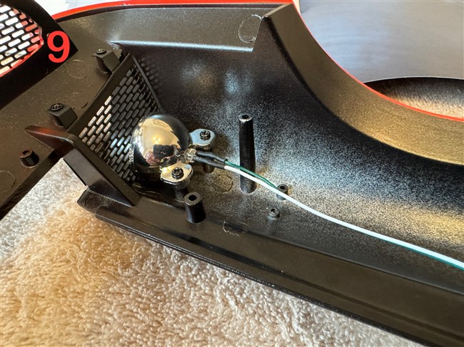

#3 Posted : 15 October 2025 09:49:23
Issue 109
Begin by slotting the headlight lens (109D) into the headlight rim (109E), picture 2. Push fit the headlight rim into the headlight reflector (109C), picture 3.
Fit the headlight grille (109B) into the recess of the front body panel using 2 x ZM screws as shown in picture 4.
Finally, attach the front left grille (109A) to the front body panel using 3 x ZM screws as shown in picture 6.
Unplug the cable marked “D” from the wiring loom at the front of the main body of the car, picture 8. These are the headlight LED bulbs, picture 7.
Push the two LED bulbs into the rear hole in the headlight. The longer cable goes into the left headlight with the shorter cable to the right headlight as illustrated in pictures 9 and 10.

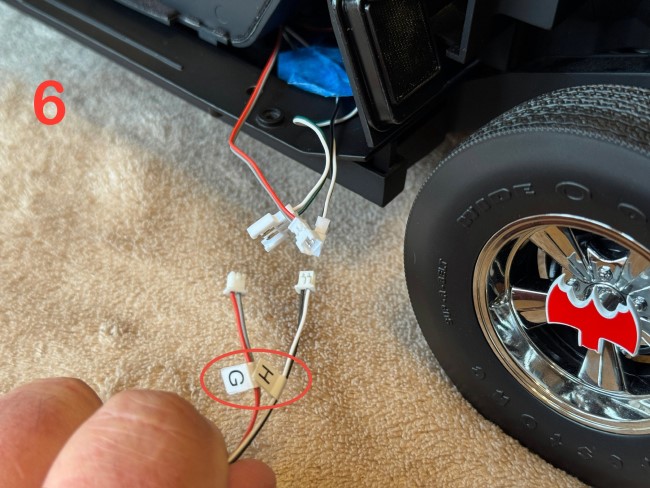

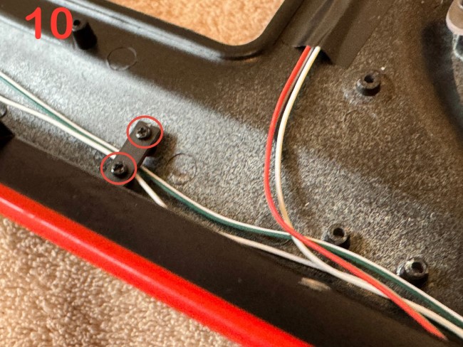

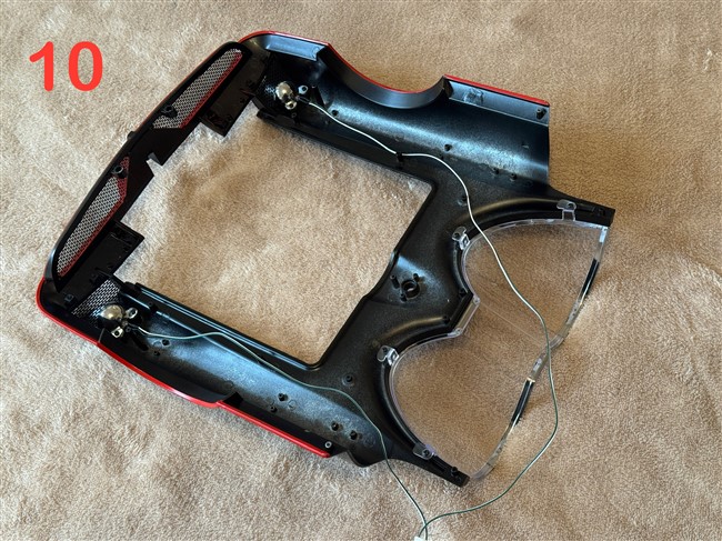

#4 Posted : 17 October 2025 14:41:04
Issue 110
Fitting the Turn Signals
Using the “L” and” R” markings as guides, push the two sets of housings (110A &110C) and lenses (110B & 110D) together, pictures 2 and 3.
Attach each turn signal to the front of the body panel using 2 x AM screws, pictures 4 and 5.
Unplug the front left and front right turn signals marked “G” and “H”, picture 6.
Push the right signal LED (H) into the hole in the right turn signal. Bend the bulb casing in a 90-degree angle as shown in picture 7. This is also the shorter of the two cables.
Do the same with the left-hand LED, pushing it into the left turn signal, picture 8.
Finally, use the four cable clips to run the four cables in the assembly, each clip uses 2 x AM screws, pictures 9 and 10.
Picture 11 shows all four clips in place. Note, I also used some of the black tape to secure the cables.

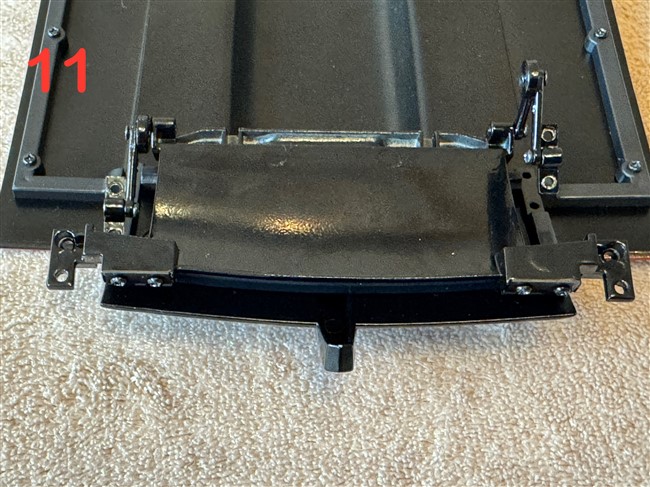

Fitting the Front Fender panel
Begin by removing the shipping beam, picture 2.
Fit the left (111B) and right (111C) brackets to the edge of the front fender panel (111A), pictures 3 and 4.
Fit the fender assembly to the underside of the front of the body panel. First, use two CM screws to secure the front fender at either end, picture 5. Turn the assembly over and place two CM screws as shown in picture 6.
Place the hood in the matching recess in the front body panel and secure it in place using 4 x AM screws. Note, that two of the screws are accessed via the two holes on the underside of the fender, pictures 7, 8 and 9.
Finally, plug the holes by using the two covers supplied, picture 10.

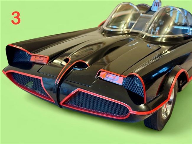

Pictures 11 and 12 show the complete assembly for this issue.

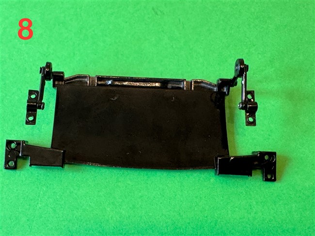

#6 Posted : 21 October 2025 10:22:49
Issue 112
Fitting the Rear Fender panel
Begin by removing the shipping beam.
Using 4 x CM screws, secure the rear fender panel (112A) to the underside of the rear body frame, picture 2.

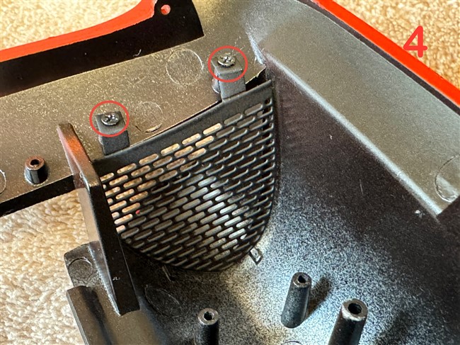

#7 Posted : 21 October 2025 10:23:47

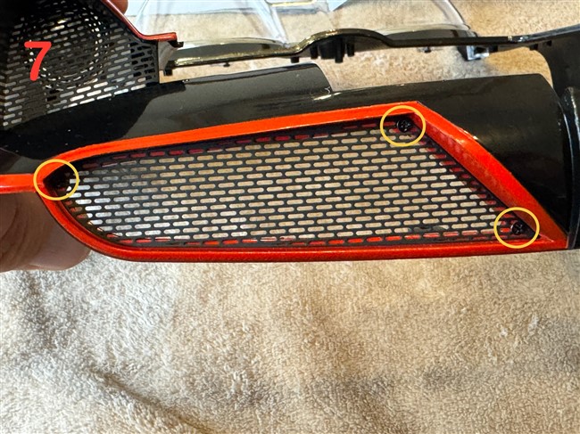

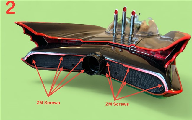

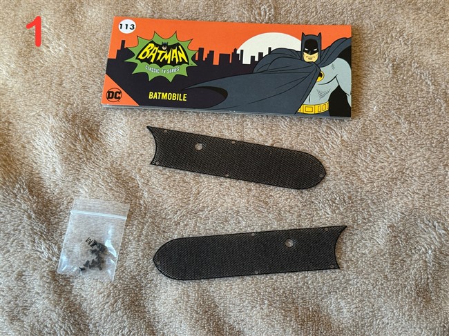

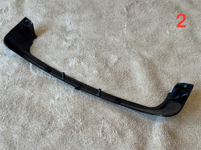

Issue 113
Fitting the Left and Right Back Grilles.
Place the grilles to the rear of the body frame and secure each one in place by using 5 x ZM screws as shown in picture 2.
Pictures 3 and 4 show the assembly complete for this issue.
