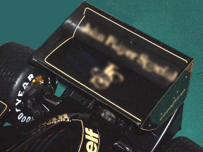

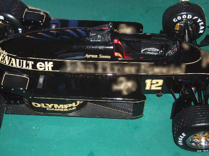

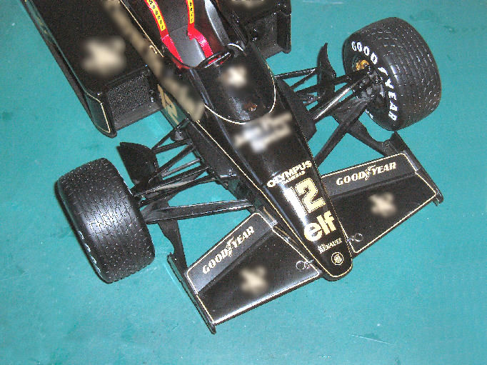

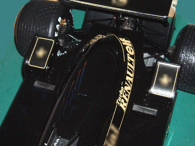

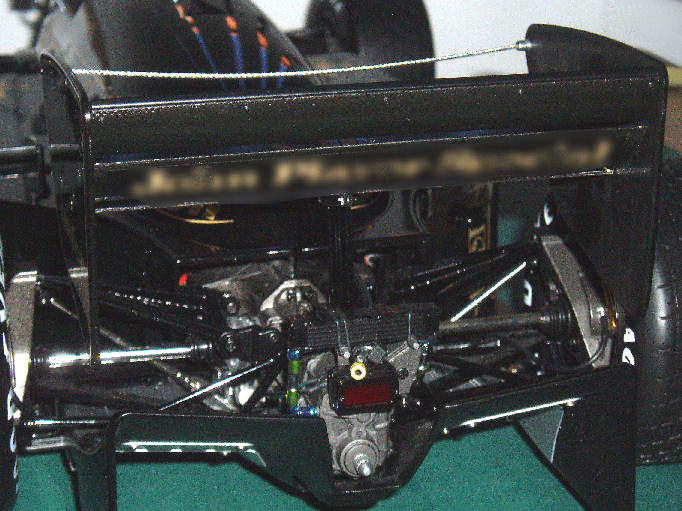

DECALS
As previously mentioned, the decals in this kit cannot be shown due to strict legal reasons.
The following images are intended as a guide to help with placing.
Of course, the decals have been deliberately blurred but hopefully the pics will show where the decals go.
An internet search will also bring up numerous pictures of the real car for reference.
