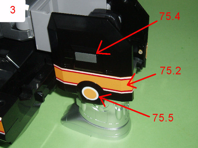

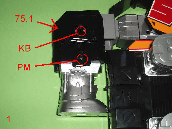

STAGE 75:
Mastodon rear right leg 2.
Pic 1: Retrieve the main assembly and fit the cover plate 75.1 as shown.
Fix it with 1 x KB screw and 1 x PM screw.

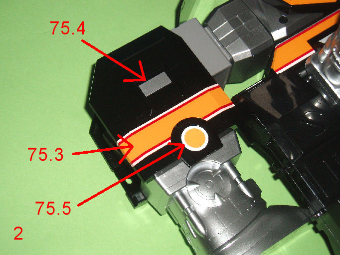

Pic 2: Press-fit the detail plates 75.3, 75.4 and 75.5 in place as shown.
Pic 3: On the other side, press-fit the detail plates 75.2, 75.4 and 75.5 in place as shown.
Store the assembly safely.

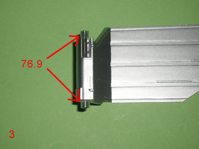

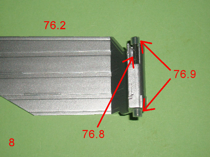

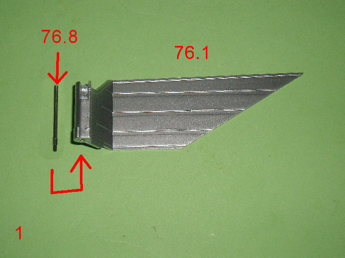

STAGE 76A:
Pterodactyl wings.
Pic 1: Locate the left wing 76.1 and the shaft 76.8.
The shaft has one thicker end which will be at the bottom then the shaft is inserted into the wing.
Pic 2: Shows the shaft fitted to the wing.
Pic 3: Fit a silicone bush 76.9 on each end of the shaft.

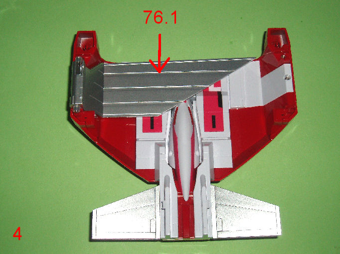

Pic 4: Retrieve the Pterodactyl assembly and fit the wing in place as shown.

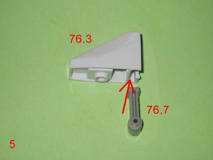

Pic 5: Locate the connecting piece 76.3 and the clip 76.7.
#3 Posted : 27 September 2025 15:24:20
Posts: 5,181
Points: 15,692

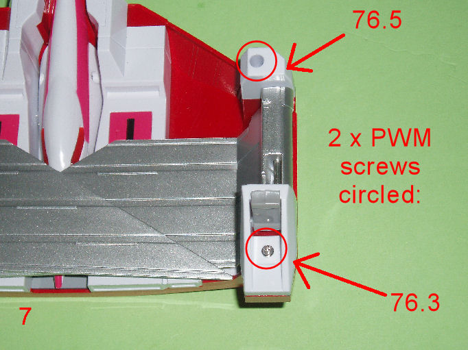

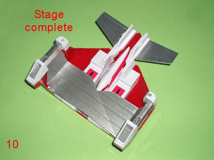

STAGE 76B:
Pic 6: Shows the parts 76.3 and 76.7 fitted together.
Pic 7: Fit the assembly to the front of the wing and the other connecting piece 76.5 at the other end.
Fix the parts with 1 x PWM screw in each.
Pic 8: Assemble the other wing 76.2 in the same way.

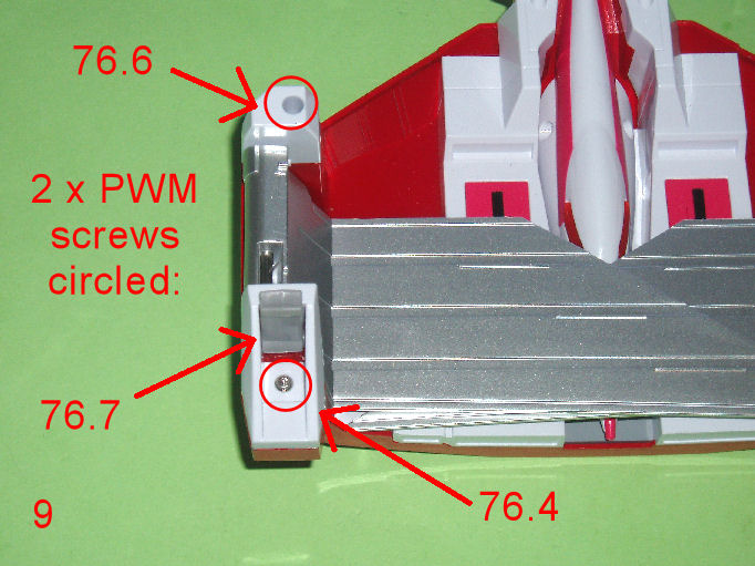

Pic 9: Assemble the connecting pieces and fit the wing as before with 2 x PWM screws.
Pic 10: Store the assembly safely.

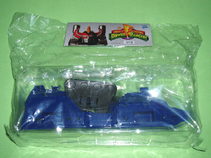

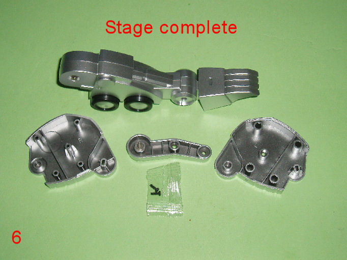

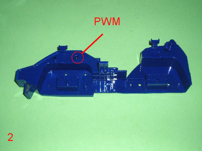

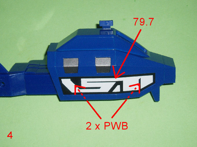

STAGE 79A:
Triceratops right front undercarriage.

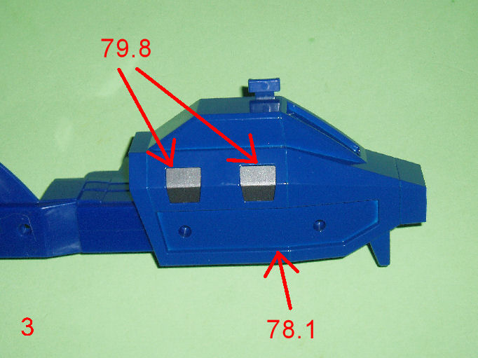

Pic 1: Retrieve the wheel cover 78.1 and locate the side panel 79.1.
78.1 will fit over 79.1 from the outside.
Pic 2: Fit the parts together and fix with 1 x PWM screw.
Pic 3: Press-fit the two panels 79.8 as shown
Pic 4: Fit the trim panel 97.7 as shown and fix from the other side with 2 x PWB screws.

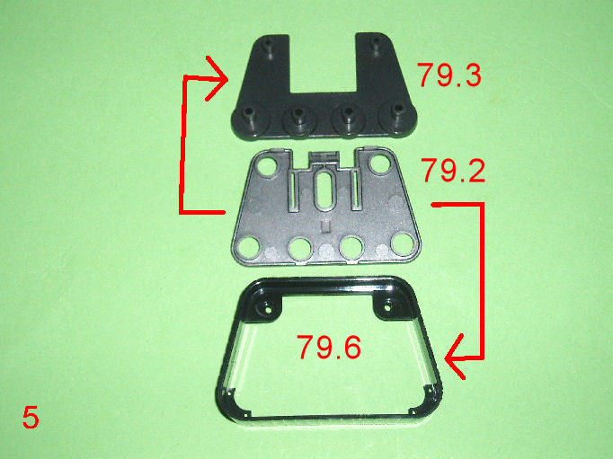

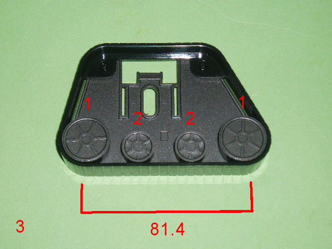

#7 Posted : 28 September 2025 11:01:35
Posts: 5,181
Points: 15,692

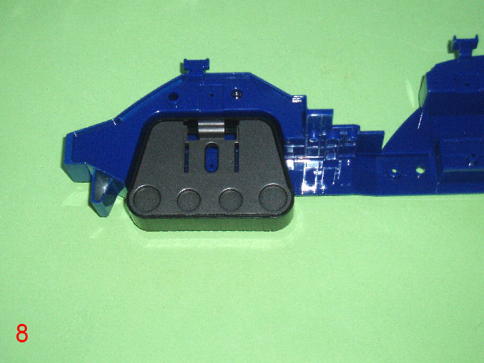

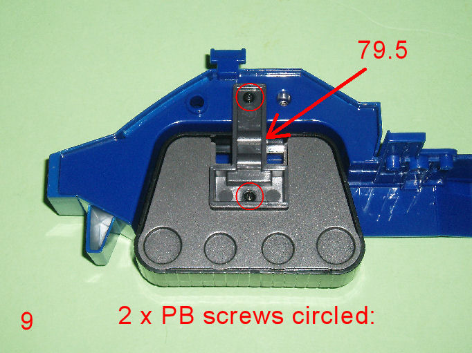

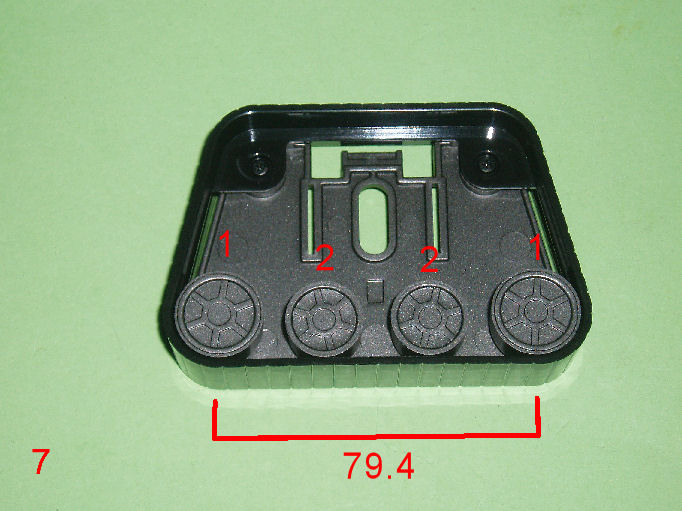

STAGE 79B:

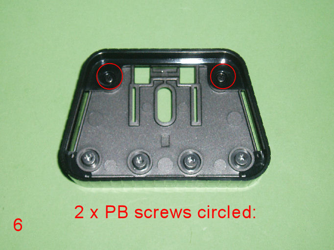

Pic 5: Locate the wheel parts 79.2, 79.3 and 79.6.
They will fit together in the order shown.
Pic 6: Fix the parts together with 2 x PB screws.
Pic 7: Press-fit the 4 x wheels 79.4 in the size order indicated.
Pic 8: Retrieve the side assembly and fit the wheels as shown.
Pic 9: Fit the retaining bracket 79.5 in place and fix with 2 x PB screws.
Pic 10: Store the assembly safely for now.

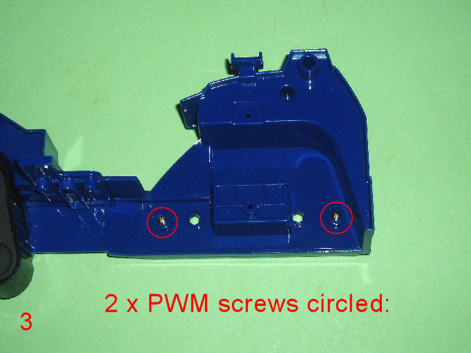

#8 Posted : 28 September 2025 14:13:43
Posts: 5,181
Points: 15,692

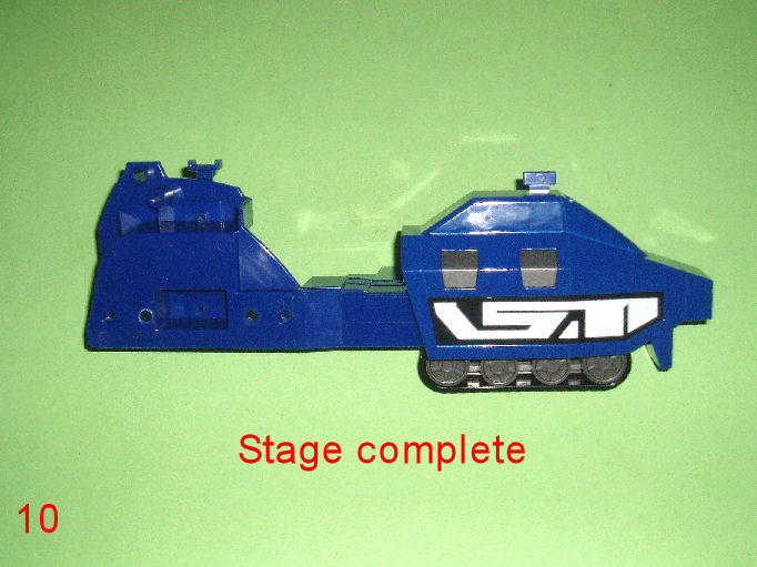

STAGE 80:
Triceratops right front undercarriage 2.

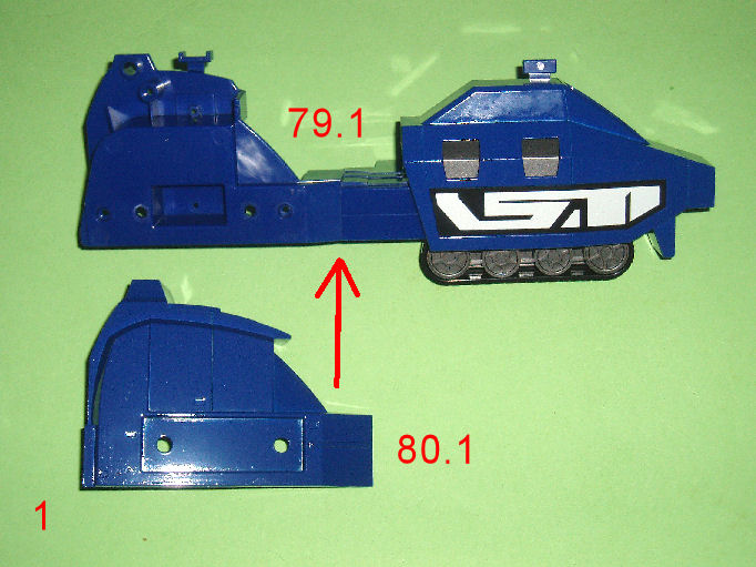

Pic 1: Retrieve the body part 79.1 and locate the rear panel 80.1.
The parts will fit together.

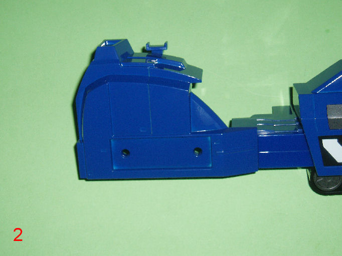

Pic 2: Shows the parts fitted together.
Pic 3: Fix the parts with 2 x PWM screws from the other side.

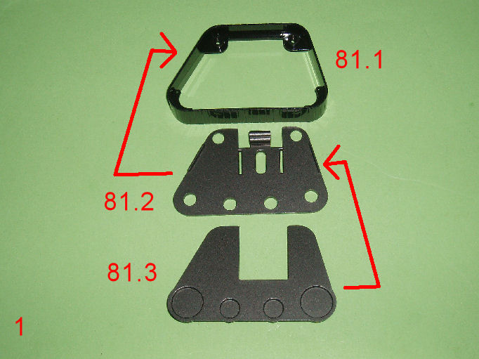

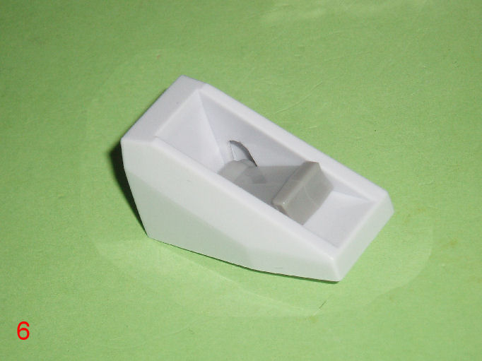

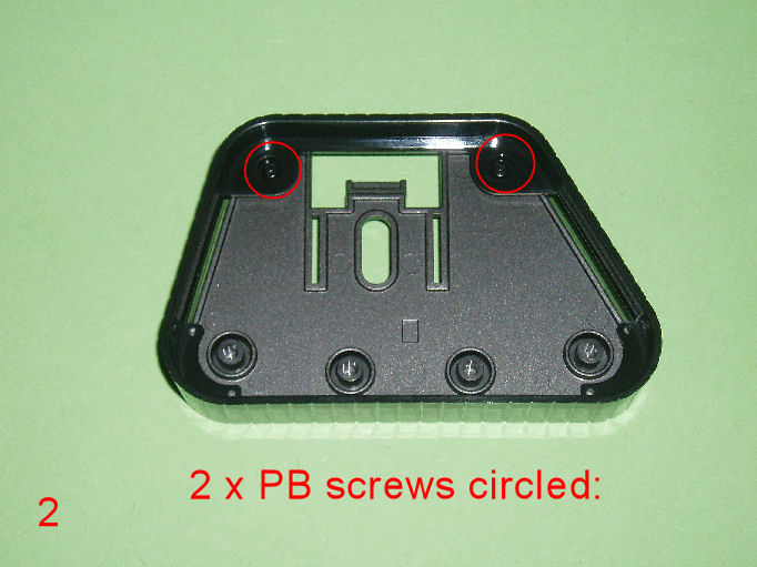

STAGE 81A:
Triceratops right front undercarriage 3.
Pic 1: Locate the wheel parts 81.1, 81.2 and 81.3.
Pic 2: Fix the parts together with 2 x PB screws.
Pic 3: Press-fit the 4 x wheels 81.4 in the size order indicated.

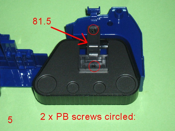

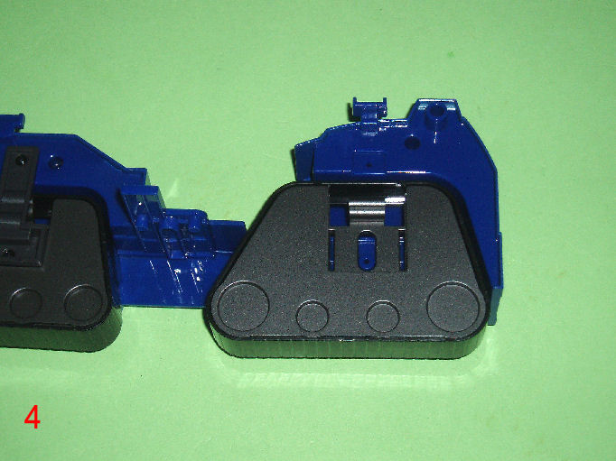

Pic 4: Retrieve the side assembly and fit the wheels as shown.
Pic 5: Fit the retaining bracket 81.5 in place and fix with 2 x PB screws.

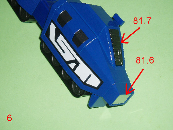

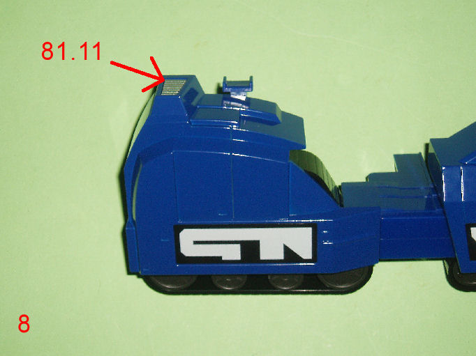

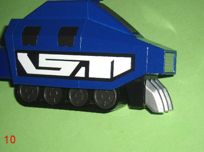

STAGE 81B:

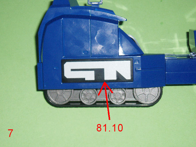

Pic 6: Fit the trim parts 81.6 and 81.7 as shown.
You may need to use an adhesive with 81.6.
Pic 7: Press-fit the trim 81.10 in place.
Pic 8: Fit the trim part 81.11 as shown.
You may need to use an adhesive.

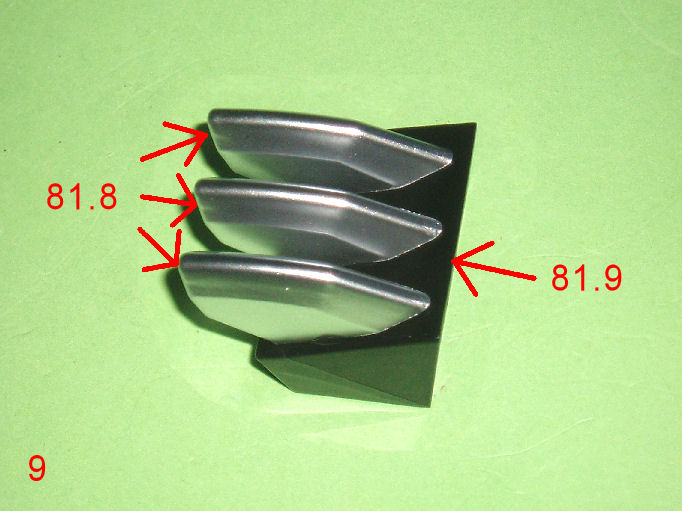

Pic 9: Glue the 3 x claws 81.8 to the foot 81.9.
Pic 10: Glue the foot in place on the front of the main assembly.
Store the parts safely for now.

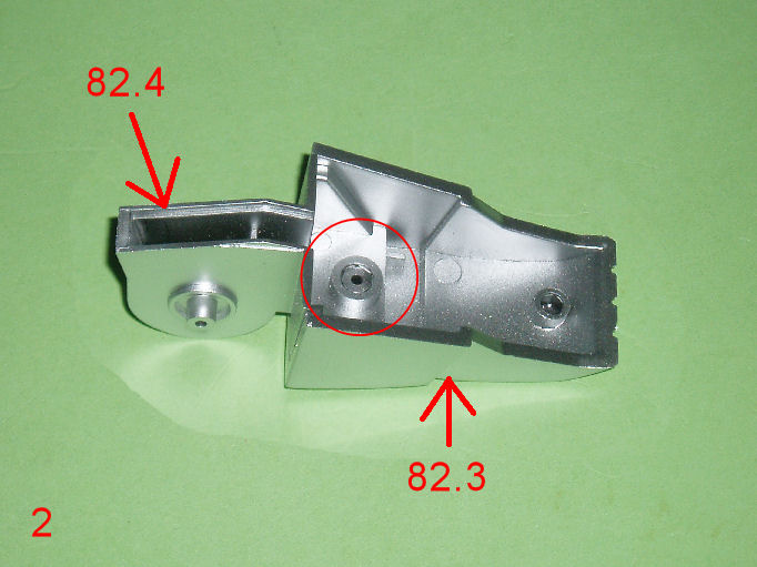

#11 Posted : 30 September 2025 10:16:16
Posts: 5,181
Points: 15,692

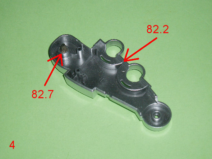

STAGE 82:
Sabretooth Dinozord legs 3.

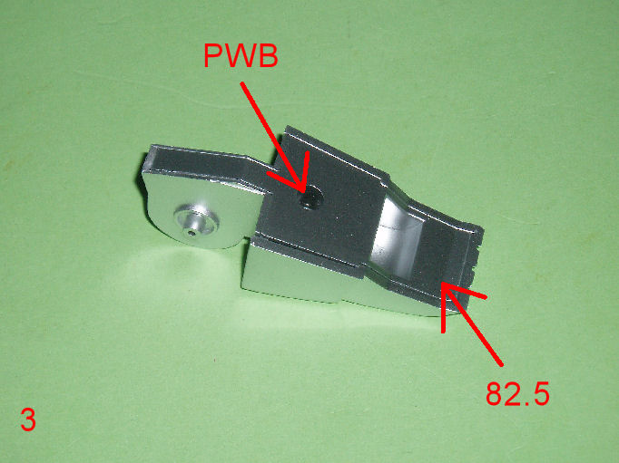

Pic 1: Locate the three parts of the foot – 82.3, 82.4 and 82.5.
Pic 2: Fit 82.4 into 82.3 as shown.
Pic 3: Fit the third part 82.5 in place and fix with 1 x PWB screw.

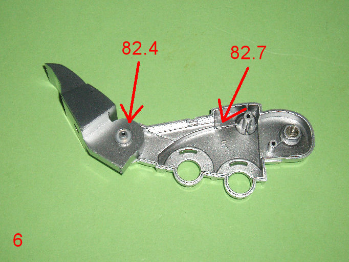

Pic 4: Press-fit the spindle 82.7 into the leg part 82.2.
The thicker end of the spindle will go in the hole in the end of the leg.

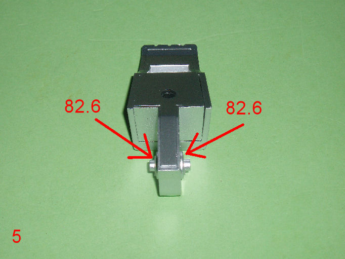

Pic 5: Retrieve the assembled foot and fit a silicone washer 82.6 on each side as shown.
Pic 6: Fit the foot assembly into leg part 82.7 as shown.

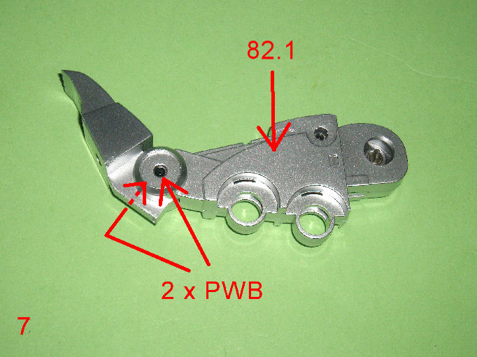

Pic 7: Fit the upper left part 82.1 in place and fix the parts together using 1 x PWB through the hinge on each side.
Store the parts safely.

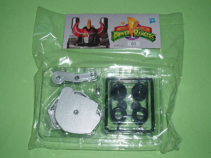

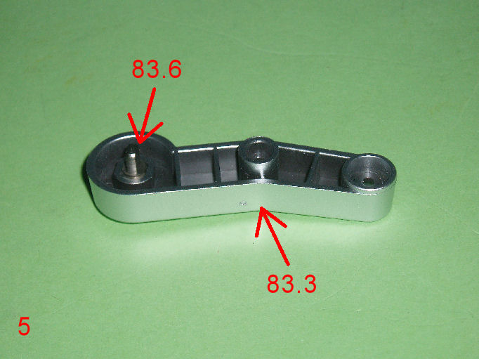

STAGE 83:
Sabretooth Dinozord legs 4.

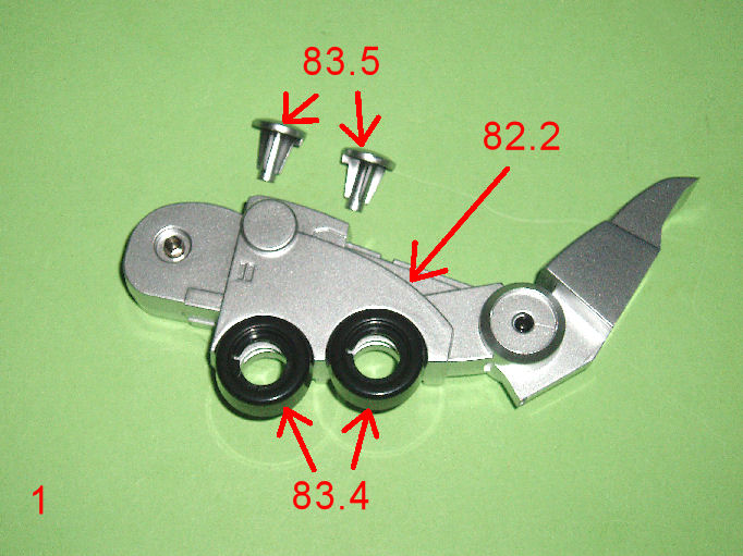

Pic 1: Retrieve the assembly from the previous stage and fit the wheels 83.4 in place.
Locate the hubs with the long shafts from the sprue 83.5.
Pic 2: Fit the hubs in place as shown.
They will only fit one way.

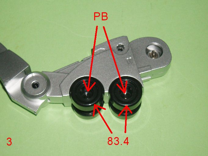

Pic 3: Turn the assembly over and fit the other wheel parts 83.4.
Fix through the centres with 1 x PB screw in each.

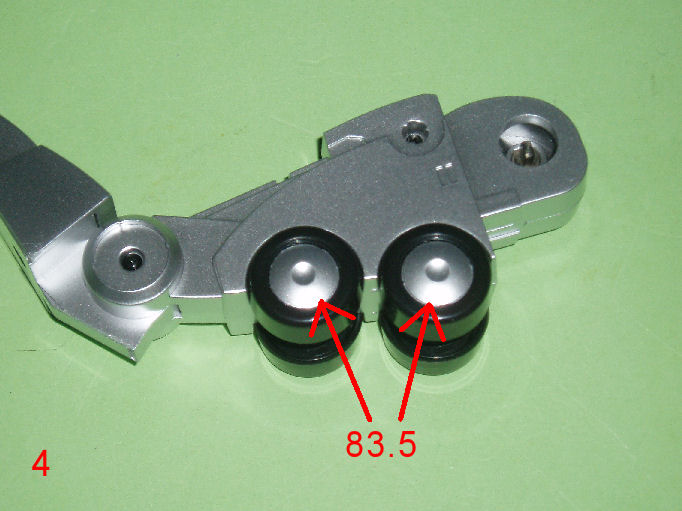

Pic 4: Press-fit the thinner hubs 83.5 in place.
Pic 5: Press-fit the thicker end of the spindle 83.6 into the hole in the larger end of the leg 83.3.
Pic 6: Store all parts safely for now.

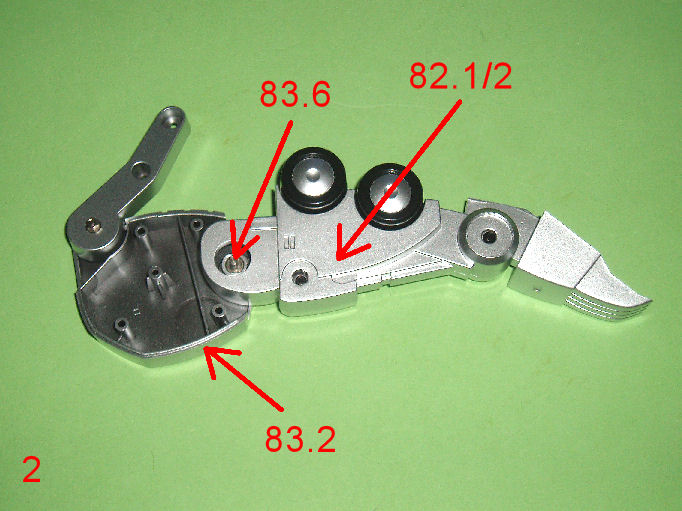

#13 Posted : 02 October 2025 10:08:32
Posts: 5,181
Points: 15,692
STAGE 84:
Sabretooth Tiger body 4.

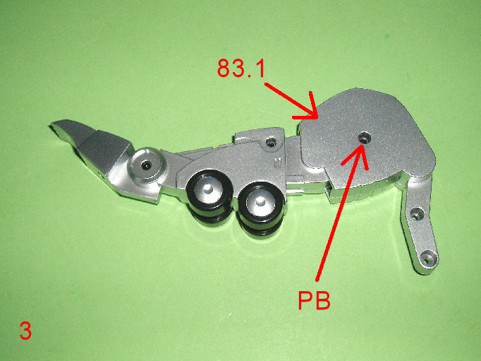

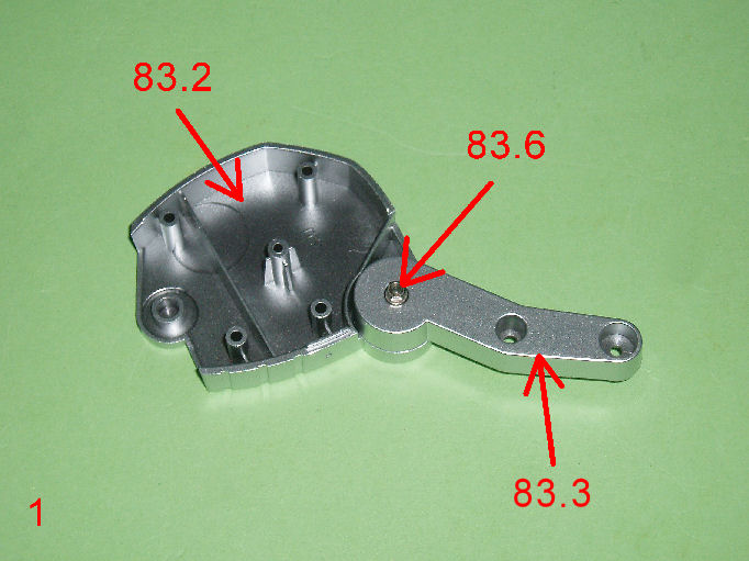

Pic 1: Retrieve the parts from stage 83 and fit the leg 83.3 into the hip 83.2 as shown.
The spindle 83.6 will fit in the slot in the rounded end of the hip 83.2.
Pic 2: Retrieve the leg assembly from stage 82 and fit the other spindle 83.6 into the round hole in the open end of the hip 83.2.
Pic 3: Fit the other hip half 83.1 in place and fix with 1 x PB screw.

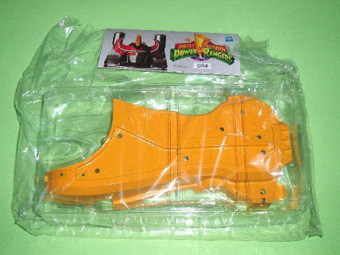

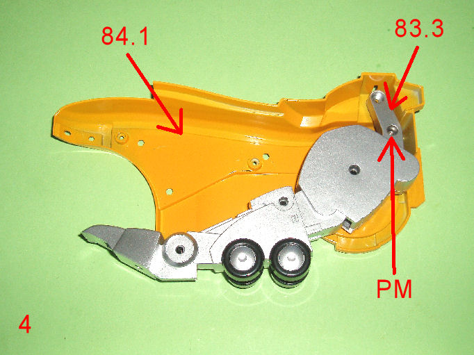

Pic 4: Fit the assembly to the inside of the yellow body part 84.1 supplied with this issue.
Fit the parts together with 1 x PM screw as shown.

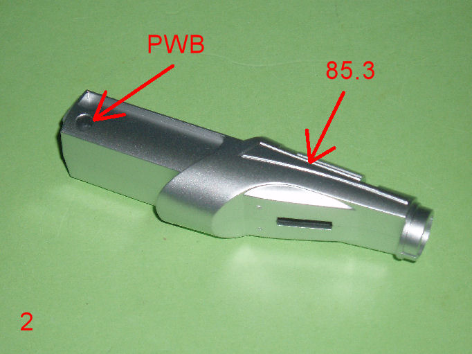

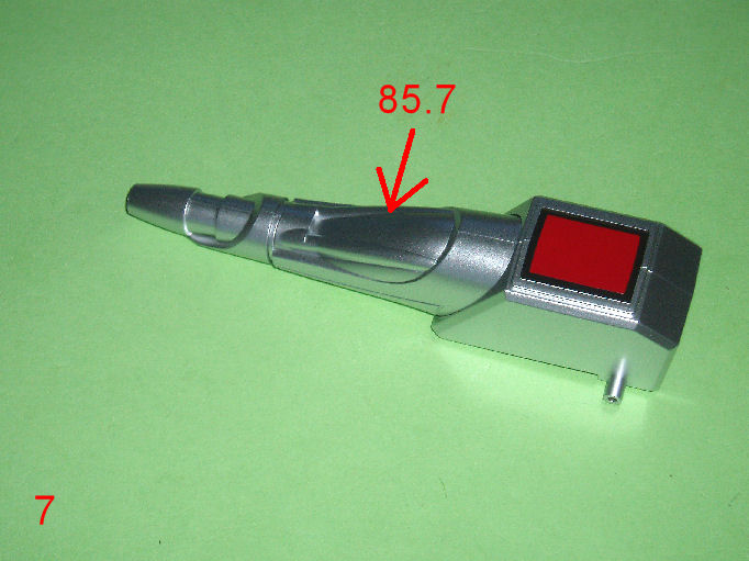

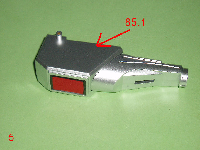

STAGE 85:
Sabretooth Tiger tail.

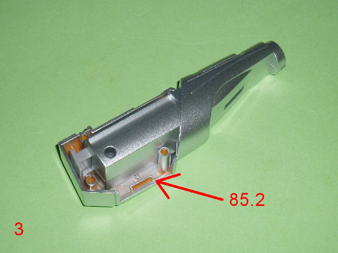

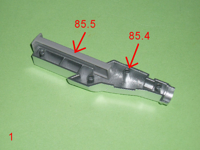

Pic 1: Fit the tail support 85.5 into the side of the tail part 85.4.
Pic 2: Fit the other half of the tail 85.3 and fix with 1 x PWB screw.
Pic 3: Fit the assembly into the body part 85.2.

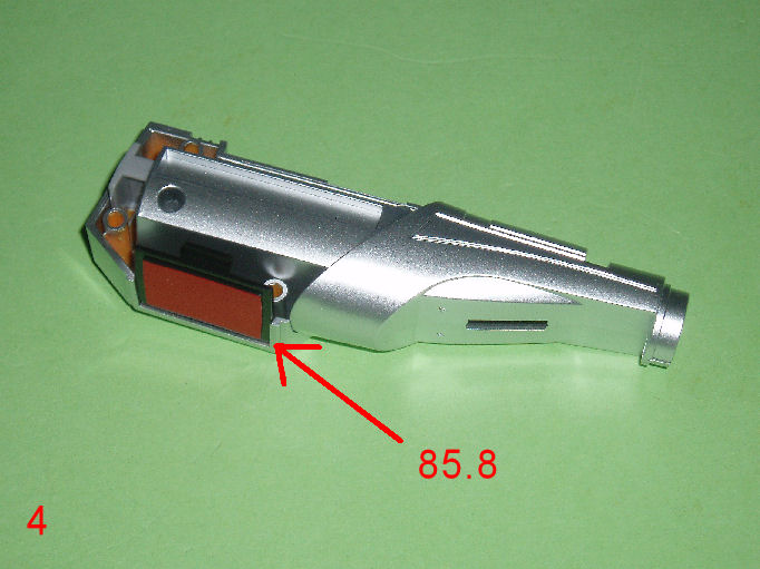

Pic 4: Fit the trim piece 85.8 into the slot in the edge of the body part just fitted.
Pic 5: Press-fit the other body half 85.1 in place as shown.

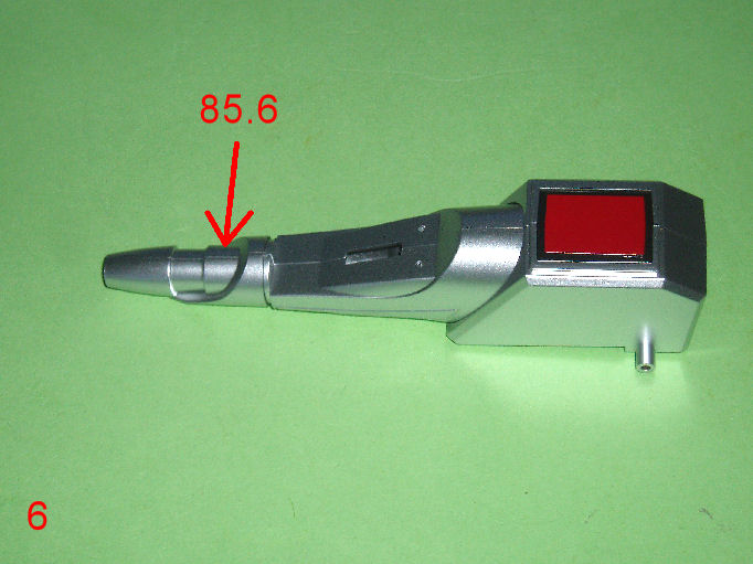

Pic 6: Glue the tail end 85.6 in place.
It will only fit one way.
Pic 7: Glue the upper tail 85.7 in place as shown.
