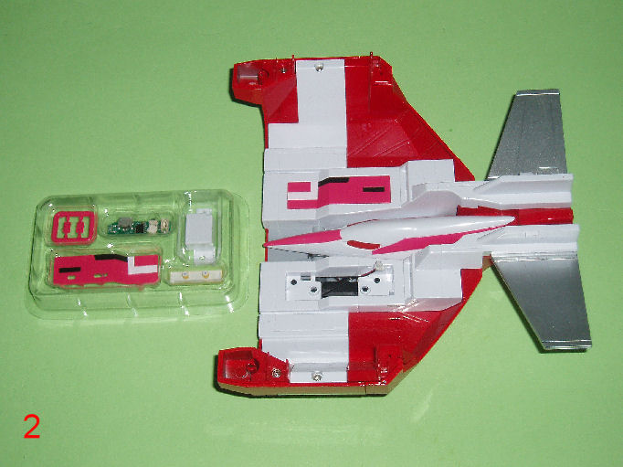

All parts supplied.....Pic 1, you will also need the final assembly from Issue 41.

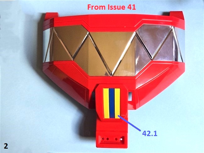

Start by pressing the cover plate 42.1 into place on the main assembly from Issue 41, as shown in Pic 2.

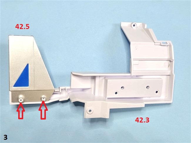

Next, press the right rear wing 42.5 onto the right side tail structure 42.3, Pic 3.
Instructional Errors image 42.C: Notation 43.3 should read 42.3 and you cannot fit that part with the head in the retracted position, so pivot it forwards.

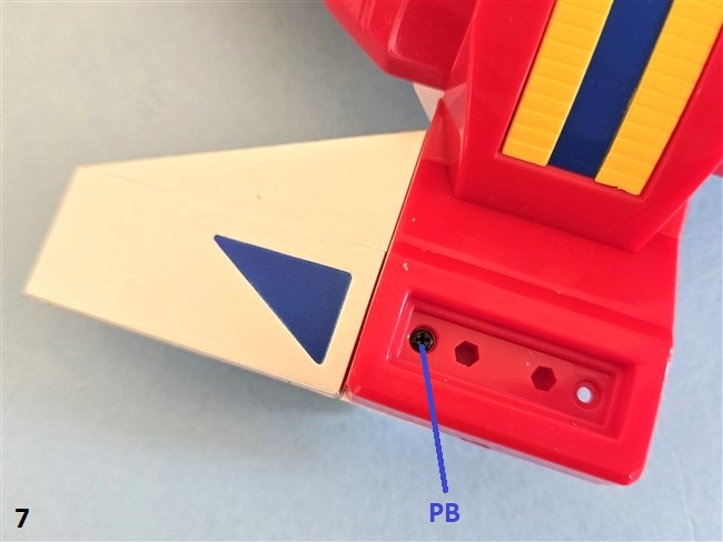

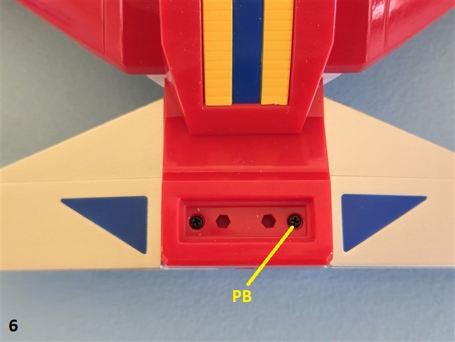

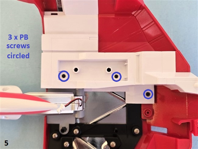

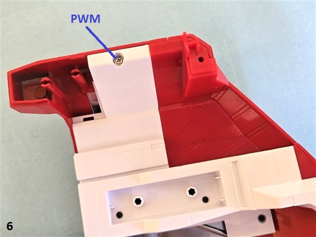

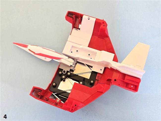

Now, with the head/neck in the extended position add the previous assembly as shown in Pic 4, fixing it in position with 3 x PB screws, shown in Pic 5. Finally fix the outer edge of the assembly with a PWM screw as shown in Pic 6 and at the tail a PB screw as in Pic 7. Part 2 coming very soon.

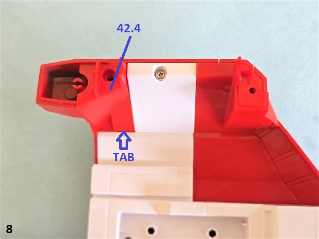

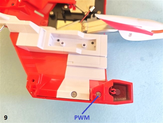

Position the right internal body plate 42.4 inside the main assembly, making sure that the "tab" on the lower edge is engaged first, Pic 8. Then fix the panel in place with a PWM screw, shown in Pic 9.

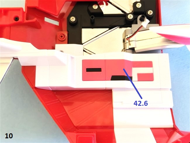

Now, carefully press the rear centre body panel 42.6 into position as shown in Pic 10.

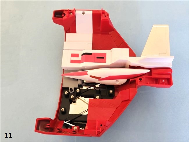

Check that the head/neck can be retracted as this assembly is now fixed in position (one side only), Pic 11.

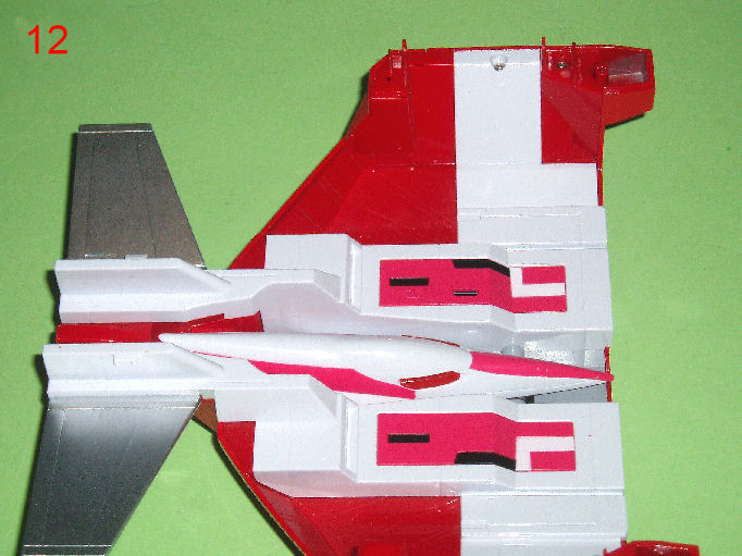

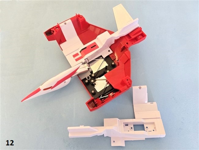

Final assembly and unused part shown in Pic 12.

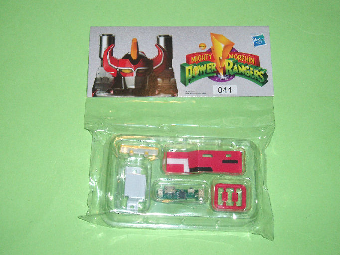

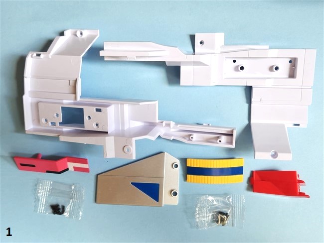

Parts supplied.....Pic 1, you also need the final assembly and unused part from the previous update.

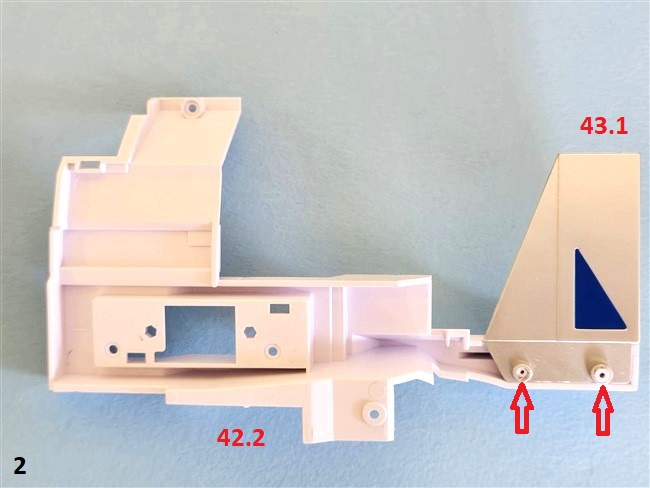

Start with the left side tail structure 42.2 and press fit the left rear wing 43.1 onto the posts as shown, Pic 2.

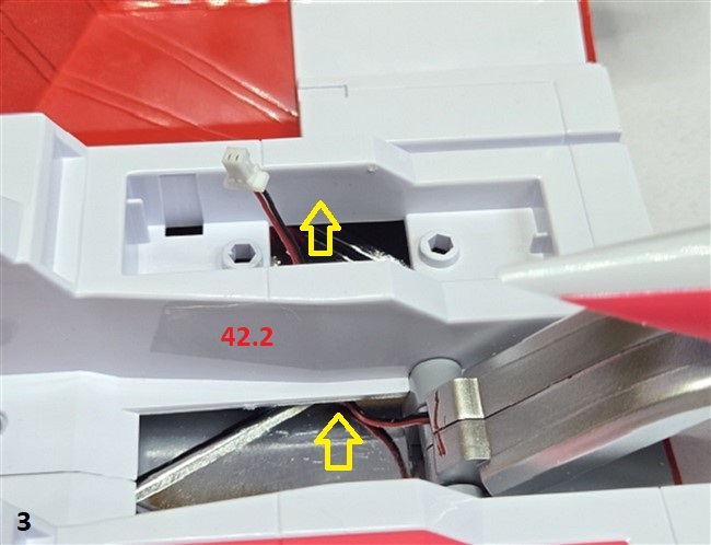

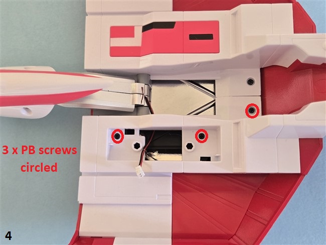

Place the head/neck assembly into the extended position and place the last assembly into the left side of the body. As you do, feed the wires from the neck through the hole as shown in Pic 3, then fix the parts together with 3 x PB screws shown in Pic 4. Now fix the outer edge with a PWM screw, as in Pic 5 and the tail end (from the outside) with a PB screw, shown in Pic 6.

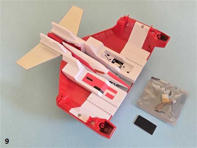

Pics 8 and 9 show how the assembly should look at this time.

Pic 1: Parts supplied
Pic 2: Retrieve the Pterodactyl assembly.

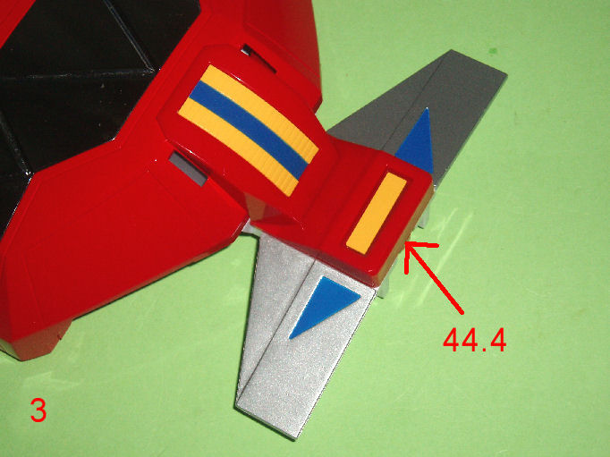

Pic 3: Press-fit the plate 44.4 in place as shown.

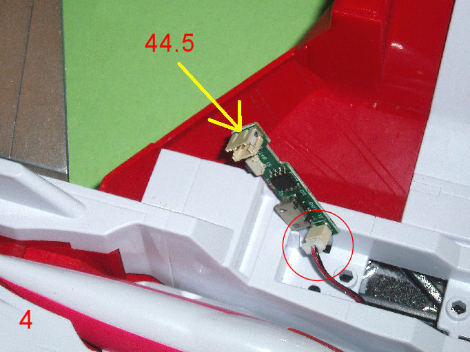

Pic 4: Connect the PCB 44.5 to the LED plug.

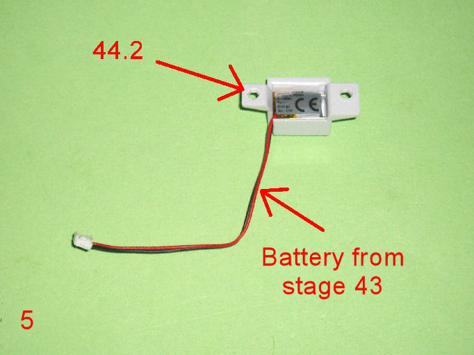

Pic 5: Fit the battery saved from the previous stage into the holder 44.2.
It will only fit one way.

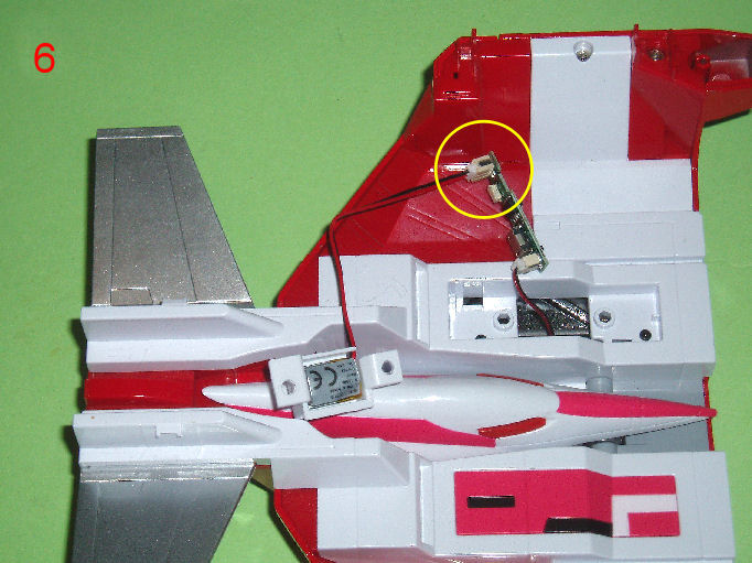

Pic 6: Connect the battery to the other terminal on the PCB.

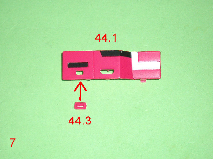

Pic 7: Locate the panel and button, 44.1 and 44.3.
Pic 8: Fit the parts together from the other side.

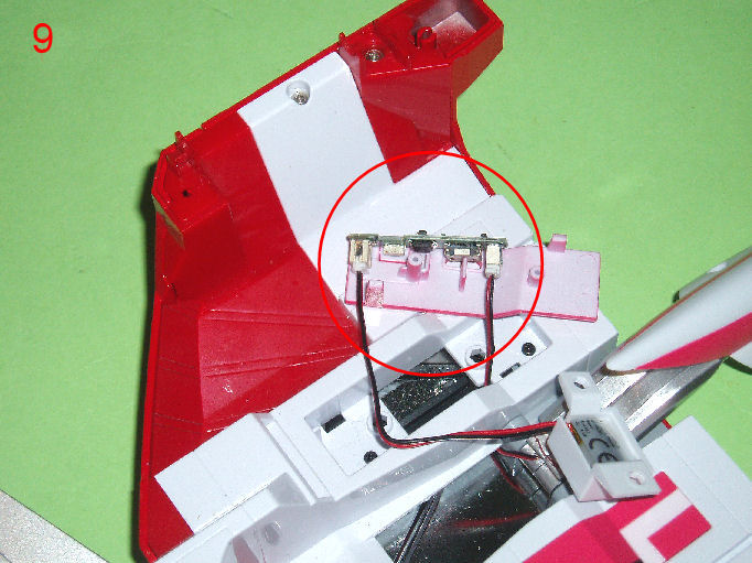

Pic 9: Fit the PCB into the side of the panel as shown.

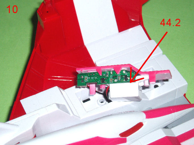

Pic 10: Press-fit the battery and box 44.2 onto the two pins on the panel, holding the PCB in place.
The battery box will only fit one way.

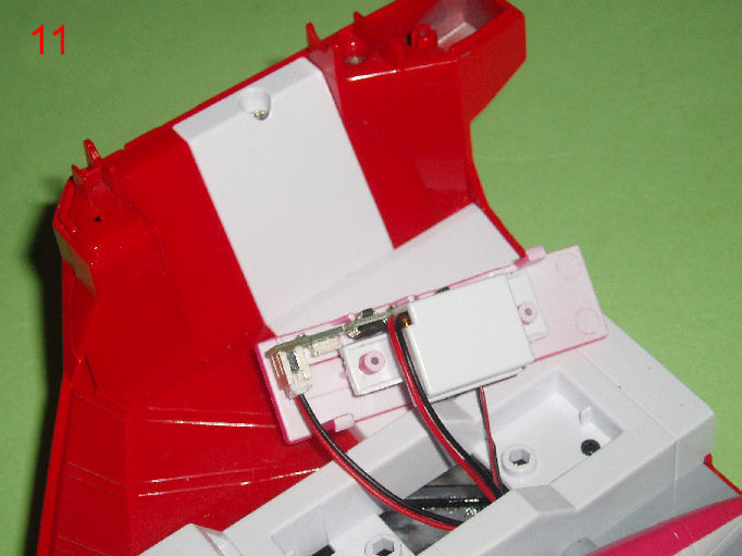

Pic 11: Another view of the assembly.
Pic 12: Keeping the wires out of the way inside the Pterodactyl, press-fit the assembled panel in place.
