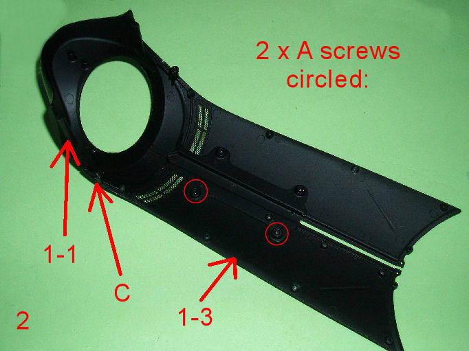

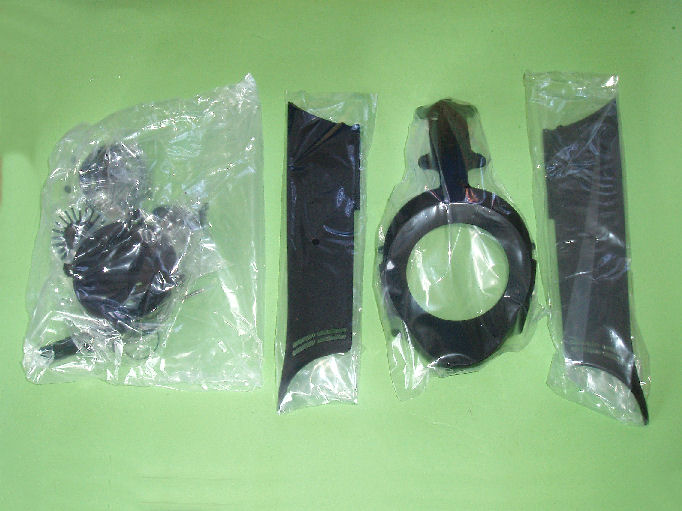

STAGE 1A:
Hood and turbine.

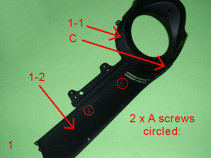

Pic 1: Fit the hood parts 1-1 and 1-2 together and fix with 2 x ‘A’ screws and 1 x ‘C’ screw.
Pic 2: Repeat with the other hood part 1-3.

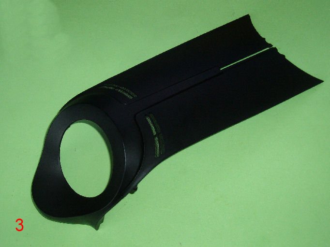

Pic 3: Shows the parts assembled.

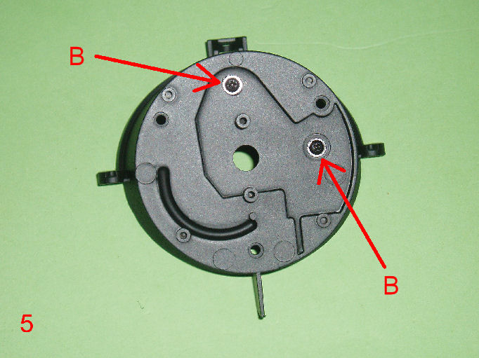

Pic 5: Fix from the other side with 2 x ‘B’ screws.

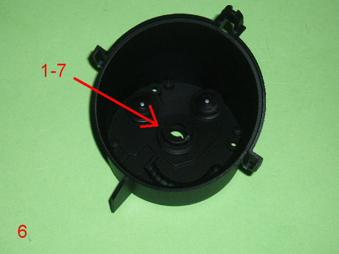

Pic 6: Fit the large pulley 1-7 in the centre of the housing.

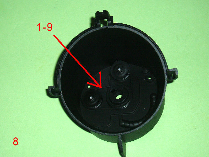

Pic 8: Fit the other band 1-9 around the pulleys as shown.
This band will locate in the upper groove in pulley 1-7.

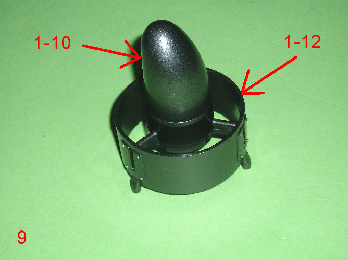

Pic 9: Fit the turbine parts 1-10 and 1-12 together as shown.

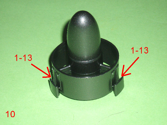

Pic 10: Press-fit the two vanes 1-13 into two of the slots in 1-12 as shown.

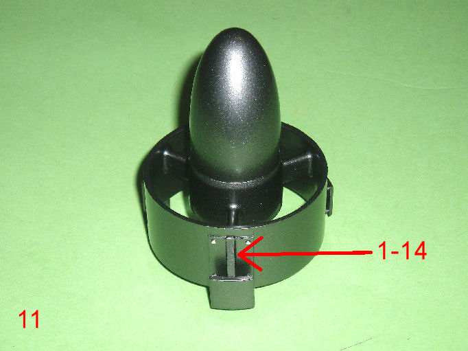

Pic 11: Fit the vane 1-14 into the other slot in 1-12.

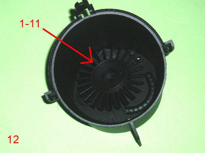

Pic 12: Fit the turbine blades 1-11 inside the housing.

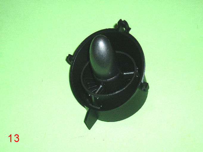

Pic 13: Fit the centre turbine assembly in place making sure the central cone angles up toward the widest part of the surround, and the screw locations are aligned with the holes underneath.

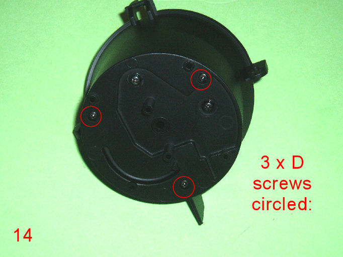

Pic 14: Fix the parts together with 3 x ‘D’ screws from underneath.

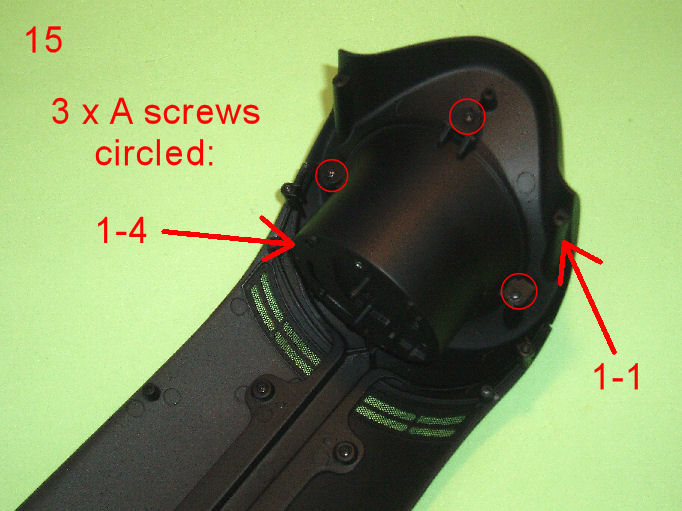

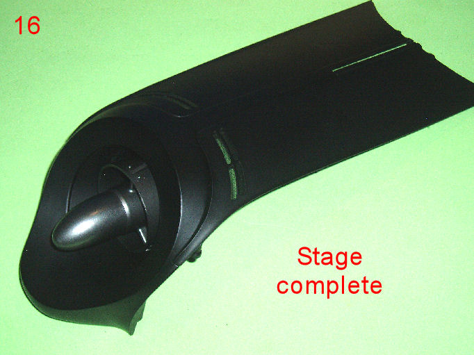

Pic 15: Fit the assembly 1-4 inside the upturned hood 1-1 and fix using 3 x ‘A’ screws.
Pic 16: Store the assembly safely for now.

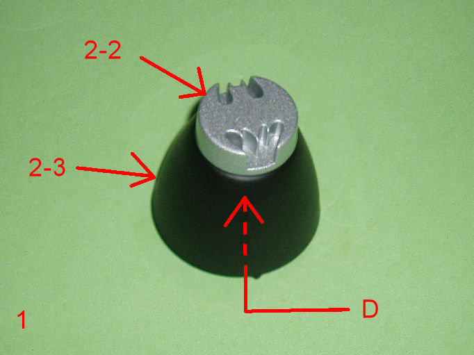

Pic 1: Fit the badge 2-2 to the hub 2-3 and fix from inside with 1 x ‘D’ screw.

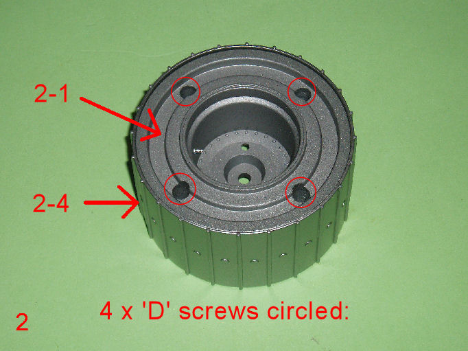

Pic 2: Fit the inner wheel 2-1 to the outer wheel 2-4 making sure the screw hole locations line up on both parts.
Fix together with 4 x ‘D’ screws.

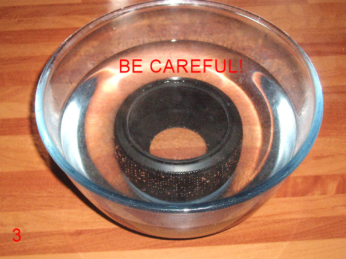

Pic 3: Soak the tyre 2-6 in hot water for around 1 minute.
TAKE CARE HERE.

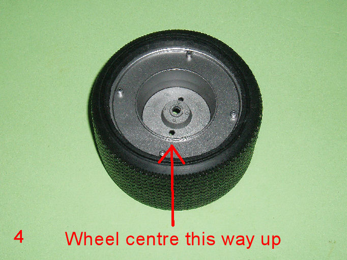

Fit the wheel into the tyre with the face of the wheel and the valve detail down.
Press firmly to fit the tyre over the wheel.

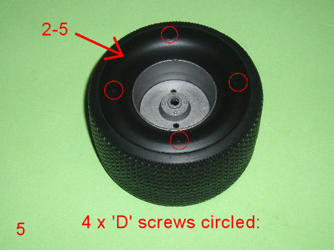

Pic 5: Fit the outer tyre panel 2-5 in place with the screw holes in alignment.
Fix the parts together with 4 x ‘D’ screws.
Do not over tighten these screws as you may drive them through the rubber.

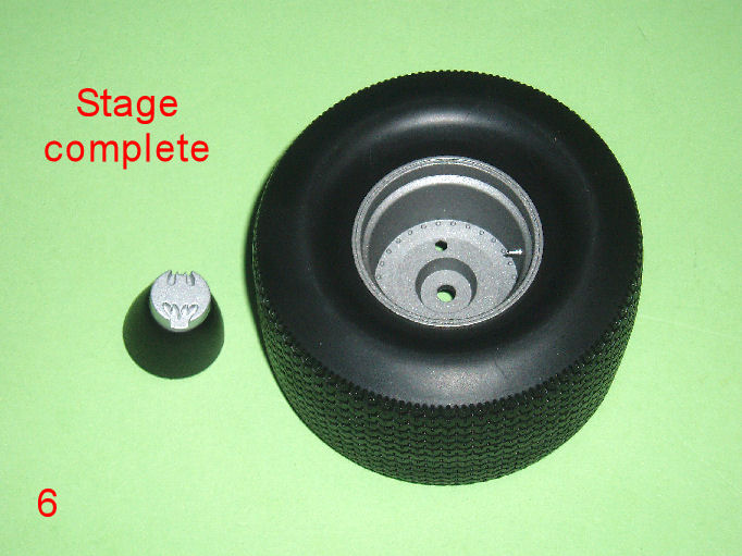

Pic 6: Store the parts safely for now.
