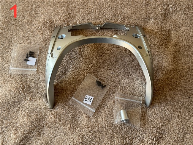

Picture 1 shows the parts for this issue.
The Back Assembly

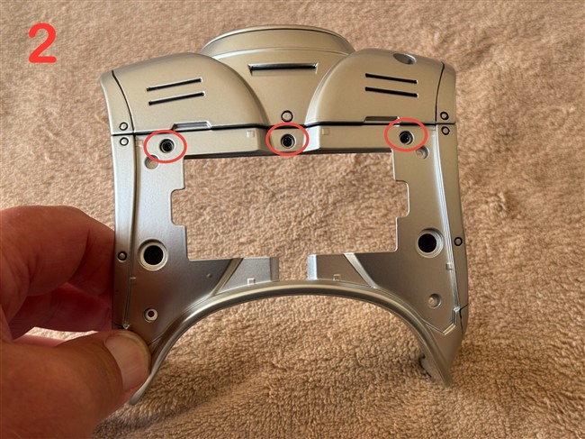

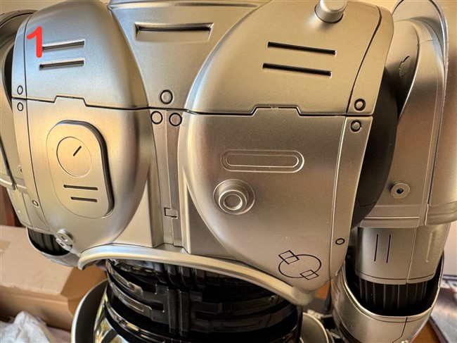

Connect the back of the shoulders (90A) to the back of the armour (91A), using 3 x EM screws, picture 2.

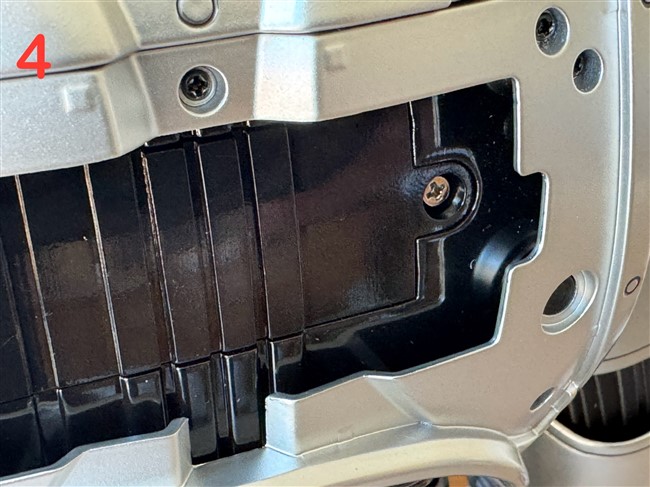

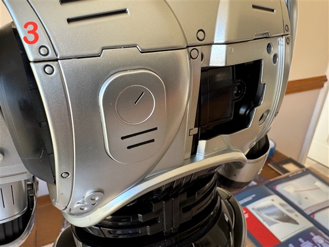

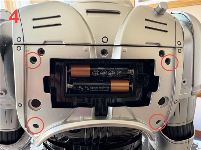

Insert the switch button (91B), picture 3. Attach the assembly onto the back of the model, securing it in place using 4 x EP screws as shown circled in picture 4.
Note: The magazine shows the two bottom screws to be located in the wrong holes. For the correct positioning, refer to the last picture.

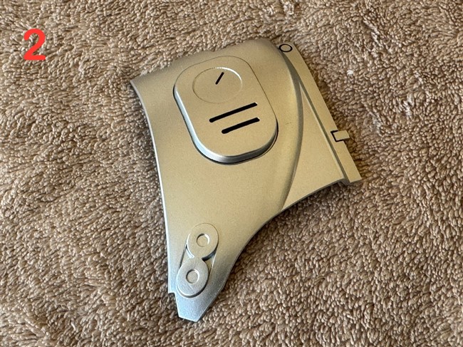

The Back Assembly

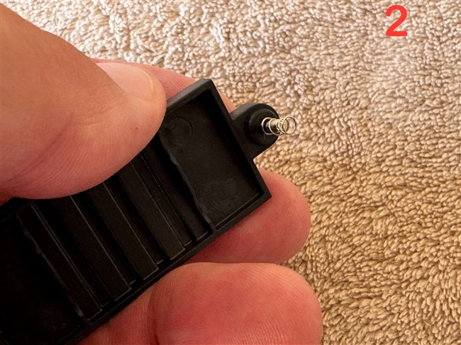

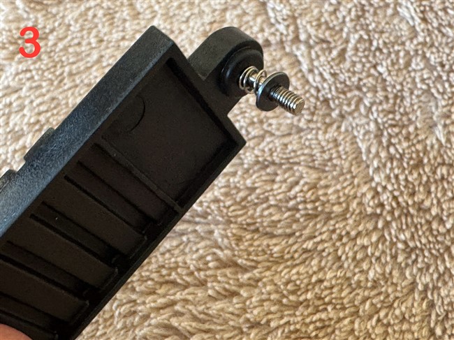

Insert the screw (92B) into the battery compartment cover (92A) from the outside, then place the spring (92C) over the screw, picture 2.
Now place the washer (92D) over the screw, picture 3. Note: You may need to screw the washer in place.
Attach the battery compartment cover onto the battery compartment and tighten up the screw to hold it in place, picture 4.

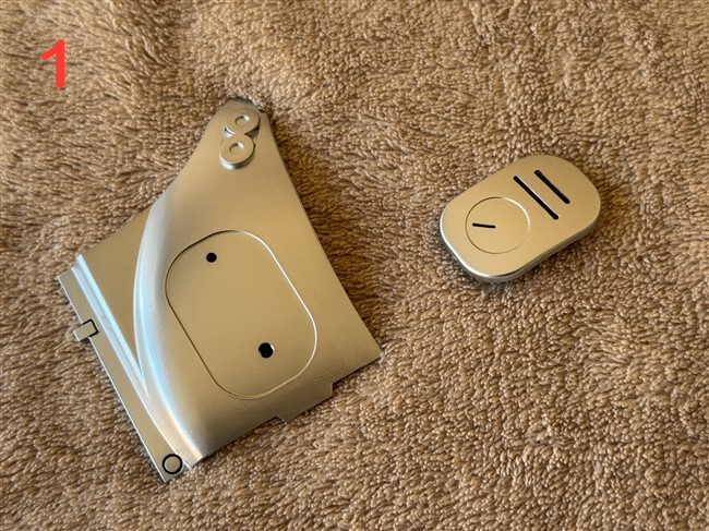

The Back Assembly
Place the left shoulder blade detail (93B) over the shoulder blade (93A) making sure the pins fit the holes, picture 2.
