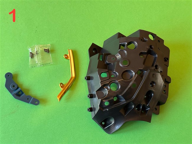

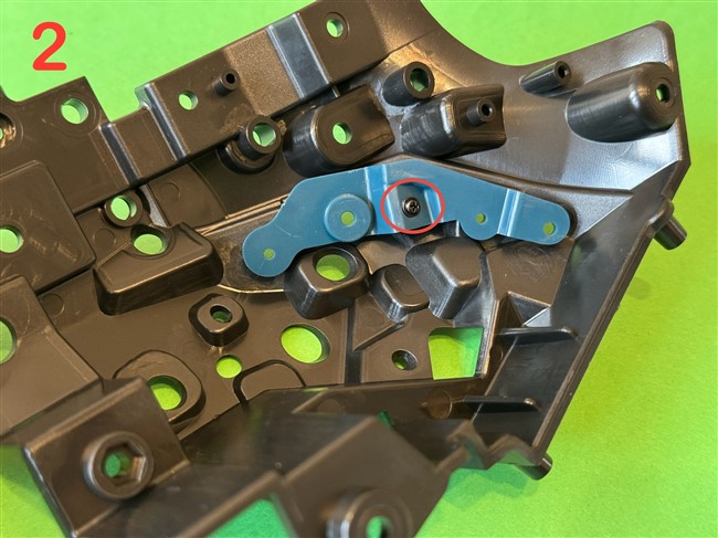

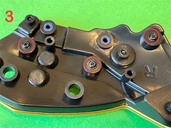

Issue 21

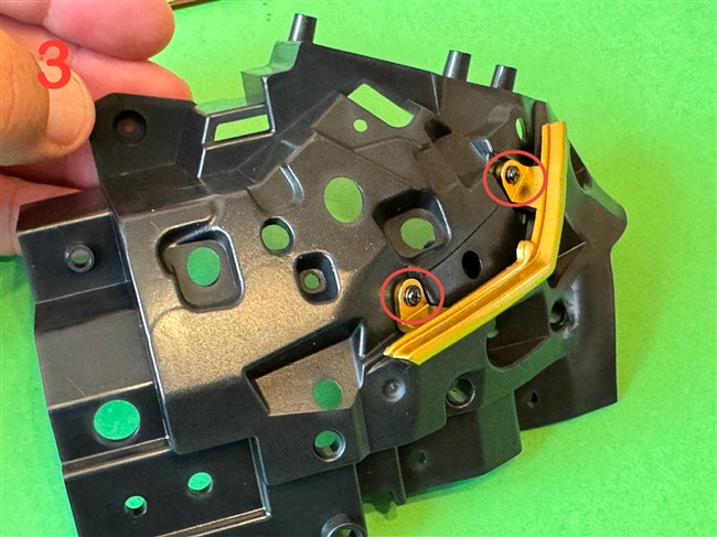

The Chest

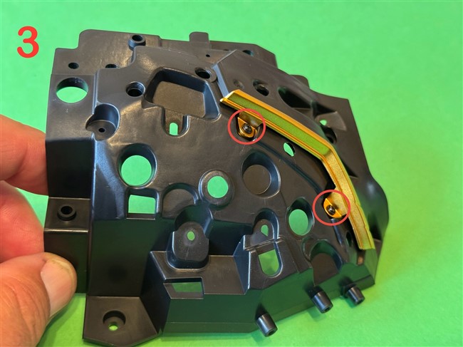

Fit the inner trim bracket inside the left chest frame and secure using an “E” type screw as illustrated in picture 2.
On the outside of the chest frame attach the gold trim using 2 x “E” screws, picture 3.

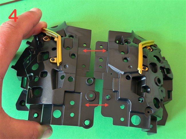

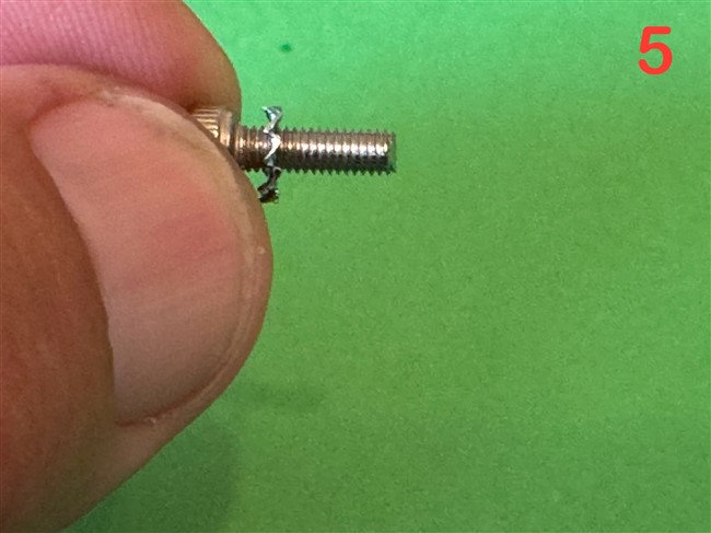

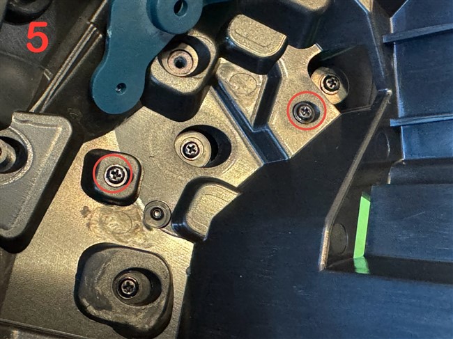

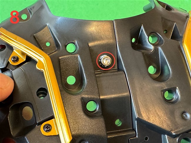

Issue 22
The Chest

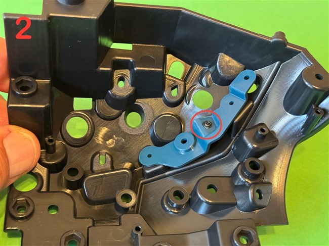

Fit the inner trim bracket inside the right chest frame and secure using an “E” type screw as illustrated in picture 2.

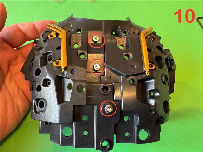

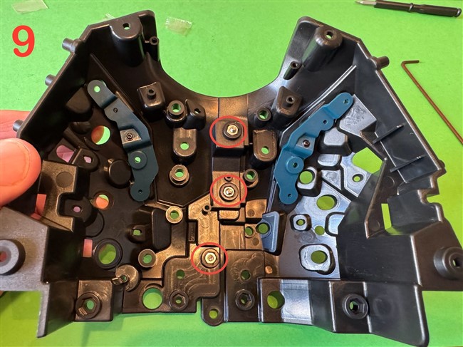

Retrieve the left chest frame and attach the two together, picture 4, using the type “H” bolts. Prepare the bolts by slipping an M3 washer over it, picture 5.

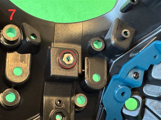

Once the two parts are together, picture 6, place an M3 nut on the inside of the frame as shown in picture 7. Hold this in place and turn the assembly over screwing in the bolt you prepared a moment ago, picture 8.
Continue with the other two bolts as shown in pictures 9 and 10.

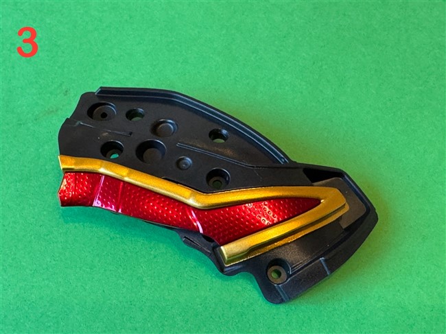

Issue 23
The Chest

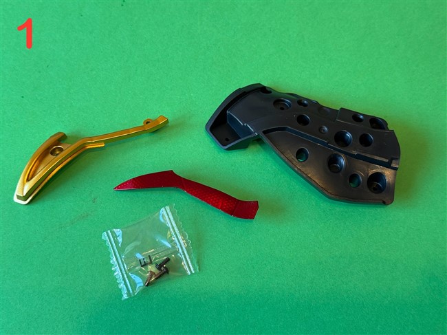

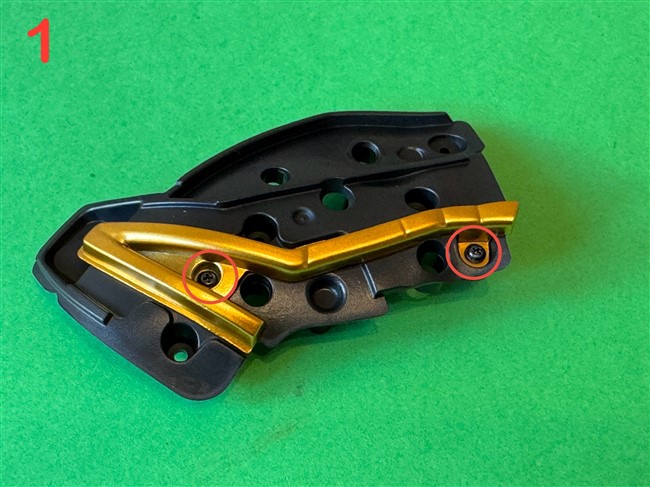

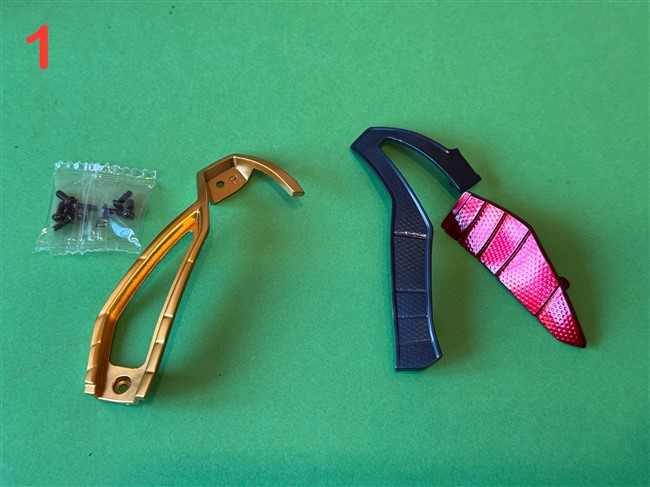

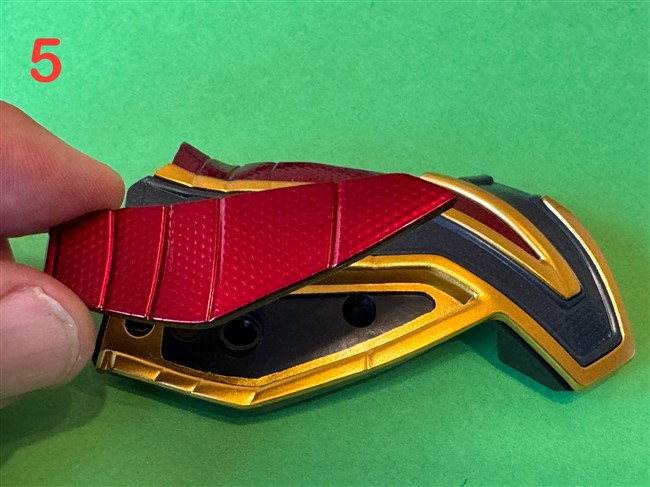

Fit the left breast plate gold trim and push it into position on the left breast plate, securing it using 2 x “E” screws, picture 1.
Push fit the breast plate lower red trim in place as shown in picture 2.

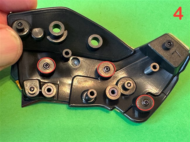

Issue 24

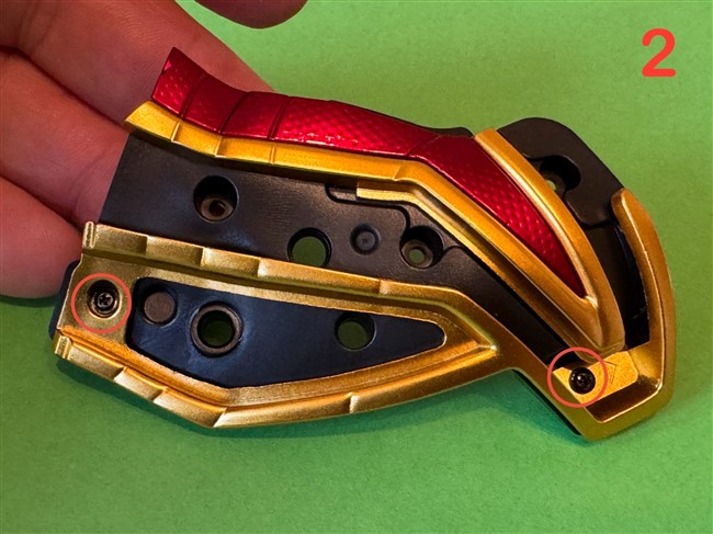

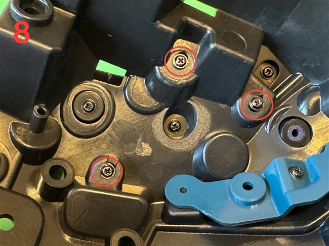

The Chest

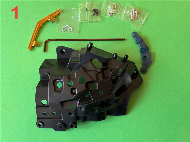

Retrieve the left breast plate from the previous issue and push the gold trim in place securing it using 2 x “E” screws, picture 2.

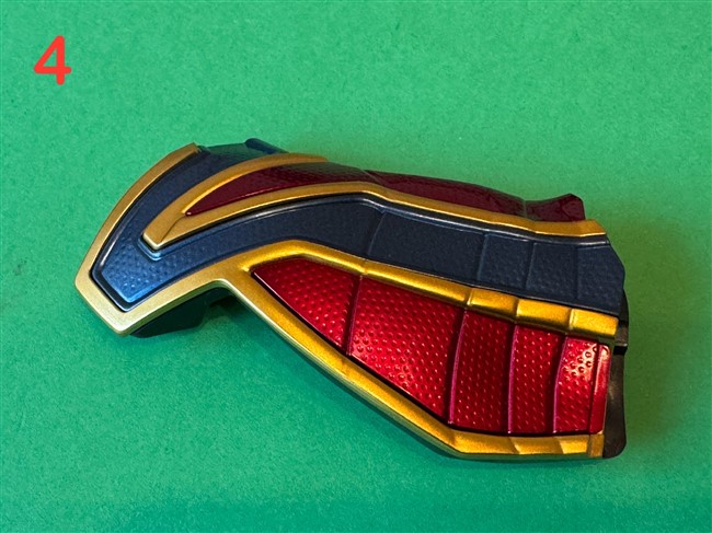

Take the blue centre plate, which has three pins and push it into position, picture 3. Turn the assembly over and secure the pins using 3 x “E” screws, picture 4.
To complete the beast plate push fit the red trim into position as shown in pictures 5 and 6.
Retrieve the chest frame and attach the breast plate as illustrated in picture 7. Turn the assembly over and secure the breast plate by using 3 x “E” screws as circled in picture 8.

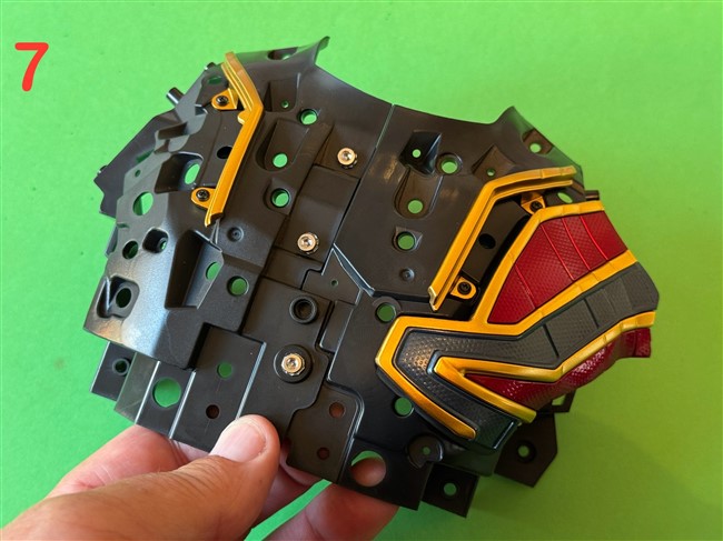

#5 Posted : 11 September 2025 10:22:58
Posts: 6,966
Points: 21,205

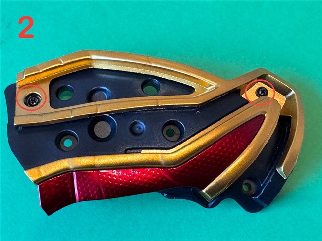

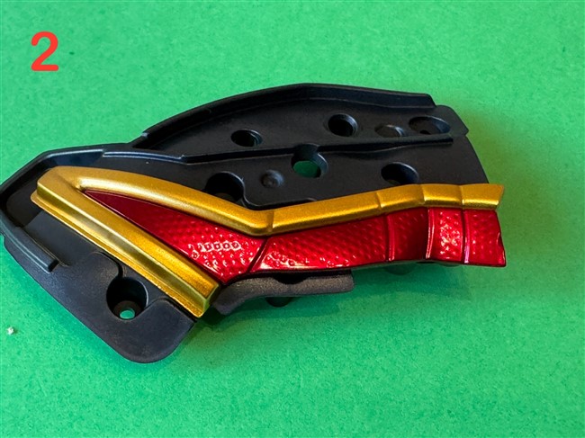

Issue 25
The Chest

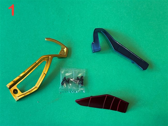

Fit the left breast plate gold trim and push it into position on the right breast plate, securing it using 2 x “E” screws, picture 2.
Push fit the breast plate lower red trim in place as shown in picture 3.

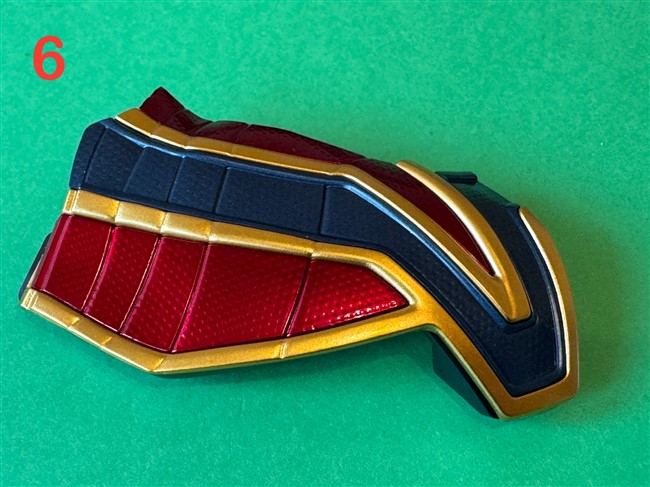

Issue 26

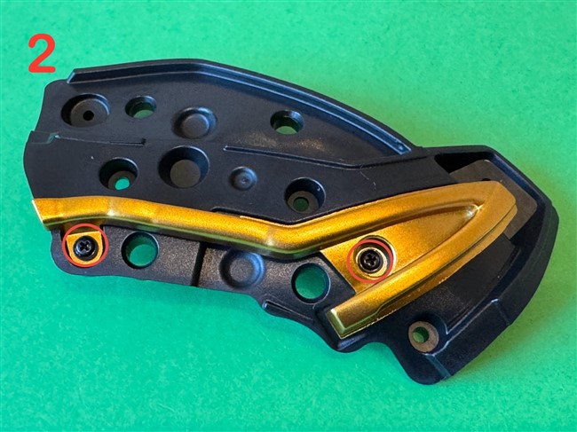

The Chest

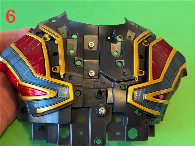

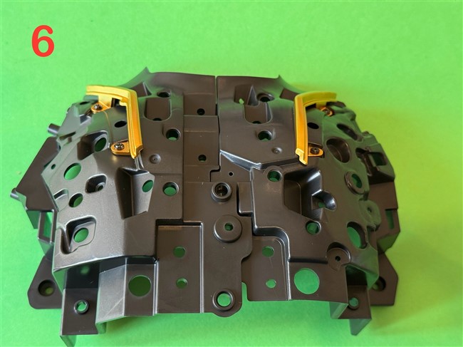

Retrieve the right breast plate from the previous issue and push the gold trim in place securing it using 2 x “E” screws, picture 2.
Take the blue centre plate, which has three pins and push it into position. Turn the assembly over and secure the pins using 3 x “E” screws, picture 3.
To complete the beast plate push fit the red trim into position as shown in picture 4.
Retrieve the chest frame and attach the breast plate as you did with the previous left breast plate. Turn the assembly over and secure the breast plate by using 2 x “E” screws as circled in picture 5.
Picture 6 shows the completed assembly for this issue.
