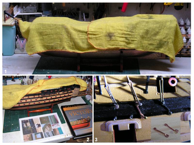

Well, she’s finally made it! The ‘Ole Vic’ is out of ‘Reserve’ and back on the workbench. I almost can’t believe how long it’s been – three years have gone by since the last work I did on her but that was a rebuild and completion of her figure head. As I said in that installment I’ll have to get back onto the chainwales and looking at that part of the build it’s almost five years to the day! The date of the last posting on this section was the 17th of January 2016!!Blushing Blink For all that time the old girl has been stored on the bench under her yellow duster tarpaulin and despite that (probably because they’re pretty old dusters and quite thin) she’s still managed to pick up a slight coat of fine dust in the nooks and crannies, especially inside the gun ports. Nothing too much though and easily brushed away with a soft paintbrush. The things I did notice however after removing the dusters shown in Photo 1 was that firstly, some of the blackened brass chains are more rusty than black now, again, not too bad but I’ll need to see how they compare with the new chains before deciding whether I’ll need to create a ‘rusty iron’ paint to bring them all to the same ‘look’ or not and secondly, after five years of summer heat and winter cold up in the attic workroom, a few of the mounted cannon have parted company with the deck and are only held in place by their rigging! This time around though I have that excellent Deluxe Card Glue and a pack of tiny disposable pipettes – I’m going to try sucking up a small quantity of the glue and ‘injecting’ it under the cannon to re-glue their wooden support blocks back to the deck again. That’s for later however, the first thing I had to do was to go back to my own diary and figure out what the heck I was doing down there five years ago! Photo 2 shows her together with a pair of printed diary pages to remind me of the task in hand (and how I was doing it) and the pair of reference books I’ve been using throughout the build. Having seen that I had made some little jigs to construct the chains on, the obvious next question was ‘What the hell did I do with them?’ Fortunately they weren’t far away (a miracle in my workroom) so I could try and get back into the routine of miniature blacksmithing again. Photo 3 shows the first of the lower brackets under construction. Made from 0.5mm copper wire, formed around the nail jig and then hammered out flat on the miniature jewellers anvil as shown in the insert. The first two brackets are seen test fitting in Photo 4 with the first one nailed in place in Photo 5. What I’ve changed this time around is that the hammered copper brackets are now being chemically blackened instead of painting them as I was before. They were painted with Admiralty Paints Metal Black but over the intervening years that bottle has dried out solid (strangely, all the other Admiralty colours are fine!) I’m using the last of my Blacken-it bottle for these chains and nails although I’ve just sent off on Ebay for a 10ml bottle of a blackening solution which looks very much like the old Blacken-it and its description says it works on brass, bronze, lead, pewter and copper. If it works that will be great (it was only £2.99!) Another thing I have changed is the material for the lower chains themselves. The first ones were made from 0.5mm brass wire, as you can see in Photo 6, before leaving the Victory for her unintentional period in Reserve, I’d made all the upper chain links for this port side main channel so I only have to do the slightly more complicated lower links (complicated as they are narrower at the bottom than the top!) For the rest of them however, I’m using 0.4mm brass wire (half hard). The difference in diameter is hardly noticeable but the wire is considerably easier to bend and shape. The brass chain links, brass fine nails and the copper brackets are first shaped, then dipped into a Poundshop bottle of Nail Polish remover (acetone) to completely de-grease them. After a gentle wrap up in a paper tissue they are then dropped into the Blacken-it, about half an inch deep in a re-cycled cleaned jam jar (cranberry sauce actually)! I’m also using a little item I bought to help with resin casting in the winter – a heat mat of the kind used for reptile and tarantula tanks (no I bought another one – my Tarantula is fine and warm still!BigGrin ) With the Blacken-it solution warmed up it only takes a few minutes to blacken the copper and brass, cold, it can take over an hour and left too long the parts come out half the size they went in. Once they are blackened off they are removed with tweezers and dropped into another glass jar full of clean water to neutralize the chemical then dabbed again with the paper tissue to dry them off ready for fixing in place. Also in Photo 6, the next lower chain along doesn’t have a bracket but is fixed directly to the hull right on the corner of the gun port. DelPrado builders have to take extreme care around these ports – under the wood surround is the cast metal box, which forms the actual gun port – tap a nail too close and its possible to dislodge the metal box away from the hull and rib – that’s why I always pre-drill the hole first to make sure nothing’s behind it!

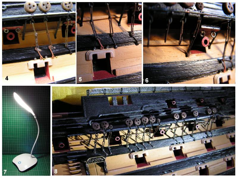

Another thing that I remembered after coming back to the Victory was the need for an extra, directed light source! All the lighting in my workroom comes from directly above the workbench. This is fine for the vast majority of the builds but has one drawback when I arrived at this stage all those years back – building the chains for the channels involves working underneath the channels themselves, in other words – in the shadows! You need a light source beaming into the work area from the side to illuminate the spot. Last time I was using my work lamp with umpteen white LEDs stood on its end. This was great but in the meantime the darned thing has broken its battery compartment lid and can’t be made to stay on. Looking on Ebay (as always) I found this super little reading lamp for just £6.39! It’s powered by an internal rechargeable battery which is charged up via a USB port (or one of my mains USB plugs I got for the Kindle), light as a feather and the neck is completely bendable to put the light just where its needed. There is no actual moving switch, just a printed symbol over a touch sensitive spot on the base – first touch switches it on, second makes it brighter, third brighter still and fourth turns it off again – an absolute bargain and easier than the start of this installment when I was balancing a Cree torch on top of a plastic mixing cup and roll of tape to get the right height for the spotlight!Blushing My new best tool is shown in Photo 7. Finally for this long overdue return, Photo 8 illustrates the completed port side Main Channel Chains assembly. Just checked the starboard channel – the deadeyes are all there, just got to start the entire chain part now!
Back again with that lot next, hopefully in a lot less than five years!BigGrin

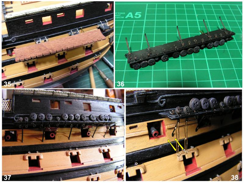

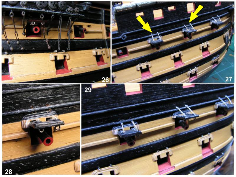

Many thanks for those kind words Tony! Yes, apart from those 'loose cannon' BigGrin she's in pretty good condition considering (plus the copper tape bottom is continuing to weather itself nicely too!)Cool
Well, the good news is the starboard Main Channel chains did NOT take five years to complete like the port side did!BigGrin That new source of blackening solution on ebay to try alongside my diminishing supply of the original ‘Blacken-it’ worked really well. I just bought a 10ml bottle to try out (it comes in 10, 20 or 30ml, or in other words one, two or three 10ml bottles) for £2.99 a bottle. The info on the site said it could be diluted down to about 1:10 with clean, preferably distilled water so I used some clean rain water but only mixed it in a 1:1 solution giving me a 20ml supply in a clean cranberry sauce glass jar. With the jar left tightly capped and stood on the heat mat to warm it up, the solution will turn the brass wire black in about thirty seconds and the copper brackets in about a minute! (After a quick bath in the acetone first). Photo 9 shows the first part of the procedure with all the thirteen brass upper chain links shaped and blackened hanging off the deadeyes. As well as the blackening going well I also improved upon the technique for making the lower links and the copper brackets. I had already made up the first five links starting from the aft using the old method – measuring what I thought the link should be, making it up and then test fitting it to find if it was the correct length, before having to make another, either one size bigger or smaller. You’d think simply measuring it would be accurate enough but getting in there with a ruler or even callipers is very difficult and even then the angle the chain will eventually run down at can be off making the measurement a mm or two off as well. The original jig I made up those five years ago is shown in Photo 10 and this is still used in the same way. But after the fifth link I had a brainwave. Actually not a brainwave, just a good idea – if I’d thought of this right at the start THEN it would have been a brainwave!Blink Using the jig, I made up a set of measuring links with a hook at the top end and a ring at the other, bent up slightly to simulate the bend at the end of the real link where the nail passes through both the link and the copper bracket to nail it to the hull as seen in Photo 11. Now, to find the correct size of lower link I simply have to hook the gauge over the upper link and see if the ring touches the hull in the right place. As you can see in Photo 12, the smallest 6mm gauge isn’t long enough to reach, whilst in Photo 13, the 10mm one is just right! This made constructing the bottom links far more precise (with much less wastage of brass wire!) The other slight change was in the creation of the copper brackets. At the same time as I thought up the gauges I moved from hammering out the copper wire with the little jeweller’s hammer to placing the formed copper bracket under the shank part of the iron punch I’m using to tap in the final bit of the brass nails (to avoid smashing great dints into the wooden hull!) By placing the bracket under the shank and tapping that with the hammer I get a more even flattening of the copper. This is almost like Nelson’s Navy as it moved from individual blacksmith produced ironwork to industrial steam press mass production – although if any dockyard blacksmith of that era saw my diddy jeweller’s hammer he’d have to go home for the day with uncontrollable laughter!BigGrin The ‘steam press’ is shown on my equally laughable anvil with a ‘raw’ and flattened copper bracket in Photo 14 with a close up of the brackets in Photo 15. As well as new techniques, I’ve also got a couple of new tools shown in Photo 16. Firstly, my best electronics wire snips are ‘adequate’ for cutting the brass wire but they could be a little sharper or finer so I’ve tried something different – instead of really expensive wire snips I’m going to try the ones shown here which are actually pedicure nail clippers! I’ve tried them on the 0.4mm brass wire and they give a lovely neat cut. I’ll give them a good try-out on the Fore-channels, which are next in line. The tweezers are the other new buy. I was finding that holding the blackened links and moving them about with normal tweezers was causing scratches, which meant another dip in the blackening bath so this set is made of plastic! They’re meant for electronic work really, eg, non-conductive, but the pointy ended ones have proved ideal for this job. The only contact with a metal tool after blackening now is the final closing of the open upper link once the lower one is hooked on. I tried using the plastic ones but they’re not quite strong enough to bend the brass. Photo 17 is to illustrate just how effective that new blackening solution is and the final Photo 18 shows the entire starboard Main Channel fully chained to the hull below – only four years and fifty-one weeks quicker!
The Fore Channels are next of course, but before those get underway its time to try and get some glue under those wobbly cannon to fix them down again. Once that is done I’ll have to try and re-build the mini router set up I made from my mini drill stand to carry on with the Fore Channels. The wood is already shaped apart from the subtle inner curve to fit the hull, and they just need the groove for the copper wire surround – ah! Belay that!Blushing Just picked up the channels and I must have routered the grooves when I did the others! Brilliant!Cool Just need to mark out and file the positions for the deadeye strops to fit into then. In the meantime I want to try and make new moulds for the scratch built crew figures I started five years or so ago, and try casting them in resin instead of white metal (that’ll work out cheaper in the long run!)

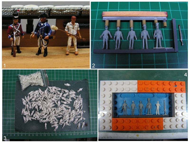

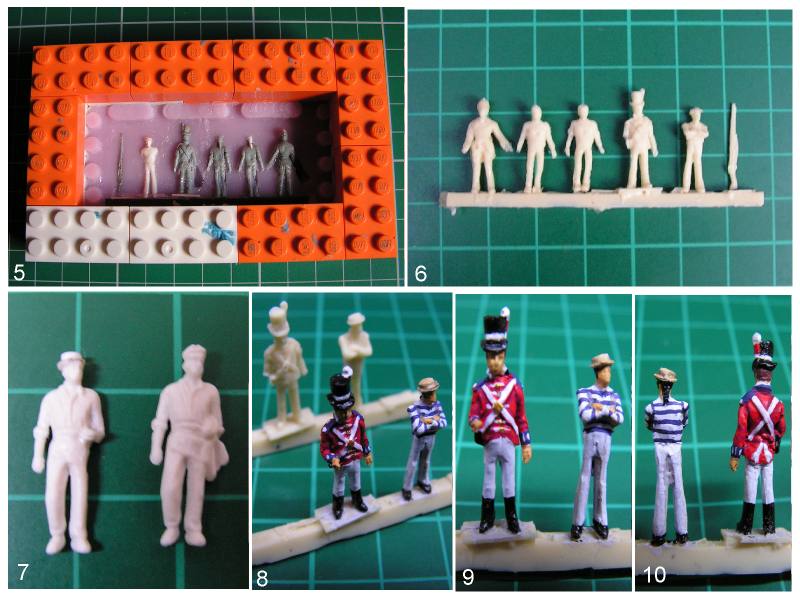

Hello again to all! As I mentioned in the last installment, as a break from continuing on with the foremast channels I’ve gone back to the crew figures I began some years ago now, which are shown in Photo 1. There were five figures in the original mould, which was designed for casting with white metal (although I only made up the first three as painted models). The initial idea was that I was going to cast them in metal and then carefully bend the arms into a variety of positions for the various crew. As you have probably noticed I have since fallen in love with casting acrylic resin and so I’ve decided to try and convert the original figures and add some more to create a cheaper alternative to the white metal (the price of which has gone through the roof in recent years!)Crying The original sprue of figures for the high temperature mould is seen in Photo 2 and since they were created I’ve also added somewhat to the available ‘source’ material as shown in Photo 3. The first figures were created from the contents of the little bag (about 50 of them I think), the larger collection is a whole 100 which includes a few new poses as well. These are of course 1/100 scale ‘architectural’ figures, also invaluable for N gauge model railways too! If you can wait for them to arrive from China they are incredibly cheap as well. I think the first bag may have been Japanese in origin as it contained a few Geishas in amongst the collection (not very useful for an 1805 HMS Victory!)Blink The new set has some more appropriate items including one that appears stripped to the waist and some children (awaiting conversion to powder monkeys I hope.) Photo 4 shows the new mould under way with the Boatswain’s Mate figure replaced with one of the new conversions’ as I wanted to build up the coat on the Bosun’s Mate (or 'Boatswine' as Corporal Jones calls them) a little more.
After pouring in the first half of the silicone rubber and letting it cure overnight we have the half mould as seen in Photo 5. Note the white ‘pigtail’ on the second figure from the right – his original came away with the plasticene so I had to re-model a new one with plastic putty ‘in situ’ before coating the rubber with a layer of Vaseline to prevent the second silicone mould from bonding to the first (and it wouldn’t be the first time either – sometimes the Vaseline isn’t thick enough, especially the liquid variety sold for just this purpose, and once I forgot to apply the ruddy stuff!)Blushing Anyway, after adding another row of Lego bricks and filling it up with the silicone I had a finished mould, which produced a line of little figures as shown in Photo 6. Not all perfect (the first attempt rarely is), one of the seamen has no hand and the Marine is missing his right forearm. In fact, the missing Marine’s arm continued to persist no matter how I tried to tweak the resin into the mould with cocktail sticks etc. For the demonstration figure I eventually made a new arm with plastic putty by applying a drop of putty at the elbow and shaping it with a sewing needle. I think the probable answer is to carefully cut off some arms from the basic figures, cut and glue them into different positions with rolled up sleeves or cuffs and then make a little separate mould to cast a selection at a time and basically make tiny ‘Multipose’ figures (remember the Airfix Multipose?) with separate arms.
Photo 7 illustrates the most basic conversions, here a figure which might be a steam train driver with conveniently rolled up sleeves and open shirt, carrying a jacket over his arm has simply had the jacket carved away (unfortunately his left hand is under the jacket and had to go too), his peaked cap was cut away and replaced with a scratch built straw hat from plasticard. This one with three or four others will be making up a second figure mould soon. Photo 8 shows two of the resin figures after a coat of paint with the ‘raw’ castings behind and Photos 9 and 10 are a close up view of them from front and back. The faces are awaiting a flesh wash ink to pick out the details and I’m awaiting a new bottle of flesh wash – my decades old bottle of Citadel wash has dried out solid – I tried adding a few drops of water but I think its had it!
So that’s it for the moment, at least I’ve proved to myself that the old white metal figures were ‘convertible’ to resin and that reminds me of something! The DelPrado kit only supplied enough deck cannon for the positions at the gun ports. The bigger scale Victory kits (like the Jotika kit on which I'm basing my Victory, often have two extra cannon lashed down on the forward deck and I always wished afterwards that I’d got into this resin lark before I glued and rigged them all in place, then I had a brainwave and checked on ebay. Now I’ve got a spare magazine complete with the cannon to make a rubber mould from, so I can stick another two ‘up front’ (like all the big boys)!BigGrin
Stop Press – the flesh wash has just arrived and I’ve tried it on the figures. Certainly makes a great difference especially on the Marine who has more definition on his face than the seaman. This wash didn’t need any extra thinning (though it might on larger scale figures) and is made by a Danish company called “The Army Painter”, a firm I only came across a short while ago when I bought their “Rough Iron” colour to touch in any chips in the chemical blacking on the channel chains. The Army Painter specializes in war games figures with a colour range which includes both historical and fantasy themes. I’ve only got the two colours so far but I’m really impressed with the quality.
The next installment will either be a few more figures or else the foremast channels (depends on how much moving around I have to do to start the Ferrari!)Cool

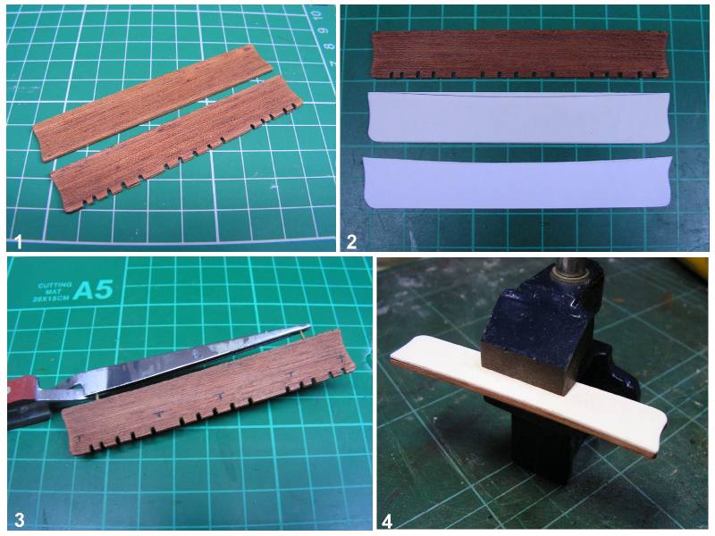

As forecast all those years ago, the next section is indeed the Forechannels, which were last seen (minus the notches for the deadeyes) as shown in Photo 1. Both the channels had been cut to size and the ends shaped with the groove for the decorative edging also ground in. There was one last piece of shaping to complete however – as shown in Photo 2, the back edge which fits against the hull is not actually straight – it has a concave curve in it to fit the curvature of the hull as it begins to swing in towards the bow. The pre-curved channel is seen at the top, at the bottom is a thin card template created after using one of those multi pin contour thingies used for skirting boards and similar – plus a bit of trial and error until it fitted just right. In the centre is a 1mm plasticard second template with that curve pencilled in from the card template ready to be ground down with the rotary tool and its sanding drum. Photos 3 and 4 are really reversed in order. Photo 3 shows the port side channel with the curve sanded down by the same drum and with the deadeye notches laboriously filed out with the diamond dust flat file. The second channel (although in actual fact it became the third) would prove to be far easier with one of those new tools I mentioned! The little pencilled ‘T’s are marking where the tiny ring bolts have to go in. Photo 4 shows how that curve was created with the plasticard template tightly pressed against the wooden channel in the mini vice. The excess wood was then sanded away via the drum until it matched up with the template. The first test fitting onto the hull is shown in Photo 5. Two holes were drilled into the rear of the channel and a pair of 0.5mm brass rods superglued into them. Corresponding holes were then drilled into the (extremely thin) square moulding which runs just above the gun port lids (easier said than done!). This was the point where I discovered a ‘slight’ problem!Blushing The size of the channel and the placement of the deadeye strops had been worked out from the drawings in the excellent Alan McGowan book on the Victory and her restoration. Doing that of course relied on the actual placement of the gun ports themselves being just as accurate – as it turned out, that was not exactly what I got. The actual kit parts for the forechannels are slightly bigger than my replacements with the cut outs also a little different. The result was that a couple of the cut outs were bang in the centre of the gun ports. The ones towards the aft were ‘do-able’ as the slope in the chains would carry them clear of the gun barrel but the more vertical ones up forward would be a real problem. I had a go at trying to move the cut outs by filling in the bad ones and re-cutting new ones but as you’ll see in a later photo it didn’t quite work, if the new cut out was going into part of the old one the glued in filler simply flew out again. In the end there was only one other option – the starboard channel was re-assigned to the port and I had to make up a replacement one for the starboard. With the new cut outs filed out it was time to make up the ring bolts which sit inboard of the deadeyes. Incidently, the term ‘Deadeyes’ was, I’d always thought, because the three holes looked like a face with staring dead eyes. Not so in fact! I recently got a really useful little book on the Victory full of lovely clear photos and it appears that the deadeyes are so termed because the rigging ropes which connect the upper one to the lower are tied off in a knot before running up and down and then tied off on the shroud rope. Because the rigging cannot move without being adjusted by hand it is termed ‘dead’. Just a bit of useless information for those interested!BigGrin

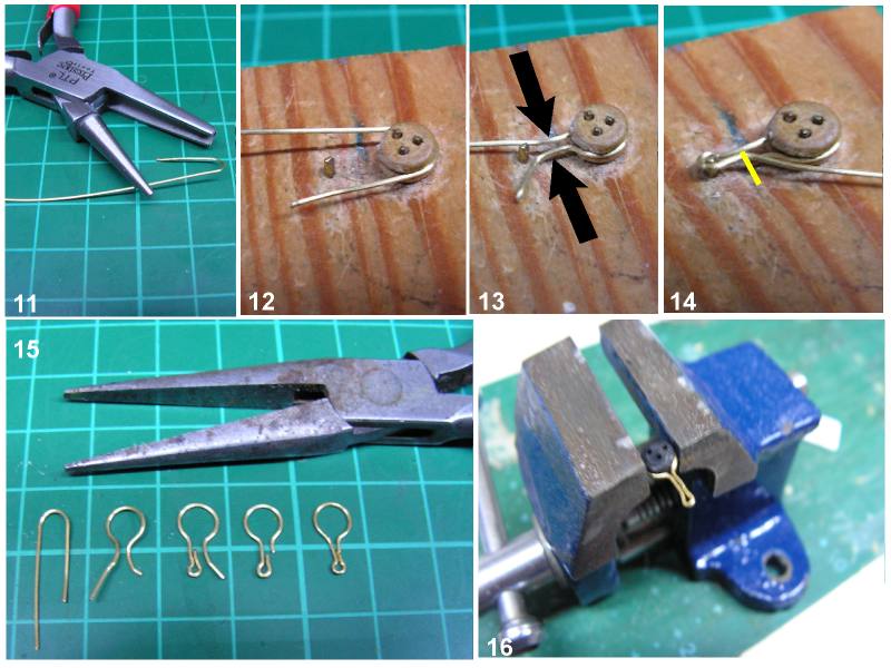

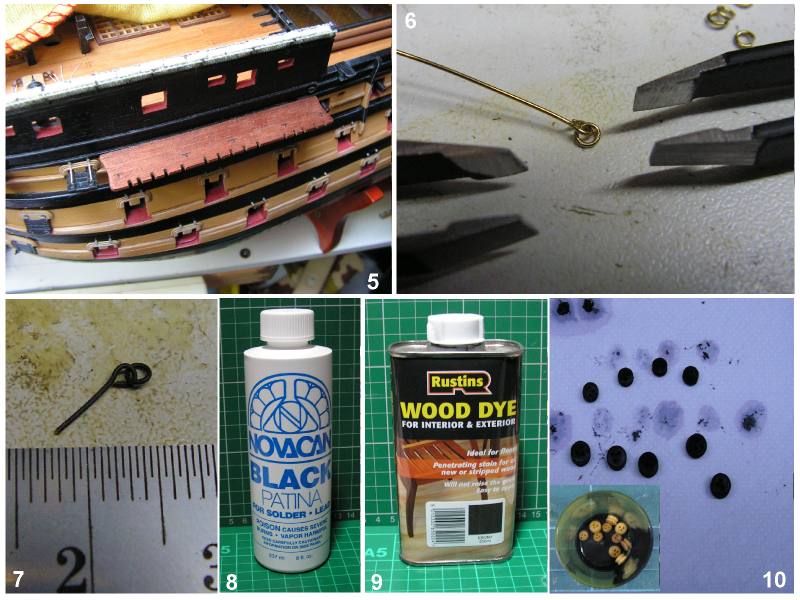

The ringbolts are shown during construction in Photo 6, those heavy duty jaws in the photo are actually two of the eyebrow tweezers from the set I got to help bend the parts of the Mars Lander. Photo 7 illustrates the same bolt after snipping off the 0.4mm brass wire and having been bathed in my new blackening solution. The main problem I’ve found with chemical blackening is getting the brass to go black after it has been soldered. The old ‘Blacken It’ solution used to work great but the company producing it went out of business some years ago. My Phillips Cold Blue for gun barrels only works on steel but not brass (or solder) and the other one I tried, the American Birchwood Brass Black works great on brass (and also copper and bronze) but won’t touch the solder. I finally found the one shown in Photo 8 on ebay, called ‘Novacan Black Patina’, this was designed to be used on lead profiles used in stained glass windows and such like and will happily blacken both lead based solder and brass at the same time. As you can see from Photo 7, it does a good job creating a real ‘wrought iron’ effect on brass. The other part of the deadeye is, of course, the wooden deadeye itself. To turn these bare wood parts black as well I used a tin of Rustins Ebony Wood Dye as seen in Photo 9. This is a spirit based dye which won’t raise the grain in wooden items unlike water based dyes, and to colour the deadeyes I simply pour enough of the dye to cover the deadeyes in one of the little plastic resin mixing cups and leave them overnight before draining the dye off and back into the tin, leaving the now black deadeyes to dry off on a piece of toilet tissue. The before and after can be seen in Photo 10. Next came the manufacturing of the iron strops. Photo 11 shows one of the new tools I acquired to make the job a little easier. These special pliers are designed to impart a nice curve onto straight wire which saves having to bend it around a suitable rod or cylinder (just getting lazy now!) A few rough guesses finds the exact point on the plier jaws to create the exact fit, mark that with a permanent marker pen and its easy from there on. My old deadeye jig is still going strong, just a deadeye permanently nailed into a base with another nail at the point where the strop makes a ring for the chain to hitch onto. Photos 12 to 14 illustrate the procedure: hook the curved wire over the deadeye groove, then using long nosed pliers crimp the two sides of the wire below the deadeye and then loop one end of the wire around the bottom nail and crimp it in tight before snipping off the excess where the yellow line is shown. Photo 15 shows the entire procedure along with the long nosed pliers used to effect the crimping. Having got it all nice and tight, you then have to gently prise it apart again to insert a wooden deadeye in the big loop and then insert the strop and deadeye into a mini vice as seen in Photo 16 and gently squeeze it until the two ends meet up again at which point they can be soldered together. The finished items are shown in Photo 17, the soldered joins having been filed down flat, the one on the right having also been blackened in the Novacan Black. That then left just the smaller (or tiny) little deadeyes to do. I forget what size these are, its either 2mm or 2.5mm, either way, the procedure is the same, just much more fiddlyBlink . The original wooden jig for these smaller ones was rapidly wearing out as the pliers were gouging out the softwood base so I bought a block of good old English Oak and made this the first jig to go on it as shown in Photo 18. Instead of having a small deadeye nailed down as before I drilled and inserted a piece of brass rod the same diameter as the groove on the deadeye. The small strops can be seen in the photo with the bigger ones in the cup above, they were all kept under a layer of isopropyl alcohol until needed to clean off any oily residue before soldering. Photo 19 will give you a sense of the scale of these little so and so’s, (more than one of them had to be hunted for on the workroom floor!) The full family of deadeyes is shown glued into the black painted channel in the final Photo 20, they are just awaiting the copper decorative edging to be fitted on (which comes in the next instalment). In the insert is that repair job on the first channel I mentioned earlier. The slot in the middle isn’t new, it was just the only one that was in the right place!Blushing
So in the following instalment the replacement channel is produced using another new gizmo which is proving very useful, and the metal chains and brackets are begun to complete this section.
Robin.

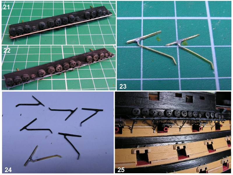

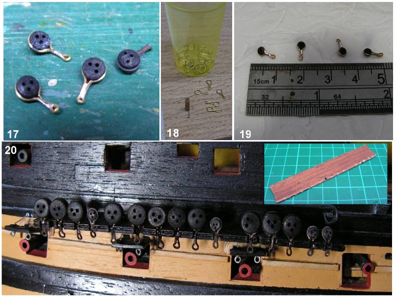

As mentioned last time, the wooden channels now required the decorative edging strip. This is shown after super gluing into place in Photo 21. The copper wire was first stretched between a couple of pliers removing the coil curve and leaving a nice straight rod. This was glued along the front of the channel and once set the two concave ends were gently smoothed into position and then glued in turn (I used super glue gel initially to get the wire fixed and then a thin superglue applied via cocktail stick to seal the wire in firmly. Once all was dry the copper wire was first primed with Vallejo grey primer and then given a coat of Admiralty Dull Black acrylic and finally, a dry brushing of Vallejo light grey to accentuate the edging, (the exposure isn’t quite right in Photo 22, it’s not as pronounced as it appears!) At this point, I super glued the channel in place on the hull – the starboard channel will be hopefully following a slightly different technique as the following part was one of those ‘tear your hair out’ moments! With the channel in place I then had to create the five iron brackets which help to support the channel (non existent on the kit unfortunately, though not exactly unexpectedly!BigGrin ) Two of them are shown in Photo 23. The ones on the Main and Mizzen channels were made from 0.5mm brass strip for the top bits and 0.3mm strip for the supports. Unfortunately I had run out of the rest of that brass so I went to order some more. Also unfortunately I then discovered that the company I’d got the brass from; “Eileen’s Emporium” had ceased trading (some years earlier)Blink . I managed to get some 0.5mm on ebay but no-one had any 0.3mm so I had to go for 0.2mm instead. 0.1mm may not sound like much but it certainly makes a difference in how firm or flimsy that support feels when trying to solder it!
Photo 24 shows the set of five supports after blackening along with a sixth one which I kept back as a pattern for the other set later (and then went and lost the darned thing and had to start from scratch anyway!) Trying to super glue those things in underneath the channel was a nightmare! I had to have the hull balanced at almost forty five degrees to be able to even see what I was doing and the tweezers kept pinging the supports off in all directions at high speeds. As I said, the starboard channel is going to go together a little differently to try and make it a bit easier to get the bits in place. Eventually I managed to get all the supports glued down (or more appropriately, up) and the channel then appeared as it looks in Photo 25. Now came another really fiddly part, adding in the chains securing the deadeyes to the hull. The port side chains are shown underway in Photo 26, each one is composed of three sections or links. The upper link, which connects onto the deadeye strop, is a straight forward parallel link and is the same size for all the deadeyes. The second link is a little more complicated, it is wider at the top and then reduces in width until the bottom where it has a slightly larger ring for the bolt to pass through. The third section isn’t so much a link as a bracket, almost like a flattened dumbbell . This is used to fix the entire chain into the hull timber via two bolts which are drilled into the thicker upper wale running below the gun ports. Fortunately, on the forechannels these brackets are fitted to the wale itself. On the main channel, some of them are longer than the wale and have a double ninety degree ‘kink’ on the bottom to run from the wale to the proper hull!Blink In this photo, the last two chains visible are awaiting the bottom brackets (actually it was only one of them, the other was supposed to be a shorter chain for the smaller deadeyes so I had to change that one later!)Blushing

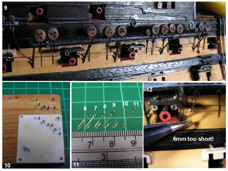

With the port side completed it was time to begin on the starboard. This was when I suddenly realised I had made a little – OK, BIG mistake when I was rigging up the gunports all those years ago! The port side gunports were fine (which was why this came as a big surprise) but on the starboard side, as shown arrowed in Photo 27, I had mistakenly put the lead tubes for the gunport lid tackle above the thin moulding instead of under it as I had on the other side! The problem being of course is that the wooden channel actually sits on that moulding so there was no way for the tackle ropes to pass through it. The foremost gunport isn’t arrowed, although it is incorrect the channel doesn’t reach that far forward so I could leave that alone (the anchor covers up most of that area once it is on!BigGrin ) Photo 28 illustrates the ‘remedial’ work underway. The aluminium tubing used for the lead tubes was gently pulled free of the hull – I do fortunately have some of that left over but was able to reuse the original bits with some new rigging thread, and corresponding new holes were drilled under the moulding. The old positions were filled in by gluing the tips of a cocktail stick into the holes and cutting off the excess before sanding flush and re-painting with Admiralty Black acrylic. Finally, Photo 29 shows the first gunport re-positioned with the second ready to start.
In the next instalment I’ll show the construction of the replacement wooden channel for the starboard side and the nifty little machine, which made those deadeye slots so much easier to put in!

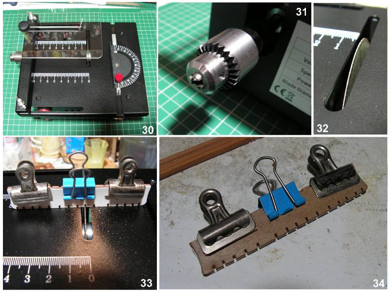

As promised, that new acquisition is shown in Photo 30 – namely a lovely little mini circular bench saw table! I found this one on ebay (of course) for a very reasonable £65. The reason I went for this particular type can be seen between the 3 and 4cm mark on the upper scale to the left of the saw blade. At the bottom of that little hole is a screw bolt and the supplied Allen key which fits down there when turned raises or lowers the height of the circular saw!Cool That particular facility (which not all mini table saws have) allowed me to do what comes later. Not only is this a circular saw, but in Photo 31, you can see the drill chuck which sticks out on the left side of the machine (also visible in the earlier photo). A selection of sanding disks comes with the set which go on here. Not shown here, on the opposite side of the motor shaft is a connection for a flexible drive shaft with a smaller chuck on the end which takes a selection of drills, sanding drums and other ‘Dremel’ type tools (also supplied in the set). One word of advice – when using the saw, follow the advice in the manual and disconnect the flexible shaft connector – it doesn’t half give your right hand a whack if you forget its down there!Blink
As well as a wood saw blade the machine also comes with a diamond dust grinder blade as shown in Photo 32 and this is the one I used for the deadeye strop slots. The wood sheets I bought for the replacement channel proved to be about a mm too thin, that’s what you get relying on a ruler instead of double checking with the micrometer!Blushing Fortunately I had some veneer, which took the wood sheet up to the proper thickness. Once the channel had been made up, the plasticard template was attached via mini bulldog clips and the saw blade set at the right depth for the slots. All I had to do then was to carefully slide the channel, template first, towards the grinder blade aiming for the previously made slots in the template as shown in Photo 33. The final result is seen in Photo 34, all neatly ground into the wooden channel and a heck of a lot easier than the manual filing out that the port side channel received!Cool
The next task was to drill the two holes for the brass rods, which will hold the channel in place as the glue dries. The first test fit is shown in Photo 35, in this instance there was another slight difference in the technique – on the port side both rods were glued into the channel and then pushed into the holes in the hull. This time however the forward rod was so tightly held in the hull that it came out of the channel on removal so I left it in there and superglued the rearward one to the channel with a drop of extra thin superglue on the other one in the hull.
I then had to go through the same laborious painting, and then the making up of all those deadeyes, the ringbolts and the addition of the copper edging. Then came the next improvement in the schedule – instead of gluing the channel in place and then struggling to fit those brass (wrought iron) supports underneath, as you can see in Photo 36 I superglued the supports on first. The ends of the supports were very slightly proud of the back of the channel so that when the channel was pushed into the holes in the hull, all the supports made contact with the lower hull just before the channel did. I could then remove the channel one last time, apply a tiny drop of superglue to each support and then push the channel back on with each support neatly glued to the hull! The final result is shown in Photo 37.
The last job as before was to add in the blackened brass chains which comes in the next instalment (with another improvement in the technique) but the procedure began with fitting on the smaller chains to the little deadeyes, these have no brackets of course and the first two are illustrated about to be pinned in place in the final Photo 38.

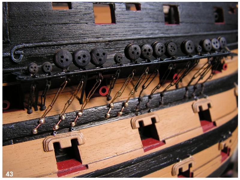

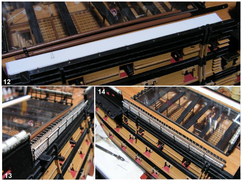

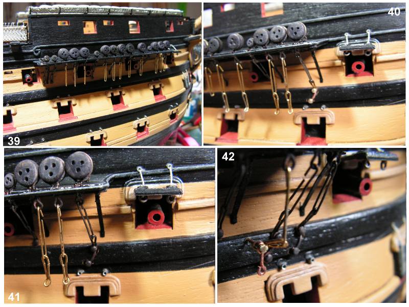

Carrying on from the last instalment, the small deadeyes have all had their shorter chains fitted on and blackened. The other improvement I mentioned last time was that instead of blackening the chains first before putting them together and nailing them to the hull, I simply cleaned the brass wire chains in isopropyl and then made sure I didn’t touch them again with bare fingers. Using only the pliers and tweezers the ends were squeezed in together and once nailed down the finished chain was then hand painted with the chemical blackener, gently washing the fluid over the brass until it went ‘old iron’ black. Once it had I then re-painted them with clean water to neutralise the chemical. Photo 39 shows the next stage with the first set of standard chain links formed and hooked over the deadeye strops. Photos 40 and 41 show the next smaller links going in with the foremost chain already fitted on and with the upper link blackened in 40, and completed in 41. The fitting of the copper bracket is illustrated in Photo 42, here the top nail hole is drilled to prevent the tiny brass nail from bending whilst being driven in (didn’t always work though)! This top nail was hammered in just tight enough to support the bracket and then the bracket was angled down, and the bottom nail hole carefully drilled into the wale timber. Occasionally the final tap on the top nail would slightly spread the chain links above as seen in the second chain so some ‘re-attaching was required as the chains progressed towards the stern.
Finally in Photo 43, all of the main chains have been fitted in and the ‘in situ’ blackening process is underway.
Once that was done the forechannels were essentially complete and after a gap of about five years I could finally turn the page in the DelPrado instruction file!BigGrin
In the next instalment there’s a brief change of direction as I re-designed the waist hammock cranes and netting for a more authentic look and re-thought the hammocks too!

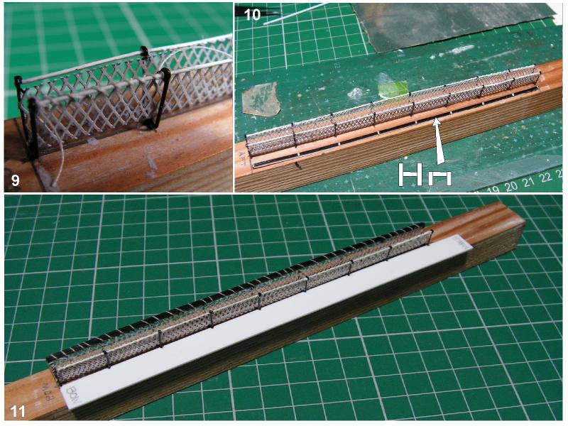

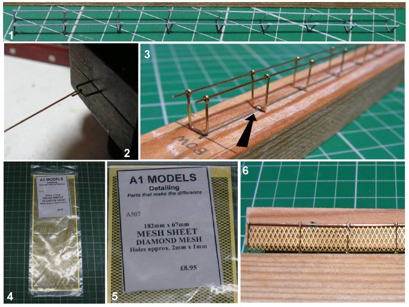

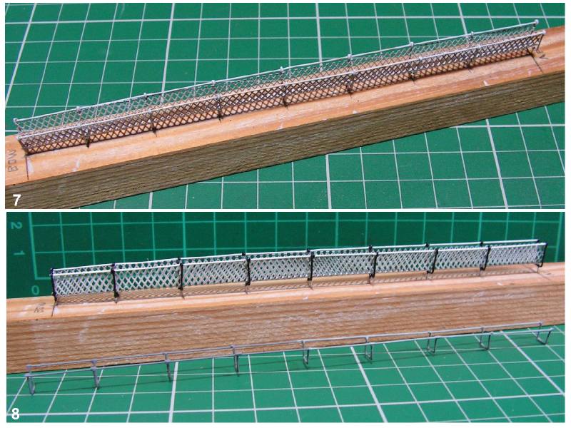

So, time to re-engineer those waist hammock frames! So far, I’d made up the hammock frames on the bow bulwarks, the quarter deck bulwarks and the cross section frame on the forward edge of the poop deck. They looked OK with the fabric mesh netting and Milliput hammocks. Being lower in height I could get away with the fact that the netting was a hexagonal ‘chicken wire’ form instead of the actual square or diamond shaped mesh. I’d only made one side of the waist hammock frames and the more I gazed at it the more I thought it looked ‘not right’. Eventually I got out all my Victory references and double checked – the suspicion was right – the frames were not high enough! That meant one of two solutions – either spend out for some PE Brass after-market ones or do it again. The PE ones I found on the internet were lovely to look at but the cost of them was not!Crying In the end I decided that since I’m having to scratch build most of this model to get it right (the kit didn’t actually have any hammock frames or netting in it although the DelPrado publicity fold out poster of the ‘finished’ model did have brass frames but no netting), I might as well carry on and make my own again.
Photo 1 shows the ‘old’ frame. It was constructed from 0.5mm brass rod by bending the ‘U’ shaped frames into shape and soldering them on the outside edge to a pair of straight brass rods to simulate the ropes onto which the rope netting was attached. The new version would be very similar but would have the rings at the top to thread the brass rod ‘rope’ through before soldering as well as an extra piece of slightly thinner brass rod (I think it was 0.4mm) attached to the base of the frame to provide a ‘nail’ to glue into holes drilled in the ‘Hammock Crane Plank’ which runs along the edge of the deck (Hammock Frames are also known as Hammock Cranes). Photo 2 shows how those bottom additions were fitted on. The frame or crane was formed first and gripped in the vice with the base just outside of the jaws. The ‘nail’ rod was bent around a steel needle to provide the ‘U’ shape, which was hooked over the base. The other end was gripped in another mini vice and pulled back under tension to keep the hook in the dead centre of the frame and then soldered. Once fixed the excess part of the hook was snipped off level with the base and the nail part cut to about 5mm or so. When all the frames were made, I took a scrap piece of wood, drew a pencil line down the centre and marked out the length of the entire frame and the spacing between the individual frames. All the frames except the two end ones had the ‘nails’ and they were all slotted into the holes drilled in the wood jig, the nearest is shown by the arrow in Photo 3. Then the two long brass rods were threaded down through the rings and once in place the two end frames slid on from each end. When I made the first hammock frames, I had a pack of perfectly straight brass rods. This time around I have a multitude of brass wires on spools. As every modeller probably knows anyway, wires on spools do NOT like going straight! The easiest remedy for that is to cut a length off the spool, grip one end in a vice and the other end in a pair of pliers or mole grips and simply pull the wire away from the vice at 180 degrees. The wire stretches slightly and when the tension is released the curved wire is perfectly straight! Instead of using the hexagonal nylon mesh the netting on the new frames was going to be made from PE brass from a Company called A1 Models Detailing. Part Number A507 – a sheet 182 by 67mm, with a diamond mesh of 1 by 2mm, as shown in Photos 4 and 5. The length was just enough to get the full waist in one piece. By luck I had another piece of scrap wood which was just the right thickness to slide in between the frames. This was used as a former to bend the cut off section of brass mesh (heavy duty scissors did the job), the wooden former is seen holding the mesh in place within the frames in Photo 6. With the brass netting in place the whole assembly was primed with Vallejo Grey Surface Primer as shown in Photo 7. After a day or two to fully dry, the netting was painted with Vallejo Ivory so the netting had a slight contrast with the supporting rope which was Vallejo White and the frames themselves were (very carefully) painted with MiG Satin Black. Despite a steady hand there was a bit of to-ing and frowing with ivory covering over accidental black and black over-painting touch-up spillage from ivory and white! The result is shown in Photo 8 with the old original frame shown at the bottom for comparison.
The next task is very fiddly to say the least! Using a thin white thread, the top most diamonds in the brass mesh have to be hand stitched to secure the brass ‘netting’ to the brass ‘rope’ as shown starting on the first section in Photo 9. I did this on both sides of the netting although to be honest I need not have done it on the inboard side as it turned out. I only went back to the drawings after I’d done both only to discover that the inboard side didn’t actually have a supporting rope at all (so I could have saved all that bending the rings on the top of the frames as well!Blushing ) Instead of the rope supports the inboard side has a wooden handrail which is attached to the top of the frame with a simple spike stuck into a hole in the rail, and the netting is then lashed to the rail. Photo 10 shows the hand rail under construction. The rail itself is made from a styrene ‘H’ girder from ‘evergreen scale models’ (I could have sworn it was Plastruct! It was 1.5mm square and the first job was to sand down the top part of the ‘H’ to turn it into an upside down ‘U’. Once the top was sanded flat I painted the inside groove in black acrylic and when dry laid it alongside the frame and used a micro drill bit to drill down into the groove at the positions of the frames – the drill holes are the little white dots along its length. I could then add a little drop of super glue gel in each hole and place the rail into position, fixing it to the top of each frame (needing all the fingers of both hands to get them all to stay in place at the same time.) Once stuck, the rest of the rail was painted black and the following day the brass netting was stitched onto the rail as shown in Photo 11. Also shown in this photo is the next simple jig, a length of plasticard corresponding to the total length of the waist with a small notch cut out to match the position of each of the frames. The jig is shown in position on the port side of the waist in Photo 12 with a small hole drilled into the edge plank in each notch ready to take the base spike on the frames. Flipping the jig over then allows it to mark the positions on the starboard side as well. The final two pictures, Photos 13 and 14 illustrate the port netting in place, dry fitted for now as I don’t want it getting in the way when I come to do the railing around the open waist later on.
In the follow up instalment, new hammocks to go with the new netting!
