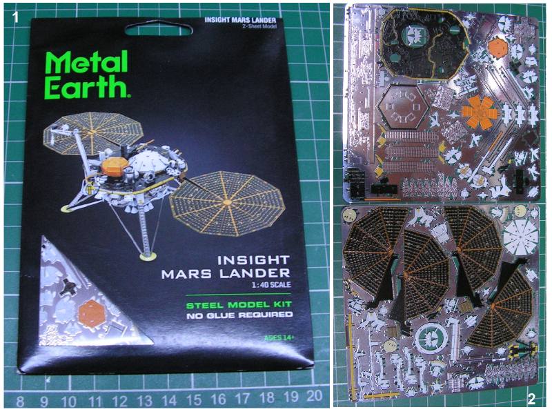

I thought I’d try one of those really clever looking Metal Earth models, I specially liked the look of the Mars Rover model with the intention of having it mounted on a Martian looking scenic base but as I was scouring through the ebay suppliers looking for that kit I first came across a completely unknown model which I hadn’t seen before! It’s still a Mars related subject but instead of a rover, it’s a lander!Cool
Photo 1 shows the cardboard envelope that the model comes in, to get a good idea of what the finished model (should) look like go to www.metalearth.com/360/mms193 this is ‘highly recommended…before assembling your own’ on page 1 of the instruction! The entire model comes on two steel cut out sprues as shown in Photo 2; sprue A at the top and sprue B below. The plans come on two double sided A3 sheets so there are 7 pages of actual instructions, page 1 being a list of icons describing the engraved or colour side of the pieces and the un-engraved or blank side, the type of bend to employ on the tiny tabs – either 90 degree flat or twist and a list of useful tools (basically wire cutters, tweezers and needle nosed pliers).

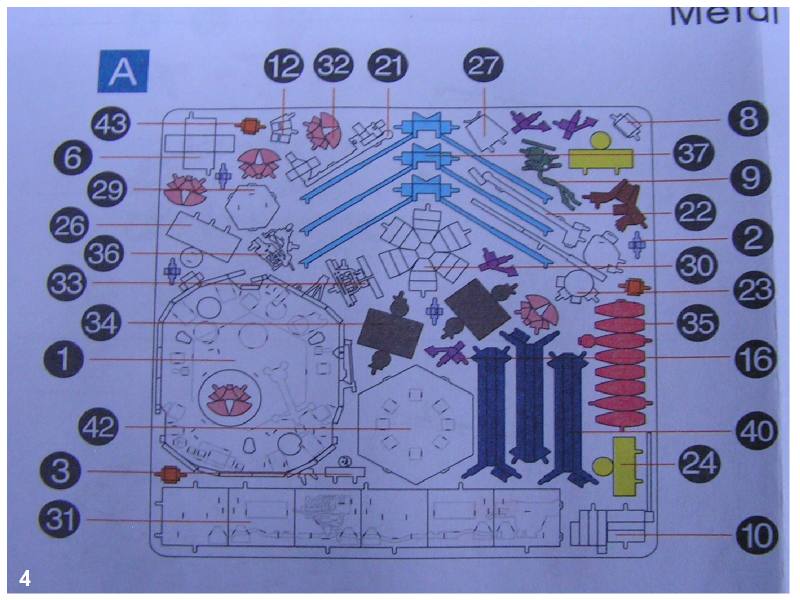

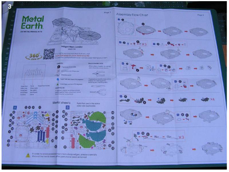

Unlike some parts identification in some kits, the Metal Earth plans go out of their way to make that easy – Photo 3 illustrates the first two pages of the instructions with half of the coloured section seen at the bottom left enlarged in Photo 4. This is Sprue A, showing where on the sheet each piece can be found and its number. The parts are also colour coded so for instance Part 37 which is part of the landing struts actually has three identical pieces, one for each leg and all numbered 37.

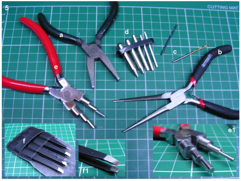

As for those tools, most of them I already had in my workroom but after ordering the kit I also sent off for a couple of extras. Photo 5 illustrates the collection so far – minus one which comes in the following instalment which I was sure I’d need from the start but so far haven’t Blushing but which I think will come into its own when I get to the leg struts later on! Tool a) is a nice flat jawed pair of pliers, useful for 90 degree bends on longer parts (but not long enough for those struts), b) is a fairly recent pair of very thin long nosed pliers which I got during the Ferrari build (when little screws kept falling out in the most awkward places), c) are a couple of small drill bits, not for drilling but to press down on the little tabs to flatten them in hard to reach places, d) is one of the two new acquisitions, a little set of formers to help curl or curve rounded sections (the two cone ended ones will come in useful when forming the tiny rocket motor nozzles), e) is another fairly new one which I got for the Ferrari – this is a pair of ring pliers used for forming metal wire into well, rings! I’ve found this one really handy for forming the ‘in situ’ parts of complicated pieces as you can grip the part in the pliers without bending the rest of the part and then simply hand form the curved bit around the suitably sized cylinder on the pliers ( a blow up of the jaws is shown in e1). Finally for these tools is f) – a really useful set of tweezers used for bending the smaller sections to 90 degrees, a blow up of one of the tips is shown in f1), the set cost less than a fiver on ebay – it’s a set of eyebrow tweezers from the health and beauty section!BigGrin
The tool not shown here is the one I hope will be useful further down the line – a photo etch bender but this one is slightly different to the VERY expensive versions on sale online – it’s a DIY gizmo built for about a fiver again. More on that next time!

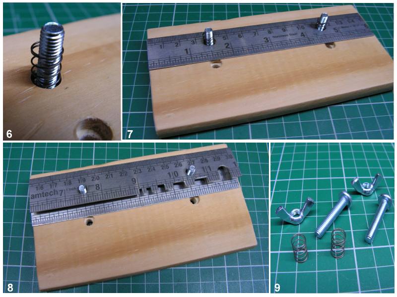

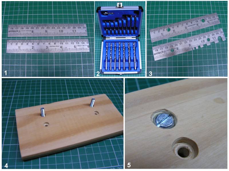

The first thing to admit about this photo etch bender is that it is NOT my idea or design! I came across this one on Youtube a few months ago and it was put together by a very clever modeller from (I think) Czechoslovakia, called David who goes under the name of PLASMO. You can find his ten minute video of how he put it together on youtube.com/watch?v=JbMH5Audl-k (or just put ‘diy photo etch bender’ into the search box and it should come up.
The basis of the bender is a steel ruler as shown in Photo 1, in this case, as in the video, a twelve inch ruler cut in half. Although this is a money saving exercise, I did actually spend quite a bit in seeing it through!Blink When trying to drill the holes through the stainless steel for the bolts and springs coming later, the first two of my HSS drill bits were worn down completely flat before they got anywhere near going through. So I took the opportunity of getting something I’d been thinking about for a long time since first coming across them on the Ideal World TV shopping channel. That ‘something’ is shown in Photo 2 – a set of “Drill All” Cobalt drill bits. They start at 3mm and go up to 10mm in 0.5mm stages. At the top left is a very useful countersink bit for good measure. In the TV demo, a drill bit is put through a layered block of wood, ceramic, steel, brick and concrete all in one go!Cool They are not cheap – this set cost all but £50 but the bits are guaranteed not to blunt, bend or break for ten years with free replacements if they do! I’ve only tried them on wood and stainless steel at the moment but that ruler which flattened two HSS bits was drilled right through in about five seconds flat (and not the drill bit this time!)BigGrin
The first task however was to grind out the right half of the top ruler with a series of notches under which the PE brass would be clamped for bending. I must admit, in David’s video, his dremel thingy cuts through the stainless steel a heck of a lot easier than mine did! I did however notice a slight flexing in his ruler as he was holding it – mine won’t flex anywhere so either mine is a thicker ruler to begin with or I have a different grade of stainless steel! I bought my ruler down the local DIY store – made by amtech and £1.99 for a pair of rulers, one twelve inch and one six. I also sent off before that for one on ebay which arrived just after I got the local ones and was definitely much thinner and more flexible!
As you can see in Photo 3, the two rulers are ground and drilled, the last indent is rounded as once I got those drill bits, adding a large cut out with the drill and cutting wheel was a lot easier! The indented ruler at the bottom has 5mm holes to take an M5 bolt whereas the straight ruler at the top has 7mm holes to allow for an M5 compression spring to sit into the wooden base (the spring is 5mm diameter on the INSIDE)!
Photo 4 illustrates the wooden base for the bender, in my case, not a beech door step but a pine plank off cut. The reason there are four holes and not just two is that the first pair were, ‘ahem, not as aligned as I thought they were!Blushing The underside of the base is shown in Photo 5 with the end of the M5 bolt countersunk down into the base. Back to the topside in Photo 6 with the M5 bolt coming up through the base and the compression spring sitting in the 7mm countersunk hole (about 5mm deep). In David’s video he used spring washers to secure the bolts in the wood, in mine the hole drilled through the pine for the bolts was tight enough that the bolts cut their own thread as they were screwed in so no extra securing was needed. In Photo 7, the bottom ruler is placed over the bolts and springs and then glued down onto the base. To hold the steel in place whilst the glue dries, simply add the wing nuts to the bolts and tighten them up locking the ruler down tight.

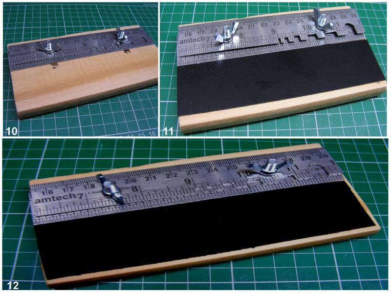

The indented half of the ruler is then placed over the bolts as shown in Photo 8, as the drilled holes are only wide enough for the bolts to pass through, the top ruler sits on top of the springs as seen here. The bolts, wingnuts and springs are shown in Photo 9, not shown are the M5 washers which fit beneath the wingnuts (I got them down the same DIY store I bought the rulers from after this photo was taken – I thought I had a pack already but they turned out to be M3’s!)
The last three photos were also taken before I got those washers – Photo 10 is the bender essentially completed with the top ruler screwed down tight to the bottom. Photo 11 has the addition of a 1mm strip of black plasticard which lifted the working surface up to the level of the bottom ruler (so I couldn’t accidently add an unwanted kink to any parts being bent if they overshot the ruler width). Unfortunately a couple of days after gluing that card down with a contact adhesive it developed a ‘hump’ in the middle which was strange as I didn’t think the contact glue would affect the plastic. Anyway, I removed the plasticard (fairly easily which wasn't a good sign) and replaced it with a strip of 1mm thick black self adhesive neoprene as seen in Photo 12, (left over from lining the inside of the DIY dew shield I’d just made for my new telescope). Note that I stretched this photo to fit the space – the actual dimensions are as in the two pics above!
So that’s the perfectly workable etched brass bender. So far as I mentioned, I’ve found the pliers and tweezers perfectly adequate for the small parts on the lander, this gizmo will I hope come into it’s own on the longer spindly bits like the crane jib arms and landing gear coming later on. Many thanks to PLASMO or David for that design and video and in the next instalment we get down to the start of the build itself (coming together well at the moment with just one unfortunate ‘error’ so far!Blink
Robin.

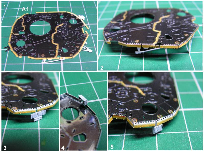

And so it begins! The first piece to work on is part A1 from (obviously) the A fret! This is shown in Photo 1 and comprises of the main top deck of the lander. As you can see in this shot, the deck is fringed by a series of yellow strips and all of these have to be bent through ninety degrees to point straight down. Doing this will also point the various struts and other gubbins down as well; as shown in Photo 2. Virtually all the bending was accomplished with the flat nosed pliers shown earlier. Next comes a little box fixed to the edge of the deck which starts off as a T shaped bit hanging off the side as shown in Photo 3. The sides and bottom panels were bent into place using the flat ended tweezers from the cosmetic set giving the shape seen from below in Photo 4 and from the side in Photo 5.

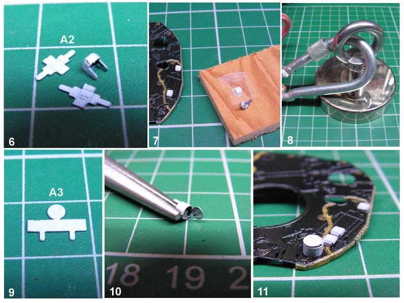

Next we have to construct three tiny boxes from Part A2 (x3) as illustrated during construction in Photo 6. Again that flat edged tweezer was employed (and is in fact the most used tool so far). At this point I met the first problem – not with the construction – although I suppose it was sort of – after making up two of the boxes and attaching them to the deck, number three pinged out of the tweezers and vanished from sight! I spent about half an hour looking for the flaming thing to no avail and then decided to make up a fake plasticard replacement which you can see stuck to the wood on a piece of double sided tape for painting in Photo 7. Beside it you can also see that long sought for missing original! The saviour is shown in Photo 8 – my very strong fishing magnet (which still hasn’t actually been used for magnet fishing)!Blink Unlike photo etched brass, the Metal Earth models are made from steel – magnetic steel!BigGrin A slow dangle around the carpet black hole and the escapee shot out of the event horizon and was found securely stuck to the bottom of the magnet (and I mean securely!) As you can see the last box was three quarters done and pinged away whilst being held by one of the small sides. The last side with the locating tab was bent over (very carefully) and then the final box was safely attached. Needless to say, that magnet is sitting beside the workbench for the duration of this build! (Stop Press! Successful seek and finds now standing at 2!)
The final piece for this instalment is a cylinder formed from Part A3 as shown in Photo 9. The pre-scored cylinder was formed around a suitable drill bit shaft and then gripped in the long nosed pliers for the ‘lid’ to be bent over as seen in Photo 10 and then finally attached to the deck beside the three boxes as shown in Photo 11.

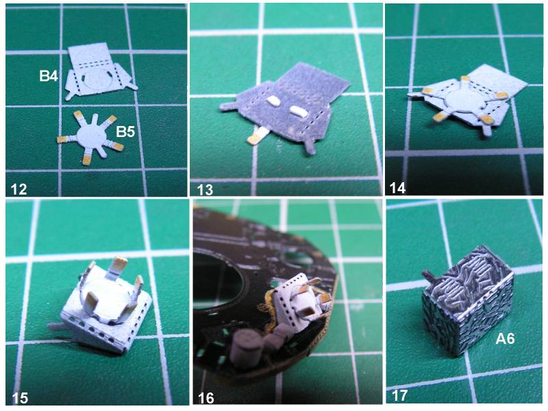

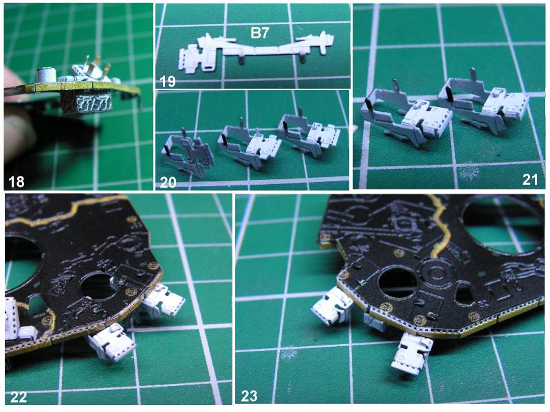

So to carry on, here’s one of those ‘incognito’ thingies! This instrument comes in two parts, both on the B fret: B4 and B5 as shown in Photo 12. The two smaller spokes on B5 are first bent down at right angles and then pass through the two slots in the face of B4 where they are bent flat across the rear as seen in Photo 13, leaving the disc fixed in place shown in Photo 14. To complete the thing, the two sides, top and rear are then bent down and the ‘antennae’ bent up to create the wedge shaped box and vanes as illustrated in Photo 15. The pair of tabs on the wedge sides then insert down through the deck and are bent over to secure the instrument in place in between two of the little boxes attached earlier, shown in Photo 16. Remember I mentioned I was in the process of making a replacement little box when the missing one was found? I needn’t have bothered! I didn’t discover until almost at the end of the build that the kit provides two spare little boxes on the fret – they could have mentioned that in the instructions!Cursing The whatever-it-is is complemented by a large ‘silver foil’ covered box of electronics which sits directly underneath the deck. This is part A6 which is shown folded up into the open topped box in Photo 17, the two tabs at opposite corners feed up through the deck before bending over to fix the box firmly in position (Photo 18).
The next part(s) to go on are again ‘unknowns’. There are four of them in total, sticking out from under the main deck. Each one is formed from a single piece B7 as shown in Photo 19. Photos 20 and 21 illustrates the shaping of the part – first the two fold lines on the narrow part (seen under the ‘B7’ in Photo 19) form the open box shape followed by the front section hinging down and passing over the tab which is then bent over to fix the front in place (Photo 20). Then the side panels on the front bend down to form another, smaller open box as shown in Photo 21. Finally the two vertical tabs on each gizmo pass up through the deck from below and are then bent over to secure the boxes as seen in the final Photos 22 and 23.

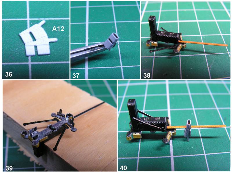

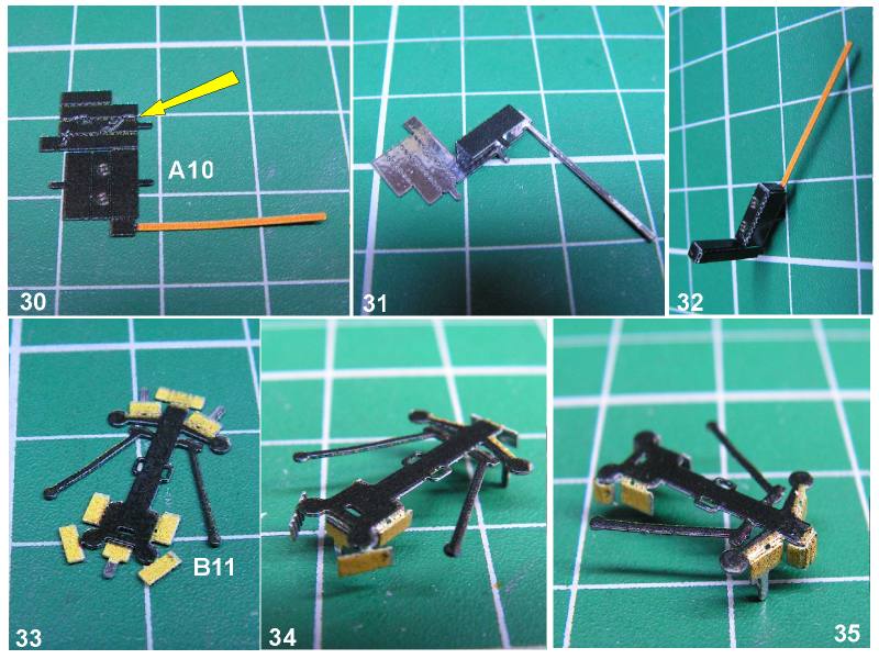

The next part to come together is the one part of the actual lander that failed in its duty – this is the autonomous drill unit or Heat Probe, which was designed to drill down into the Martian soil. Unfortunately, the HP3 Instrument to give it its full designation found itself in ‘the wrong soil’ according to NASA, the soil was a finer grade of dust than expected and instead of passing down through it (by vibrating its way down rather than a rotating drill bit), the dust clogged up the mechanism and the instrument only managed to get down a few inches instead of the few feet it was supposed to!Blink Anyhow, the instrument comes in three parts: the actual sensor inside its housing (A10), the four legged base unit (B11) and a guide piece for the flexible data cable (A12). The sensor unit is seen in Photo 30, the orange strip being the data cable and the drill housing being shown by the yellow arrow. The box shaped base is first folded into shape as shown in Photo 31, followed by the drill housing in Photo 32. The four legged stand is shown in Photo 33, the first job is to bend all the yellow panels down through 90 degrees as in Photo 34 followed by curving the two rear panels around the circular pads and the front one around the frame as illustrated in Photo 35. Next comes the little data cable guide A12. This is simply folded into the hollow wedge as seen in Photo 36. The paint was a little scratched on this piece so I gave it a coat of Vallejo light grey acrylic as shown in Photo 37. While that was drying the drill unit was fixed onto the legged base by inserting the three tabs through the slots and bending them over. The drill and base is shown right way up in Photo 38 and upside down displaying those black tabs in Photo 39. The completed instrument is shown in Photo 40 with the guide slid on to the cable and the two struts bent up to make contact with the drill housing.

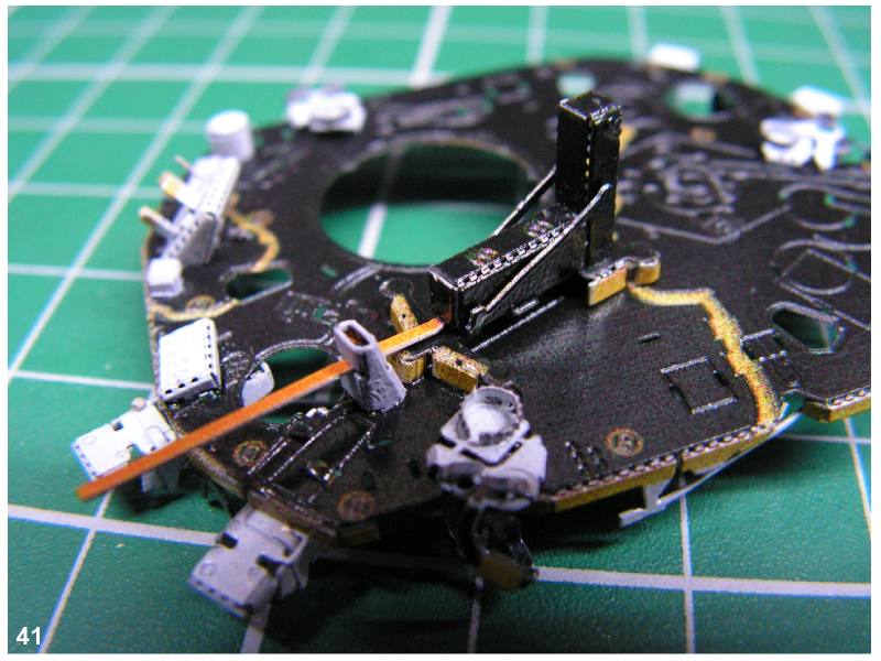

Finally, in Photo 41 the full instrument is shown fixed onto the main deck using the three tabs on the drill base and two on the cable guide. In the instruction sheet that orange cable is left sticking straight out as shown here. But it should actually curve down and under the deck, which I did later. In operation, the robot arm (which comes much further down the build was used to pick up the drill and its base and swing it out over the deck and down onto the Martian surface a few feet away from the lander, the data cable unrolling out as it goes.

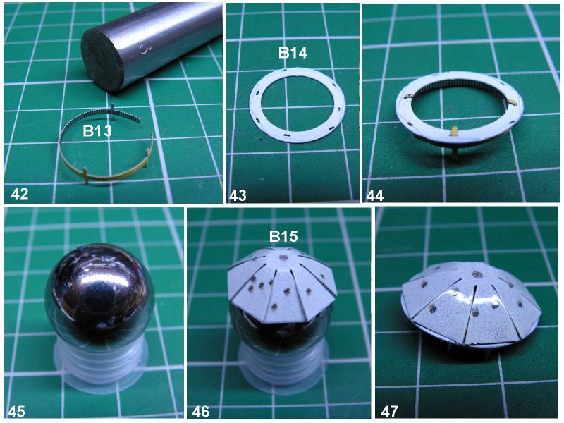

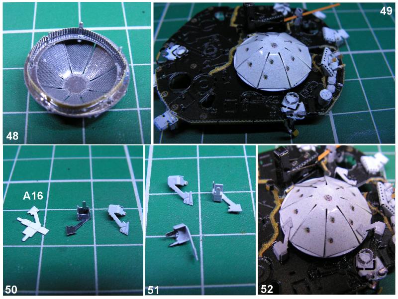

To begin the Thermal Shield section we start with part number B13 which is a long straight band with six little tabs sticking out. This has to be shaped into a ring as shown in Photo 42. The former, seen in the background is the solid steel handle of the 9mm leather punch (the cutting end is 9mm, the handle is about 12-15mm). Onto this resulting ring goes part B14, a washer with seven slots around the top. Three of those are used to attach the ring as seen in Photos 43 and 44. The actual shield part (B15) has to be formed into a shallow dome and to achieve this I sent off for a few stainless steel ball bearings of various sizes, (I only wish someone on ebay would sell sets of ball bearings from tiny to fairly big with just one of each instead of having to get so many of this and so many of that to get the selection!Cursing ) Any way, the one needed is shown in Photo 45 sat in a cradle made from a plastic bottle top. The dome is shown being formed in Photo 46, there are four tabs around the bottom and these fit into the four remaining slots in the base. They can only fit in one way so it’s important to make sure that the washer itself is fitted onto the correct three – it can go on wrong if you don’t double check – yes, experience talking!Blushing As seen in Photo 47, the edges of the dome are not curved as you might think – the top of the washer B14 is engraved with straight raised lines, which the dome then fits up against. You can just make them out in the preceding photos. The dome assembly is seen from below in Photo 48, the three remaining tabs sticking up are to secure the dome to the main deck which it has been in Photo 49. The last part of this section is to form and attach the three identical clamps which secured the dome to the deck during landing and which release their grip when the crane locks onto the dome to swing it over the side onto the seismometer experiment once it has been deployed. Photo 50 illustrates the three Part A16’s , the first flat packed as it comes off the fret, the second folded into a box shape and the third after I painted the reverse of the clamp and the inside of the box with Vallejo light grey – otherwise it’s noticeably ‘shiny’ in there!Blink
Photo 51 shows all three formed and painted ready to attach. Finally in Photo 52 the completed assembly is fixed onto the deck by those three last tabs. Interestingly, in a wonderful mix of old and new technology, the gold colour of the ring represents a flexible screen that hangs down around the dome to protect the seismometer inside – that screen is made of chainmail!BigGrin

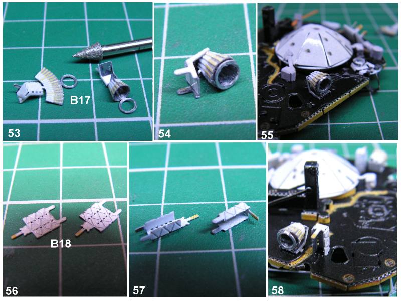

The part which had me confused is Part B17 (or rather two of them) as seen in Photo 53. Also seen here is the tiny diamond dust router bit which provided the former around which to curve what I took for a rocket nozzle. In actual fact these are a pair of Radio Science Antennas in the Medium Gain X Band (whatever the heck that is) designated the RISE (Rotation and Interior Structure Experiment)
They were designed to track the wobble in Mars’ rotation at the poles to help deduce data on the planetary core. After bending the base section in to a miniature chair shape, the scored curved section was carefully bent around the router bit to form the ‘nozzle’ before the ring was then bent down to become a rim around said nozzle as shown in Photo 54. The two ‘chair legs’ were then inserted into a pair of slots on the main deck and bent flat, securing the twin antennas in place, one on each side of the deck pointing outwards as seen in Photo 55.
The next two parts to go on are another pair of identical sensors, this time for detecting Temperature and Wind data. These are Parts B18 shown in Photo 56. Photo 57 shows their simple construction, basically a three sided open box and once folded into shape the two tabs at the base drop into another pair of slots right beside the previously fitted antennae as shown in Photo 58. You can just make out the other one on the other side of the deck to the right of the dome.

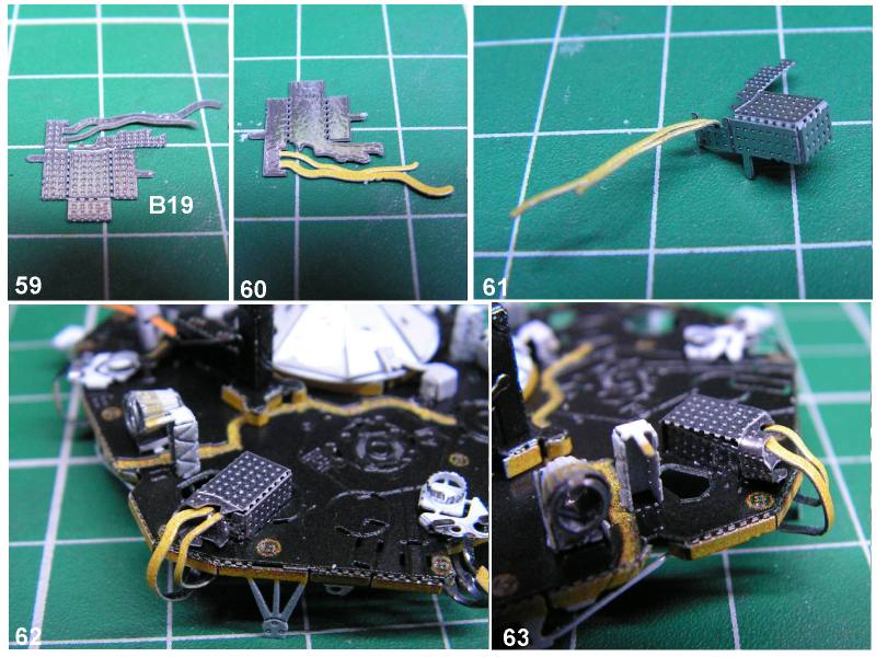

After B17 and B18, the next part was funnily enough B19! This I have no idea what it is, I couldn’t find any itemised pictures of Insight which labelled it so it’ll have to be the ‘Silver box with wires hanging out’ gubbins. Photos 59 and 60 illustrate the part from both sides. The wires are only coloured on one side but much later on when I was putting in the final ‘improvements’ I did repaint the yellow in Vallejo acrylic and painted both sides. Again this is just a simply folded box which is fixed to the deck by the two tabs on the bottom and the wires then curved around and under to vanish under the deck – they’re not actually fixed into anything down there. Photo 61 shows the box fixed in place as does Photo 62 from the other side. After I took the photos and had them on the screen it was only then that I noticed that one side of the box had accidently been squashed inwards (Photo 62) it was fairly simple to gently poke a thin sewing needle in through the holes along the side bend and tease the side back out again until it was levelled up.
