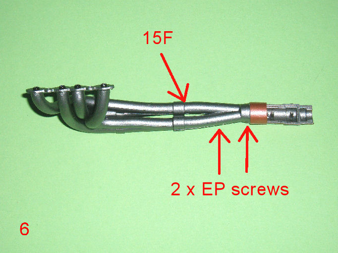

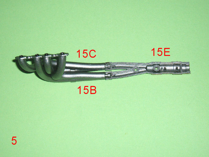

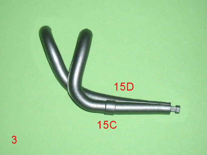

STAGE 15A:
Left exhaust.

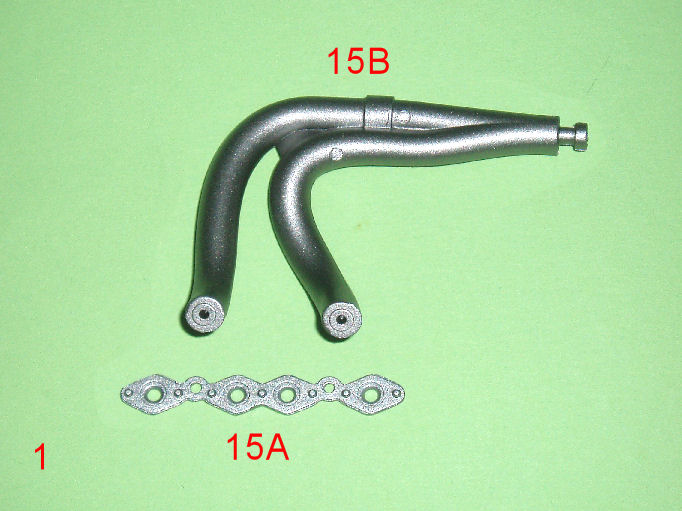

Pic 1: Locate the exhaust parts 15A and 15B.

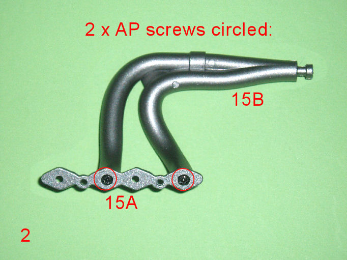

Pic 2: Fit the parts together as shown and fix with 2 x AP screws.

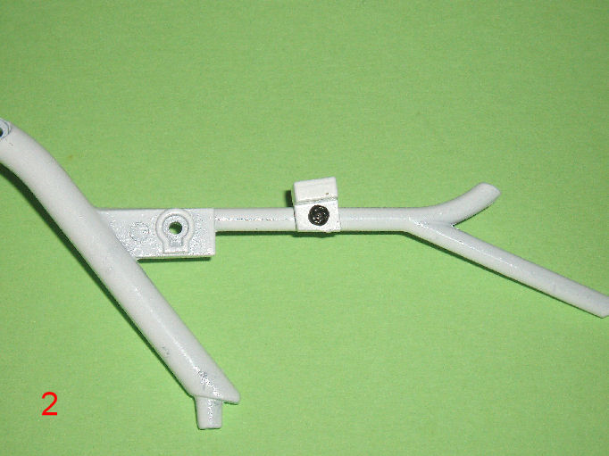

Pic 3: Locate the exhaust parts 15C and 15D.
Press-fit them together. They will only fit one way.
Pic 4: Fix these parts to the assembly in pic 2 using 2 x AP screws.
Pic 5: Fit the manifold assembly to the left bank exhaust 15E.
Pic 6: Fit the upper part of the exhaust 15F as shown and fix from the other side with 2 x EP screws.

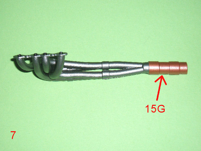

Pic 7: Press-fit the end section 15G in place.
It will only fit one way.

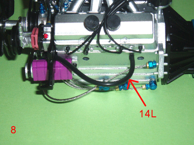

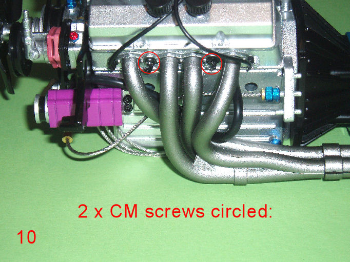

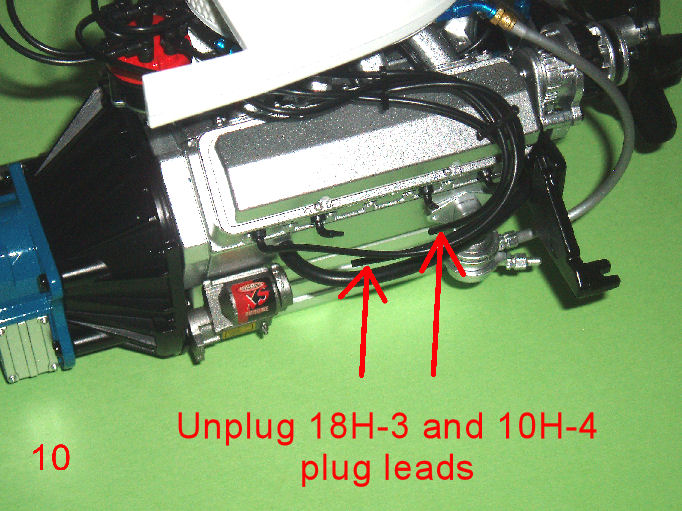

STAGE 15B:

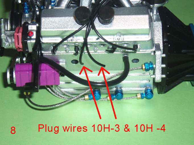

Pic 8: Retrieve the engine assembly and fit the rubber hose 14L to the pin on the side of the engine block.
Pic 9: Temporarily disconnect the two central plug wires on the left side of the engine.

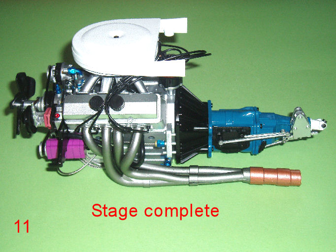

Pic 10: Fit the exhaust assembly in place as shown and fix using 2 x CM screws.
Pic 11: Reconnect the two central plug wires.
Store the engine safely for now.

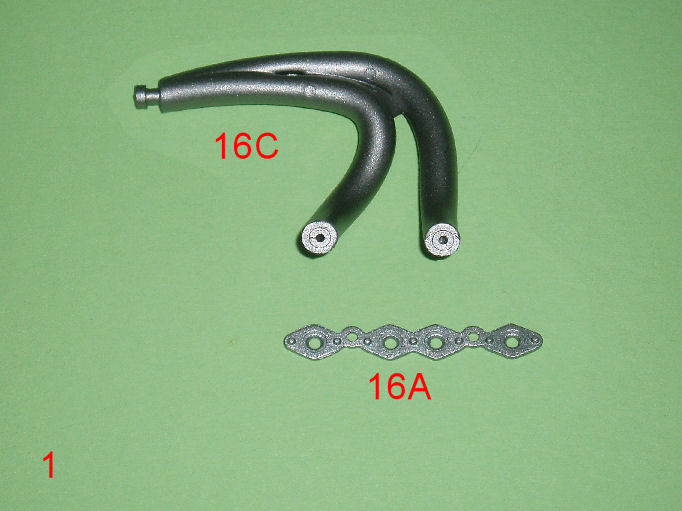

Right exhaust.

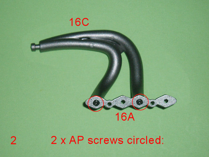

Pic 1: Locate the exhaust parts 16A and 16C.

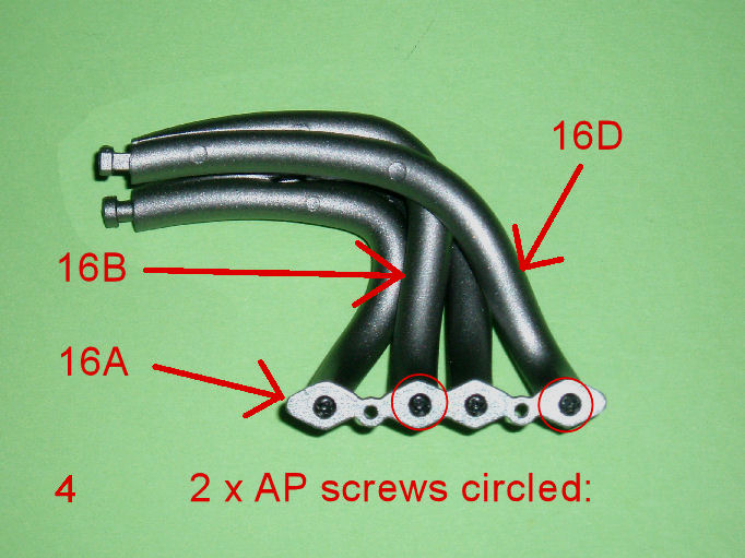

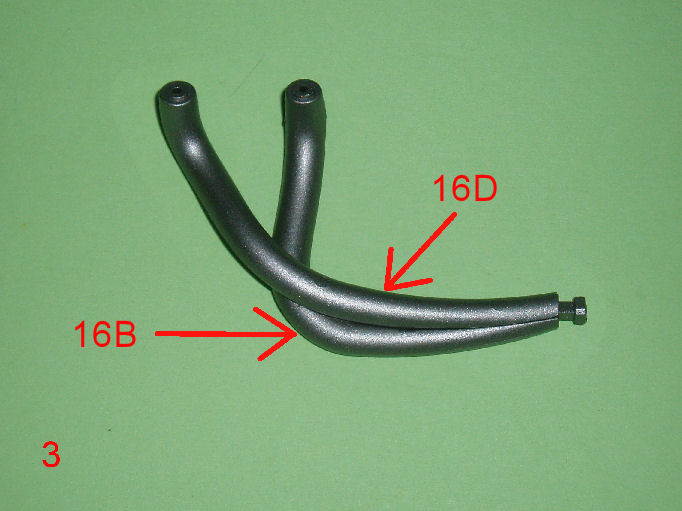

Pic 3: Locate the exhaust parts 15B and 15D.

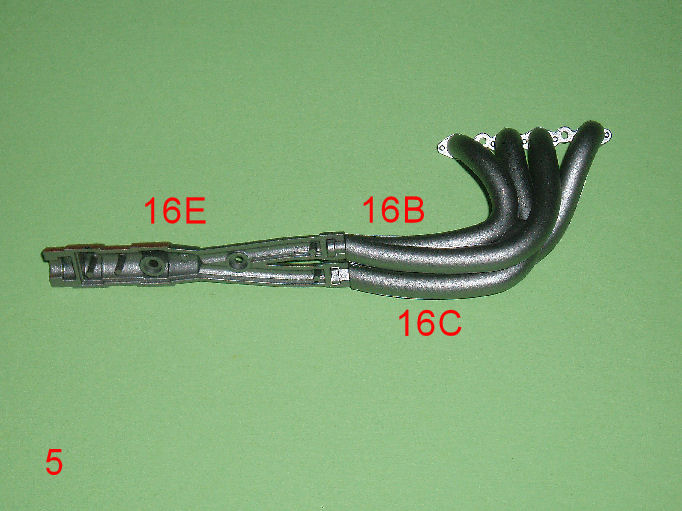

Pic 5: Fit the manifold assembly to the left bank exhaust 16E.

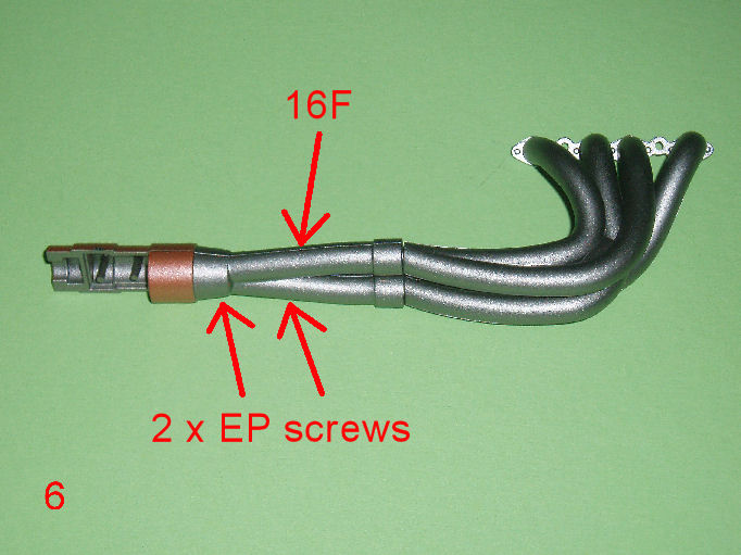

Pic 6: Fit the upper part of the exhaust 16F as shown and fix from the other side with 2 x EP screws.

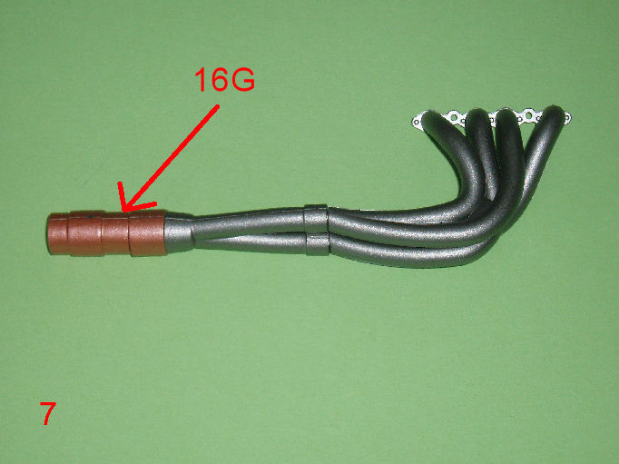

Pic 7: Press-fit the end section 16G in place.
#4 Posted : 10 July 2025 10:15:32
Posts: 5,181
Points: 15,692

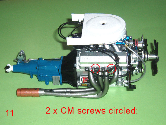

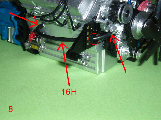

STAGE 16B:
Pic 8: Retrieve the engine assembly and fit the rubber hose 16H to the pin on the side of the engine block and the water pump as shown.

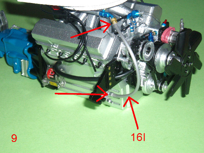

Pic 9: Connect the grey hose 16I to the fuel pump and fuel supply as shown.
Pic 10: Temporarily disconnect the two central plug wires on the right side of the engine.
Pic 11: Fit the exhaust assembly in place as shown and fix using 2 x CM screws.

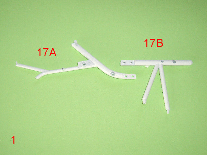

STAGE 17:
Front left subframe.

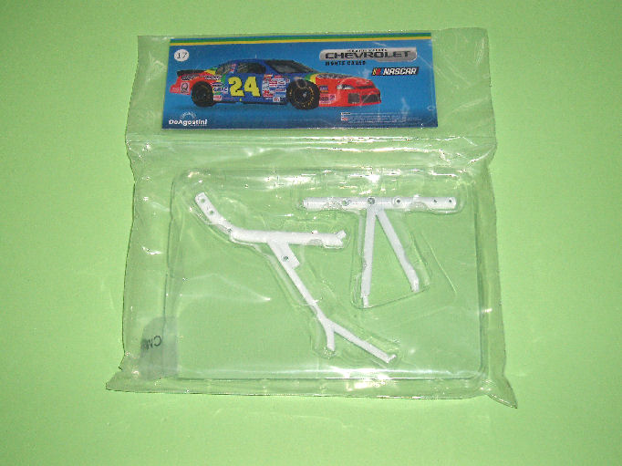

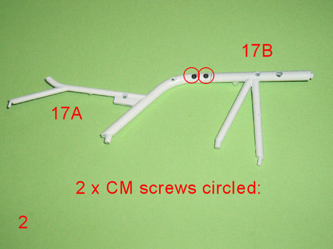

Pic 1: Locate the subframe parts 17A and 17B.
Pic 2: Fit the parts together as shown and fix using 2 x CM screws.

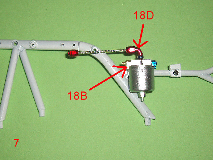

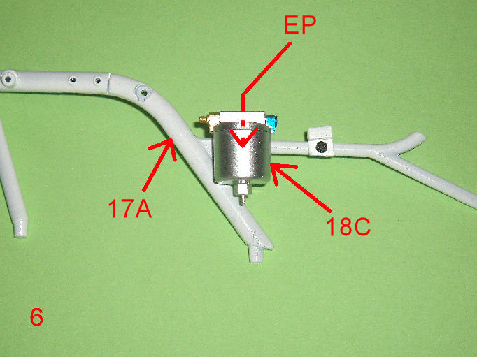

STAGE 18:
Oil filter.

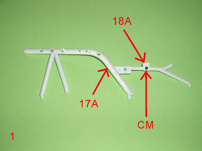

Pic 1: Retrieve the front frame from the previous stage and fit the radiator bracket 18A as shown.
Fix with 1 x CM screw.
Pic 2: Detail of fixing.

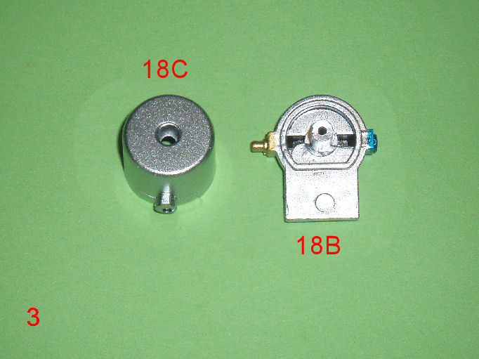

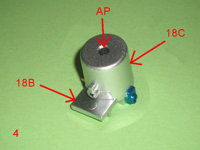

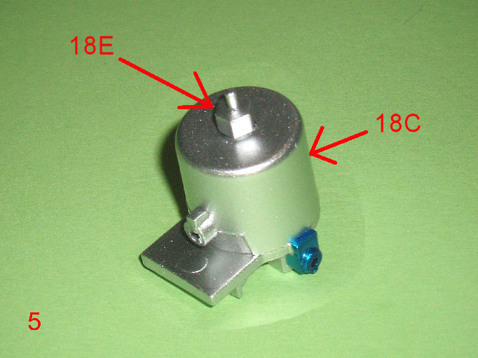

Pic 3: Locate the oil filter parts 18B and 18C.
Pic 4: Fit the parts together and fix with 1 x AP screw.
Pic 5: Press the oil hose connector 18E into place.
Pic 6: Fit the oil filter to the frame as shown and fix from behind with 1 x EP screw.
Pic 7: Fit the angled end of the oil hose 18D to the top of the filter.

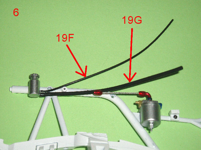

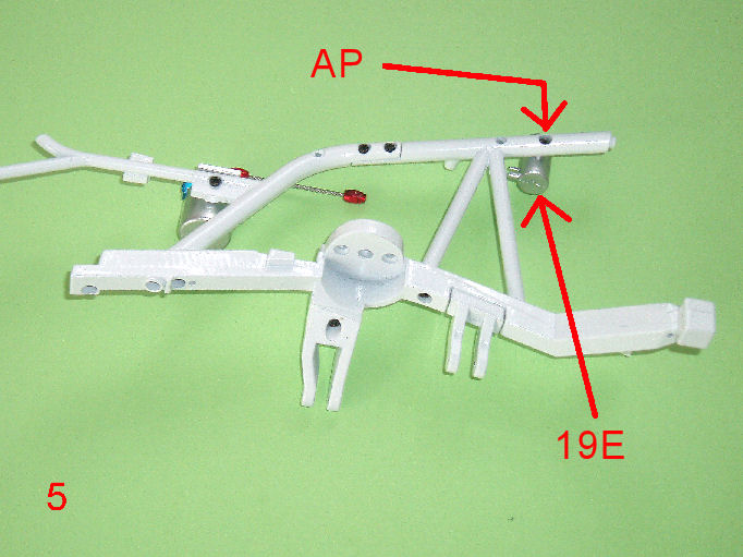

STAGE 19:

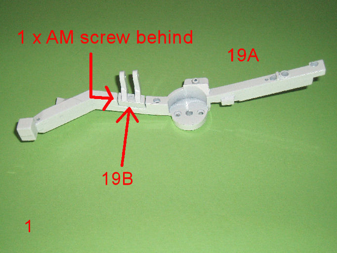

Lower left subframe.

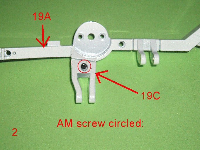

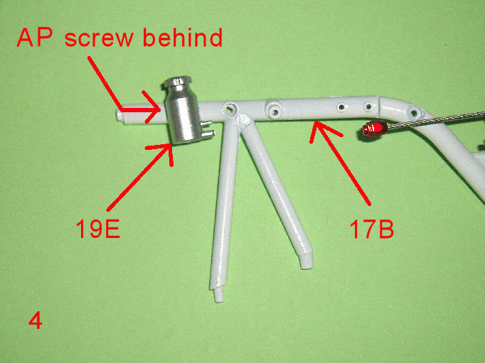

Pic 1: Fit the bracket 19B to the frame 19A and fix using 1 x AM screw from behind.
Pic 2: Fit the bracket 19C as shown and fix using 1 x AM screw.

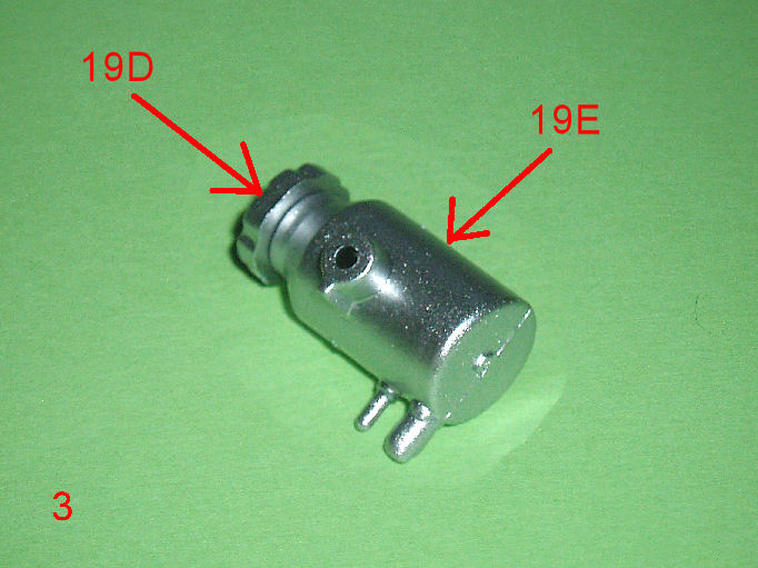

Pic 3: Fit the reservoir cap 19D to the reservoir 19E as shown.
Pic 4: Fit the assembled reservoir to the frame and fix from behind with 1 x AP screw.
Pic 5: Shows the screw fixing.
Pic 6: Fit the tubes 19F and 19G to the reservoir.
Tube 19G is the thicker tube and it fits to the lower pin on the reservoir.
Store the assembly safely.

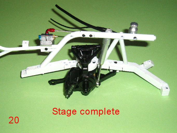

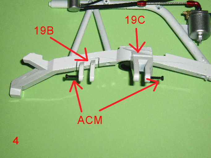

#8 Posted : 20 July 2025 11:37:19
Posts: 5,181
Points: 15,692

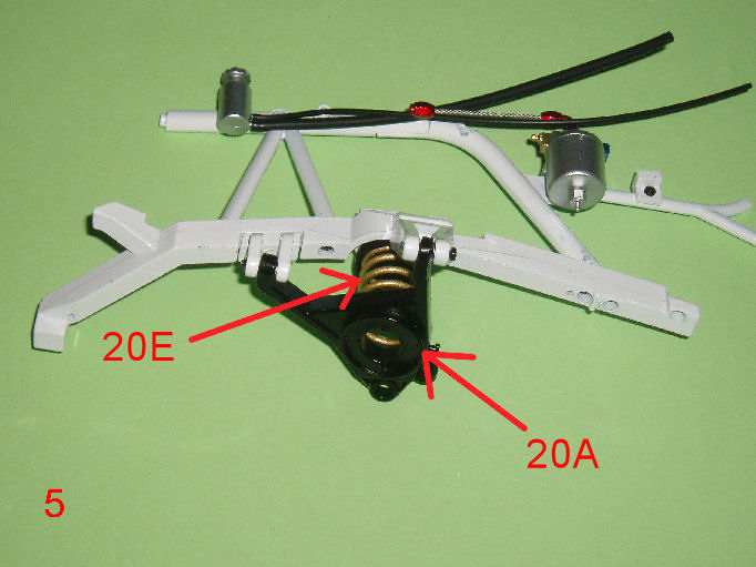

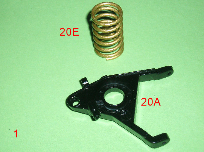

STAGE 20A:
Front left suspension.
Pic 1: Locate the suspension parts 20A and 20E.

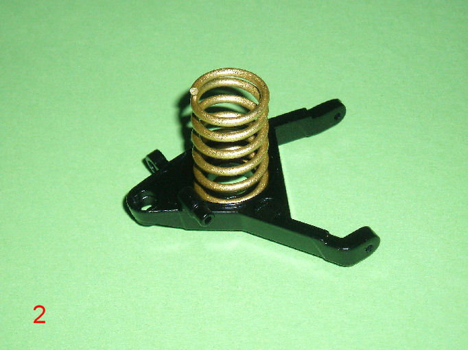

Pic 2: Fit the spring into the lower arm as shown.

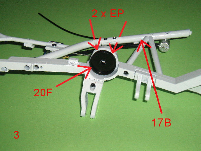

Pic 3:Fit the top spring seat 20F into the housing on the frame 19A and fix from the other side with 2 x EP screws.
Pic 4: Fit 2 x ACM screws into the support brackets 19B and 19C as shown.

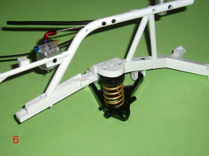

Pic 5: Fit the spring into the support seat and the ends of the lower arm into the brackets as shown and tighten the screws.
Pic 6: The assembly from a different view.
#9 Posted : 20 July 2025 11:39:55
Posts: 5,181
Points: 15,692

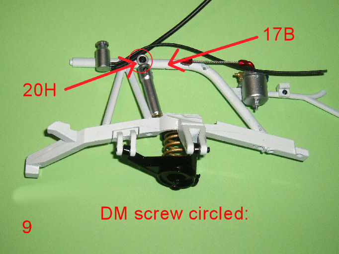

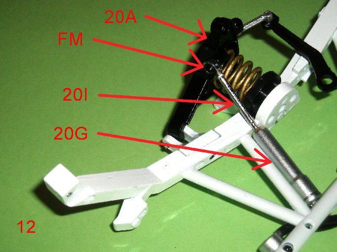

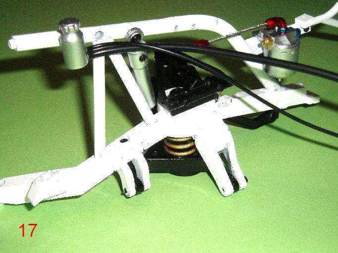

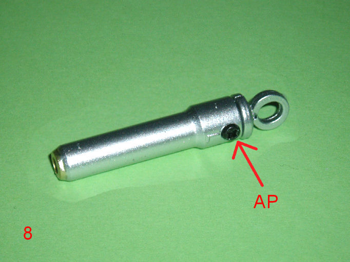

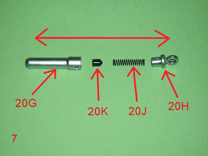

STAGE 20B:
Pic 7: Locate the shock absorber parts 20G, 20K, 20J and 20H.
Pic 8: Fit the parts together in order and fix with 1 x AP screw.
Pic 9: Fit the assembly to the frame 17B and fix with 1 x DM screw.

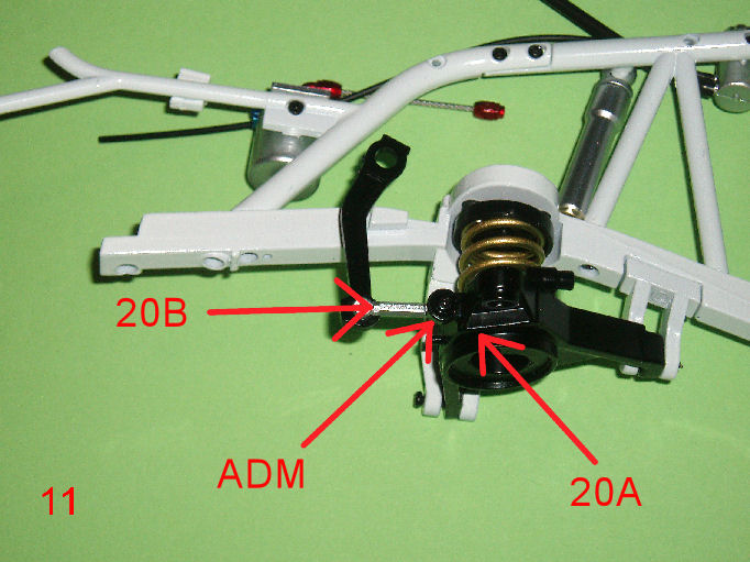

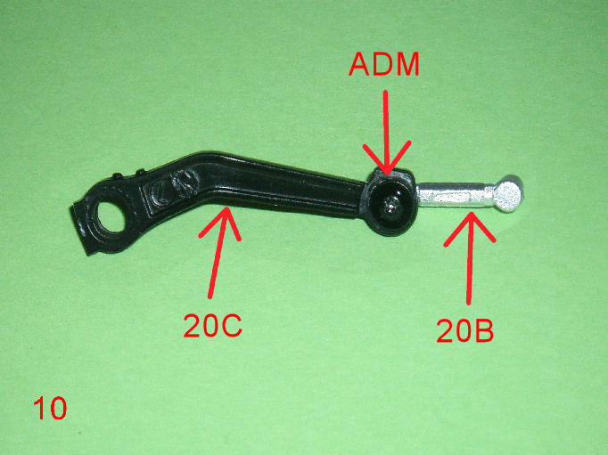

Pic 10: Fit the anti-roll bar arm and link, parts 20B and 20C together and fix with 1 x ADM screw.
Pic 11: Fit the end of the link 20B to the lower arm 20A and fix with 1 x ADM screw.
Pic 12: Fit the shock absorber arm 20I into the end of the shock absorber body 20G and fix it to the lower arm 20A with 1 x FM screw.

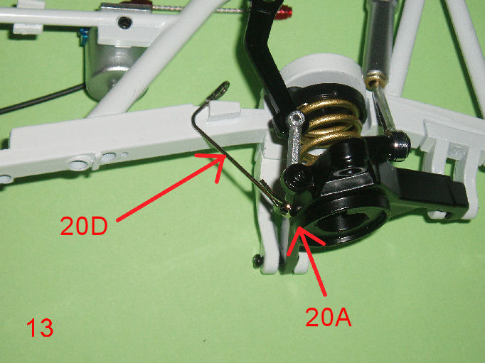

Pic 13: Hook the end of the suspension tether 20D into the loop on the side of the lower arm 20A as shown.

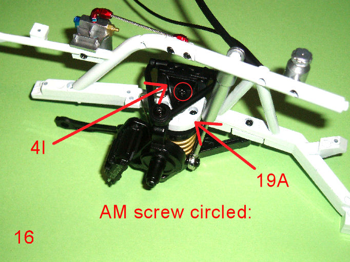

#10 Posted : 20 July 2025 11:43:16
Posts: 5,181
Points: 15,692

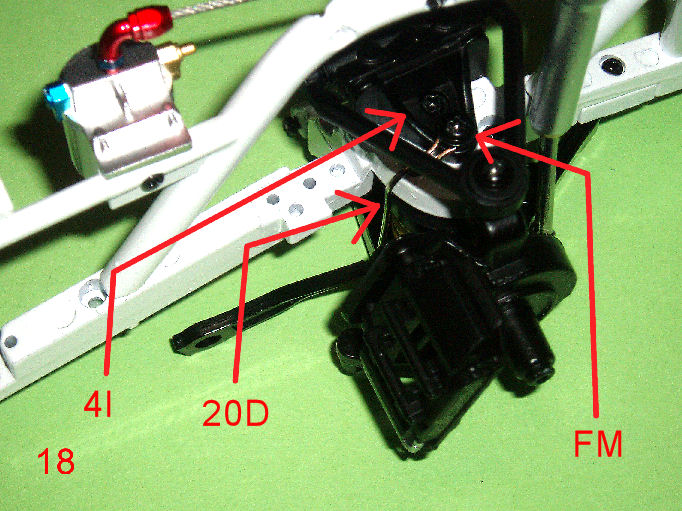

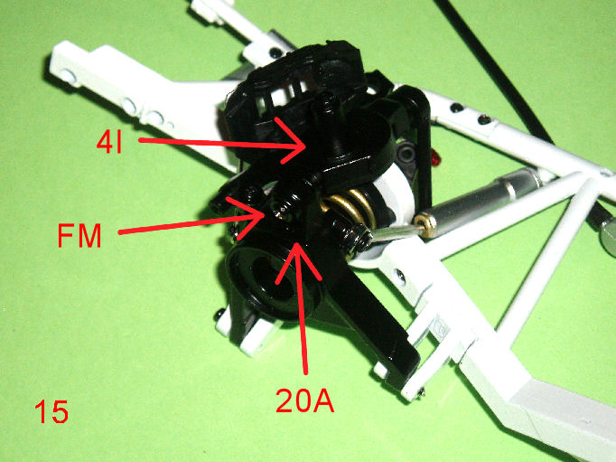

STAGE 20C:

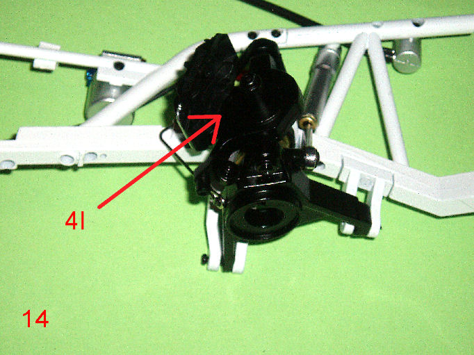

Pic 14: Retrieve the hub assembly 4I and fit it into the lower arm as shown.
NOTE – The wheel is not fitted here for clarity.
Pic 15: With the hub 4I in place, the caliper should be on the left.
Fix the bottom of the hub to the lower arm 20A with 1 x FM screw.
Pic 16: While compressing the suspension, ‘fold’ the upper link on the hub over the spring housing 19A as shown. Secure through the upper link with 1 x AM screw.
NOTE – This is fairly awkward as at times you feel you need three hands!
Pic 17: This shows the upper link in place.
Pic 18: Fit the suspension tether 20D to the upper arm 4I as shown and fix with 1 x FM screw.
Pic 19: Shows the completed stage with the wheel removed.
