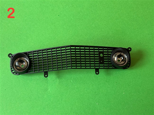

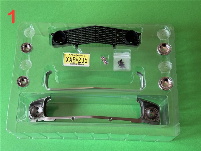

Picture 1 shows the parts for this issue.

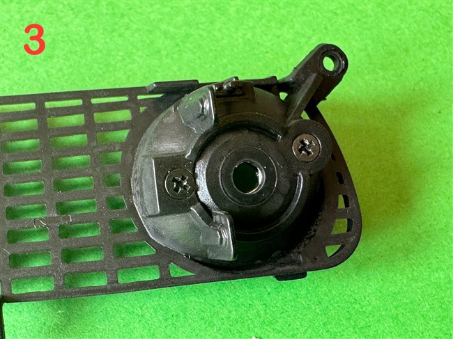

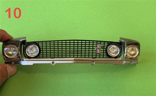

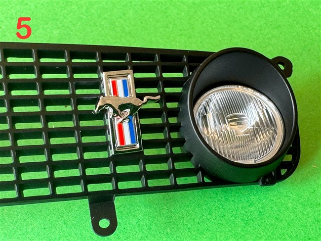

Fit the right and left high beam reflectors onto the front grille, picture 2. Note these are marked with an “L” and “R” on them. Turn the assembly over and secure them using two of the “D” screws for each lens, picture 3.
Next, place the high beam lenses to the reflectors. These will only fit one way, picture 4.
Insert the Mustang emblem into the front grille as shown in picture 5.

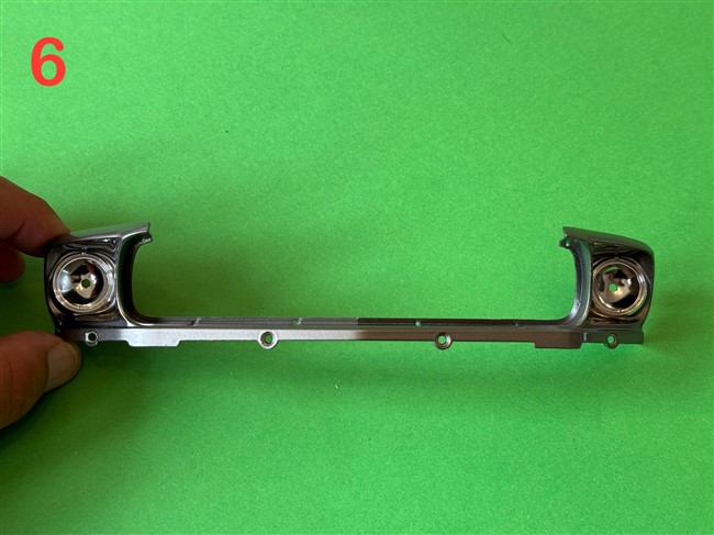

Place the dipped beam reflectors into the front grille support securing them with two type “D” screws for each one, picture 6.

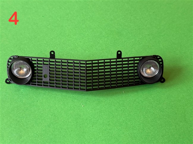

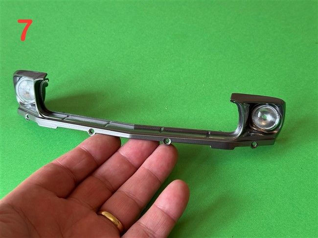

Place the dipped beam lenses on the reflectors as you did with the high beam lenses. Again, these will only fit one way, picture 7.
Fit the front grille trim moulding onto the grille support. This just clips into place, picture 8.

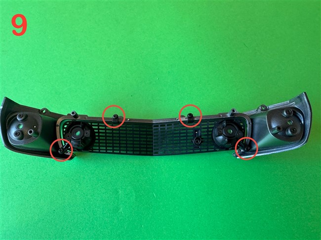

Finally, attach the front grille to the grille support and secure it in place using four of the type “E” screws, picture 9.
Picture 10 shows the completed assembly for this issue.

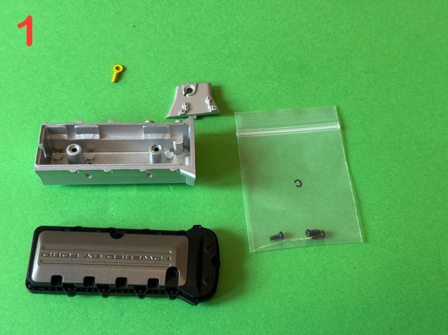

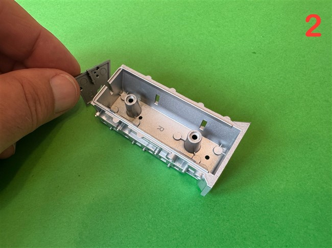

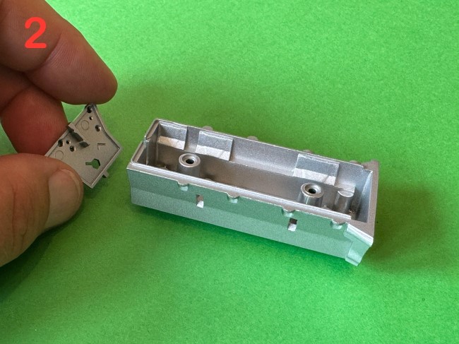

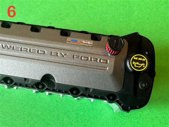

Fit the right cylinder head rear casting (4C) down into the slot of the right cylinder head (4A), picture 2.

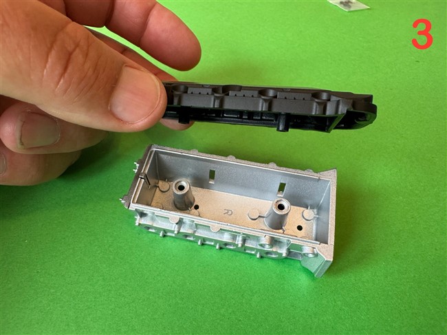

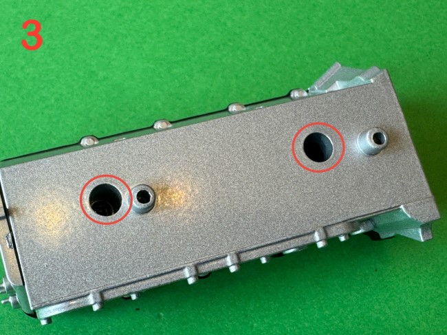

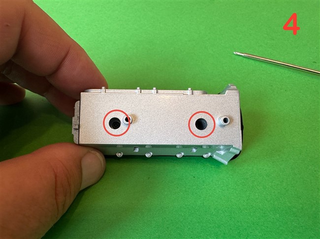

Fit the right valve cover (4B) onto the cylinder head, picture 3. Secure it in place using 2 x C screws, picture 4. Picture 5 shows the assembly.

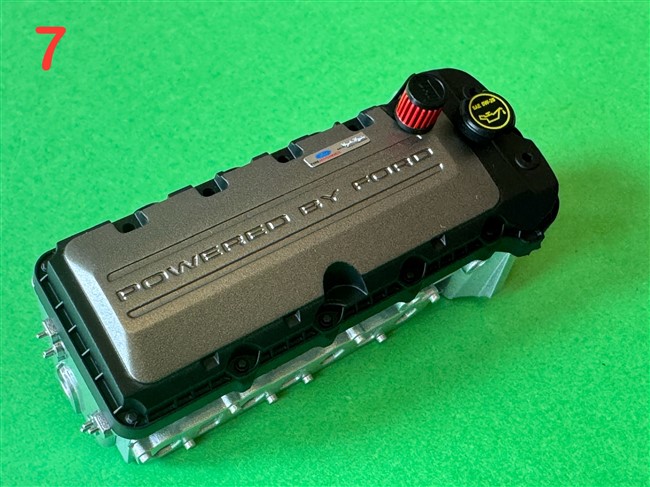

Press the valve cover breather (4E) into the hole in the valve cover. Fit the oil cap (4D) into its position by push fitting it into place, and finally, stick the engine badge (4F) on the valve cover. Picture 6 shows the parts in place.
Picture 7 shows the completed assembly for this issue.

#3 Posted : 10 July 2025 15:50:07
Posts: 6,966
Points: 21,205

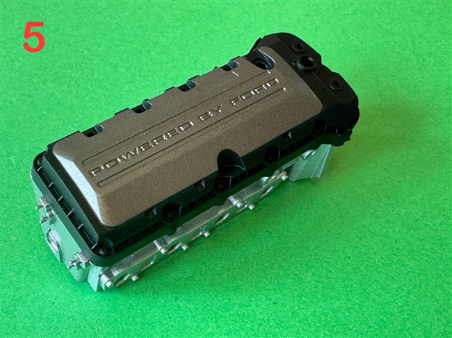

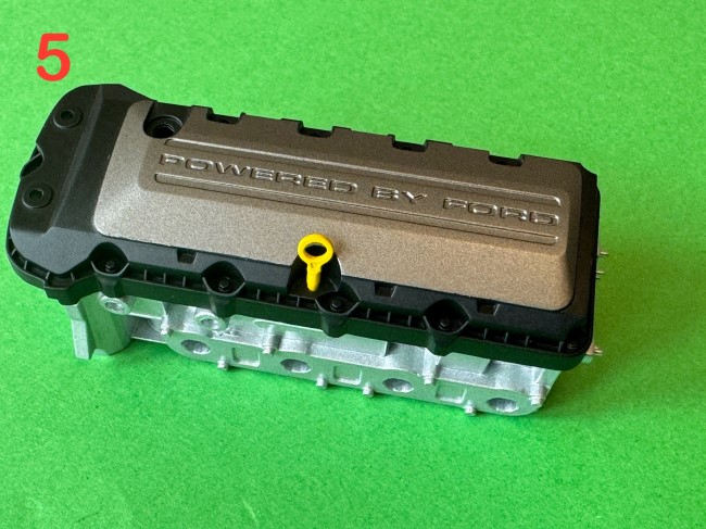

Issue 5

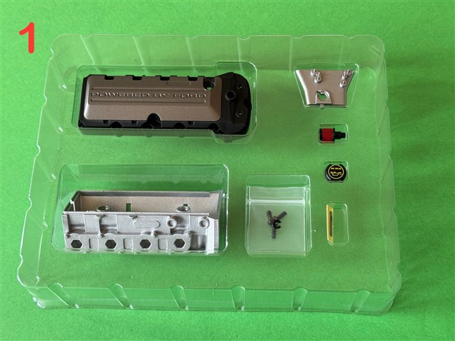

Fit the left cylinder head rear casting (5B) down into the slot of the right cylinder head (5A), picture 2.
Fit the left valve cover (5D) onto the cylinder head and secure it in place using 2 x C screws, picture 3. Picture 4 shows the assembly.
Press the dipstick (5C) into the hole in the left valve cover, picture 5.
