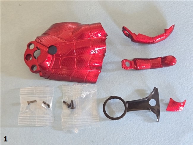

A new pack has arrived, covering Issues 9-14, so here`s Issue 9.

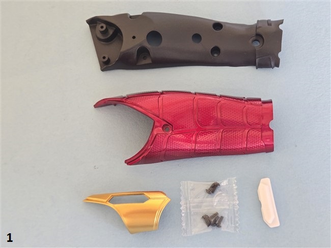

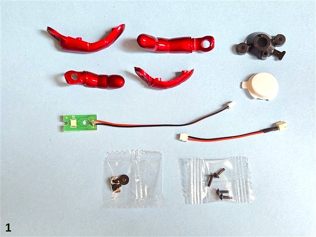

Parts supplied.....Pic 1, you will also need the right hand assembly from Issue 8 and the test batteries and circuit board.

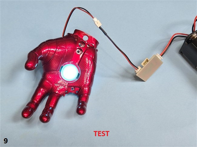

Before you start, follow the magazine instructions and test the led circuit board 07, supplied in this issue.

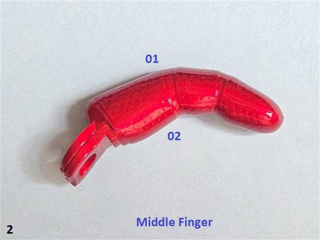

Carefully line up and press together the middle finger parts 01 and 02, as shown in Pic 2. Then do the same with the little finger parts 03 and 04, Pic 3.
Take the hand assembly from Issue 8 and fix the new fingers with a type A screw in each, Pic 4.

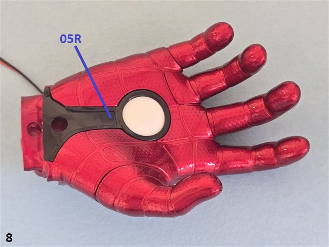

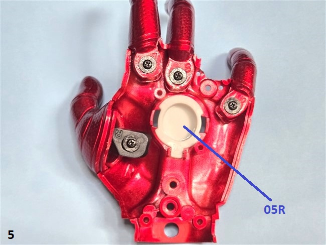

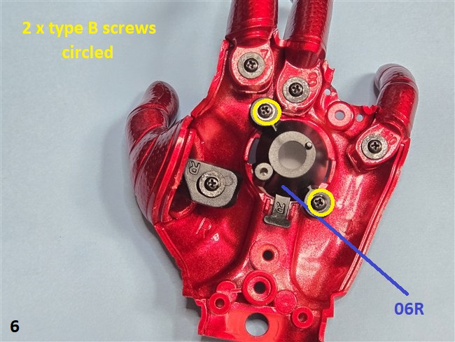

Now position the right palm display 05R, as shown in Pic 5. Then add the right palm screen frame 06R, fixing the parts in place with 2 x type B screws, Pic 6.

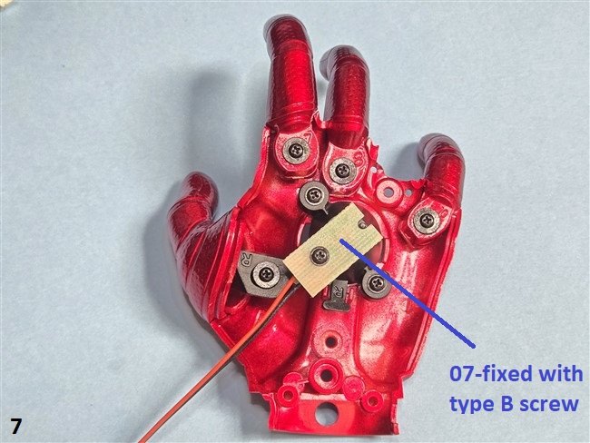

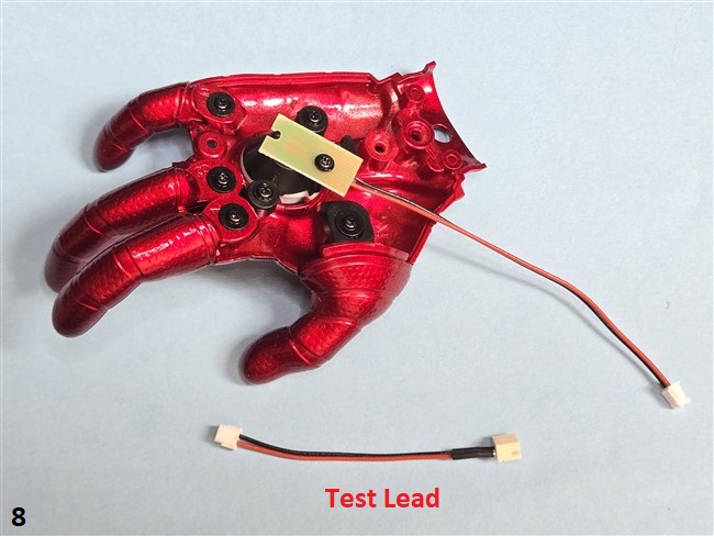

Position the circuit board 07 (tested earlier) and fix its position with a type B screw as in Pic 7. The final assembly is shown in Pic 8, but I like to retest the circuitry after assembly and that`s shown in Pic 9.

Time for the next Iron Spider update (Issue 10), where we add more to the right hand from Issue 9.
Parts supplied.....Pic 1, you will also need the final assembly from Issue 9 and the number labels from Issue 7.

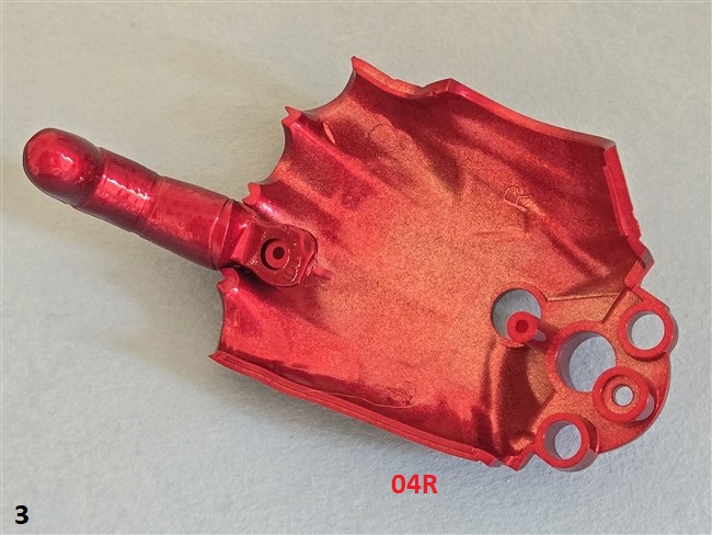

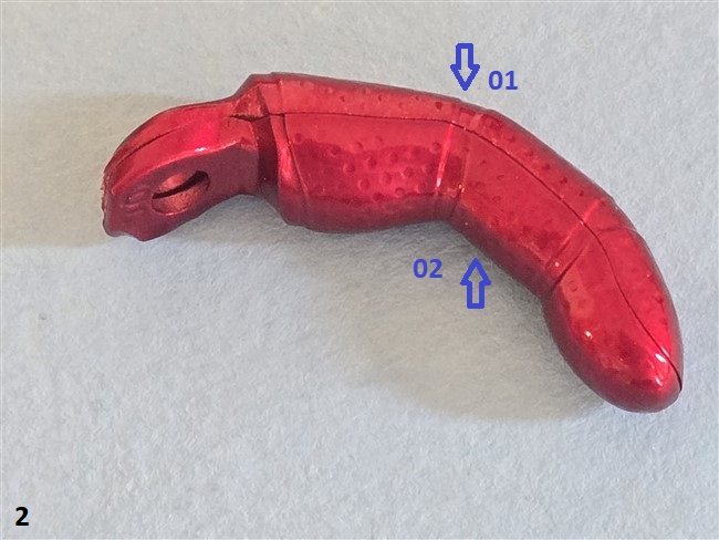

Start by pressing the two halves of the Ring Finger, parts 01 and 02 together as shown in Pic 2. Then position the finger onto its post in the back of the hand 04R, Pic 3.

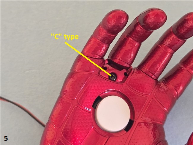

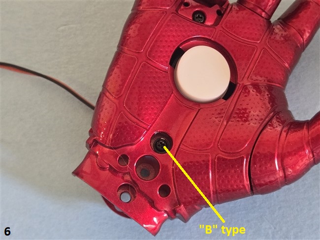

Now bring the palm and back of the hand together, carefully feeding the cable through the back of the hand as shown in Pic 4. The two halves of the hand are now fixed together, with a type "C" screw shown in Pic 5 and a type "B" screw in Pic 6. With the hand now fixed together, place the cover 03R into position at the base of the ring finger, Pic 7.

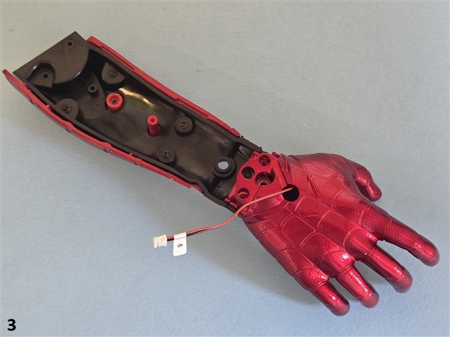

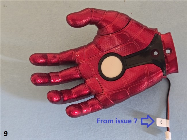

Carefully press the web launcher chassis 05R into the palm/wrist as shown in Pic 8. That just leaves the number "6" label (from issue 7) to apply to the cable, Pic 9. The end result of this update is shown in Pic 10.

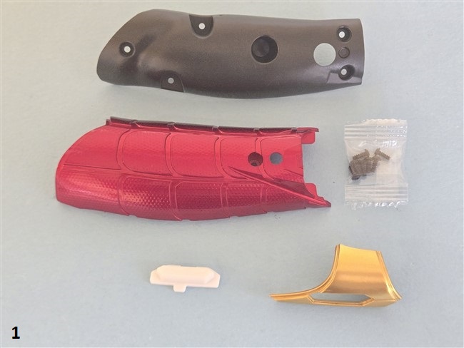

Parts supplied.....Pic 1, you will also need the right hand from the previous update.

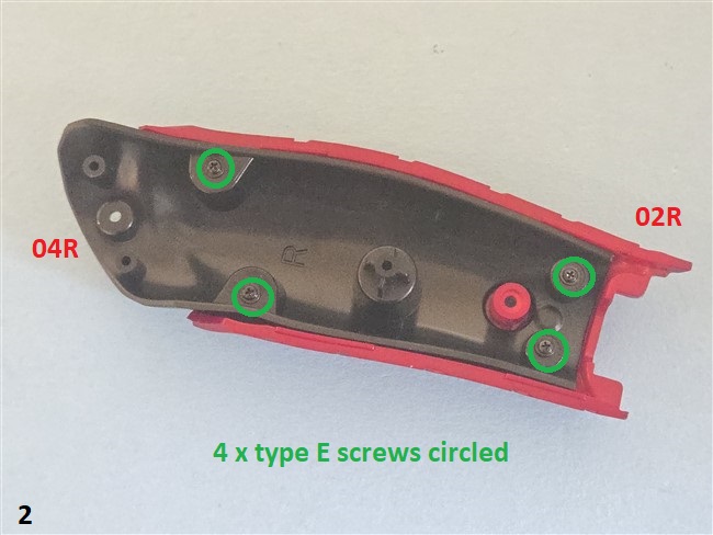

Place the right forearm inner 04R, inside the right forearm lower plate 02R and fix them together with 4 x "E" screws, Pic 2.

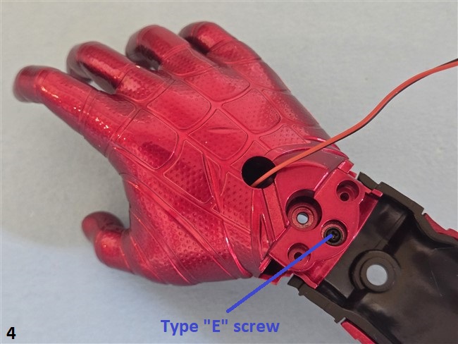

Now position the hand from the previous update onto the forearm, using the orientation shown in Pic 3, with a closer view of the "E" fixing screw shown in Pic 4.

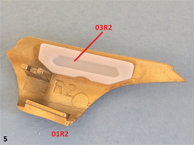

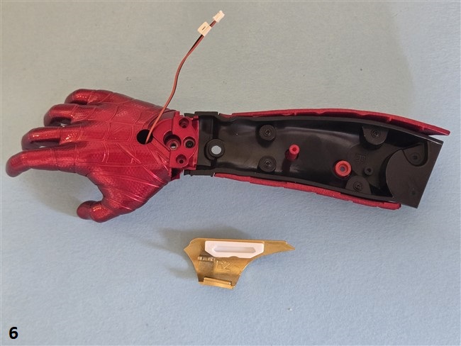

Finally place the right web-shooter light cover(1) 03R2, inside the side of the web-shooter 01R2. Shown in Pic 5.
That`s all for this update, Pic 6. Store the parts carefully until needed again.

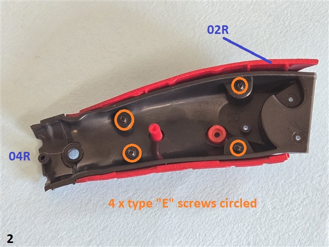

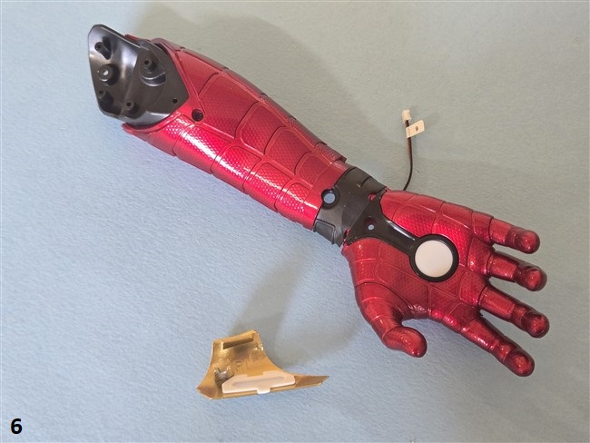

Update time with Issue 12 of Iron Spider.
Parts supplied.....Pic 1, you will also need the main final assembly from Issue 11.
Place the inner forearm 04R, inside the outer forearm 02R and fix the parts together with 4 x type "E" screws, Pic 2.

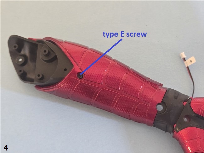

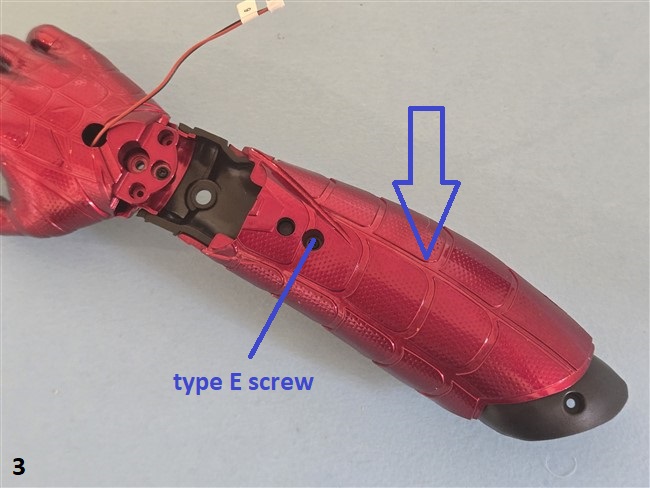

Position the forearm assembly just made, onto the hand/forearm from Issue 11 and fix them together with a type "E" screw as shown in Pic 3. Then turn the arm over and insert another type "E" screw to further secure the arm together as shown in Pic 4.
Finally, position the light cover 03R1, inside the web shooter part 01R1, Pic 5.Note that these parts are not fixed together at this stage, so store them carefully with the other assemblies.
Pic 6 shows the final assemblies for this update.
