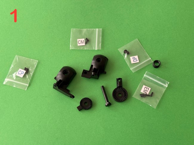

Picture 1 shows the parts for this issue.

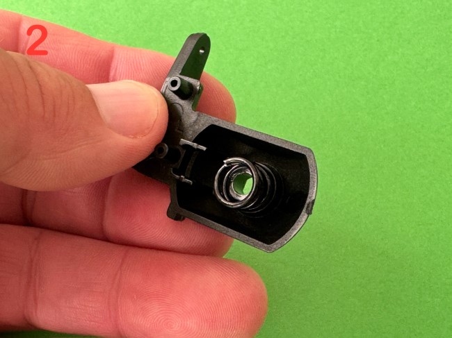

Assembling the Left Shoulder

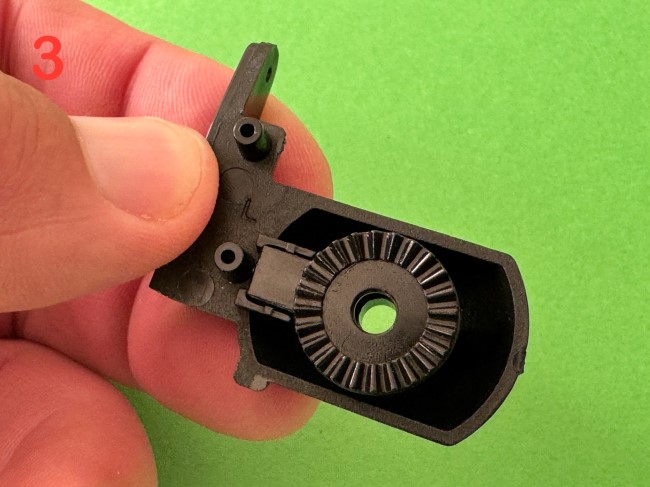

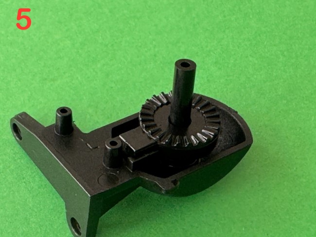

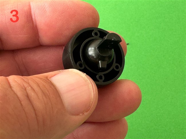

Take the outer shoulder (79A) and place the spring (79E) inside, picture 2. Place the joint gear (79C) over the top, picture 3. Feed the shaft (79F) through the hole as shown in pictures 4 and 5.

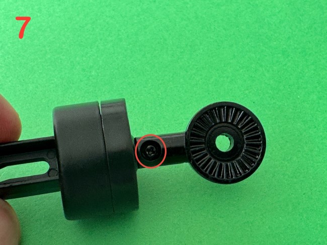

Connect the joint gear (79C) with the shoulder assembly from the last issue and secure it with a CM screw, pictures 6 and 7.

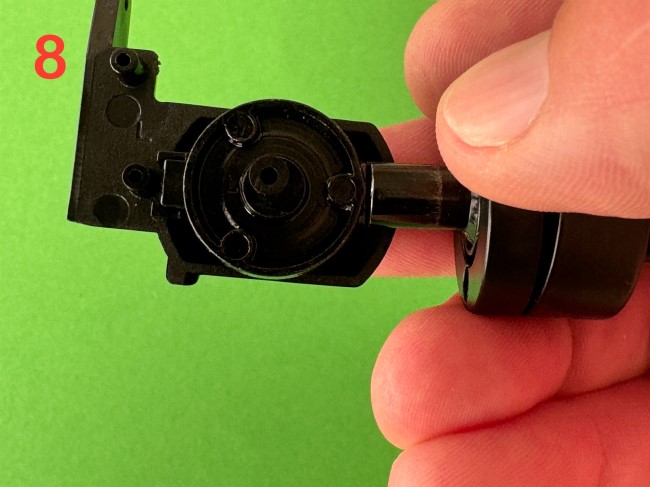

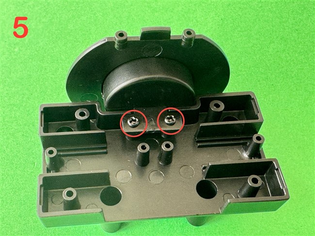

Now attach the two assemblies so that the notches match, picture 8. Place the outer support (79B) over the outer support (79A) and secure it in place using a DP screw, picture 9. Place 2 x CP screws into the holes as illustrated in picture 10.

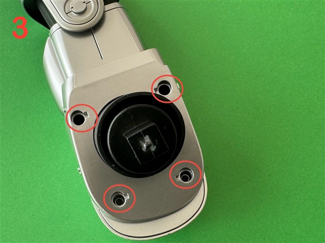

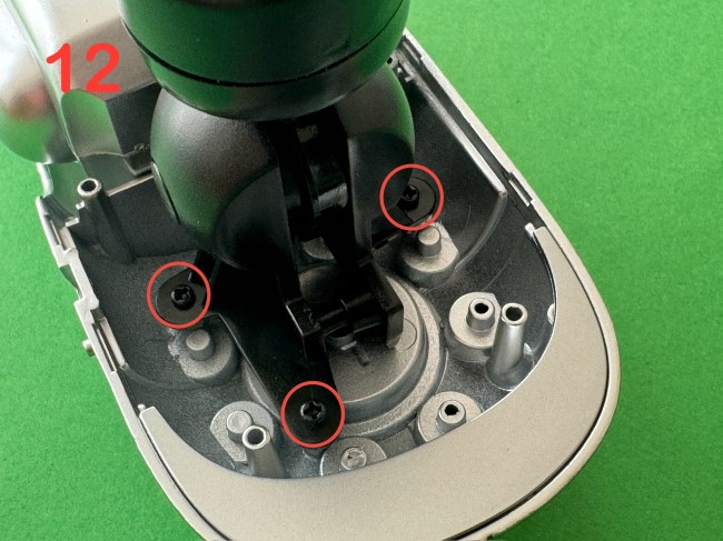

Retrieve the arm assembly from issue 78 and attach the new assembly to the inside top of the arm using 3 x EM screws as shown in pictures 11 and 12.

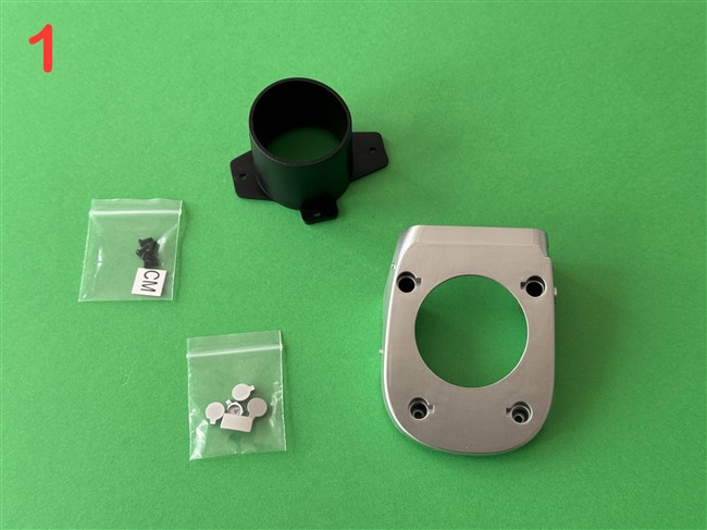

Issue 80
The Left Shoulder

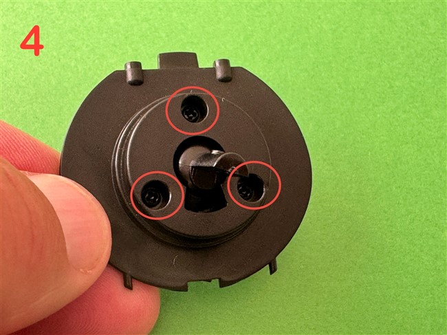

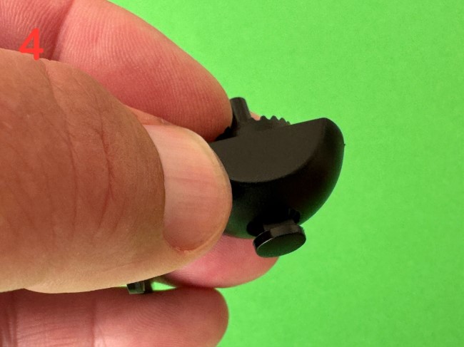

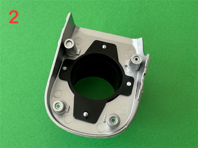

Insert the shoulder joint sleeve (80B) into the inside face of the left shoulder cover (80A), picture 2.
Retrieve the assembly from issue 79 and connect the left shoulder inner cover to the outer cover securing it in place with 4 x CM screws, picture 3. Cover the screw holes with the four covers (80C, D, E and F), picture 4.

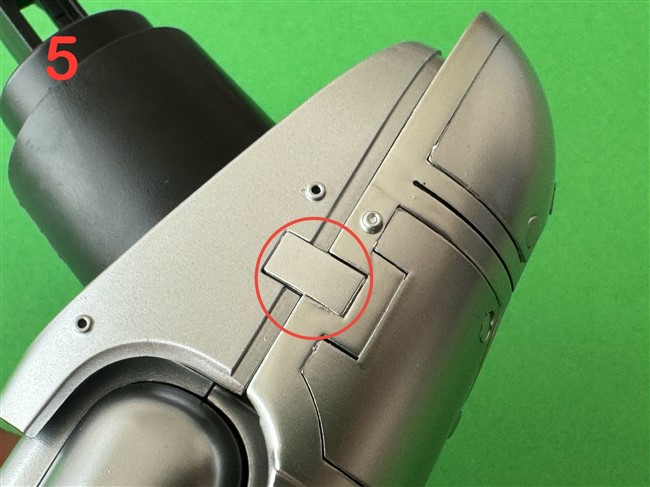

Finally, push the shoulder end cap (80G) into the holes taking care to match the size of the pins to the holes, picture 5.

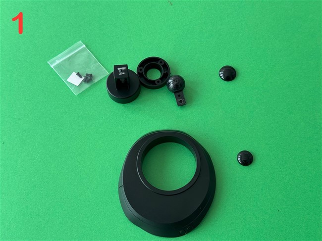

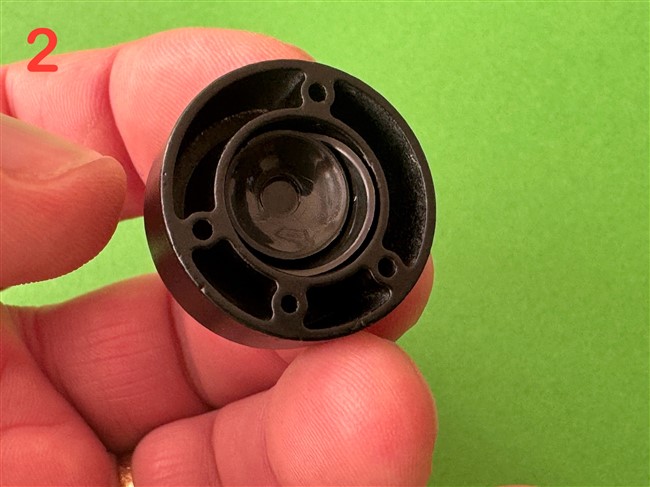

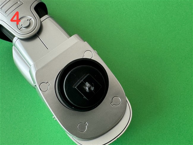

#3 Posted : 17 June 2025 22:20:34
Issue 81
The Left Shoulder

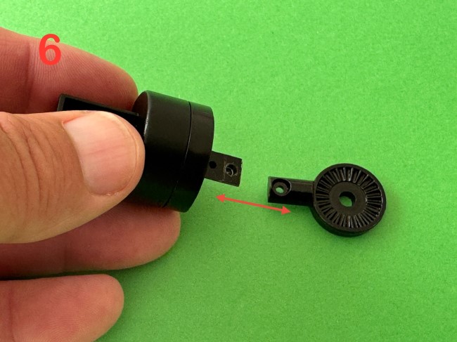

Place the friction block (81E) inside the lower neck joint support (81D) and then place the smaller friction block (81F) over the top of the first friction block, pictures 1 and 2.
Fit the ball joint (81B) over the top of the friction blocks, picture 3.
Now connect the assembly to the other lower neck support (81C) and secure them in place using 3 x EP screws, picture 4.
Secure the assembly to the rear shoulder support (81A) as shown in picture 5, using 2 x EP screws.

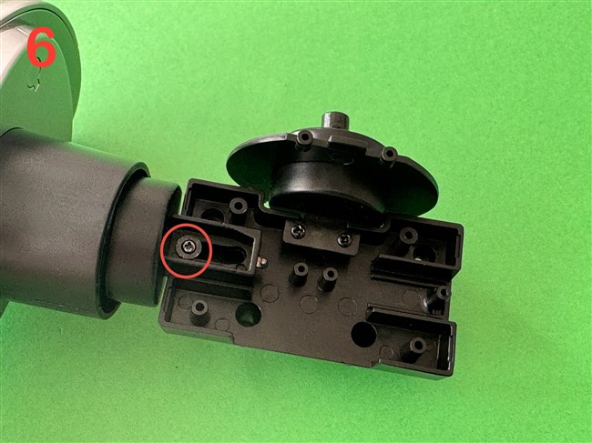

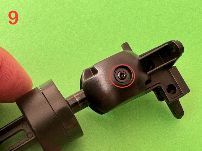

Retrieve the left arm from issue 80 and insert the left shoulder joint sleeve (80B) into the joint cover.
Finally, connect the rear shoulder support assembly to the shoulder joint by passing the side pin on 81A through the slot as shown in picture 6. Secure it using a TP screw.

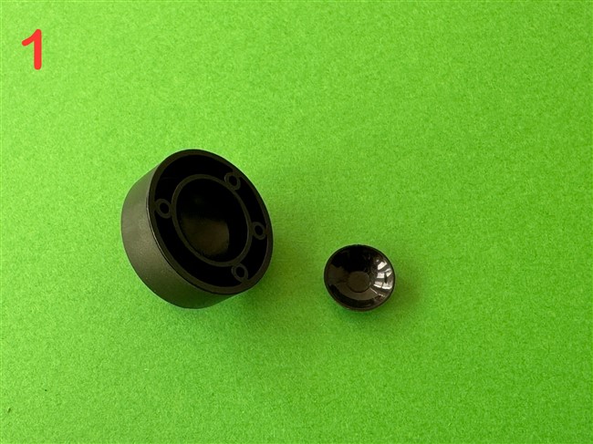

#4 Posted : 18 June 2025 19:37:42
Issue 82
Picture 1 shows the contents of this issue
The Right Shoulder

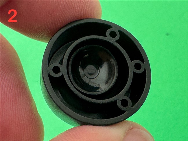

Place the friction block (82C) inside the right shoulder joint internal support (82B), picture 2.
Please note, I only used one of the friction blocks in the support as using the two makes it near impossible to connect the final assembly together. I also found that just using the one was more than sufficient.
Place the ball joint (82E) over the friction block and then bring together the other shoulder internal support (82A). Secure them by using 3 x CM screws, picture 3.
