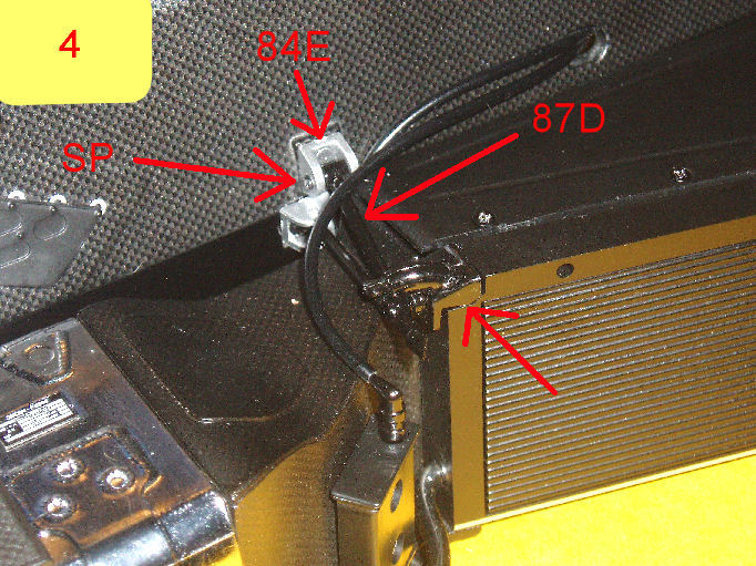

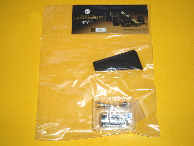

STAGE 87:

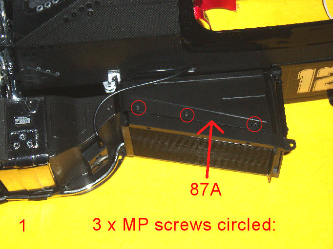

Sidepod right top panel.
Pic 1: Fit the top panel 87A in place on the right sidepod and fix using 3 x MP screws.

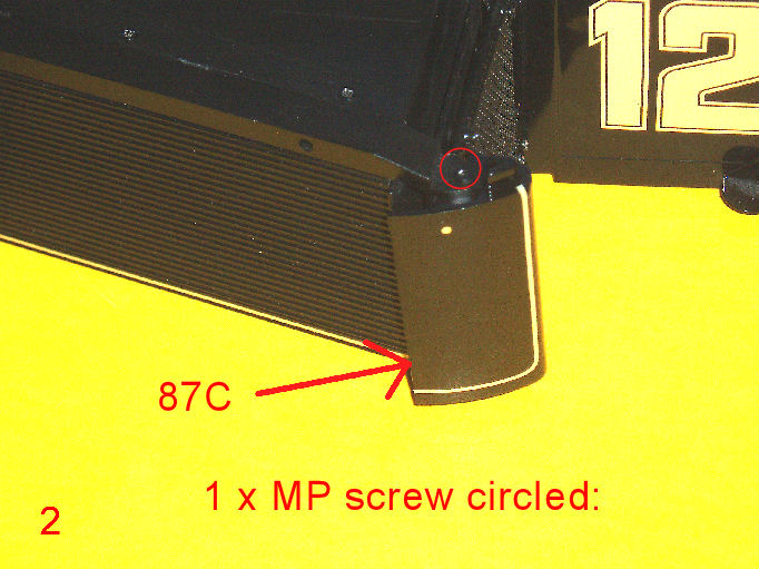

Pic 2: Fit the fight air divider 87C as shown and fix with 1 x MP screw down through the top of the radiator bracket.

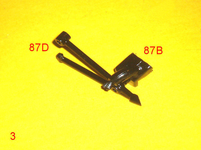

Pic 3: Press-fit the two support bracket parts 87B and 87D together as shown.
Pic 4: Fit the assembled bracket to the car as shown, locating the end nearer the body in the silver bracket 84E and fixing with 1 x SP screw from behind.
Press the outer end of the assembled bracket in the hole in the upper edge of the radiator as indicated in the picture.
Store the model safely for now.

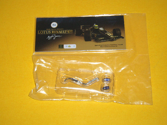

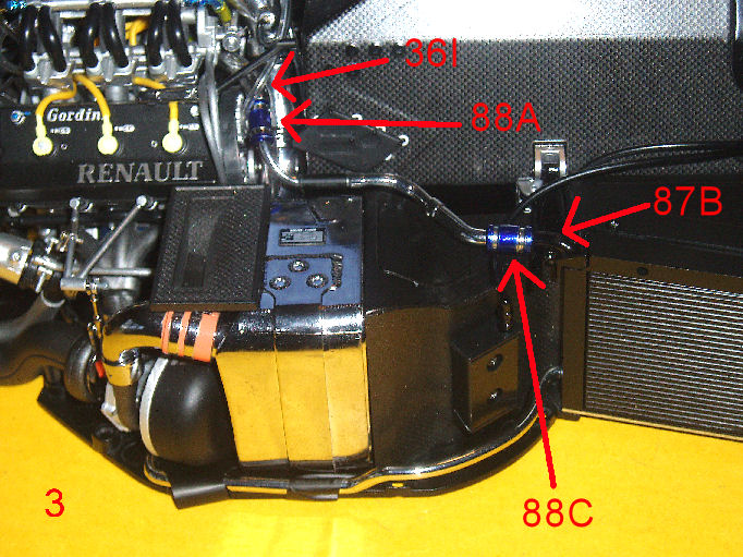

STAGE 88:

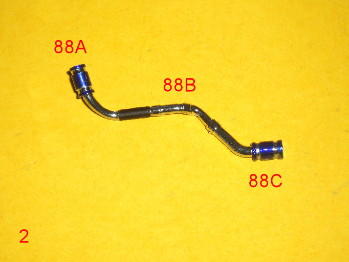

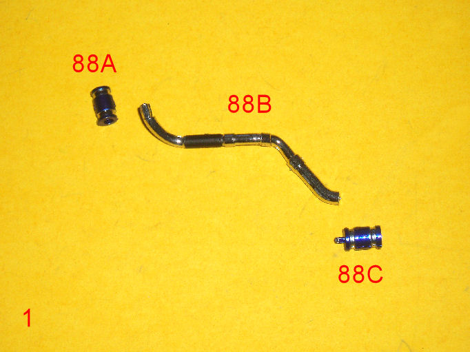

Right radiator hose.
Pic 1: Locate the hose and fittings 88A, 88B and 88C.
Pic 2: Press-fit the parts together as shown.
Pic 3: Fit the assembled hose to the car connecting the ends as shown.
88A fits to the chrome pipe on the engine, 36I.
88C fits to the connector 87B on the top outside of the radiator.

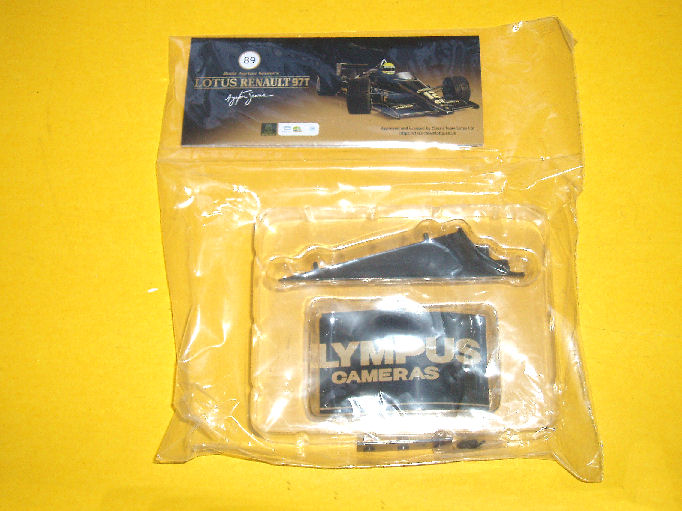

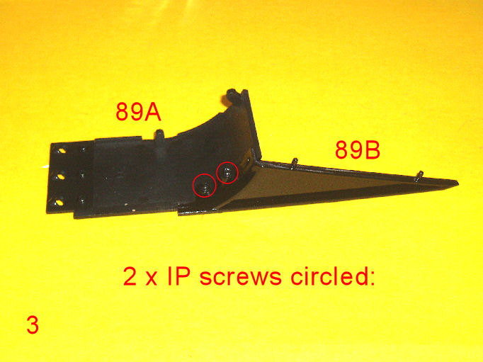

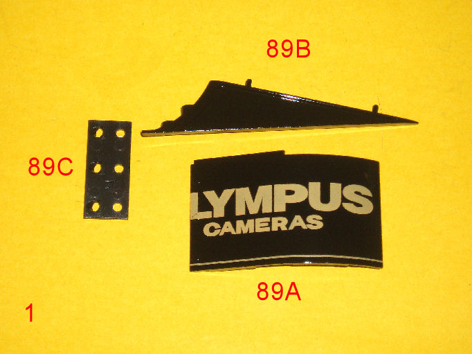

STAGE 89:
Right sidepod fairing.

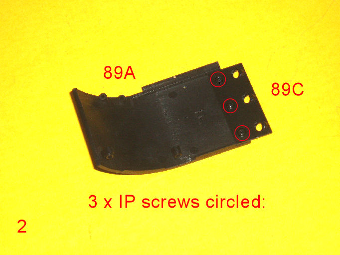

Pic 1: Locate the fairing parts 89A, 89B and 89C.
Pic 2: Fit parts 89A and 89C together as shown.
They will only fit one way.
Fix them with 3 x IP screws.

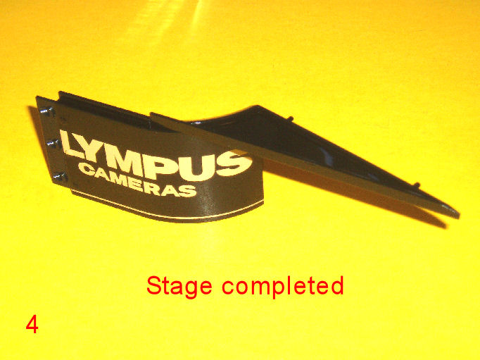

Pic 3: Fit the upper fairing part 89B to the top curved edge of 89A as shown and fix with 2 x IP screws.
Pic 4: Shows the stage completed.
Store the parts safely for now.

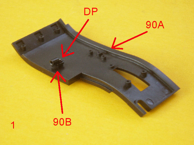

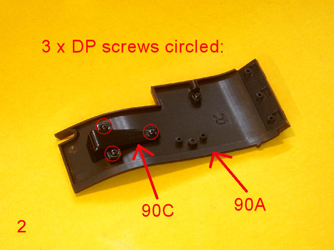

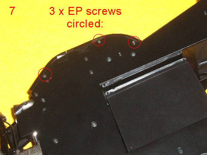

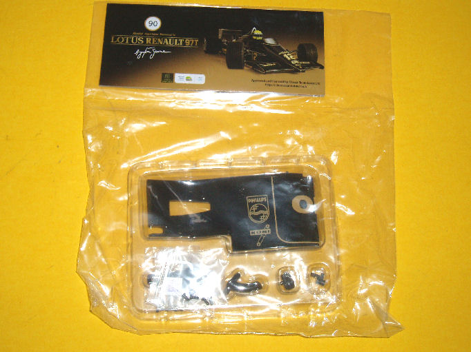

STAGE 90:
Pic 1: Locate the fairing and mounting bracket 90A and 90B.
Fix the bracket 90B in place and fix with a DP screw.
Pic 2: Fit the NACA duct 90C to the inside of the fairing 90A as shown and fix with 3 x DP screws.

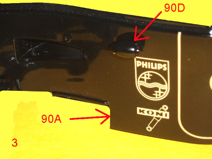

Pic 3: Press-fit the cooling scoop 90C to the outside of the panel 90A.
It will only fit one way.

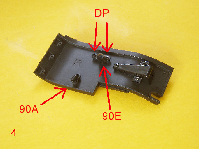

Pic 4: Fit the inner cooling duct 90E to the inside of the panel 90A as shown and fix with 2 x DP screws.

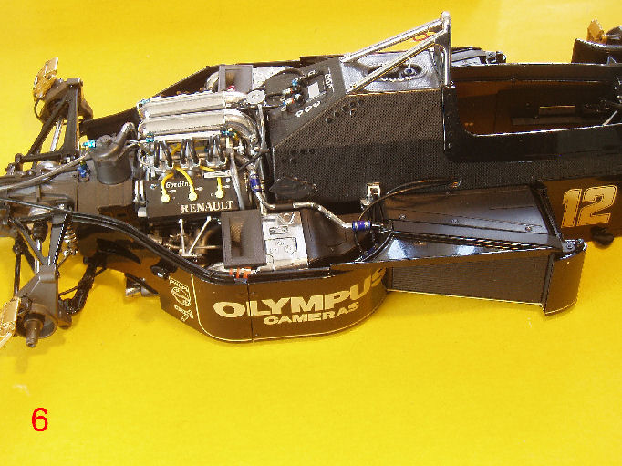

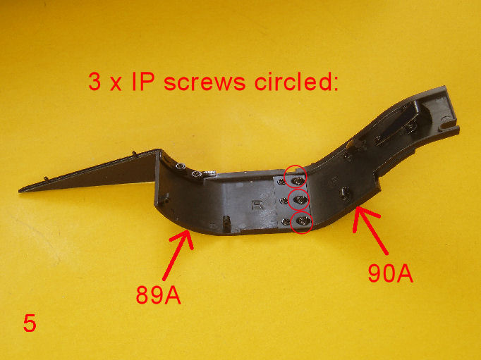

Pic 5: Retrieve the panel 89A from the previous stage and fit it together with panel 90A as shown.
Secure the parts together with 3 x IP screws.
Pic 6: Retrieve the main car and fit the fairing assembly in place as shown.
Make sure the two pins on the upper front edge of the fairing locate in the holes on the top edge of the radiator.
Pic 7: Turn the car over and fix the fairing in place using 3 x EP screws.

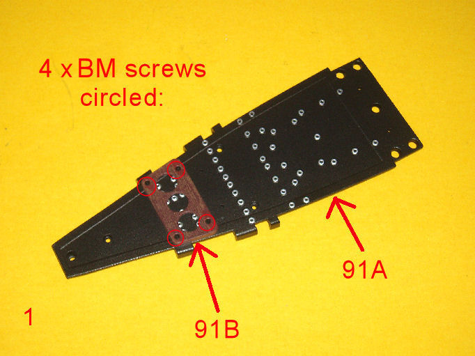

STAGE 91:
Nose panel and fire extinguisher.
Pic 1: Locate the nose panel and wood nose plate 91A and 91B.
Fit the parts together as shown and fix them with 4 x BM screws.
NOTE: The picture in the printed instructions shows the wood plate the wrong way round.

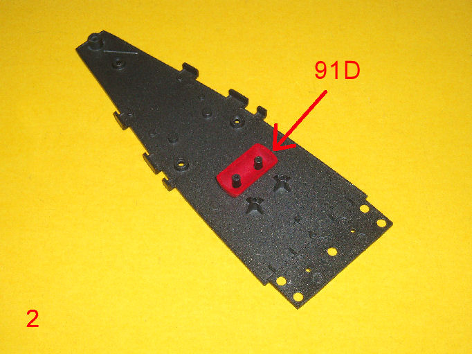

Pic 2: Turn the nose panel over and fit the lower half of the fire extinguisher 90D over the two longer posts.
Pic 3: Fit the upper half of the fire extinguisher 90C in place and fix with 2 x BM screws through the holes in the top.

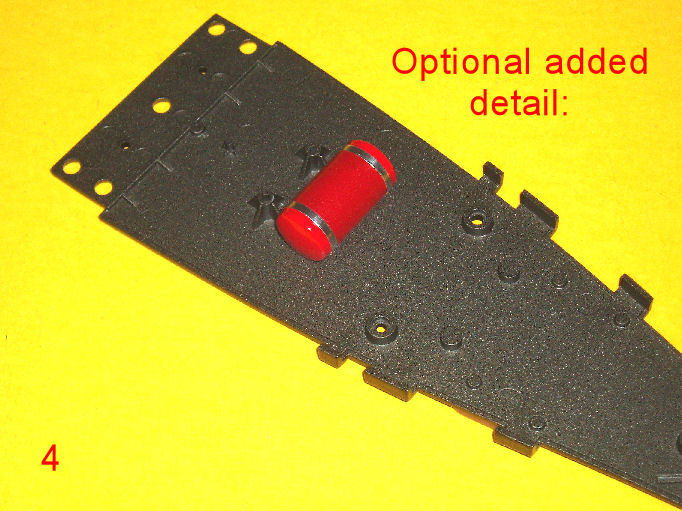

Pic 4: OPTIONAL DETAIL.
To improve the look of the fire extinguisher, wrap a piece of red electrical tape over the centre section to cover the screw holes and add self-adhesive aluminium foil strips over the retaining straps.
This is entirely at the builder’s discretion
