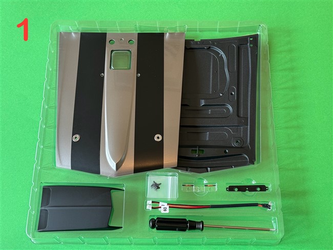

Picture 1 shows the parts for this issue.

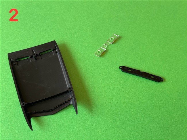

Take the parts (1A, 1F and 1B) as shown in picture 2. Take the hood turn signal light lenses and place it into the hood scoop, picture 3. Now place the lens bracket over the lens, pushing it onto the light lens until it clips into place, picture 4.

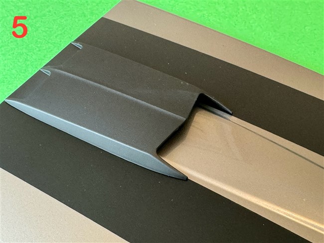

Place the assembly onto the hood/bonnet (1C), picture 5, then turn the assembly over and secure it in place using 3 x “B” screws, picture 6.

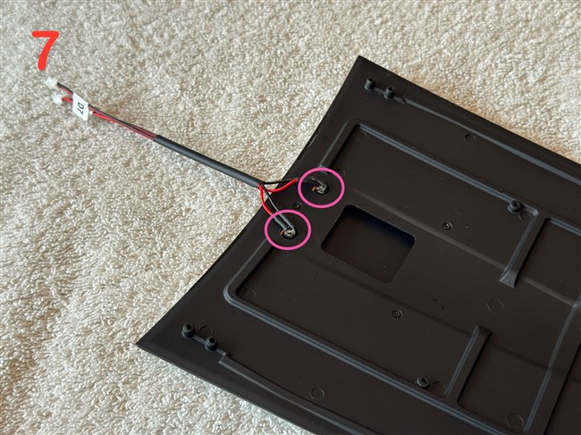

Now fit the two LEDs from the cable (1E) and push them in place in the underside of the hood/bonnet as shown in picture 7.

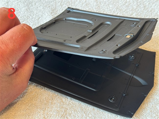

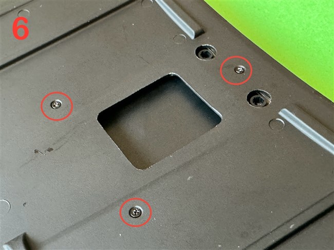

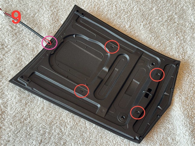

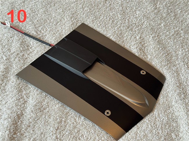

Fit the inner hood reinforcement (1D) onto the inside of the hood, picture 8. Secure the inner hood/bonnet using 4 x “A” screws as circled in red in picture 9. Make sure the cable runs between the slot at the top of the inner hood as shown with a purple circle in picture 9.
Picture 10 shows the completed assembly for this issue.

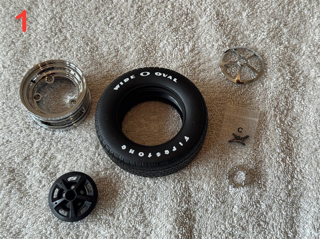

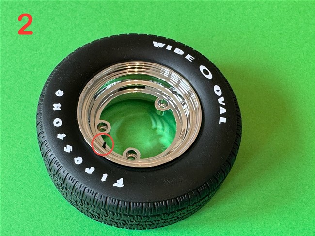

Fit the left wheel rim (2C) into the left front tyre (2A). Push fit it in from the facing outside tyre, making sure the tyre valve is facing outwards as shown in picture 2.

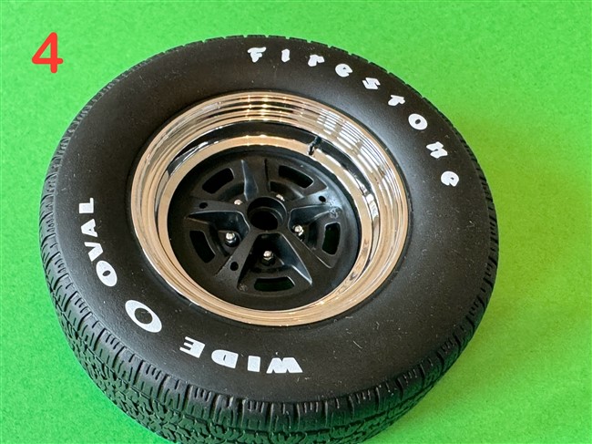

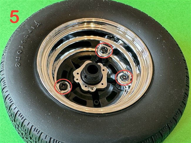

Press the front wheel hood mounting (2E) into the holes around the middle section of the inner wheel centre (2B), picture 3. Place the assembly into the centre of the wheel as shown in picture 4. Turn the assembly over and secure the inner wheel with 3 x “C” screws, picture 5.

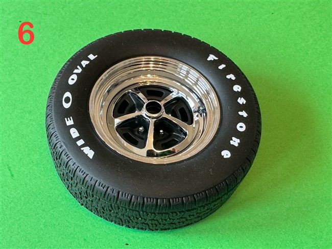

Finally, place the front wheel outer centre (2D) into the inner centre, push fitting the three pins in place, picture 6.
