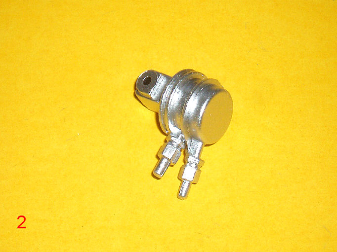

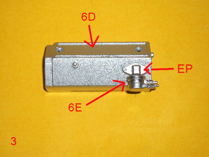

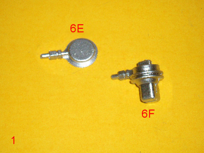

Pic 1: Locate the two fuel pump parts 6E and 6F.
Pic 2: Press the two parts together as shown.
They will only fit one way.

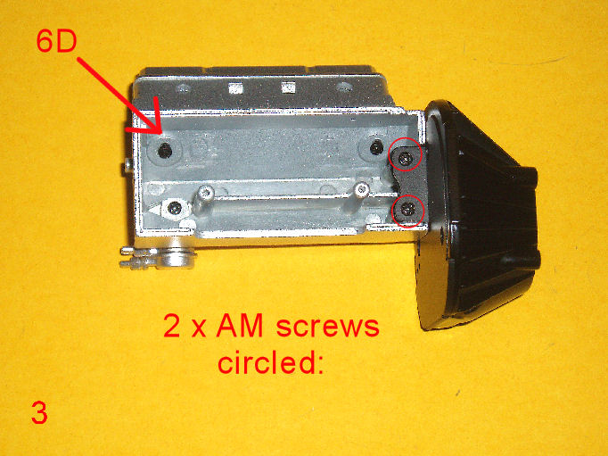

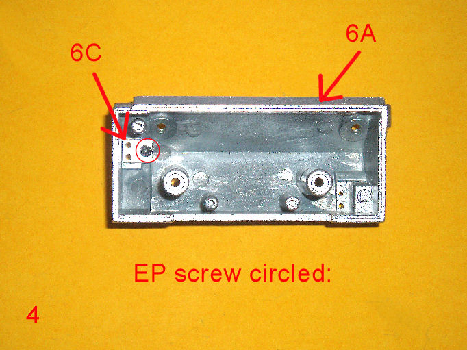

Pic 3: Fit the assembly to the right engine block 6D as shown.
Fix from the inside with 1 x EP screw.
The part will only fit one way.
Pic 4: Fit the small bracket 6C into the left engine block and fix with 1 x AM screw.
Pic 5: Fit the outside bracket 6B to the left engine block 6A as shown and fix from the inside with 2 x CM screws.

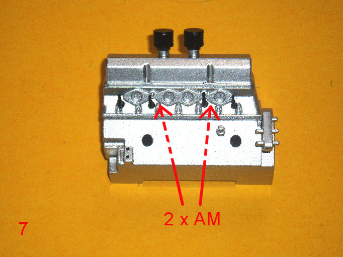

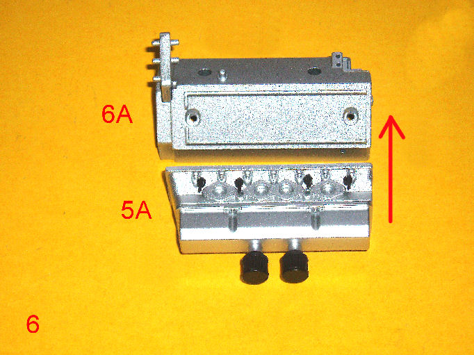

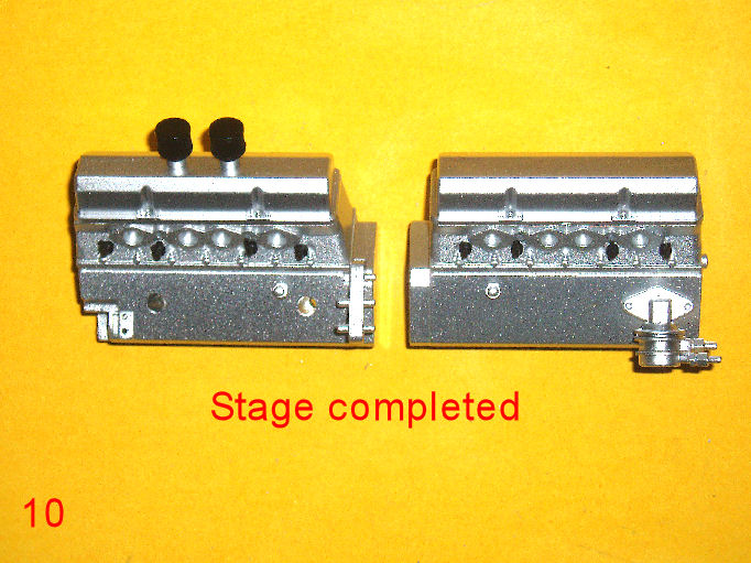

Pic 6: Retrieve the left cylinder head 5A. It will fit onto the left engine block 6A.
Pic 7: Fit the two parts together as shown and fix from the inside with 2 x AM screws.

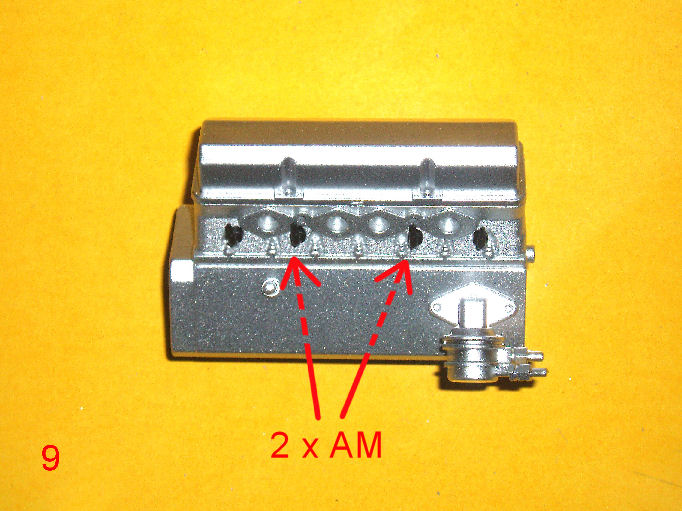

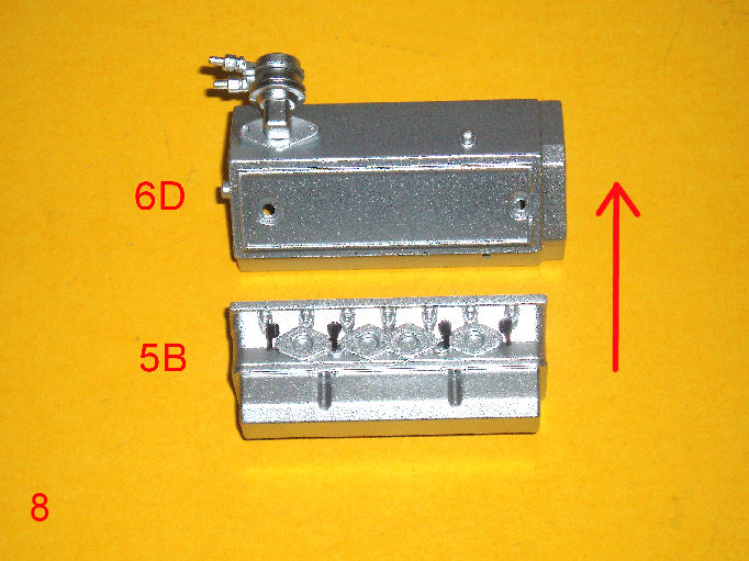

Pic 8: Retrieve the right cylinder head 5B. It will fit onto the right engine block 6D.
Pic 9: Fit the two parts together as shown and fix from the inside with 2 x AM screws.
Pic 10: Store all of the parts safely for now.

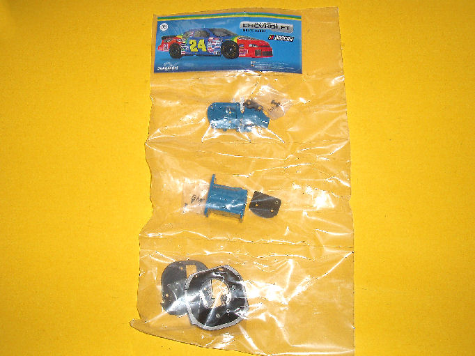

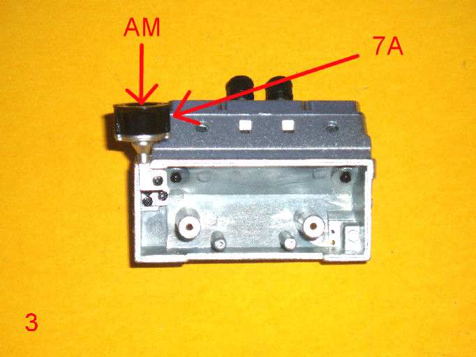

STAGE 7:
Distributor and oil pan.

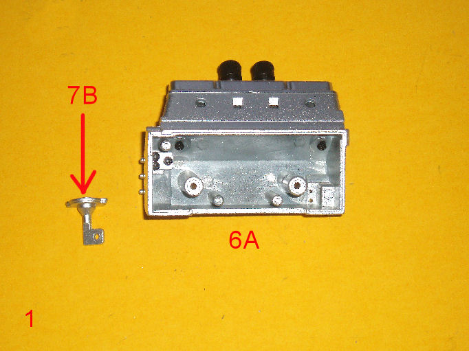

Pic 1: Retrieve the left engine block 6A and locate the distributor bracket 7B.
Pic 2: Fit the bracket as shown and fix with 1 x AM screw.
Pic 3: Fit the distributor body 7A as shown and fix with 1 x AM screw down the centre.

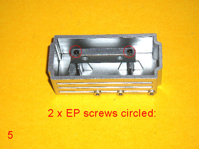

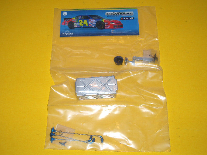

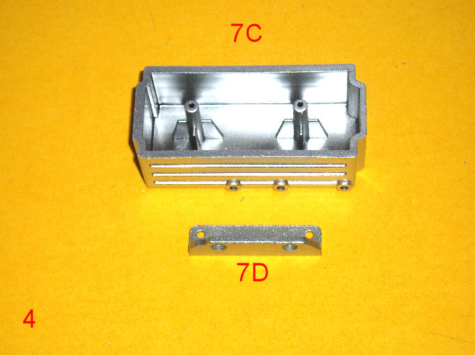

Pic 4: Locate the oil pan 7C and bracket 7D.
Pic 5: Fit the parts together as shown and fix using 2 x EP screws.

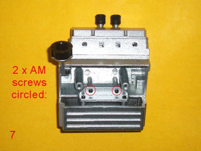

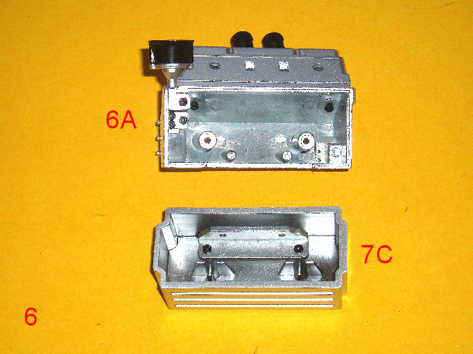

Pic 6: Retrieve the left engine block 6A.
Pic 7: Fit the engine block and oil pan together as shown and fix using 2 x AM screws.

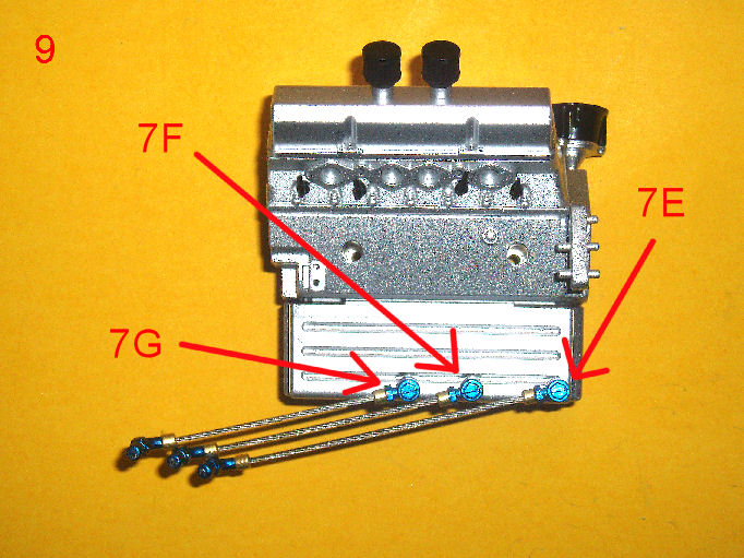

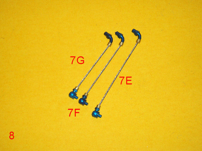

Pic 8: Locate the three oil hoses 7E, 7F and 7G.
They are identified by the different lengths.
Pic 9: Fit the oil hoses to the oil pan in the order shown.

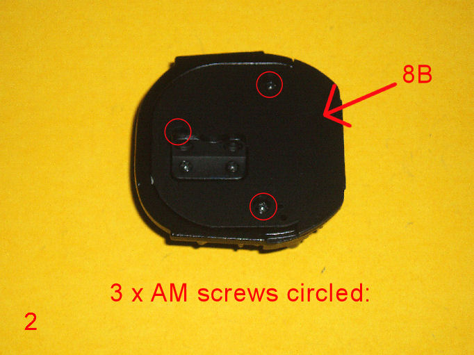

Pic 1: Fit the bracket 8C inside the clutch bell housing 8A as shown and fix with 2 x AM screws.
Pic 2: Fit the front plate 8B and fix with 3 x AM screws. The part will only fit one way.

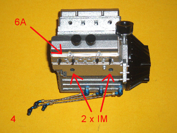

Pic 4: Retrieve the left engine block assembly 6A and fit it to the right half 6D, securing the parts together with 2 x IM screws as shown.

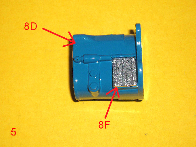

Pic 5: Locate the transmission case body 8D and press the cover plate 8F into place.
It will only fit one way.

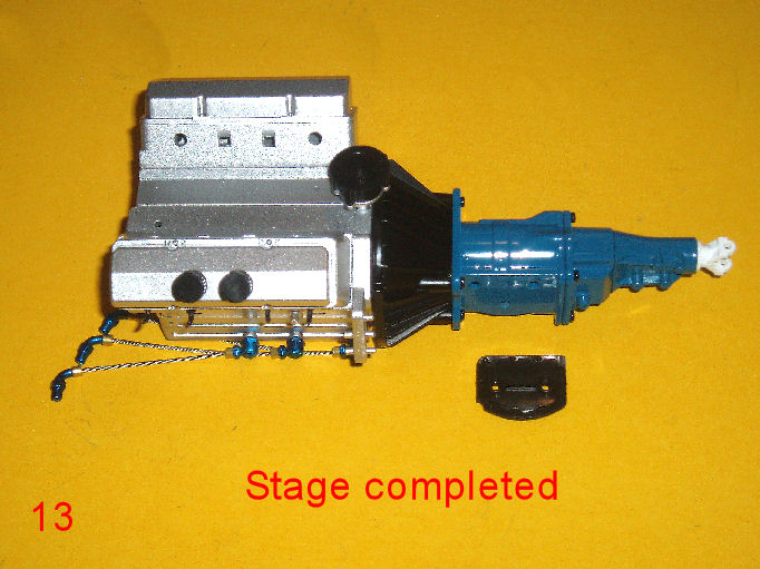

STAGE 8B:

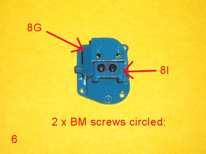

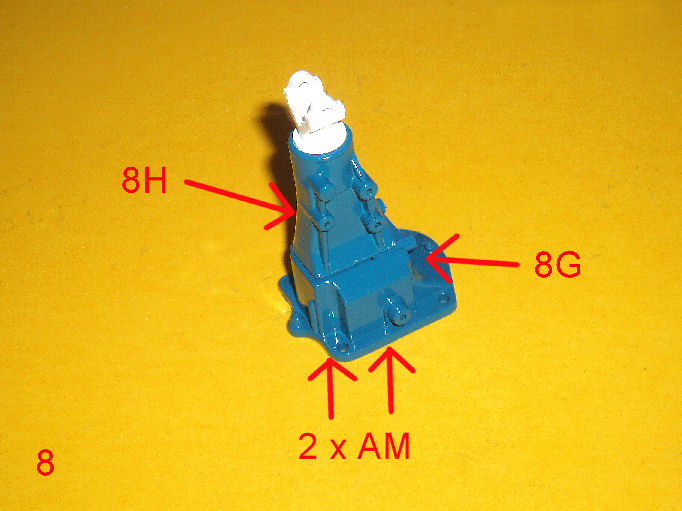

Pic 6: Fit the bracket 8I to the case mid-section 8G and fix with 2 x BM screws.

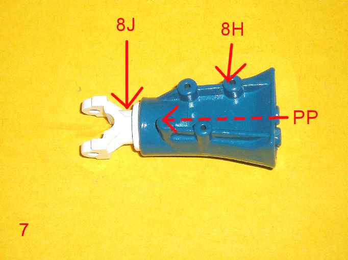

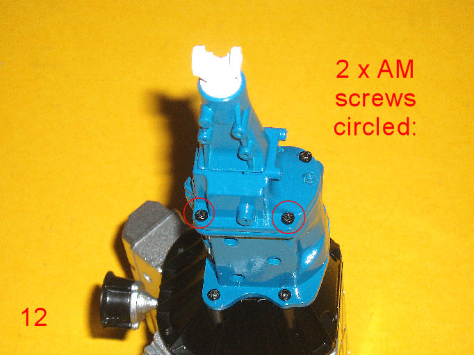

Pic 7: Fit the drive shaft slip yoke 8J into the transmission case end 8H and fix from the inside with 1 x PP screw.
Pic 8: Fit the transmission case assemblies 8G and 8H together as shown and fix with 2 x AM screws from the inside.

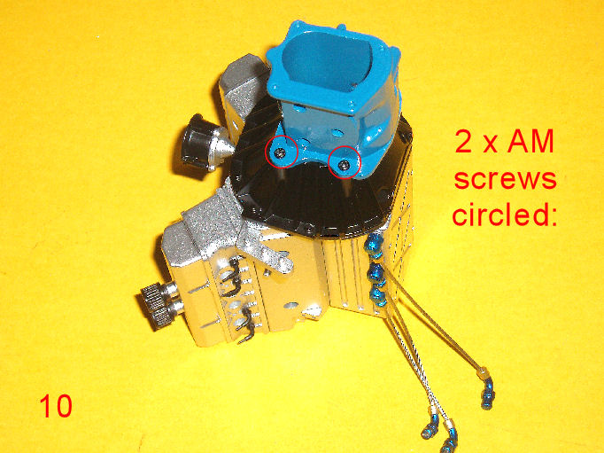

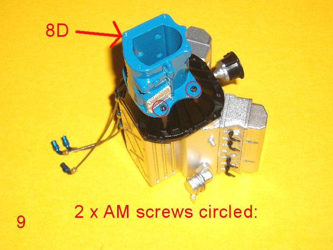

Pic 9: Fit the transmission case 8D to the clutch bell housing on the engine assembly as shown and fix with 2 x AM screws.
Pic 10: Turn the assembly around and fit a further 2 x AM screws on the other side.

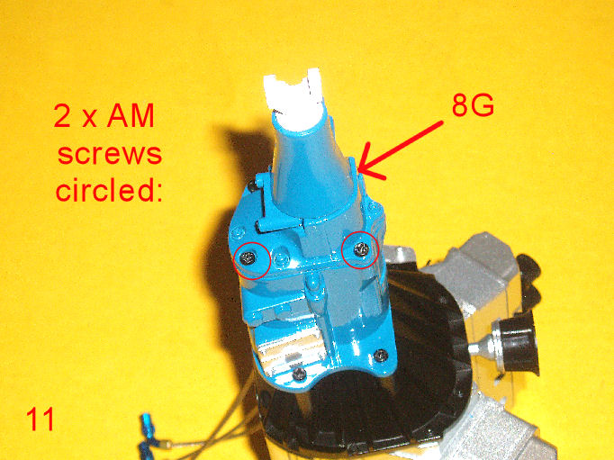

Pic 11: Fit the mid transmission assembly 8G in place and fix using 2 x AM screws as shown.
Pic 12: Turn the assembly around and fit a further 2 x AM screws on the other side.
Pic 13: Store all of the parts safely for now.
