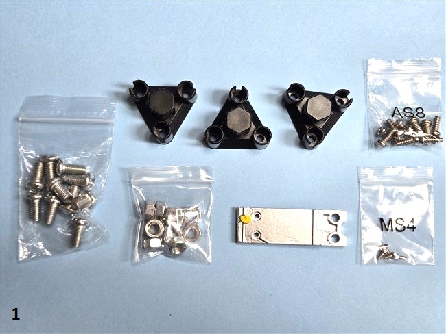

#1 Posted : 02 May 2025 13:52:43

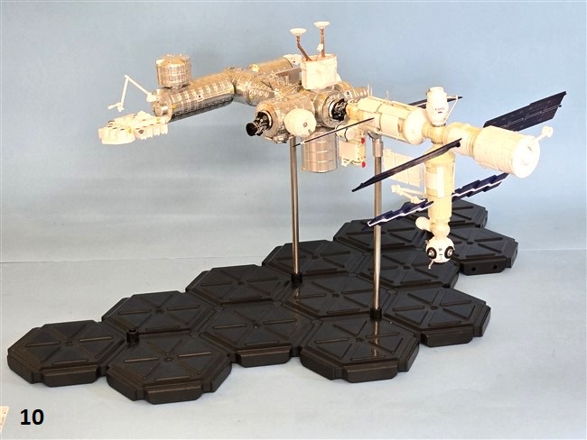

Hi All, BigGrin
Pack 15 of the ISS has arrived, so here`s the first update with Issue 75.
Parts supplied.....Pic 1, you will also need the main model on the base and the solar panel from Issue 74, plus the base assembly also from Issue 74.
Start with the solar array from issue 74 and add the panel 26M, fixing it in place with 2 x MS4 screws, shown in Pics 2 and 3.

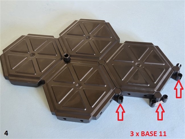

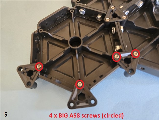

Now add the 3 x BASE 11 parts supplied to the base from issue 74, as shown in Pic 4. Turn the parts over and fix them with 4 x BIG AS8 screws, indicated in Pic 5.
Ok, Option 1: start up your zero gravity workshop.....Confused, no I don`t have one either. Option 2: Find someone you trust to hold your model and the base upside down while you work on it. Wifey`s comment not printable here. So, against the instructions, Option 3: Remove the ISS from its base and put it somewhere safe for now.

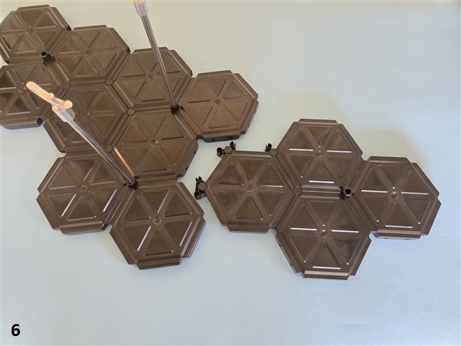

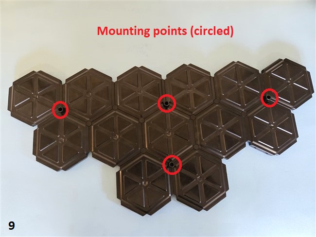

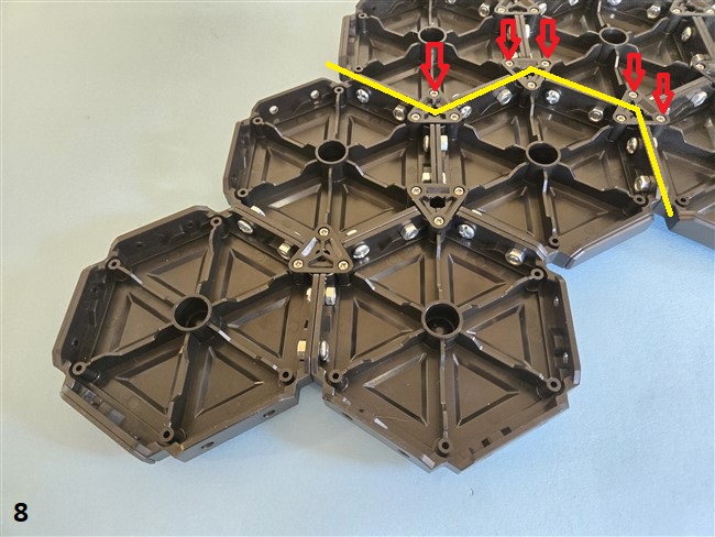

Pic 6 shows the orientation of the two base sections (mounting posts included). Fit the two sections together as shown in Pic 7. Remove the mounting posts and fix the BASE 11 parts with a further 5 x BIG AS8 screws (arrowed in Red) and fit 8 x NUTS and BOLTS along the joint line marked in Yellow. See Pic 8.
Your base should now be as shown in Pic 9, so you can remount your model with the posts. Pic 10. See you soon for the next update.

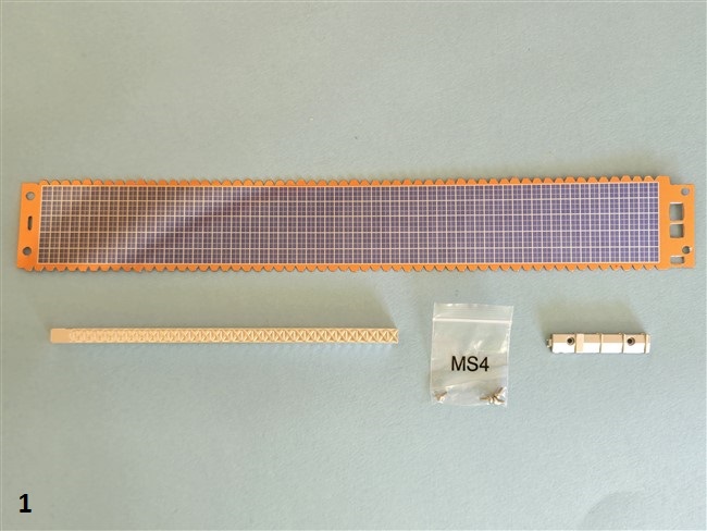

#2 Posted : 04 May 2025 13:28:01
Hi All, BigGrin

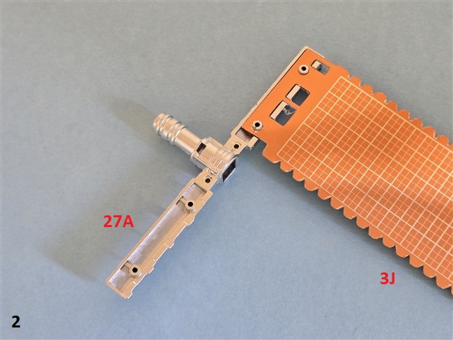

Here`s the update for Issue 76 of the ISS, where we start the next solar panel.
Parts supplied.....Pic 1.

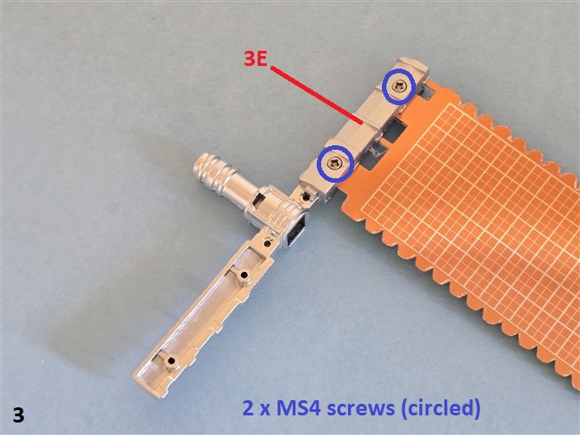

Carefully press the solar panel 3J onto the frame 27A, as shown in Pic 2. Then place the cover 3E on top and fix the parts together using 2 x MS4 screws, Pic 3.

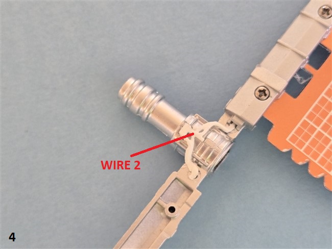

Turn the assembly over and press the WIRE 2 part into the locating holes. Pic 4.

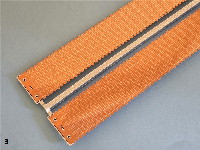

#3 Posted : 06 May 2025 13:51:24
Hi All, BigGrin

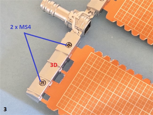

Update time for the ISS with issue 77.
Parts supplied.....Pic 1, you will also need the solar panel assembly from the previous update.

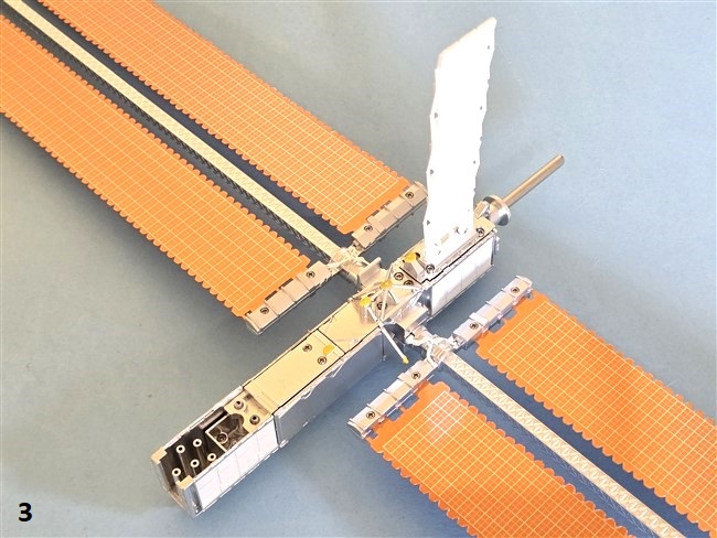

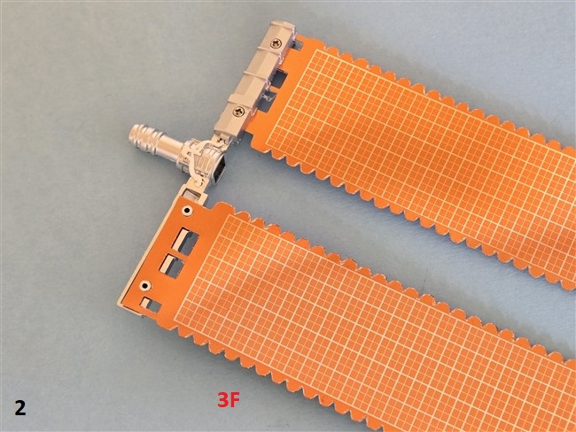

Start with the assembly from issue 76 and add the solar panel 3F, as in Pic 2. Then add the cover 3D and fix it in position with 2 x MS4 screws shown in Pic 3.

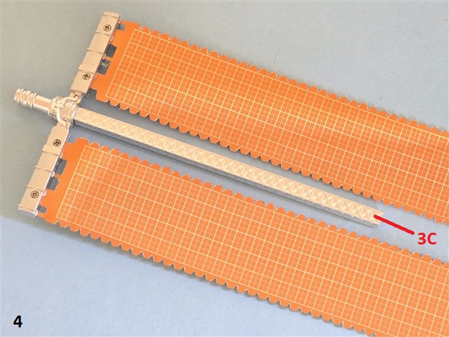

Now add the centre spar 3C (remembering that this part is not fixed until the next issue), Pic 4.
Pic 5 shows the assembly at the end of this stage.

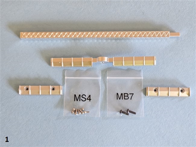

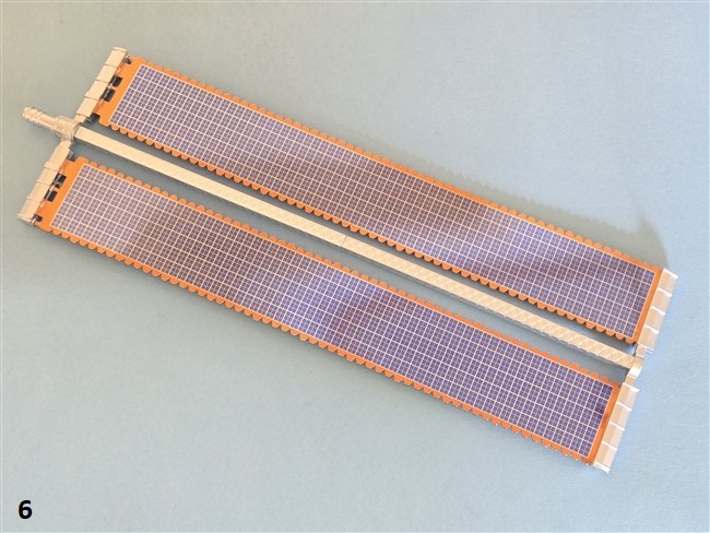

#4 Posted : 08 May 2025 14:46:04
Hi All, BigGrin
This is the update for Issue 78 of the ISS.
Parts supplied.....Pic 1, you will also need the assembly from Issue 77.

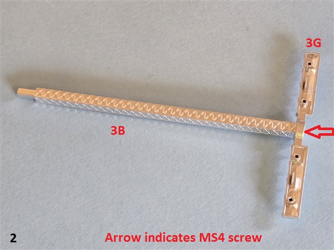

Start by joining the centre spar 3B, to the outer end cross piece 3G with an MS4 screw, Pic 2.
Add these parts to the end assembly from issue 77, carefully engaging the solar panels onto the locating points as shown in Pic 3.
Now fit the end covers 3i and 3H, fixing each with 2 x MS4 screws, Pic 4.

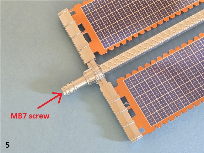

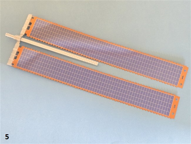

Finally, turn an MB7 screw carefully into the end spindle to tension the solar panels. Indicated in Pic 5.
Pic 6 shows the final assembly for this issue.

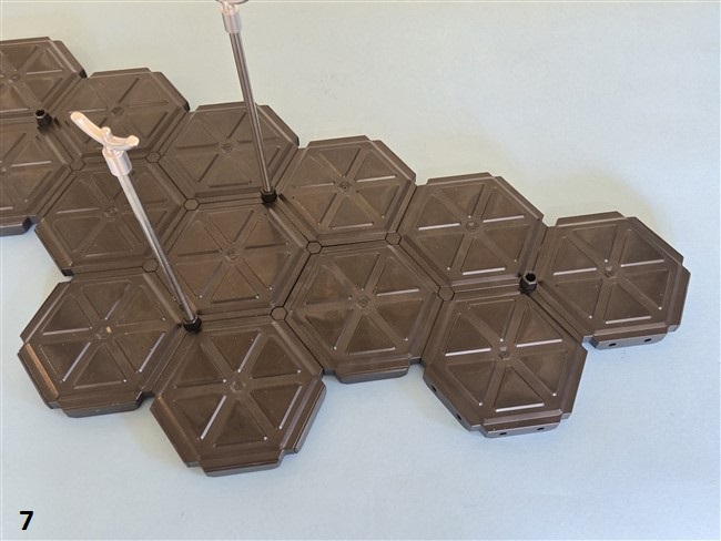

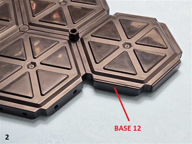

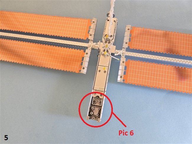

#5 Posted : 11 May 2025 12:16:16
Hi All, BigGrin

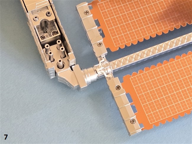

It`s update time for the ISS, with issue 79.

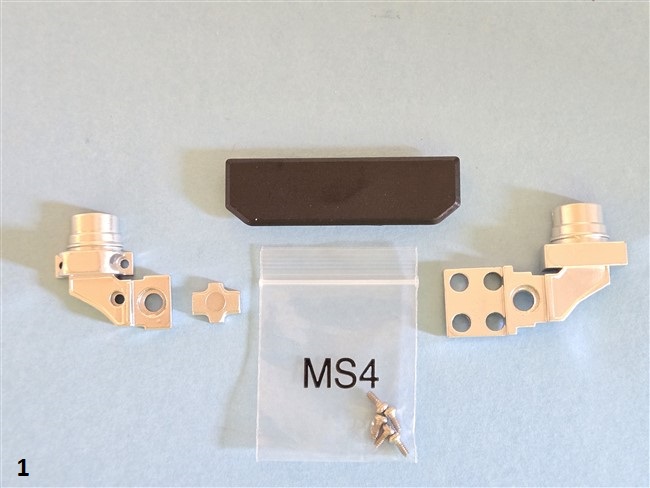

Parts supplied.....Pic 1, you will also need the main model/base, the large solar panel (Issue 75) and the solar panel from the previous update.
No need to move the main model/base about to much, just press fit the side trim BASE 12 as in Pic 2.

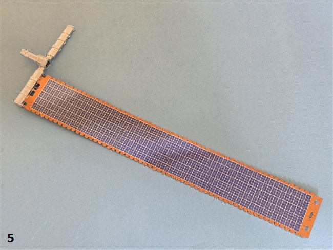

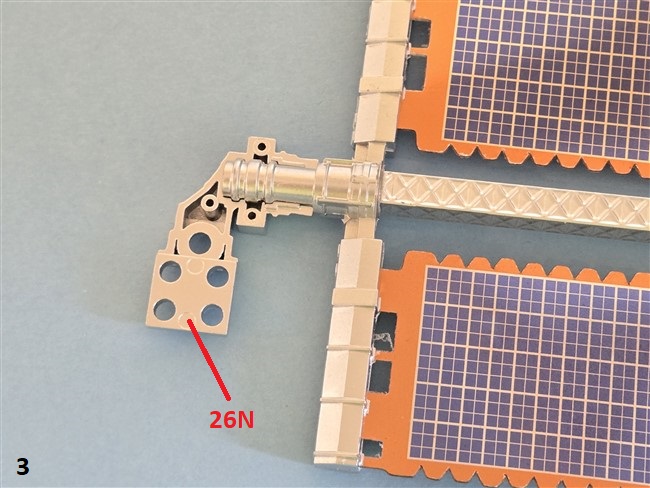

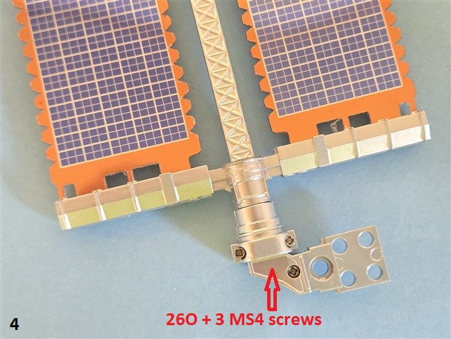

Now we work on the solar panel from the last update, by adding the spindle attachment part 26N as in Pic 3. Then add the upper part 26O, fixing it in place with 3 x MS4 screws, shown in Pic 4.
Next, place the larger solar array (Issue 75) on the table and add the spacer 26Y, area indicated in Pic 5, with a close-up in Pic 6.

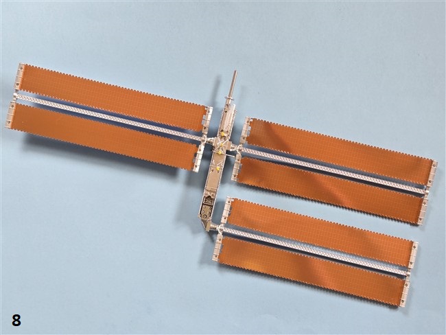

Finally, add the double solar panel from earlier over the spacer as in Pic 7. That`s all for this update, Pic 8. So store the solar array very carefully, remembering that the last panel is not yet secured.

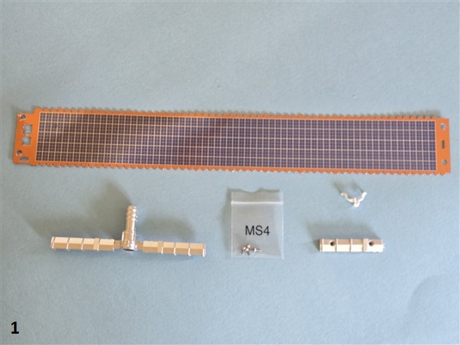

#6 Posted : 13 May 2025 17:33:14
Hi All, BigGrin Woot
Well here we are with the latest update for the ISS, with issue 80 and that puts us at the 2/3rds of the way point. Cool
In this issue we start to build the fourth double panel for this solar array.
Carefully press the solar panel 3J onto the connector piece 27A, as shown in Pic 2. Place the cover piece 3E on top of the panel and fix the parts together wit 2 x MS4 screws, all shown in Pic 3.
To finish, press the cable part WIRE 2 into position as in Pic 4, with Pic 5 showing the end result for this update.
