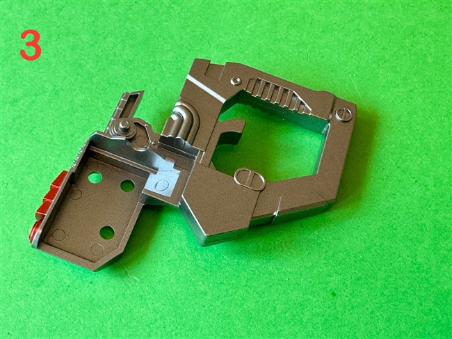

#1 Posted : 16 April 2025 19:25:49
Issue 97
Picture 1 show the parts for this issue.
Assembling the Left Leg
Snap the three pins of the frame (97D) into the holes on the front calf plate (97A) as shown in picture 2 and 3. Note, there should be a gap between the frame and calf plate as the frame pins have shoulders on them to stop them from going in any further, picture 4.
Fit the upper calf detail (97B) by snap fitting it in place, pictures 5 and 6, followed by the lower calf detail (97C) as shown in picture 7.
That completes the assemble for this issue.

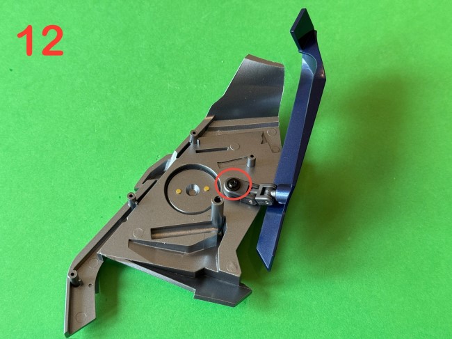

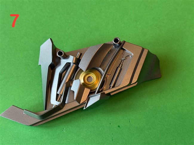

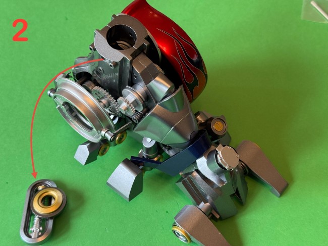

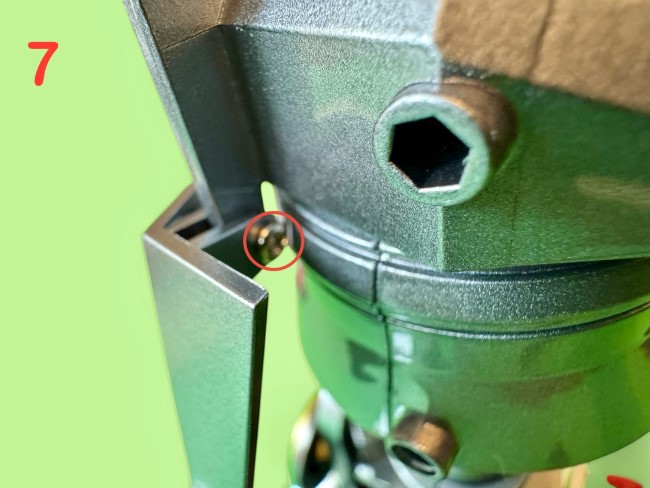

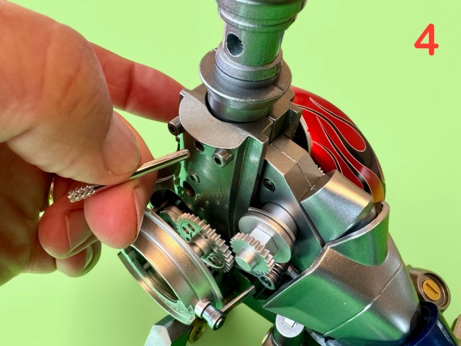

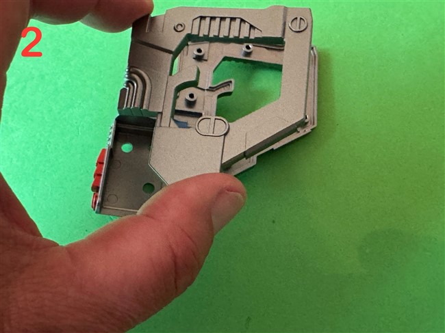

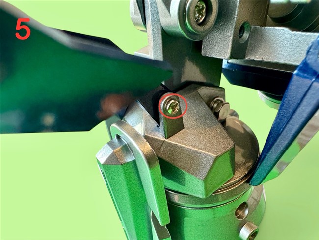

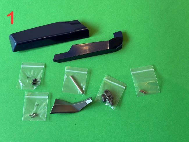

#2 Posted : 17 April 2025 15:59:42

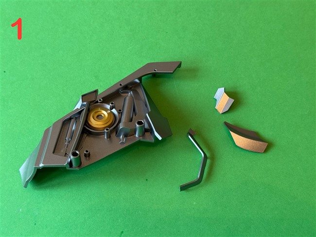

Issue 98
Picture 1 shows the parts for this issue.

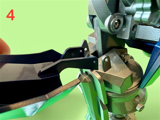

First, carefully remove the assembly from issue 78 as shown in picture 2. In stage 78, I did recommend not to attach this assembly, as it would need to be removed later. If you did assembly this stage, then be very careful when removing it from the foot.
Insert the base of the leg into the ankle socket until the rubber seals are inside the socket, picture 3. Insert the smooth end of the pin (98C) through the hole until it is flush, picture 4.
Finally, replace the assembly from issue 78 back in place, picture 5.
Fit the detail (98A) and secure it with an RP screw, pictures 6 and 7.

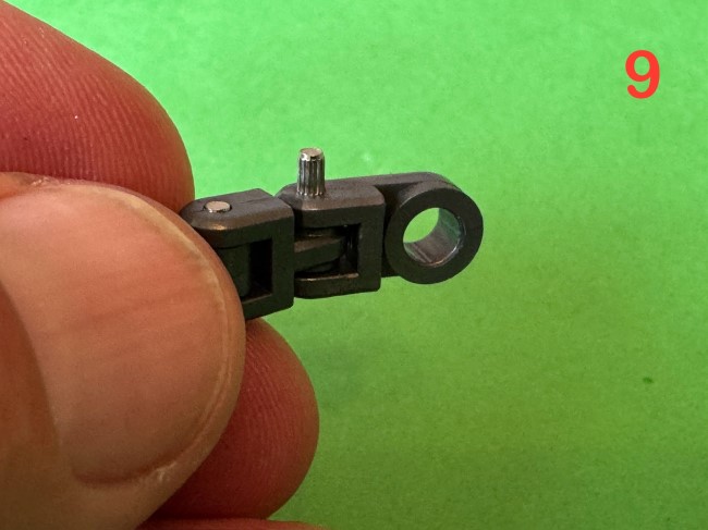

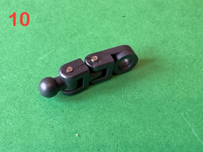

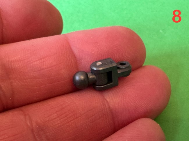

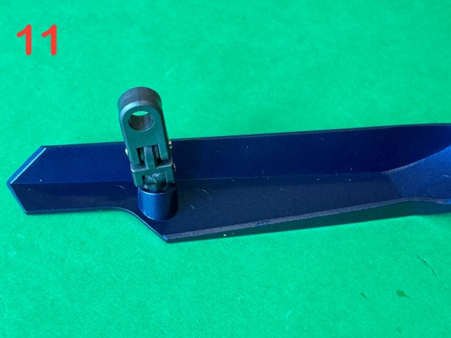

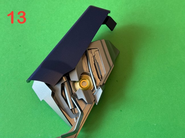

Attach the hinge part (98G) to the hinge part (98E) by aligning the two holes. Secure them with one of the two pins (98H), picture 8. Join the assembly to the hinge (98F) and secure it with the other pin, pictures 9 and 10.
Put the hinge ball joint into the recess on the inside face of the leg plate (98D), picture 11.
Retrieve the leg side assembly from the previous issue and secure the leg plate to it using an MP screw, picture 12. Turn the assembly over and attach the leg side plate (98B) by snapping the two pins into the posts on the side of the leg, picture 13.

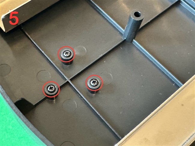

#3 Posted : 18 April 2025 18:02:55
Issue 99

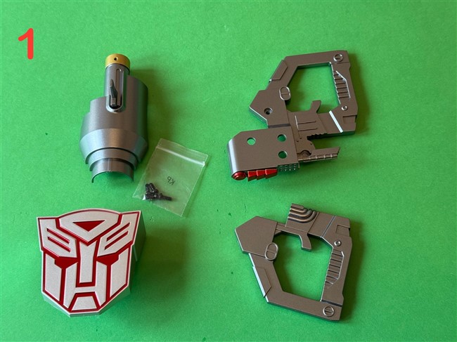

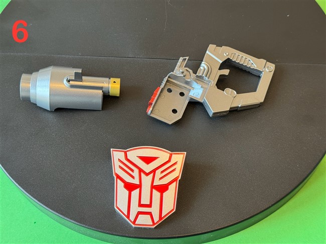

Assembling the Base and Iron Blaster
Snap fit the right grip (99C) into the left Grip (99D), pictures 2 and 3.

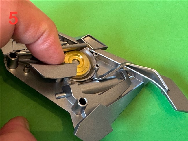

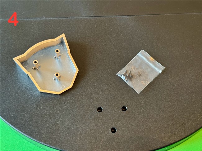

Take the Autobot emblem (99A) and fit the three pins into the three holes on the top of the base, picture 4. Turn the assembly over and secure the emblem with 3 x KP screws, picture 5.
Picture 6 shows the assembly complete for this issue.

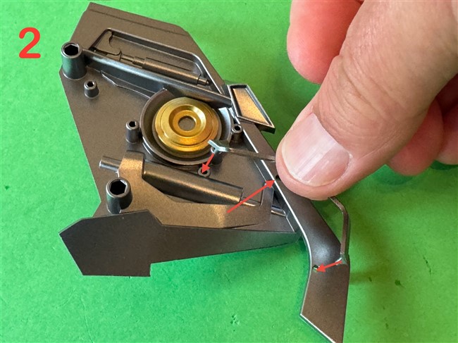

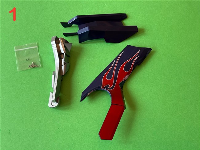

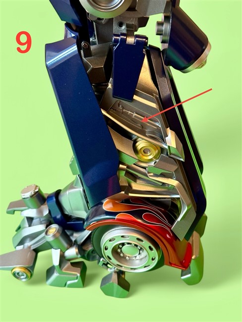

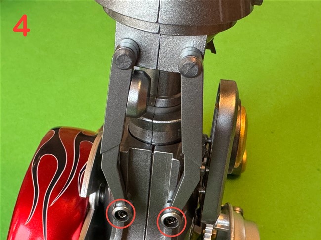

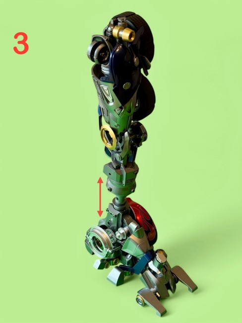

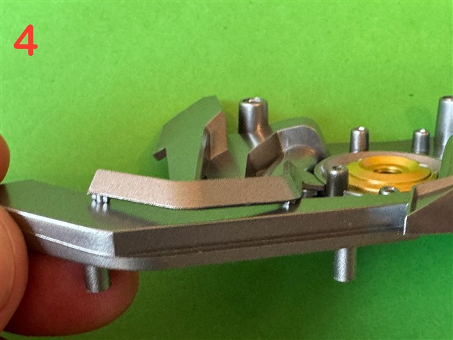

#4 Posted : 20 April 2025 12:40:20
Issue 100
Snap fit the pins of the shin detail (100B) into the indicated holes in the knee frame, pictures 2 and 3.
Fit the knee plate (100C) to the upper posts of the knee frame, picture 4, and fix it into position using 2 x SP crews, pictures 5 and 6.
Picture 7 shows the assembly complete for this issue.

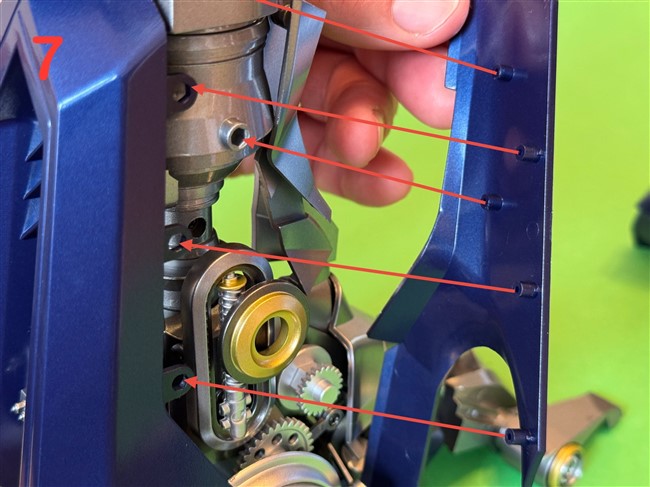

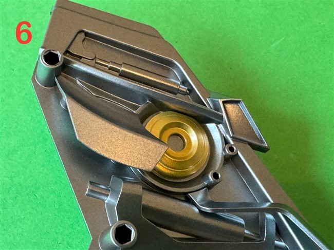

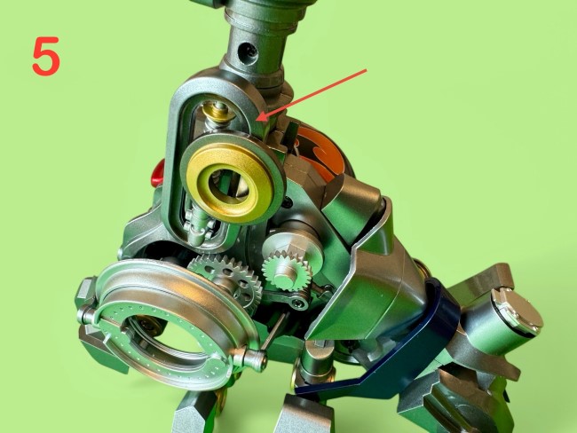

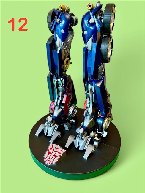

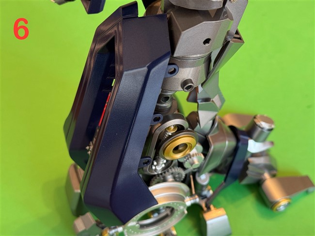

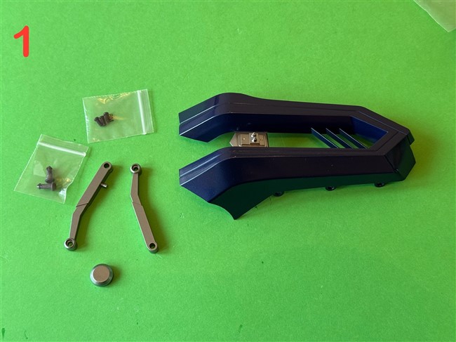

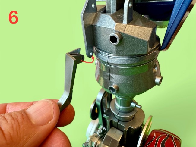

#5 Posted : 21 April 2025 21:50:58
Issue 101

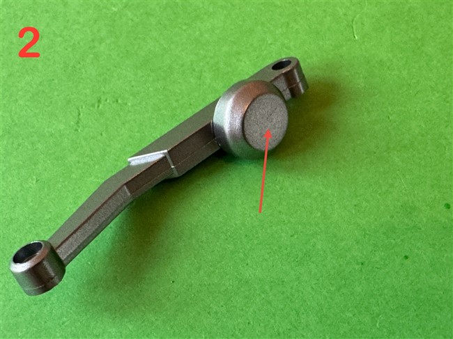

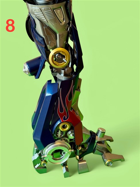

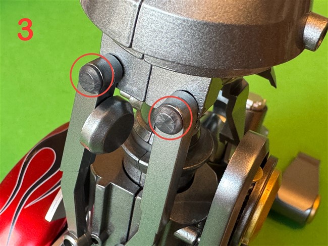

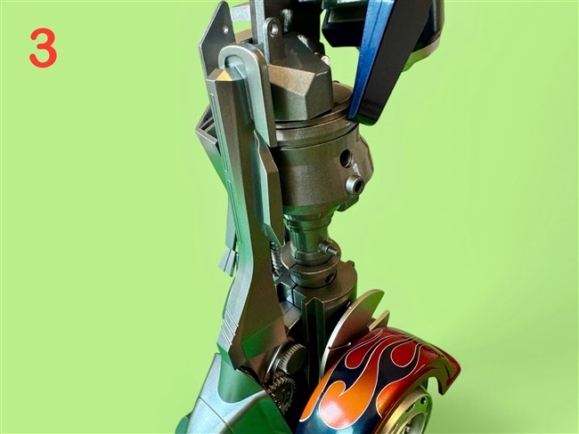

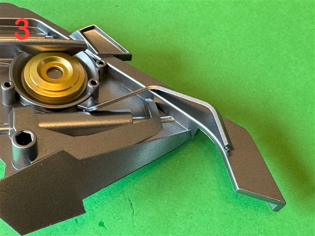

Attach the calf support end (101B) to the semi-circular pin on the left calf support (101C), picture 2. Press the two snap rivets (101E) into the holes of 101C and 101D, then attach them to the calf pushing the two rivets into the holes, picture 3. Next, secure the two parts at the bottom using 2 x BM screws as shown in picture 4.
Attach the upper pin of the calf plate (101A) to the hexagonal rear hole of the leg as illustrated in pictures 5 and 6.
Retrieve the plate 100A from the previous issue and snap fit the pins as shown in picture 7. Picture 8 shows how it looks when fitted.

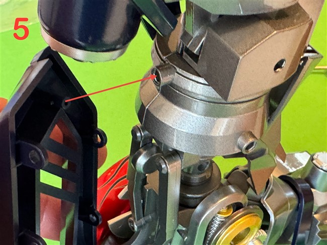

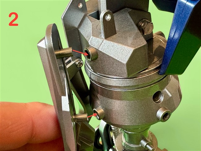

Turn the assembly around and fit the side assembly from issue 98 onto the leg in the same way, pushing the pins in place, picture 9.
Pictures 10 and 11 show the leg assembly complete from both sides.
The final picture shows both legs placed upon the base.
