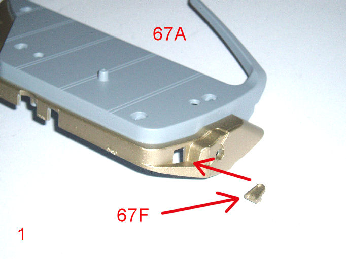

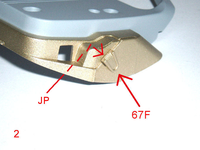

STAGE 67A:
Inner door panel.
Pic 1: Fit the lock, part 67F into the door panel 57A.
Pic 2: The lock in place, secured from behind with 1 x JP screw.

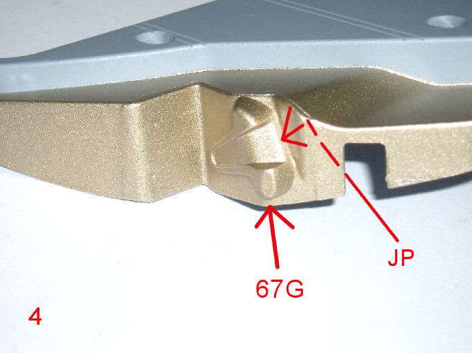

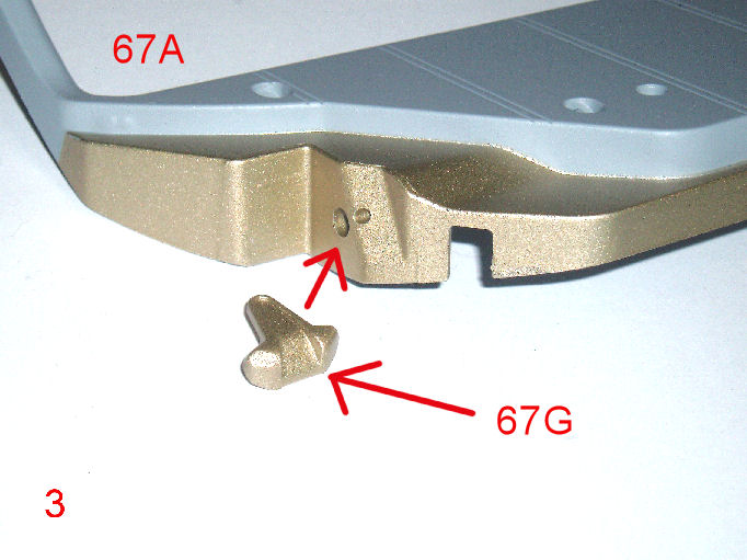

Pic 3: Fit the rear lock, part 67G to the door panel, 67A.
Pic 4: Lock in place fixed from behind with 1 x JP screw.

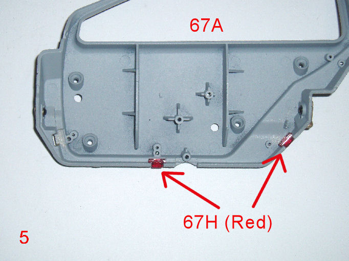

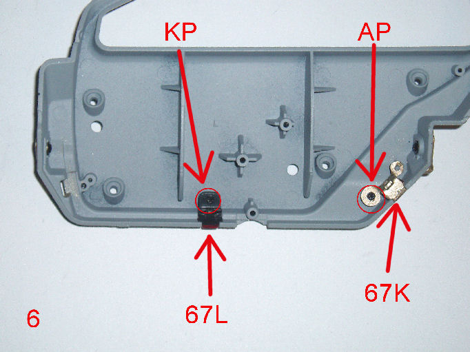

Pic 5: Fit the two red light units, parts 2 x 67H to the inside of the door panel, 67A.
Pic 6: Fit the retaining brackets 67K and 67L over the lights and fix with 1 x KP and 1 x AP screws as shown.

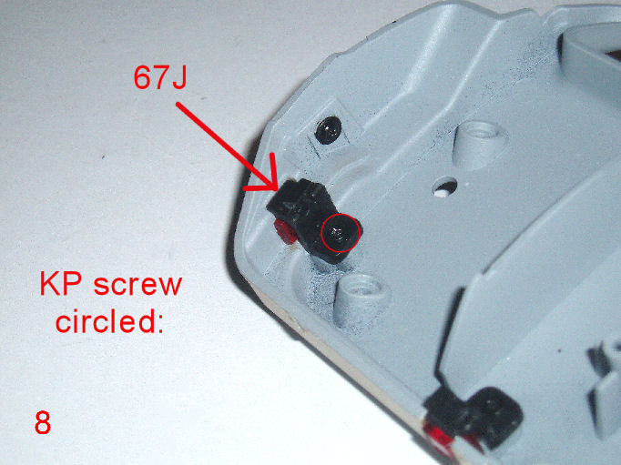

STAGE 67B:

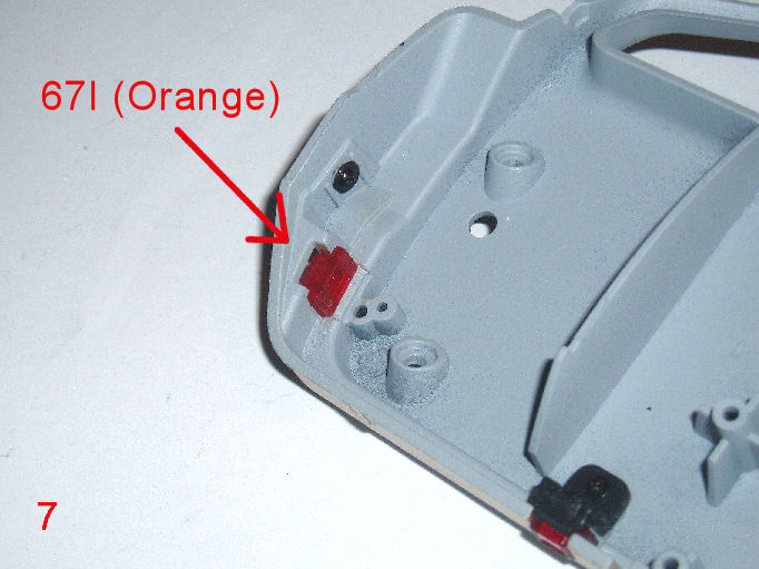

Pic 7: Fit the orange light cover, 67I to the inner end of the door panel.
Pic 8: Secure with the bracket 67J and fix using 1 x KP screw.

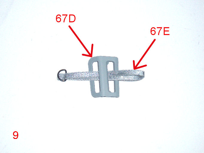

Pic 9: Fit the door pull strap 67E through the holding bracket 67D as shown

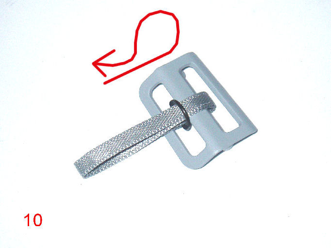

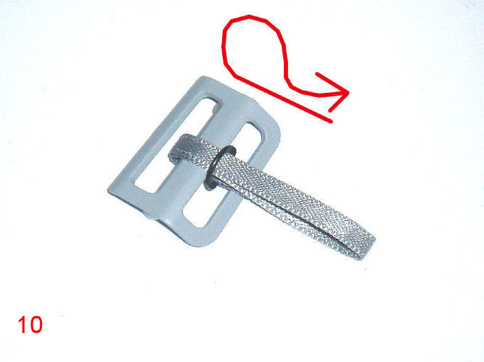

Pic 10: Fold the strap over the centre bar of the bracket and pass the end through the metal loop.

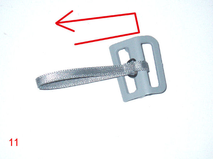

Pic 11: Pull the strap tight, and away from the curved end of the bracket.

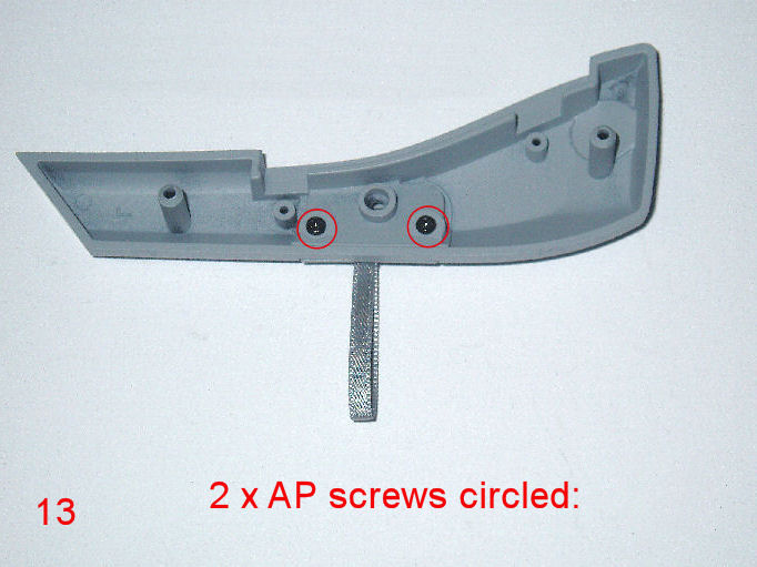

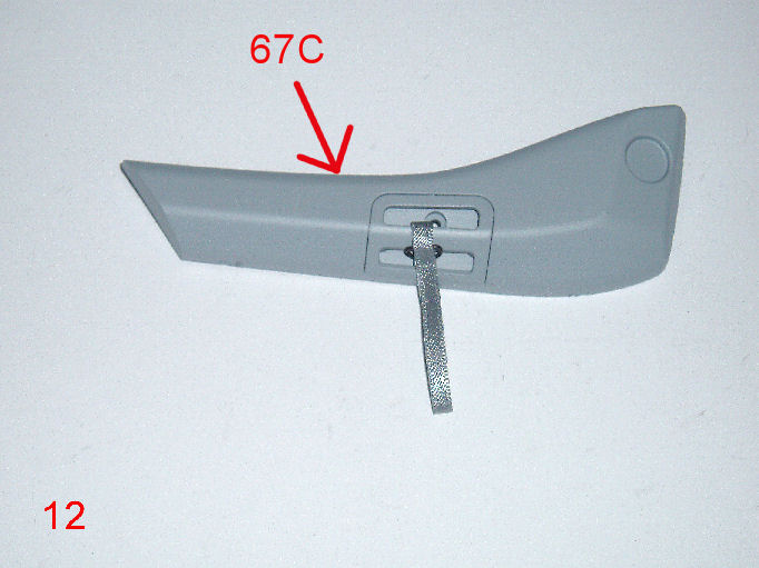

Pic 12: Fit the assembled bracket to the arm rest, part 67C.
Pic 13: Secure from behind with 2 x AP screws.

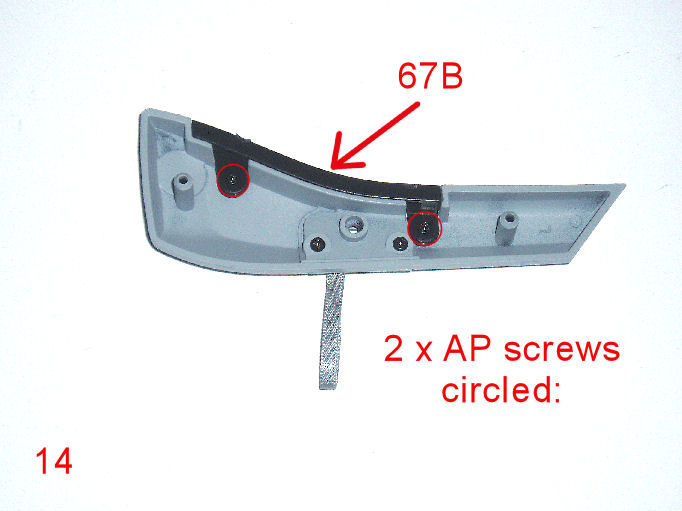

Pic 14: Fit the window control strip, part 67B to the top of the arm rest and fix using 2 x AP screws from behind.

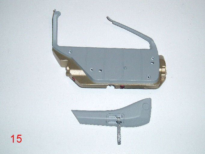

Pic 15: Stage completed.

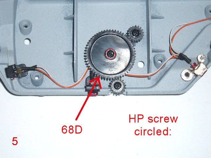

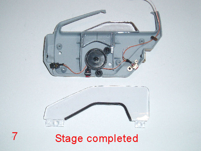

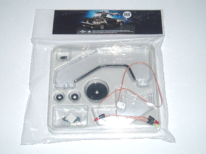

STAGE 68:
Inner door panel.

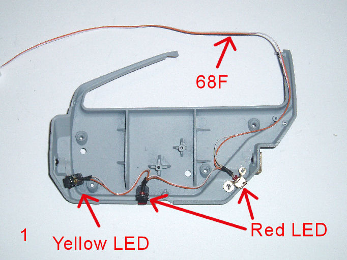

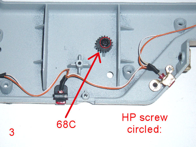

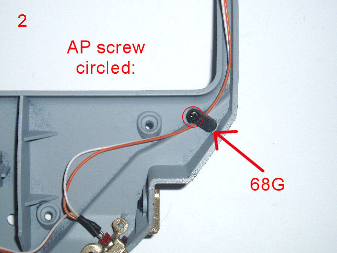

Pic 1: Fit the LED light wire into the door panel 67A as shown with the correct colour LED’s fitting in the respective sockets.
Pic 2: Fit the wire so it runs inside the window frame channel. Fit the retaining clip 68G and fix with 1 x AP screw.

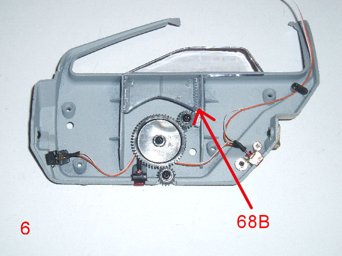

Pic 3: Locate the thinner cog wheel, 68C and fit it to the upper post inside the door panel. Secure with 1 x HP screw.

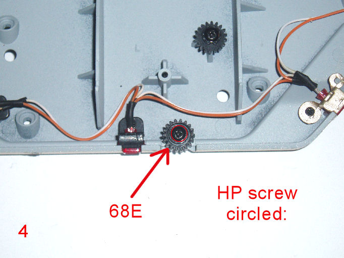

Pic 4: Locate the thicker cog wheel 68E and fit it to the lower post on the door panel, with the recessed face upwards. Secure with 1 x HP screw.
Pic 5: Fit the large cog wheel 68D to the central post, between the other two cogs. Secure with 1 x HP screw.
Pic 6: Fit the smaller window, 68B in place, locating the cogged edge in place on the door panel.
Pic 7: Stage completed.
Store the parts safely for now.

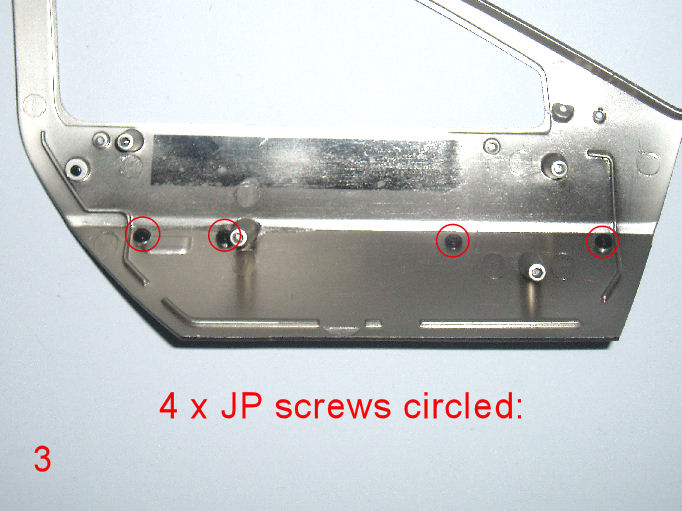

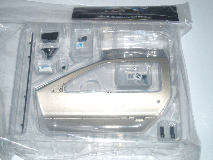

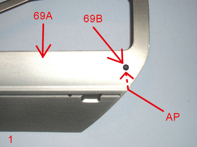

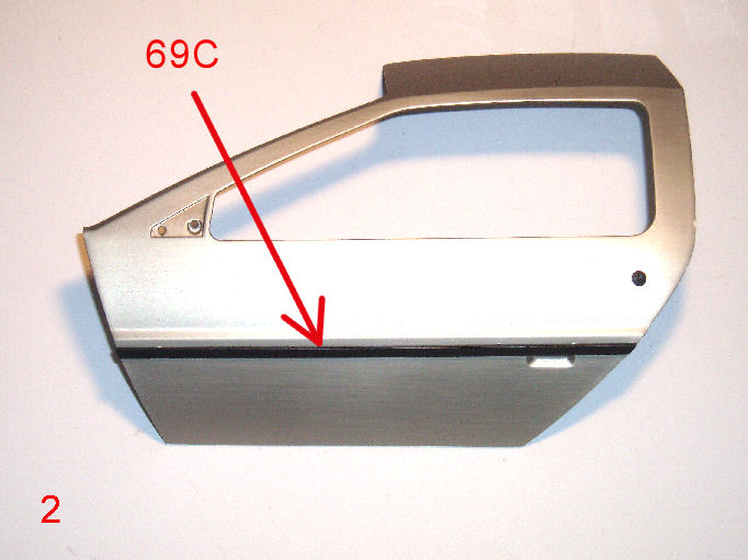

STAGE 69A:
Door assembly.
Pic 1: Fit the lock, 69B into the door shell 69A and fix from behind with 1 x AP screw.
Pic 2: Fit the trim strip 69C to the door as shown.
It will only fit one way.
Pic 3: Secure from behind with 4 x JP screws.

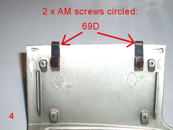

Pic 4: Fit the two roof brackets, 2 x 69D to the upper door panel as shown and fix with 2 x AM screws.

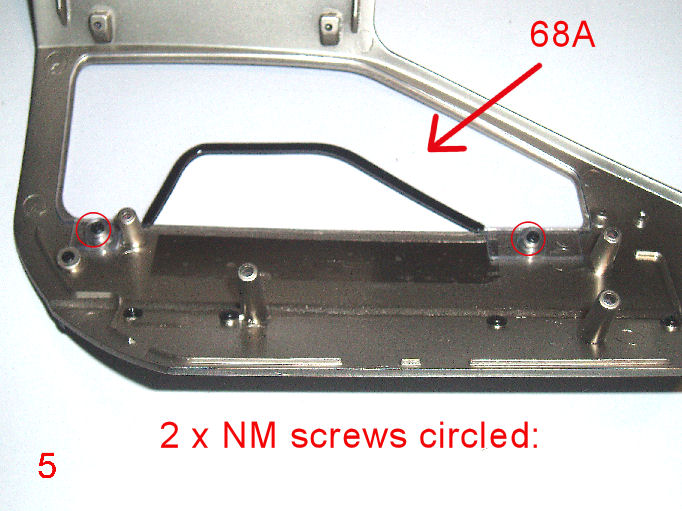

Pic 5: Fit the side window 68A in place inside the door and fix with 2 x NM screws.

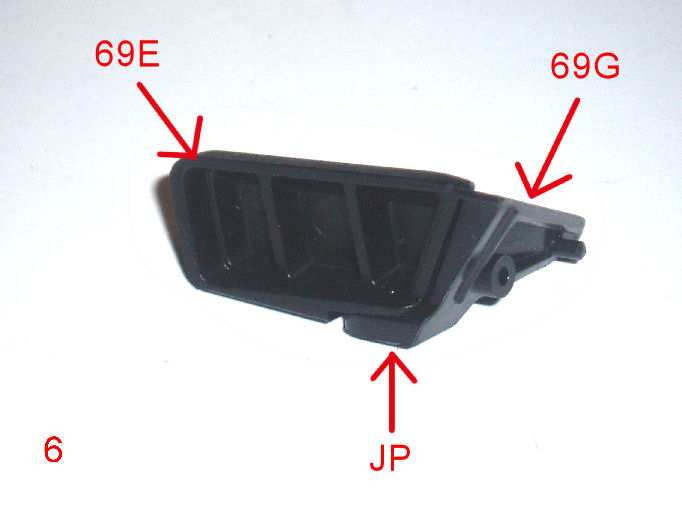

Pic 6: Assemble the mirror parts 69E and 69G as shown. Secure them with 1 x JP screw from underneath.

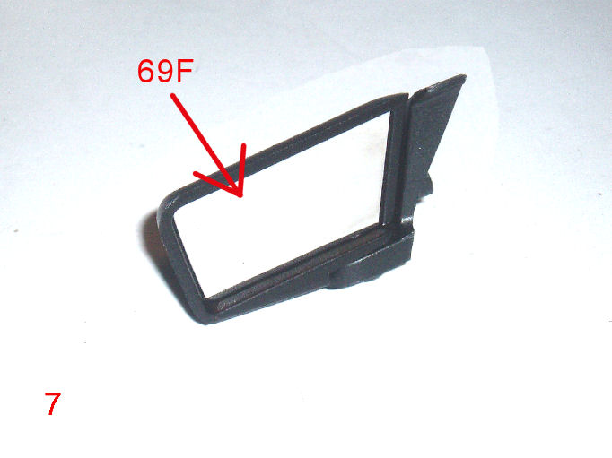

Pic 7: Peel the backing paper from the mirror, 69F and fit it to the assembly.

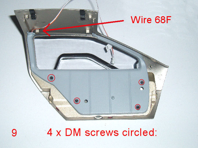

Pic 9: Fit the interior door panel assembly in place and fix using 4 x DM screws.
Make sure wire 68F exits correctly as shown.

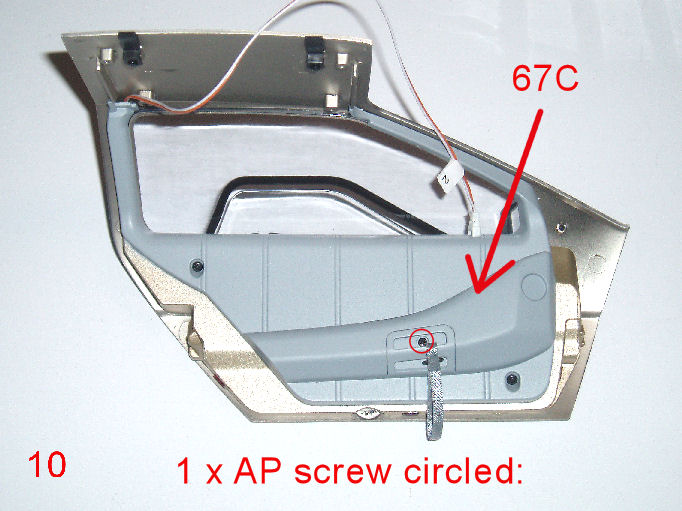

Pic 10: Fit the arm rest part 67C as shown and fix using 1 x AP screw.

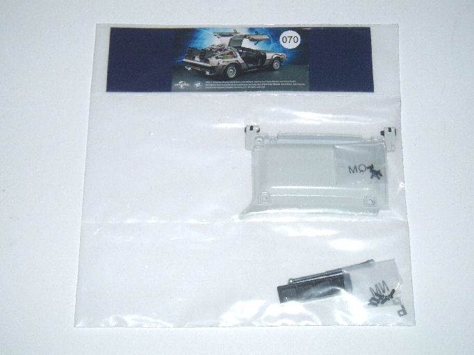

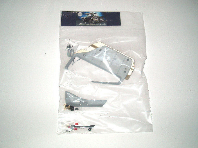

STAGE 70:
Door fitting.
NOTE: There may be an unexplained black rectangular part in the pack.
This does not appear in the build instructions and seems to serve no purpose.
However, it might be wise to store this part 'just in case'.
Pic 1: Retrieve the door assembly and fit the upper lining panel 70A, fixing it with 4 x NM screws. Make sure the wire 68F exits through the small slot at the top left of the panel.

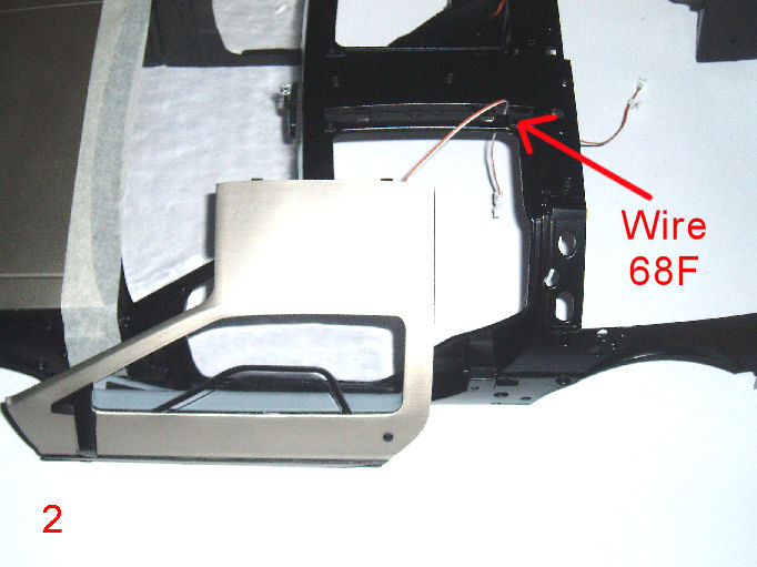

Pic 2: With the door leaning against the body, feed the wire 68F through the rectangular hole in the upper right of the main body roof panel.

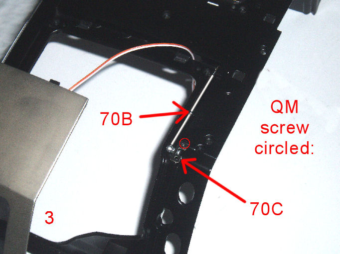

Pic 3: Fit the roof support strut 70B in the locating groove on the upper body and then fit the retaining clip 70C in place as shown.
Secure with 1 x QM screw.

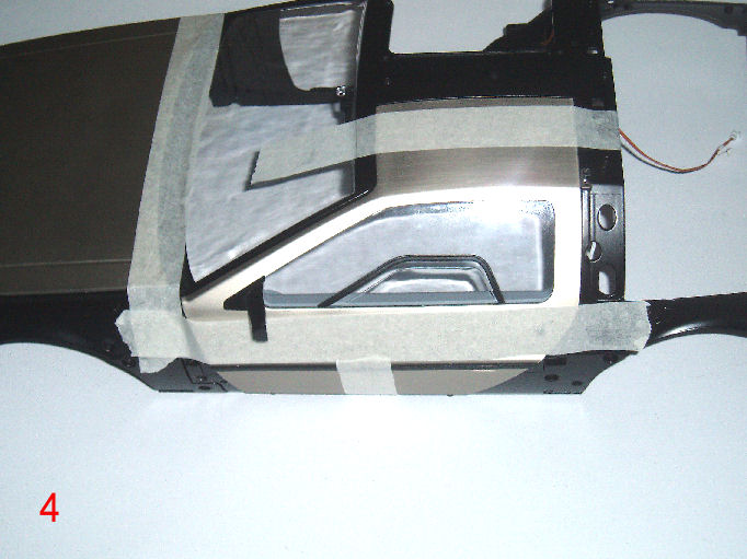

Pic 4: Fit the door in place on the body as shown with the small hinges on the upper edge of the door locating in the holes on the upper main body.
You might find the next step easier if you temporarily hold the door in place using strips of low tack masking tape. Make sure the tape is low tack.
This is entirely at the builder’s discretion.

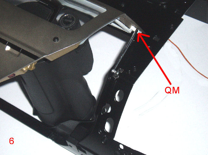

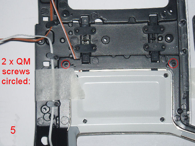

Pic 5: Turn the car over and fix the door in place using 2 x QM screws as shown.
Pic 6: Turn the car over again and remove the masking tape, if used.
Open the door and prop it up, to fix the end of the support strut to the edge of the door roof using 1 x QM screw as shown.

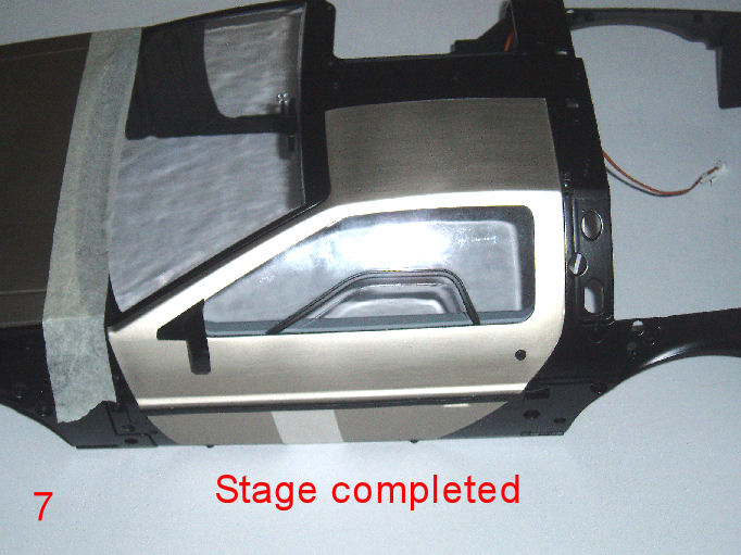

Pic 7: This shows the stage completed.
You may wish to secure the lower edge of the door for now with a piece of low tack masking tape.

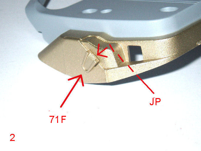

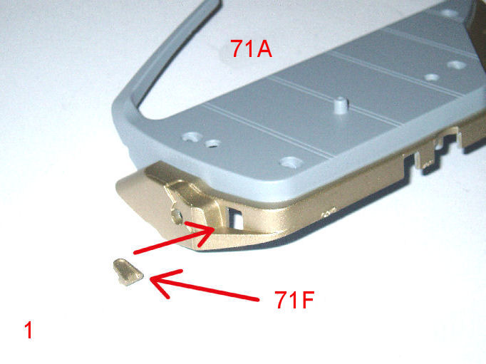

STAGE 71A:
Inner door panel.
Pic 1: Fit the lock, part 71F into the door panel 71A.

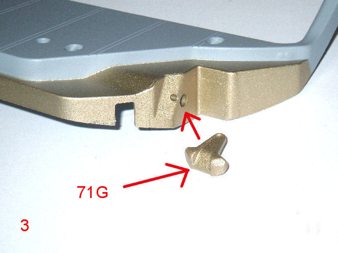

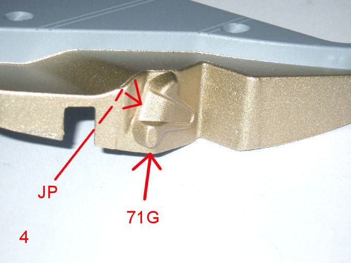

Pic 3: Fit the rear lock, part 71G to the door panel, 71A.

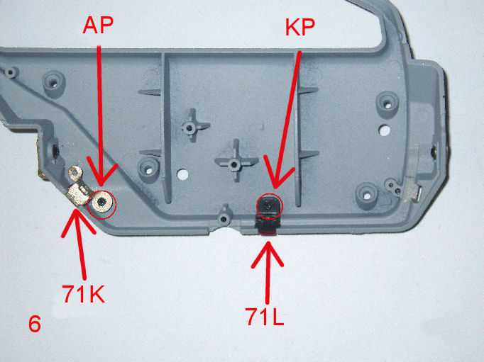

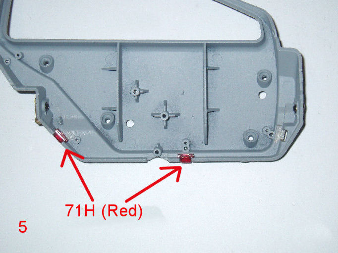

Pic 5: Fit the two red light units, parts 2 x 71H to the inside of the door panel, 71A.
Pic 6: Fit the retaining brackets 71K and 71L over the lights and fix with 1 x KP and 1 x AP screws as shown. (The 71J bracket looks similar to 71L but the locating posts are different so you cannot fit the wrong one)

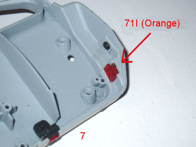

STAGE 71B:

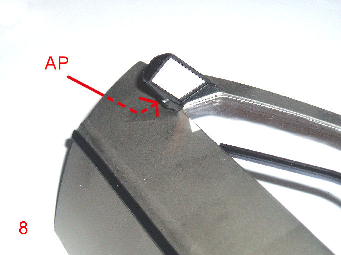

Pic 7: Fit the orange light cover, 71I to the inner end of the door panel.

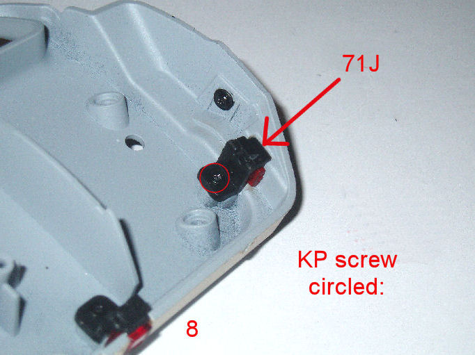

Pic 8: Secure with the bracket 71J and fix using 1 x KP screw.

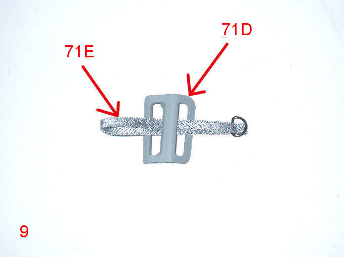

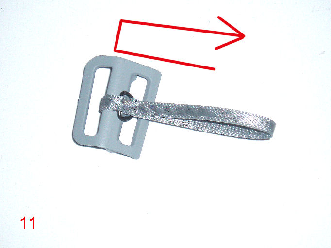

Pic 9: Fit the door pull strap 71E through the holding bracket 71D as shown.

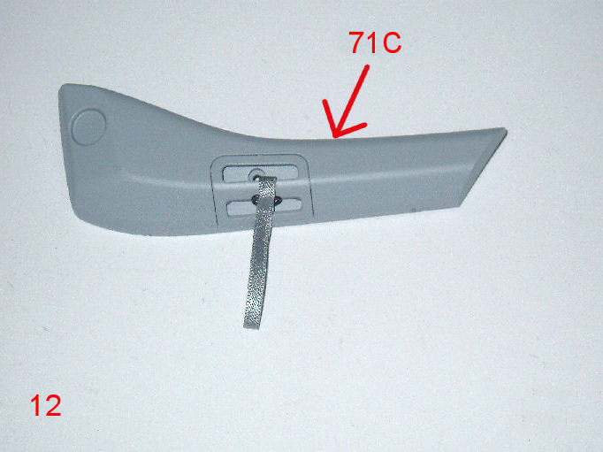

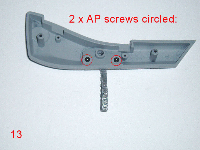

Pic 12: Fit the assembled bracket to the arm rest, part 71C.
