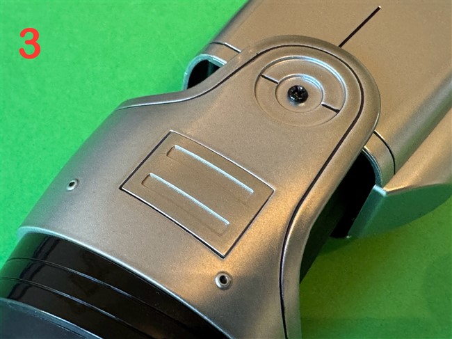

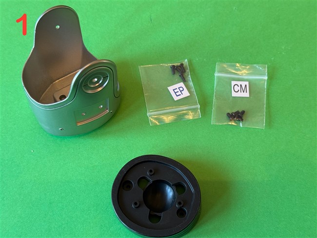

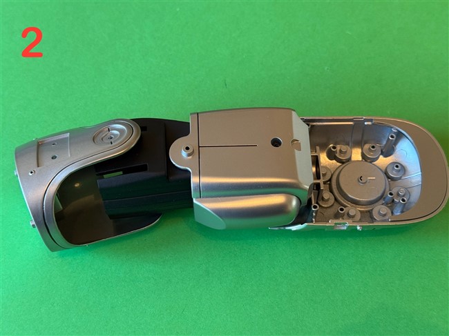

Picture 1 shows the parts for this issue.

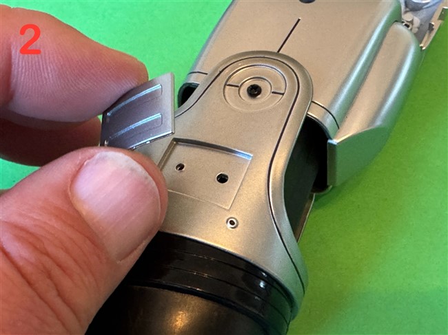

The Left Arm

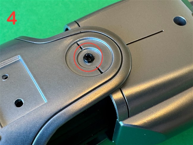

Insert the lower end of the assembly from issue 70 into the upper left forearm (71A). Note the orientation, picture 2. Secure the upper left forearm with 2 x EP screws, picture 3.
Reinforce the joint with an EP screw, picture 4. Turn the assembly over and do the same on the other side, only this time use a CM screw, picture 5.
Finally, connect the middle part of the forearm (71B) and secure in place using 2 x CM screws, noting its orientation, picture 6.

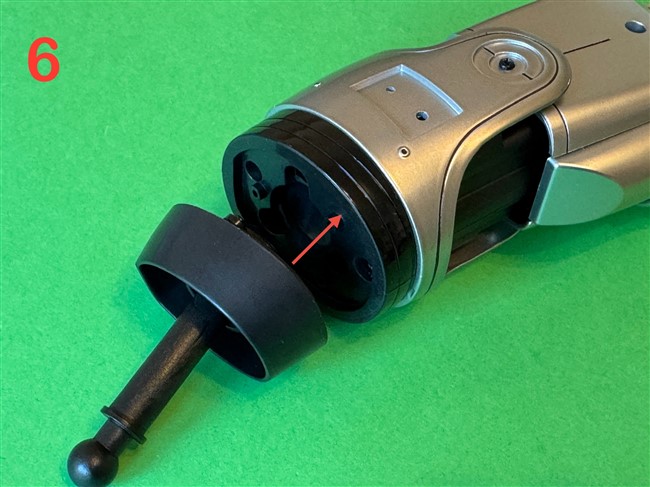

#2 Posted : 11 April 2025 13:55:30

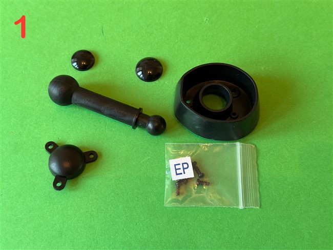

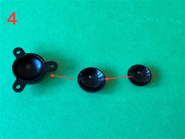

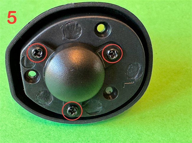

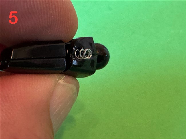

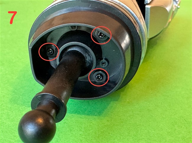

Issue 72
The Left Arm

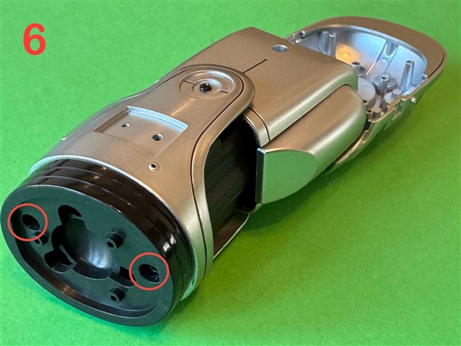

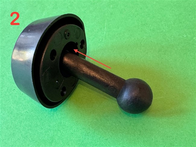

Insert the end of the wrist joint (72B) into the upper wrist joint support (72A), pictures 2 and 3.
Place the friction blocks (72D & 72E) inside the wrist joint support (72C) as shown in picture 4.
Attach the assembly and connect it to the wrist support using 3 x EP screws, picture 5.
Now place the completed assembly onto the assembly from issue 71, pictures 6 and 7. Secure the assembly by using 3 x EP screws, picture 8.

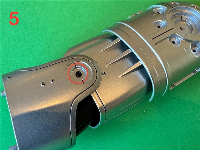

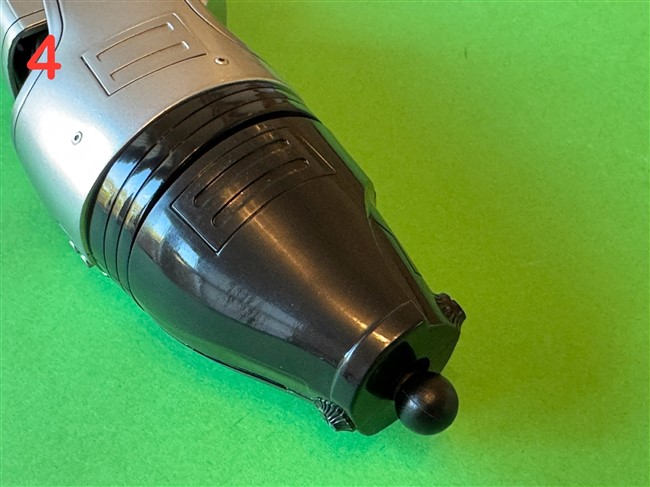

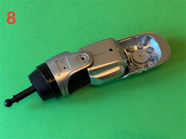

#3 Posted : 13 April 2025 18:09:03

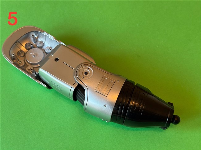

Issue 73
The Left Arm

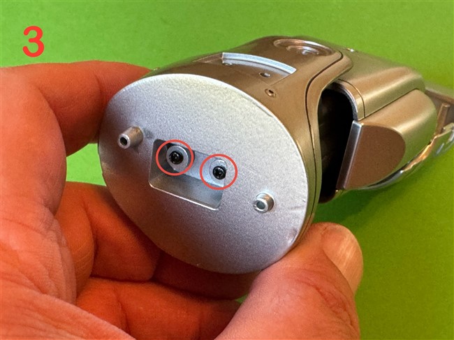

Fit the side cover (73B) into the recess as shown in pictures 2 and 3.
Next, insert the lower part of the forearm (73A) into the wrist joint. You will need a little pressure to push this in place, picture 4.
Picture 5 shows the completed assembly for this issue.

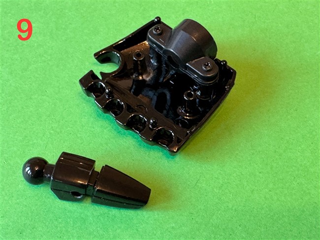

#4 Posted : 14 April 2025 19:41:36
Issue 74
The Left Hand

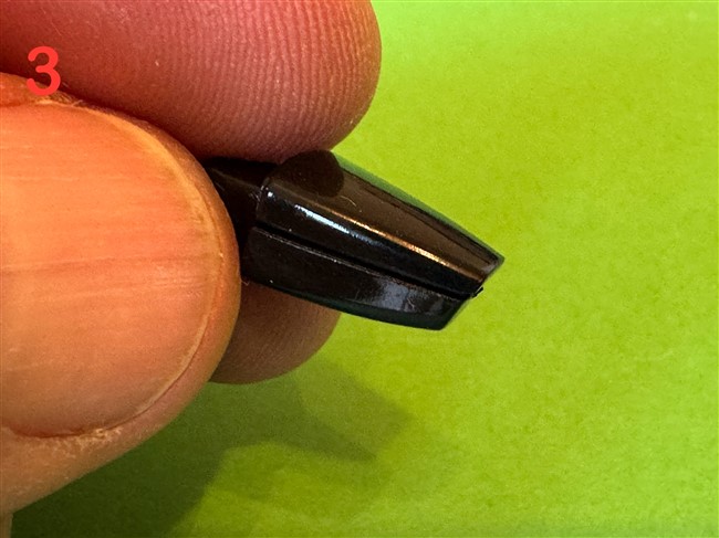

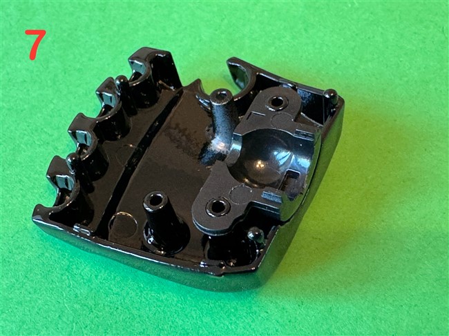

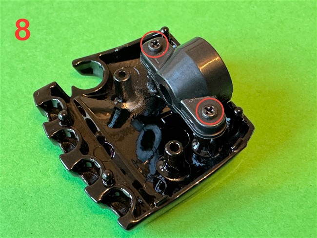

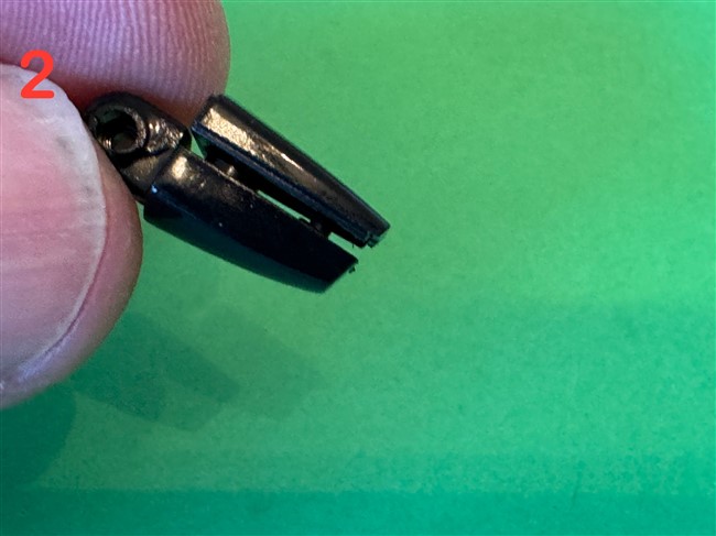

To assemble the thumb, press the two pieces of the thumb together, (74E & 74F), pictures 2 and 3. Place the assembly into the top part of the thumb (74D), picture 4. Insert the spring (74G) into the hole as shown in picture 5, then thread the RP screw and tighten. You should still be able to bend the finger, picture 6.

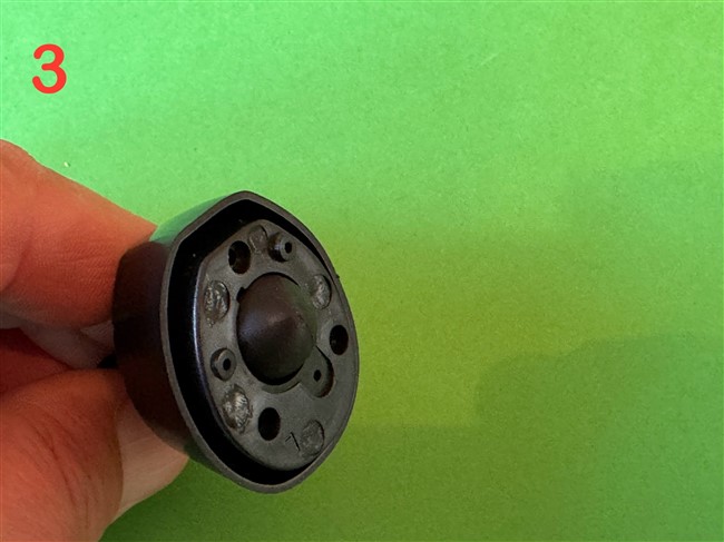

Take the palm of the hand (74A) and place the wrist joint support 2 (74C) onto the palm as shown in picture 7. Place the wrist joint support 1 (74B) over the wrist support 2 and secure them in place by using 2 x BM screws, picture 8.
Picture 9 shows the completed assembly for this issue.
