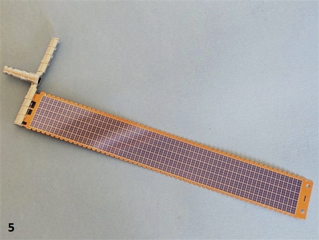

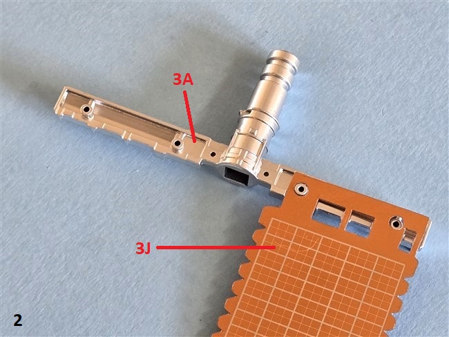

Hi All, BigGrin
Here we are with the next pack of the ISS with pack 14, covering issues 69-74.
In issue 69 we start the construction of the next double solar panel.
Parts supplied.....Pic 1.

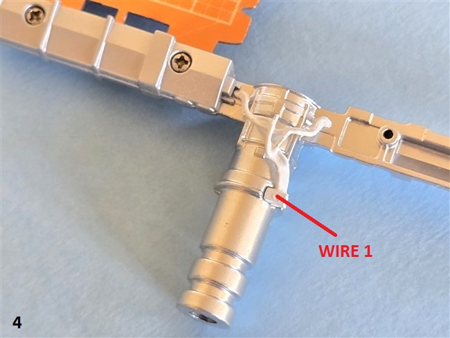

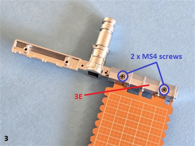

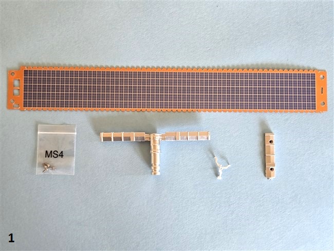

As before, carefully press the solar panel 3J onto the end bar 3A as in Pic 2. Then place the other side of the bar 3E over the panel and fix it in place with 2 x MS4 screws, Pic 3. Finally fit the WIRE 1 part as shown in Pic 4. That completed this stage, as shown in Pic 5.

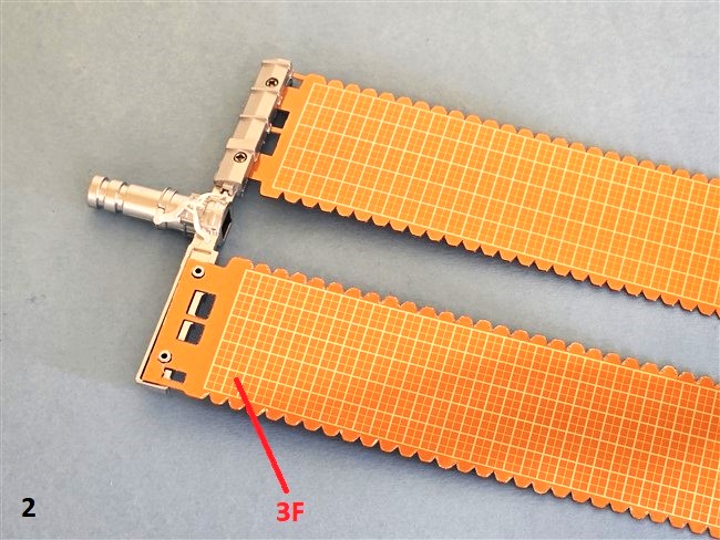

#2 Posted : 02 April 2025 12:20:03
Hi All, BigGrin
Update time for the ISS with issue 70.
Parts supplied.....Pic 1, you will also need the assembly from the previous issue as well.

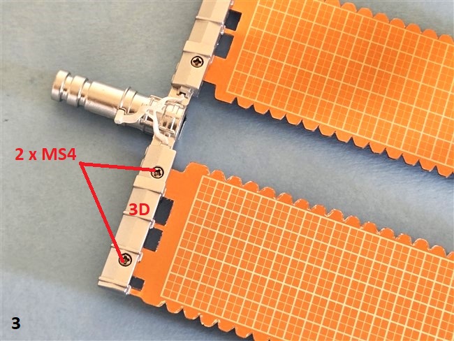

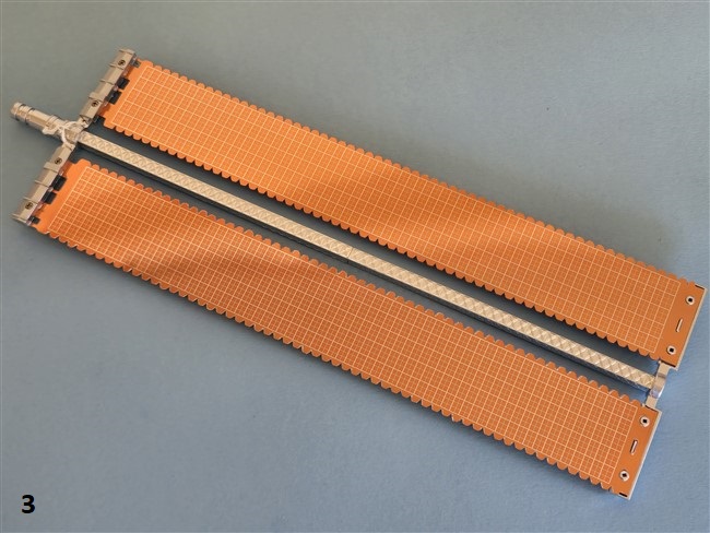

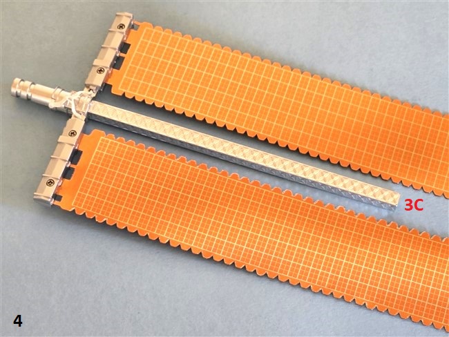

Start by adding the solar panel 3F to the previous assembly, as in Pic 2. Then position the cover 3D over the panel and fix the parts together using 2 x MS4 screws, Pic 3. The central spar 3C is added as shown in Pic 4, but you can keep the part safe for now as its not fixed into position until the next update.
Pic 5 shows the final assembly for this issue.

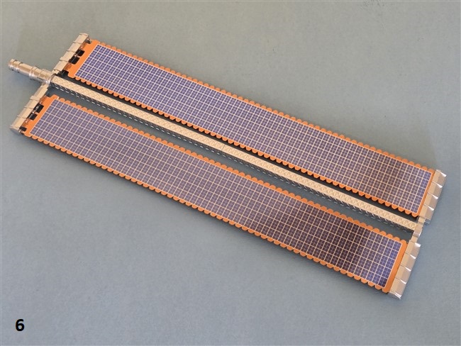

#3 Posted : 04 April 2025 14:02:54
Hi All, BigGrin

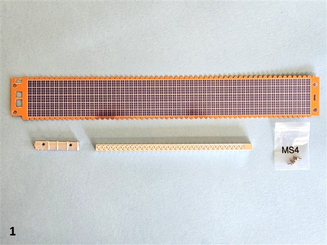

Here we are with the next ISS update with issue 71.

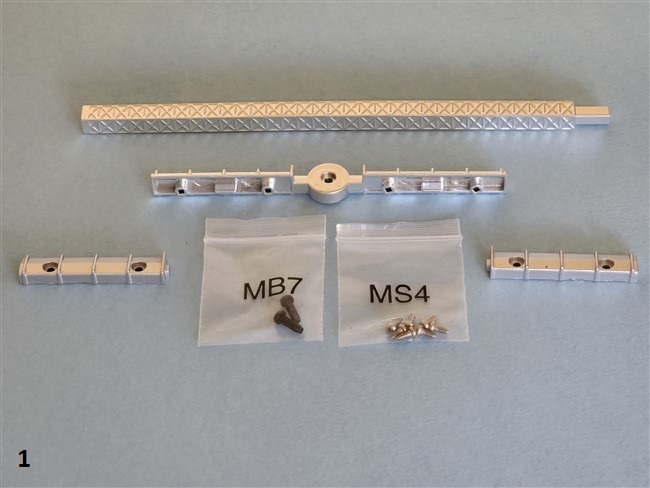

Parts supplied.....Pic 1, you will also need the solar panel assembly from the previous update (don`t forget the central spar).

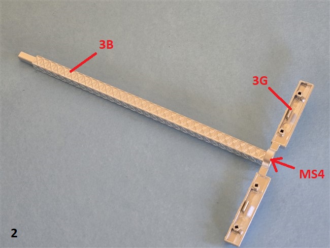

Start with the new centre spar 3B and the end bar 3G, fixing them together with an MS4 screw as in Pic 2.
Bring the final assembly from issue 70 to the table and add the assembly just made, taking care when fitting the solar panels, Pic 3.

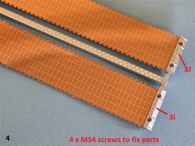

Position each end bar cover 3H and 3i, fixing each in place with 2 x MS4 screws. Shown in Pic 4.

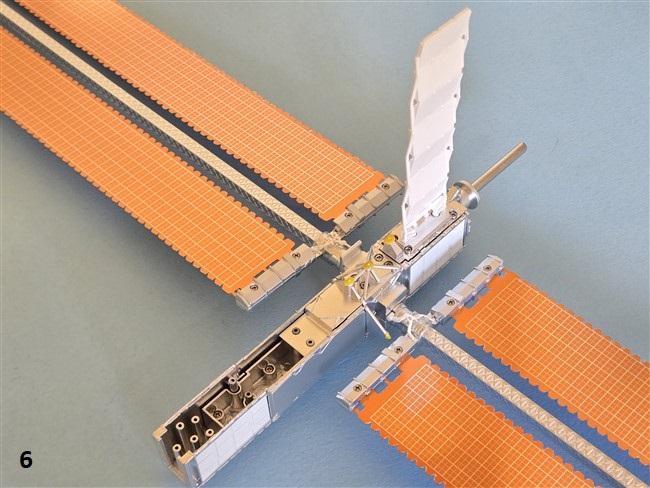

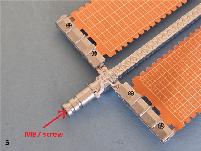

Finally, screw the MB7 screw into the spindle of the solar panel and carefully tension the solar panels, indicated in Pic 5. The final full assembly is shown in Pic 6.

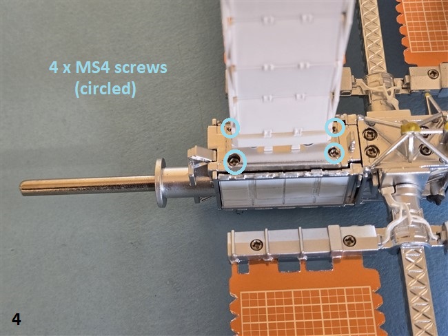

#4 Posted : 06 April 2025 16:33:19
Hi All, BigGrin
Here we go with the update for Issue 72.

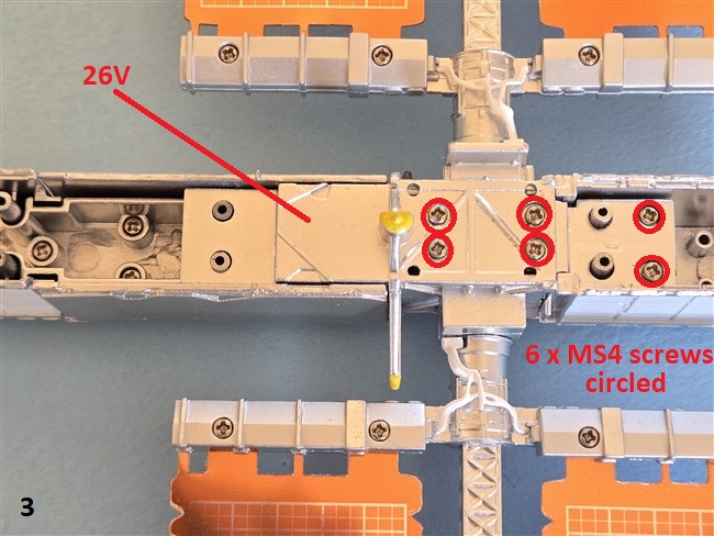

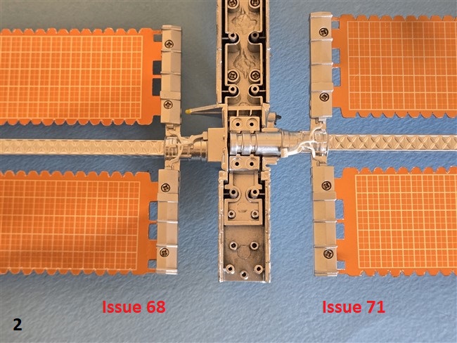

Parts supplied.....Pic 1, you will also need the assemblies from issues 68 and 71 and the base assembly from issue 67.
Place the assemblies from issues 68 and 71 together as shown in Pic 2. Now position the plate 26V over the area where the parts join up and fix it into place using 6 x MS4 screws, Pic 3. Finally for this section of the update, press the four pins of part 26G into the previous part, Pic 4.

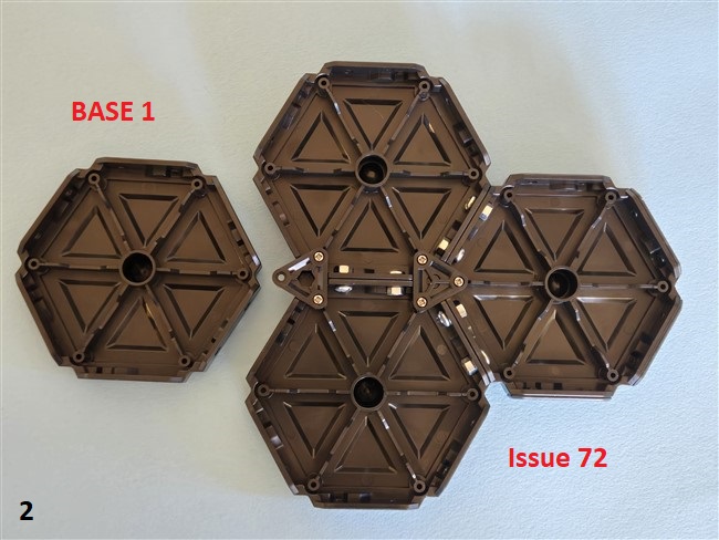

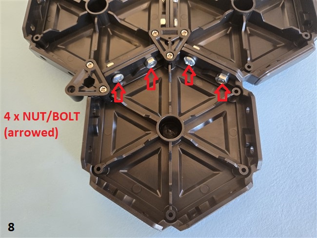

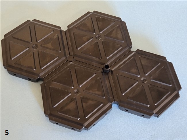

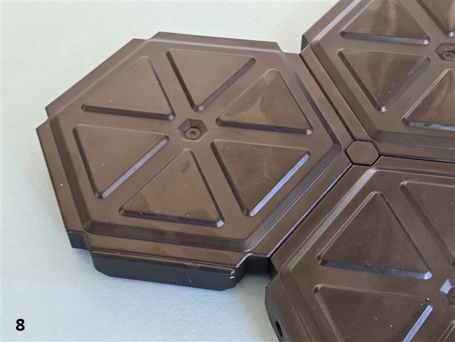

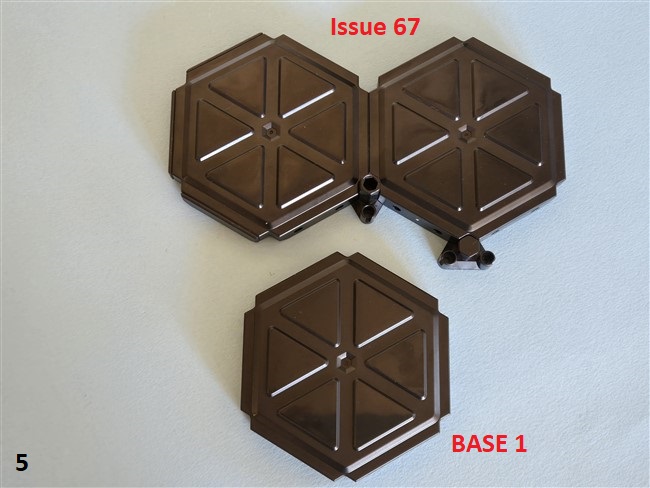

Now bring the base section from issue 67 and see how the new part BASE 1 will fit, as in Pic 5. Engage the base sections together Pic 6 and fix then using 2 x AS8 screws, Pic 7. Finally fix the base parts with 4 x NUT/BOLT as indicated in Pic 8. Your base should now be the same as shown in Pic 9.

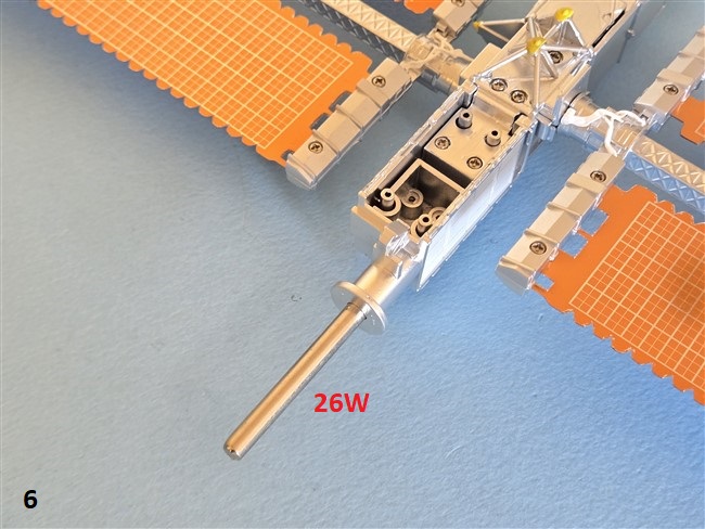

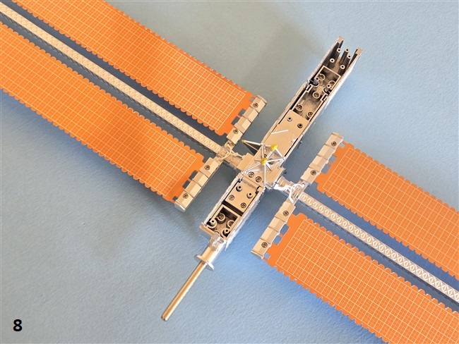

#5 Posted : 08 April 2025 15:09:46
Hi All, BigGrin

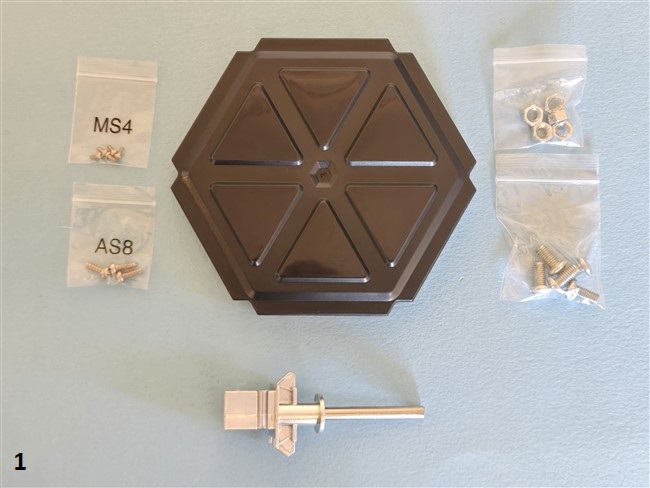

ISS update time again with Issue 73.

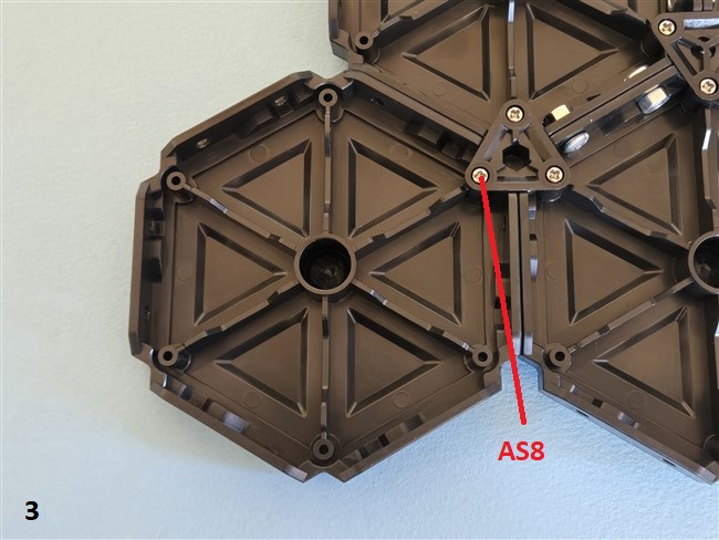

Parts supplied.....Pic 1, you will also need the base and solar array from the last update.

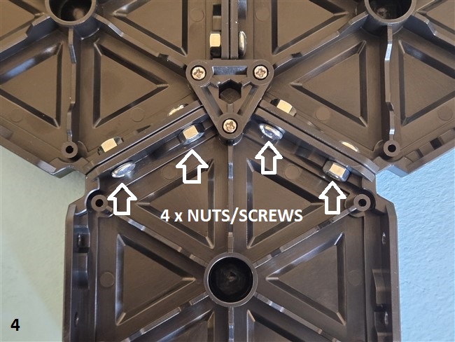

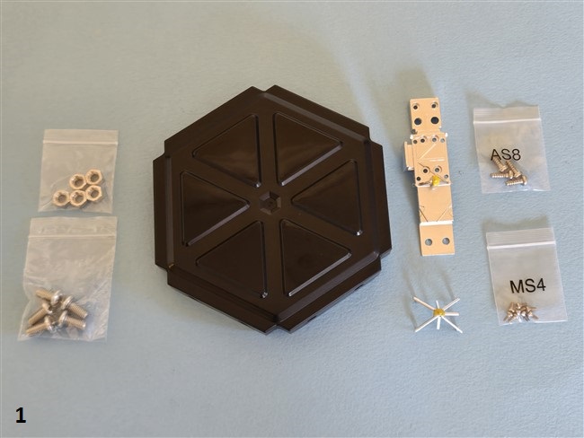

Starting with the base, Pic 2 shows the orientation of the new part BASE 1 part. Engage the new and previous parts and fix them using a single AS8 screw as in Pic 3. Then complete the joint with 4 x SCREWS/NUTS, Pic 4. The base at this stage is shown in Pic 5.

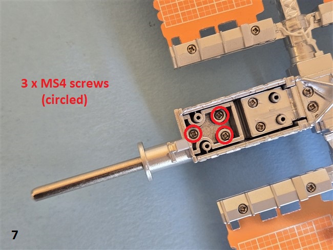

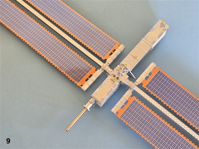

Now place the spindle part of the solar array 26W into place as shown in Pic 6 and fix it into position with 3 x MS4 screws, Pic 7.
Pics 8 and 9 show the central area of the solar array at the end of this update.

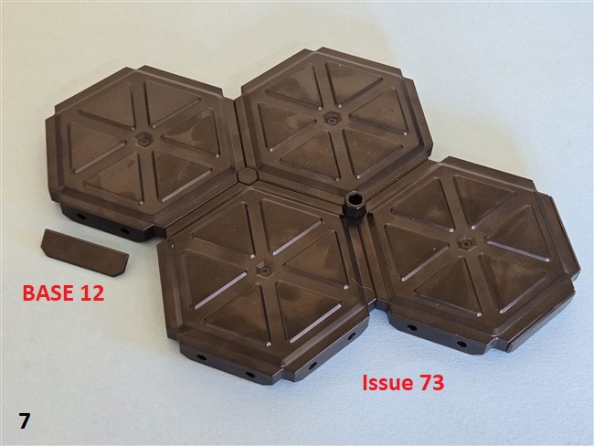

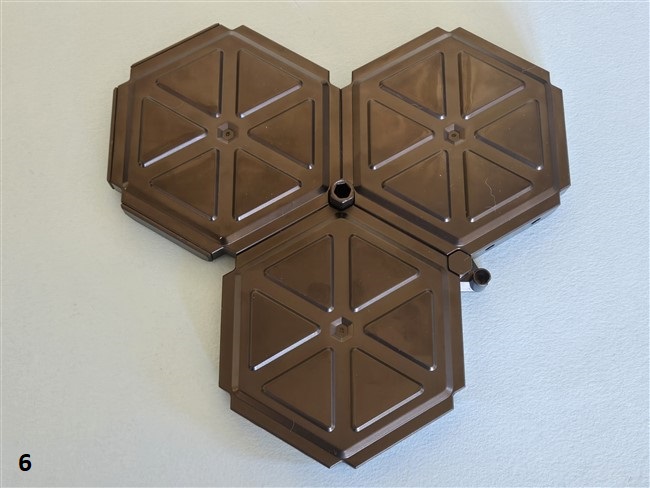

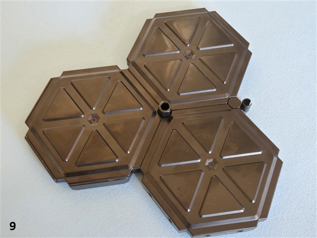

#6 Posted : 10 April 2025 17:45:55
Hi All, BigGrin

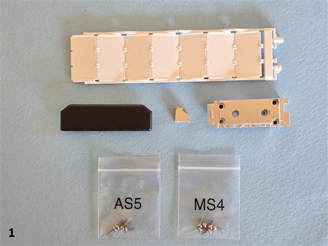

Here we are with the final update for this pack, with Issue 74.
Parts supplied.....Pic 1, you will also need the solar array and base from the last update.

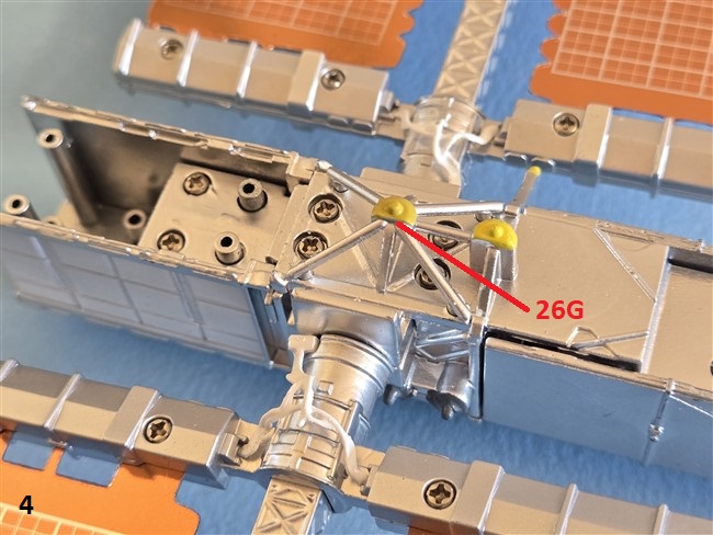

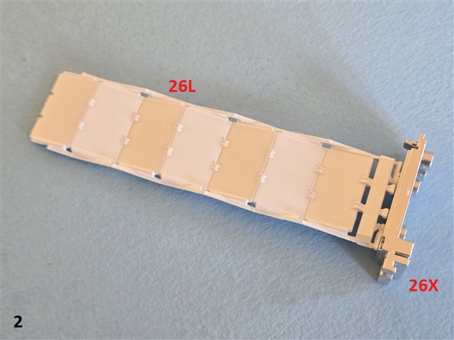

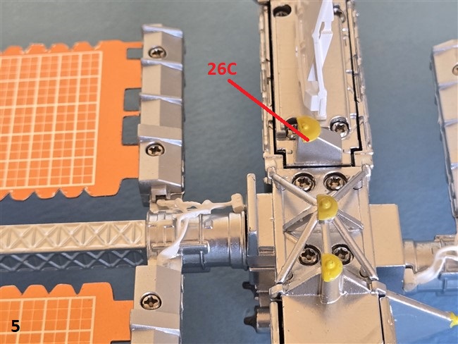

Position the parts 26L and 26X as shown in Pic 2 and then fix them together using 2 x AS5 screws, Pic 3. Now position this assembly onto the solar array from the previous update and fix it into position with 4 x MS4 screws, Pic 4. Add the final detailing part 26C, by pressing it into position as in Pic 5. Now Pic 6 shows the centre section of the solar array at this point.
Now take the base from the previous update and the part supplied BASE 12 and note the orietation in Pic 7. Press the BASE 12 part into position, Pic 8 and we are all done until the next pack arrives. ThumpUp
