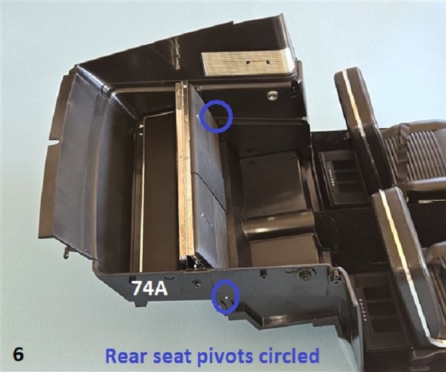

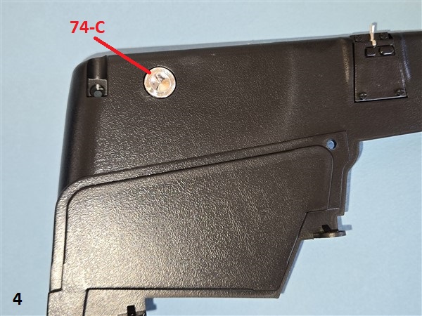

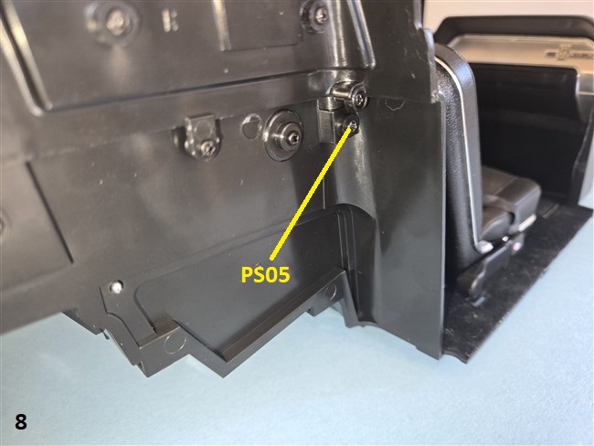

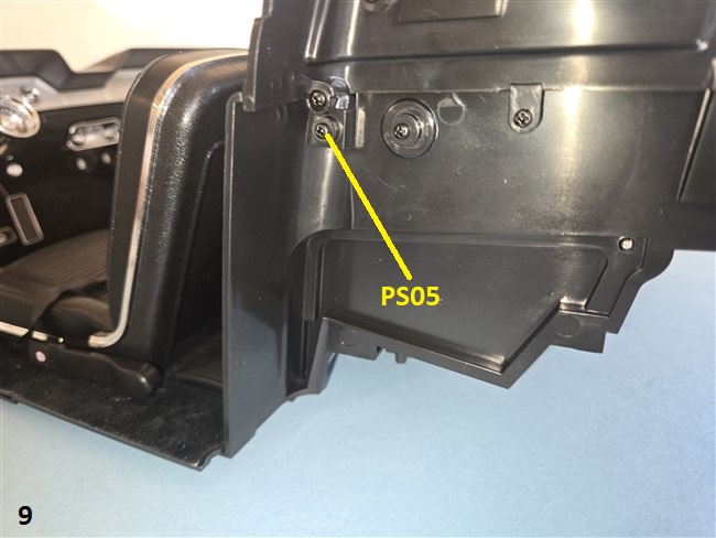

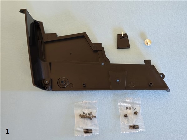

Issue 74 covers fitting the rear seat from the last update and starting the right side of the rear passenger compartment.
Parts supplied.....Pic 1, you will also need the rear seat assembly from the last update and the main inner passenger compartment.

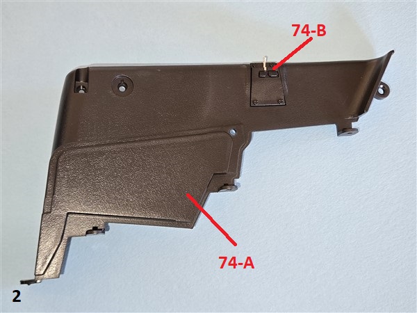

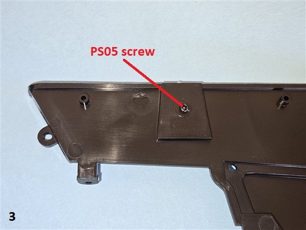

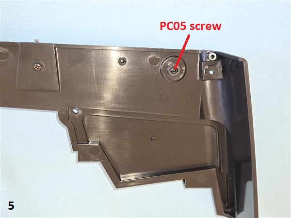

Start with the interior panel 74-A and position the rear seat mechanism 74-B, fixing it in place with a PS05 screw as shown in Pics 2 and 3. Now locate the fitting 74-C into the panel and fix that using a PS05 screw, Pics 4 and 5.

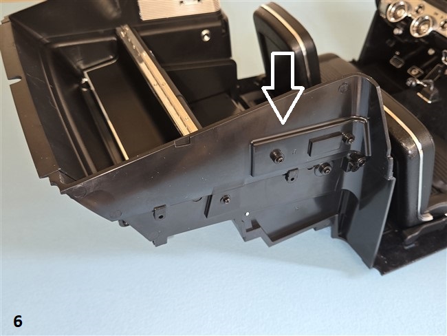

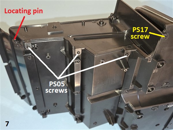

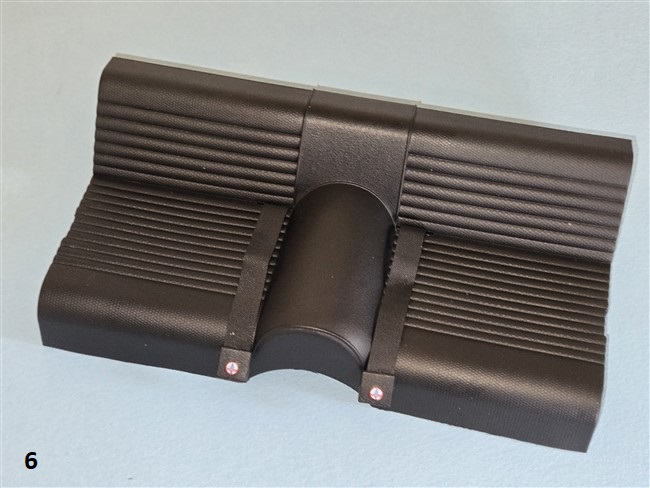

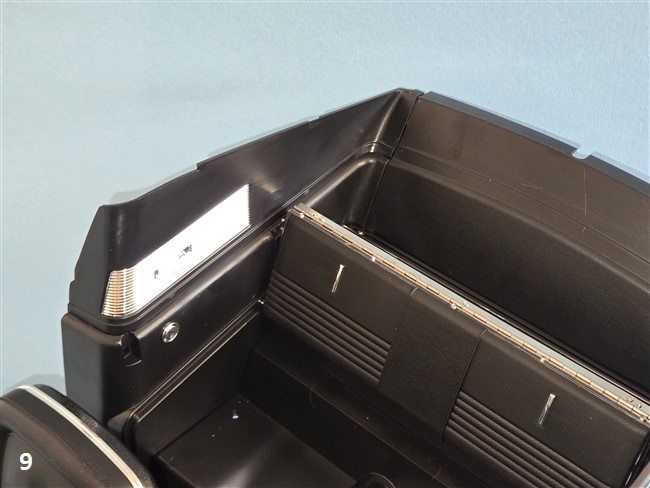

Take the rear seat assembly from the last issue and locate the left side pivot pin into the interior panel. Then add the panel 74A (just assembled) to the right side as shown in Pic 6. Make sure that the rear pin is engaged and fix the panel in place using 3 x PS05 screws and 1 x PS17 screw. All shown in Pic 7.

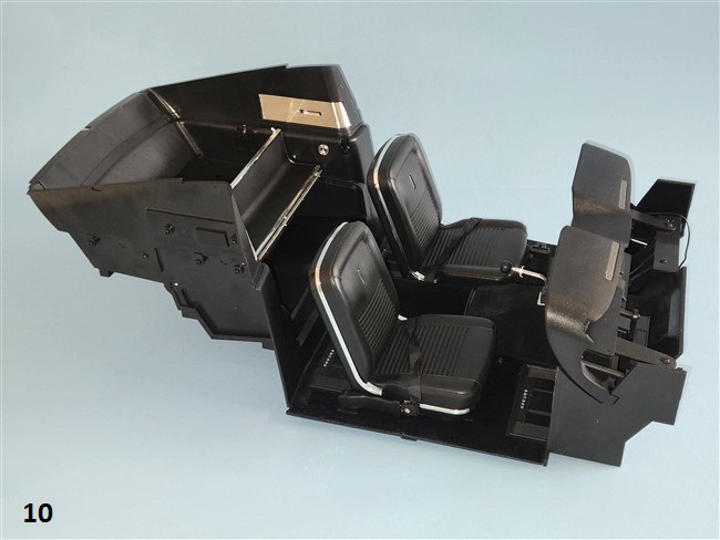

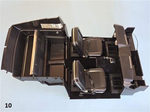

That`s all for this update, with Pics 8 and 9 showing the two positions of the rear seat back and Pic 10 the full assembly as it is now.

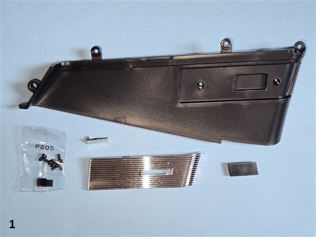

Parts supplied.....Pic 1, you will also need the internal passenger module from the previous update.

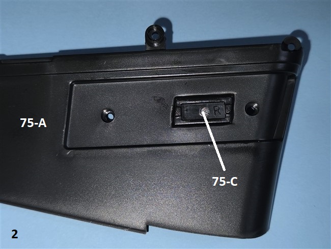

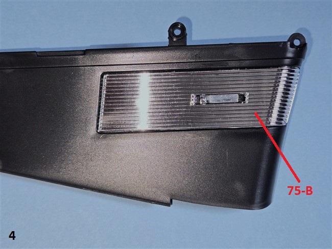

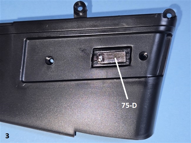

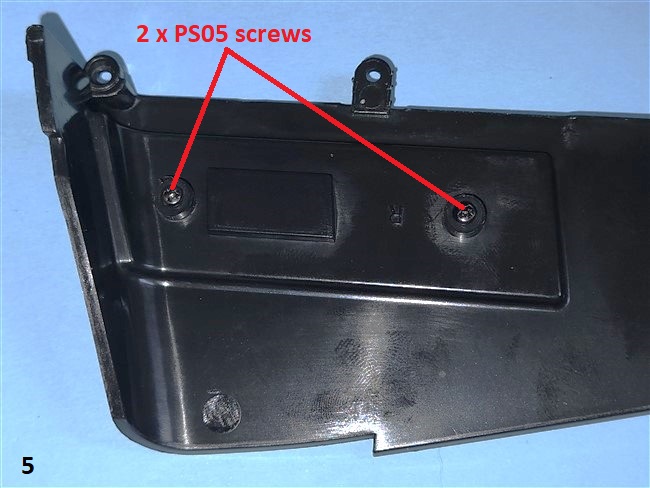

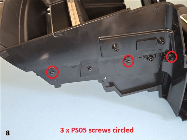

Start by placing the vent lever holder 75-C, into the interior panel 75-A as in Pic 2. Add the vent adjustment lever 75-D, Pic 3 and then the vent grille 75-B as in Pic 4. Hold the parts in place and secure them from the rear of the panel using 2 x PS05 screws, shown in Pic 5.
Place the assembly onto the rear right side of the internal module, as shown in Pic 6. Engage the upper stud of the rear panel, carefully into the panel you have just constructed, Pic 7 and fix the lower edge with 3 x PS05 screws as indicated in Pic 8.
That`s the end of this update, with the new panel shown in Pic 9 and the whole internal assembly in Pic 10.

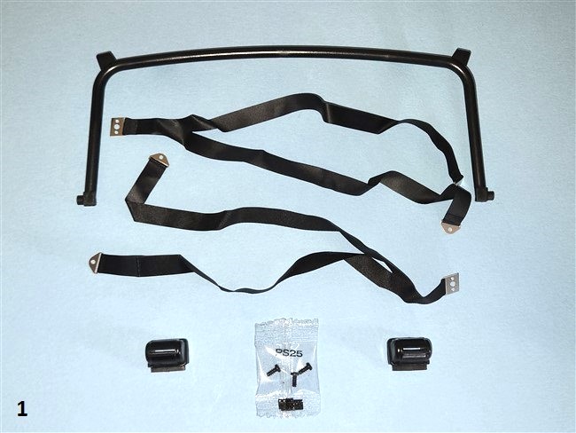

Parts supplied.....Pic 1. Fitting the harnesses to the roll bar.

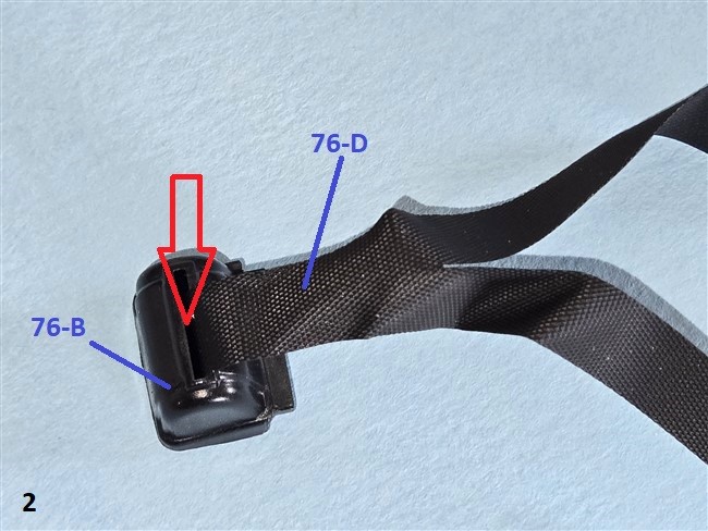

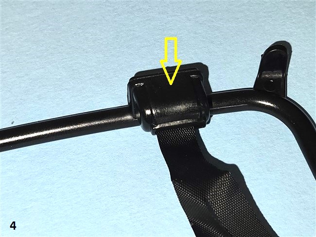

Feed the short single end of the harness 76-D, through the left harness holder 76-C as shown in Pic 2. Then press the buckle into its position on the two studs at the rear of the holder, Pic 3.

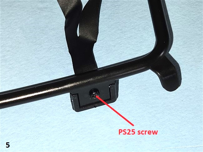

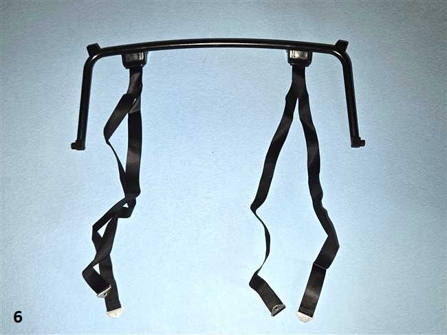

Bring the roll bar 76-A to the table and position the holder/harness as in Pic 4, fixing it in place with a PS25 screw as shown in Pic 5. Now repeat the sequence for the right hand harness to complete this issue, Pic 6.

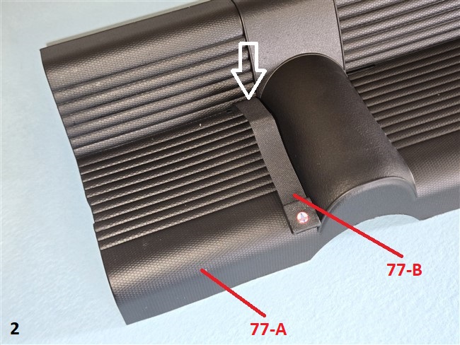

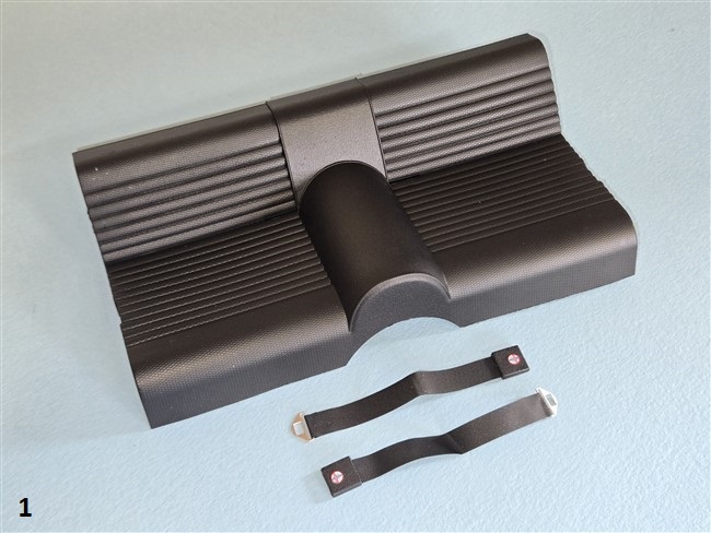

Feed one of the seat belts 77-B through the seat 77-A, Pic 2 and carefully press the end plate onto the locating pin on the underside of the seat, as shown in Pic 3.

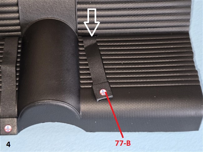

Repeat the previous sequence with the second belt 77-B as in Pics 4 and 5.

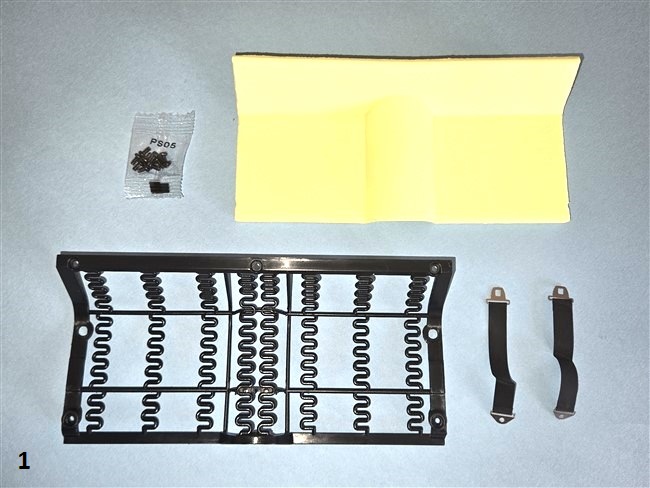

Parts supplied.....Pic 1, you will also need the rear seat base from issue 77, the roll bar from issue 76 and the main interior assembly.

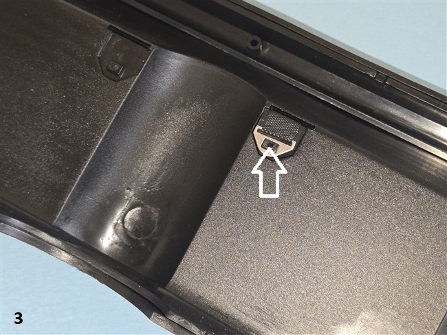

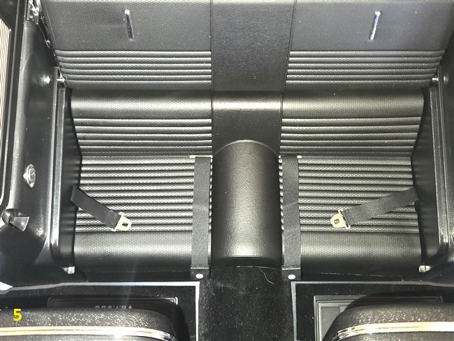

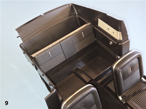

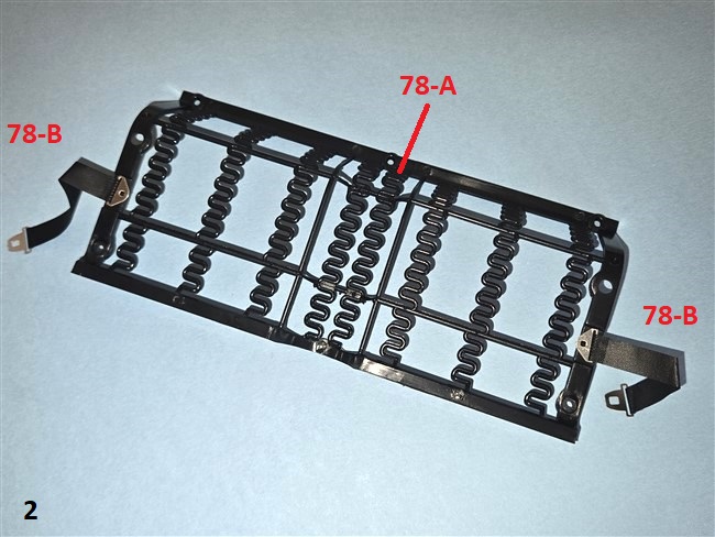

Start with the rear seat frame 78-A and press the rear seat belts, parts 2 x 78-B onto the locating pins as shown in Pic 2.

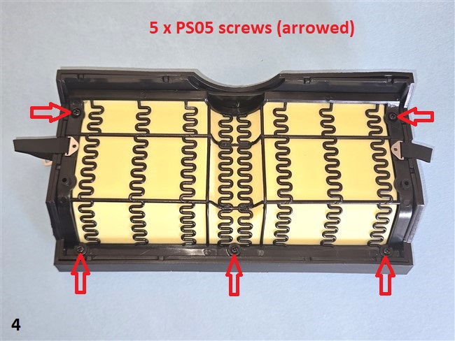

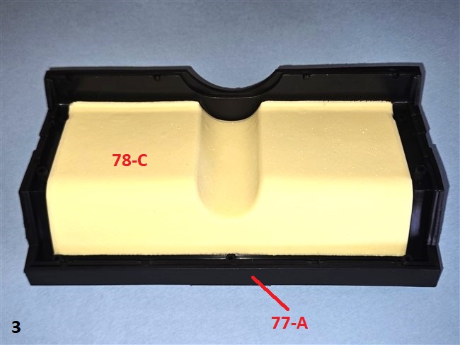

Now position the rear seat pad 78-C onto the rear seat 77A, as in Pic 3, then add the rear seat frame (just assembled) making sure the belts don`t get trapped and fix them together using 5 x PS05 screws, Pic 4.

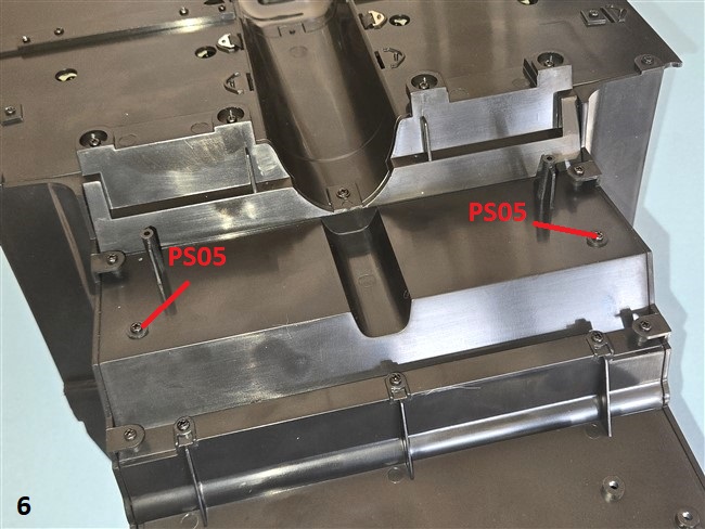

Take the seat assembly and fit it into the interior section as in Pic 5 (don`t trap the belts) and fix the seat base from underneath with 2 x PS05 screws, Pic 6.

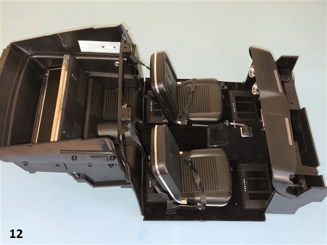

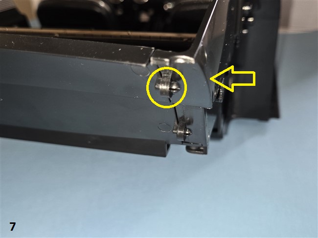

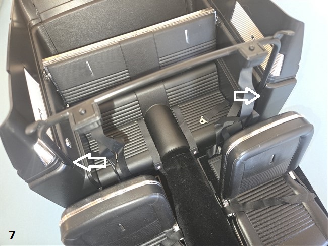

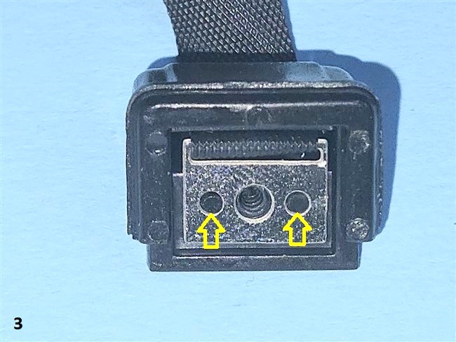

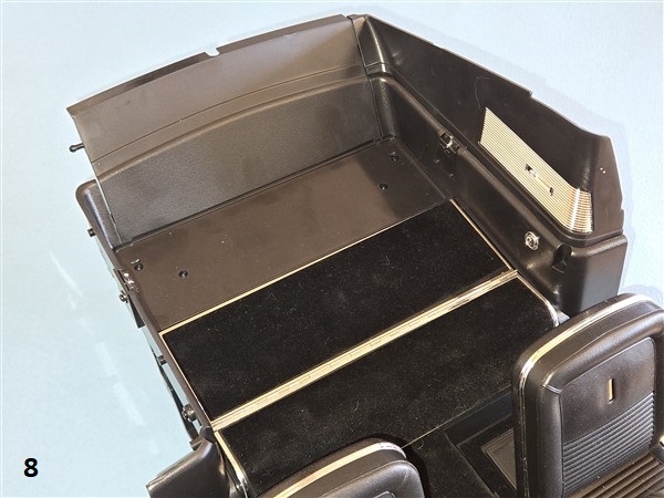

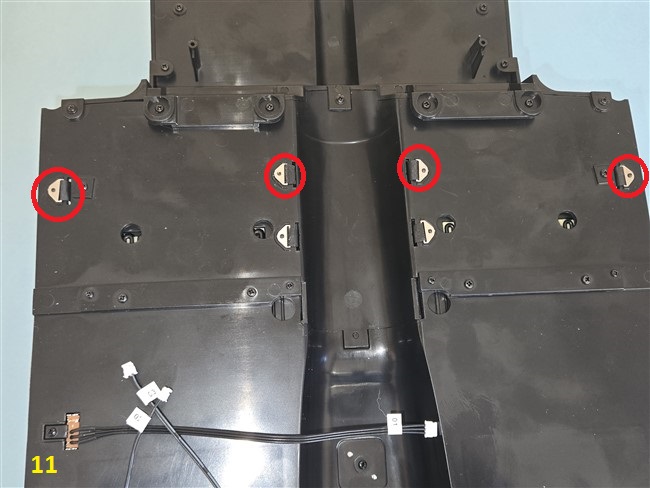

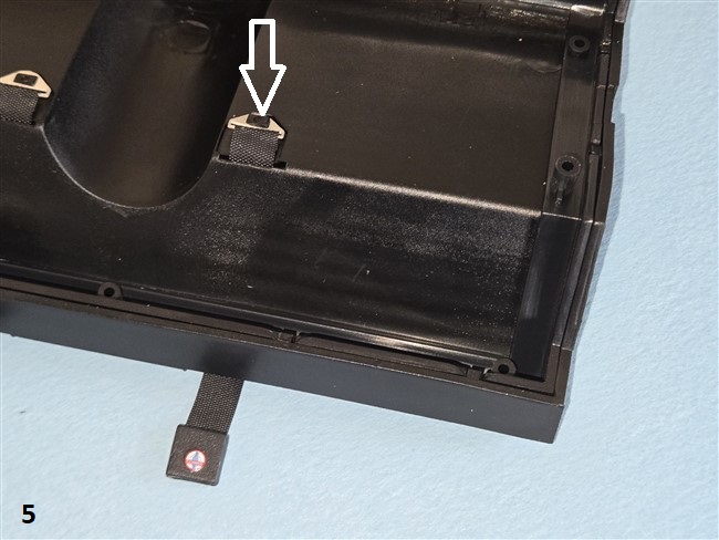

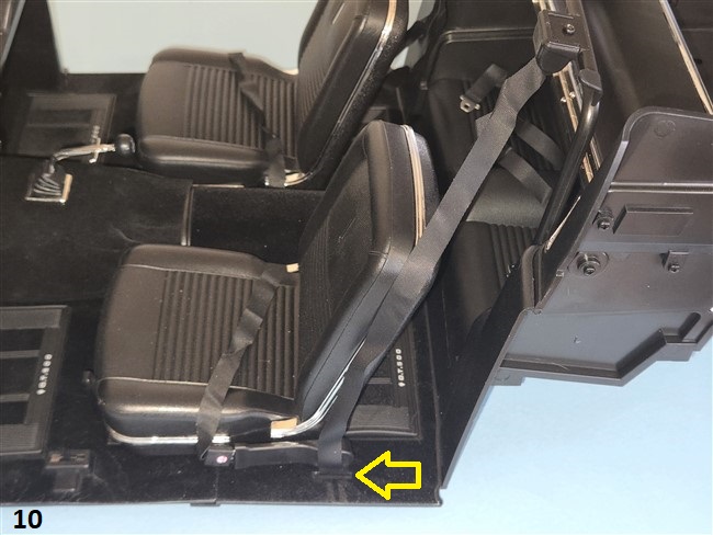

Position the roll bar from issue 76 as shown in Pic 7 and fix it in place with 2 x PS05 screws, Pics 8 and 9. The next stage is fiddly, where the hanging seat belts are fixed through the floor. Take each in turn, passing the triangular buckle through the floor (one shown) Pic 10 and fit them to the pins under the floor as indicated in Pic 11.
That`s all for this update, Pic 12. Now waiting for the next delivery.
