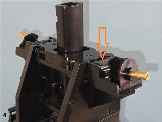

Here`s Issue 69.ThumpUp

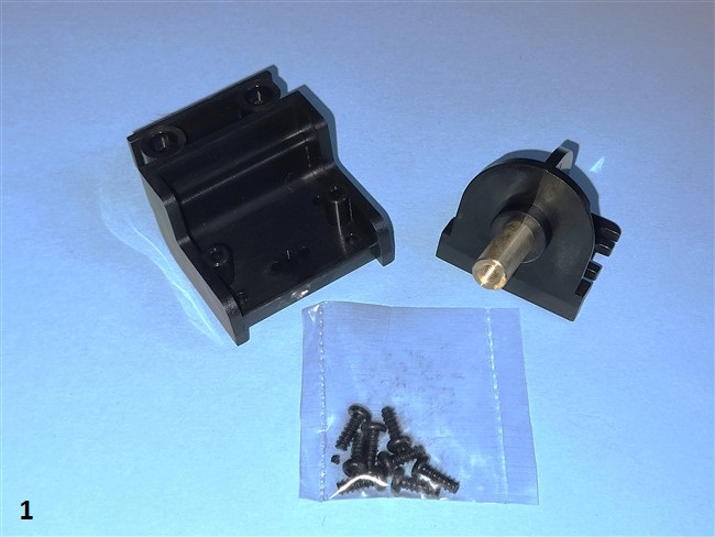

Parts supplied.....Pic 1, you will also need the main body of ET.

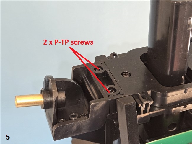

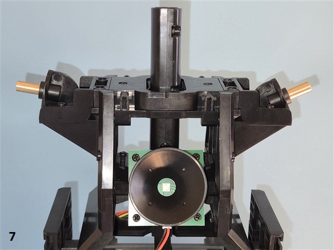

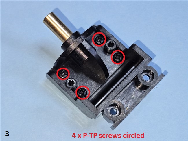

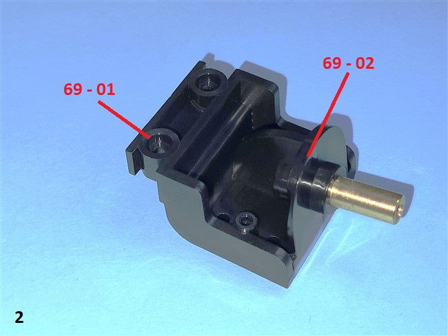

Position the part 69-02 inside part 69-01 as shown in Pic 2, then fix the parts together with 4 x P-TP screws, Pic 3.

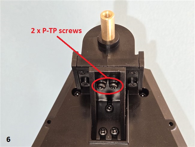

Place the assembly into the main body of ET, indicated in Pic 4. Now fix it into position, using 2 x P-TP screws shown in Pic 5 and 2 x P-TP screws, as in Pic 6.
That`s it for this update, Pic 7.

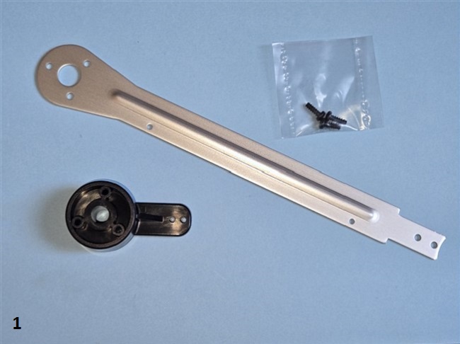

Parts supplied.....Pic 1.

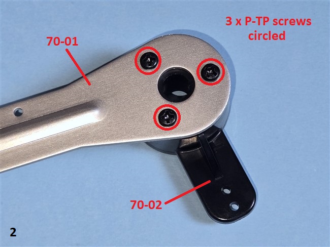

Position the parts 70-01 and 70-02 together and fix them using 3 x P-TP screws as shown in Pic 2.
Pic 3 shows the end assembly for this issue. Did someone say "SHORT".

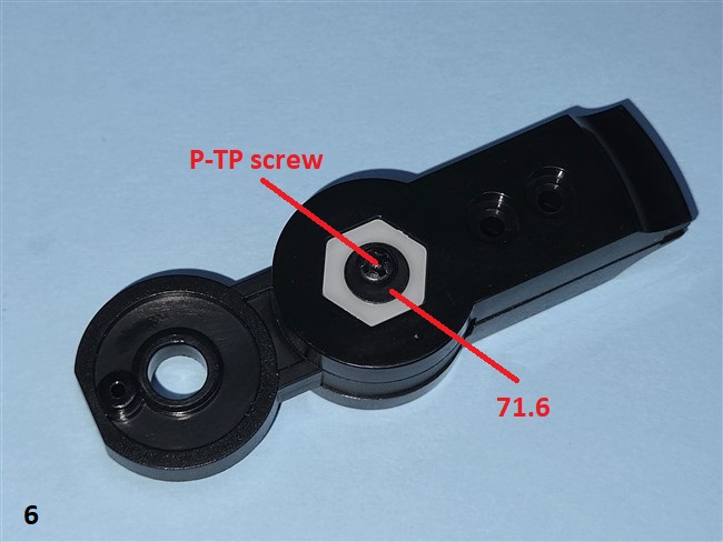

In this update for Issue 71, we build and add ET`s left elbow to his upper arm.

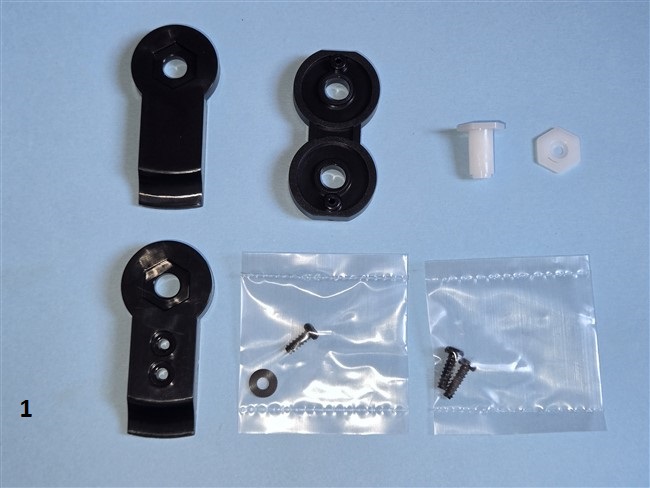

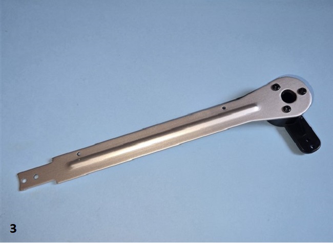

Parts supplied.....Pic 1, you will also need the upper arm from the previous update.

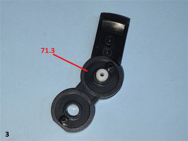

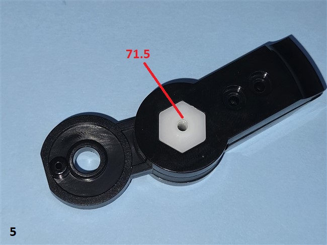

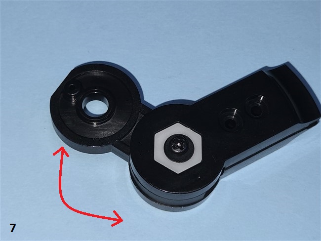

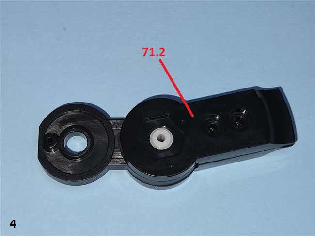

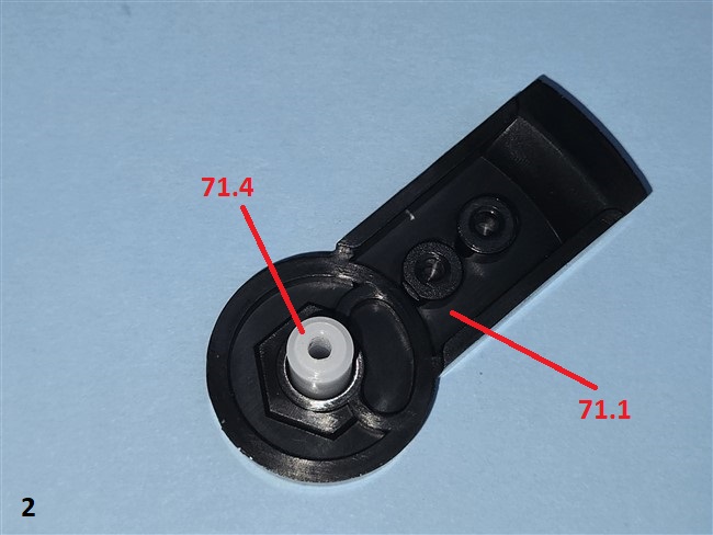

Start by positioning the elbow shaft 71.4, through the elbow 71.1 as in Pic 2. Then place the forearm joint 71.3 onto the shaft, Pic 3 and then place the elbow cover 71.2 as in Pic 4. Now, fix these elbow parts together with the elbow shaft washer 71.5 in Pic 5 and the screw P-TP and washer 71.6, Pic 6. Check the movement of the joint now, Pic 7.

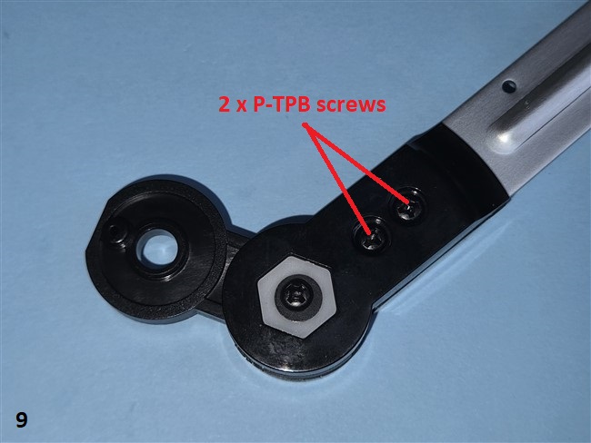

Take the upper arm assembly from the previous update and position it fully into the elbow joint, Pic 8 and fix the two assemblies together with 2 x P-TPB screws as in Pic 9.
The final assembly should be as shown in Pic 10.

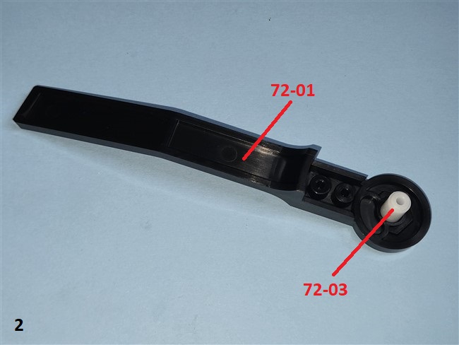

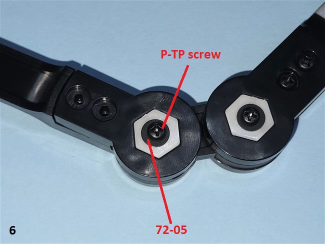

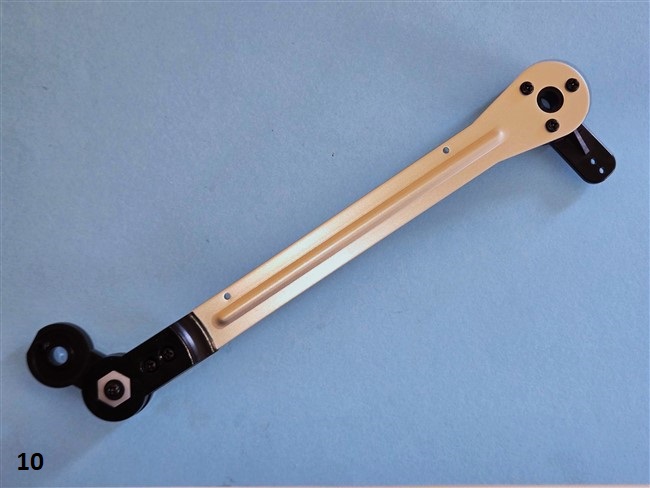

Here we go with the update for issue 72.
Parts supplied.....Pic 1, you will also need the final assembly from the last update, issue71.

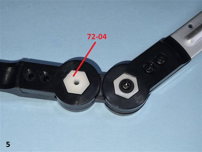

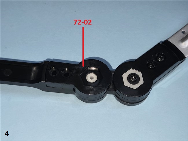

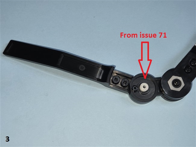

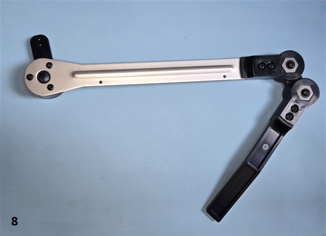

Place the elbow shaft 72-03 through the left forearm 72-01 as shown in Pic 2 and then add the upper arm assembly (from the previous issue) as in Pic 3.
Now add the left forearm cover 72-02, Pic 4. To fit the elbow joint together, add the Hex washer 72-04 as in Pic 5 and fix the parts in position with a washer 72-05 and a P-TP screw, shown in Pic 6.
To finish this part of the assembly, secure the forearm cover to the forearm with 2 x P-TPB screws as in Pic 7. ET`s arm at this point is shown in Pic 8.

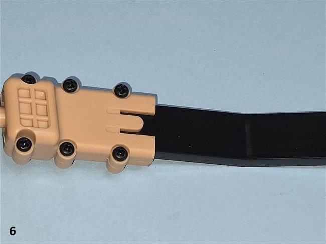

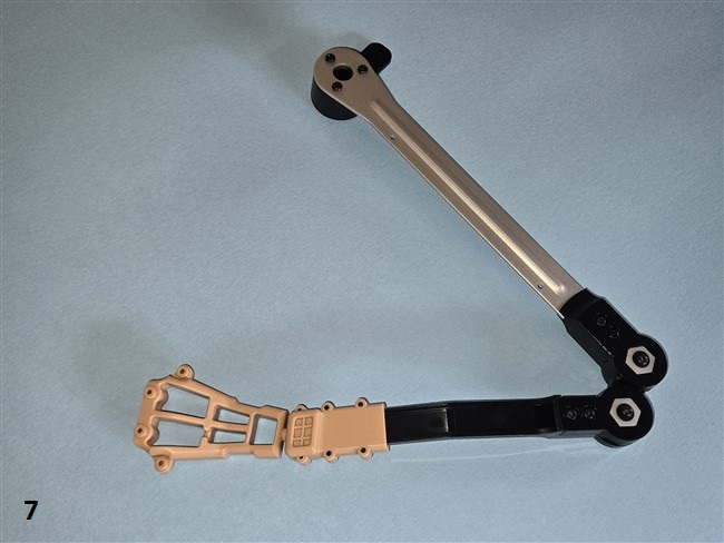

Parts supplied.....Pic 1, you will also need the left arm assembly from the previous issue.

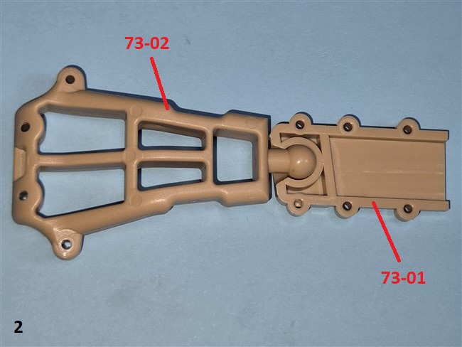

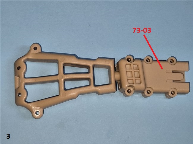

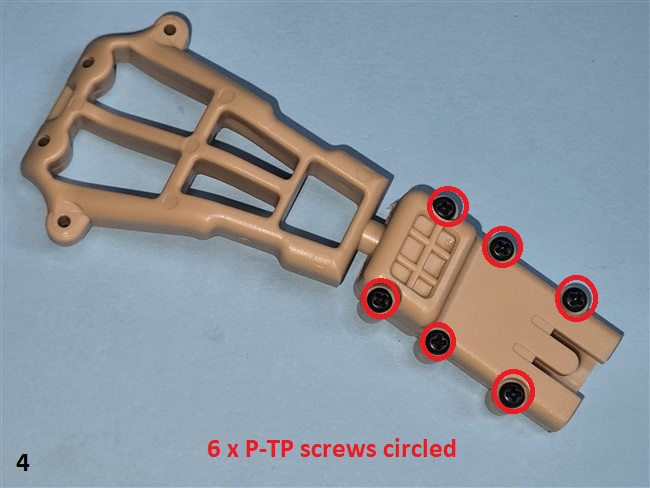

Place the ball end of the left hand 73-02, into the socket of the wrist joint 73-01 as in Pic 2. Then position the joint cover 73-03 on top, Pic 3. Now secure the wrist assembly with 6 x P-TP screws as shown in Pic 4.
Bring the arm assembly from the previous issue to the table and note that the lug in the wrist, needs to be on the same side as the drillings in the forearm. Indicated in Pic 5.
Push the forearm fully into the hand, as in Pic 6 to complete this issue. Pic 7 shows the complete assembly at this time.

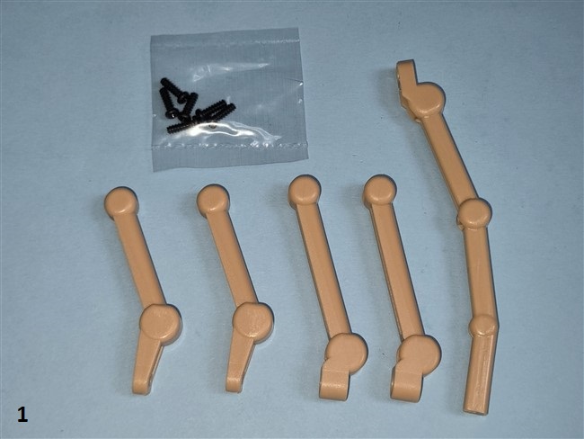

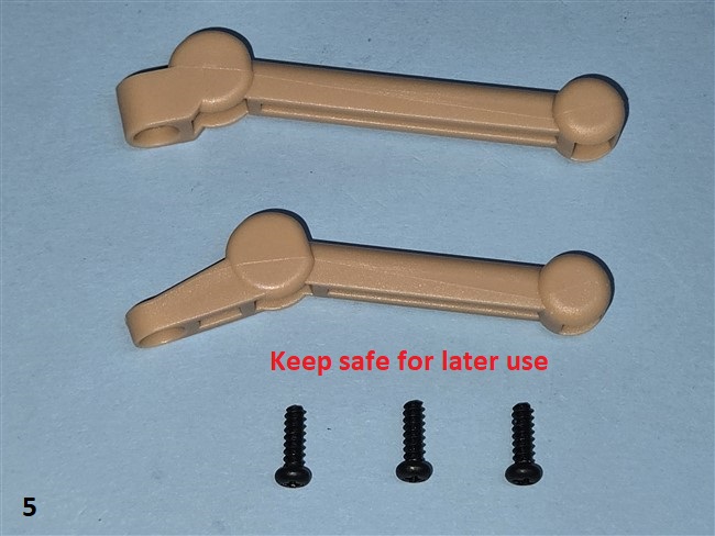

It`s ET update time with the last issue of this pack #74.
Parts supplied.....Pic 1, you will also need the Arm/Hand assembly from issue 73.

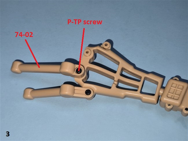

Place the finger 74-03 into the left side of the left hand and fix in place using a P-TP screw, as in Pic 2.

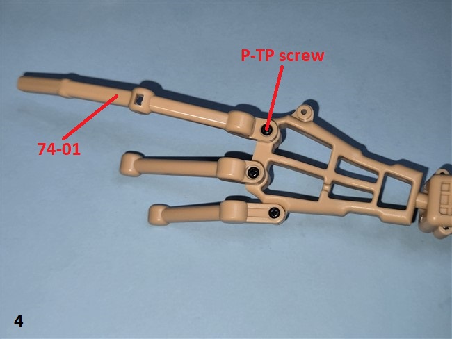

Position the next finger 74-02, fixing it with another P-TP screw as shown in Pic 3. Then add the largest finger 74-01, fixing it also with a P-TP screw, Pic 4.
That`s all for this update and pack, so keep the remaining parts shown in Pic 5 safe until needed later.
(Derek) Admin
