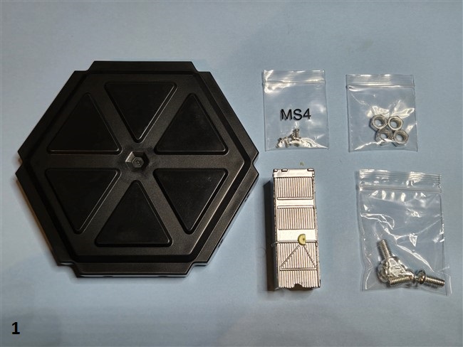

Parts supplied.....Pic 1, you will also need the final assembly and the BASE 1 from Issue 62.

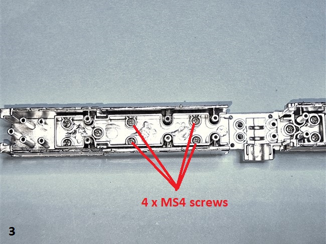

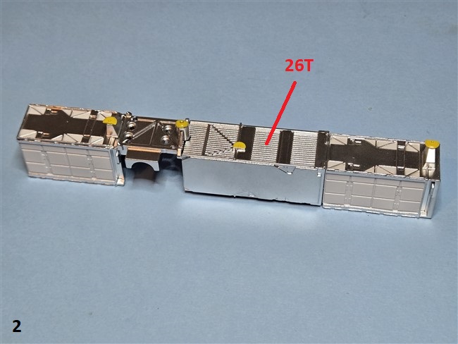

Start with the final assembly from issue 62 and place the new part 26T as shown in Pic 2. Now hold the parts together and secure them with 4 x MS4 screws as shown in Pic 3.

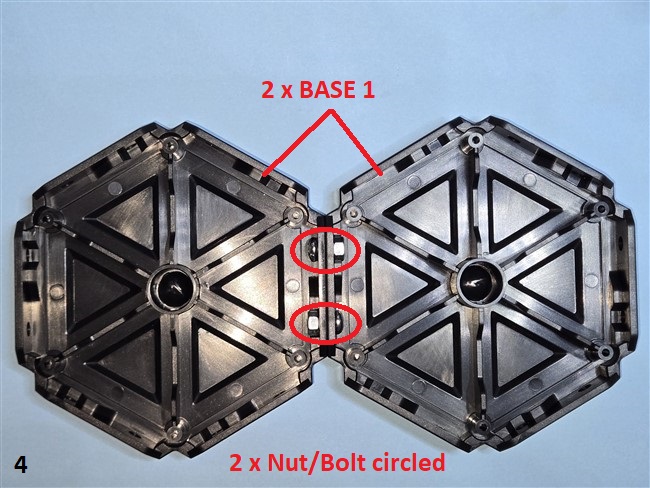

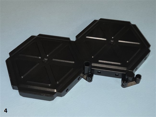

Position the two BASE 1 parts together and fix them using 2 x Nuts/Bolts as in Pic 4. That`s all for this update, Pic 5.

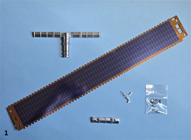

I`m back with the update for Issue 64 of the ISS, which covers the start of the next double solar panel.
Parts supplied.....Pic 1.

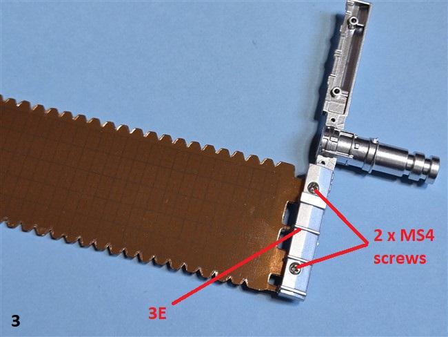

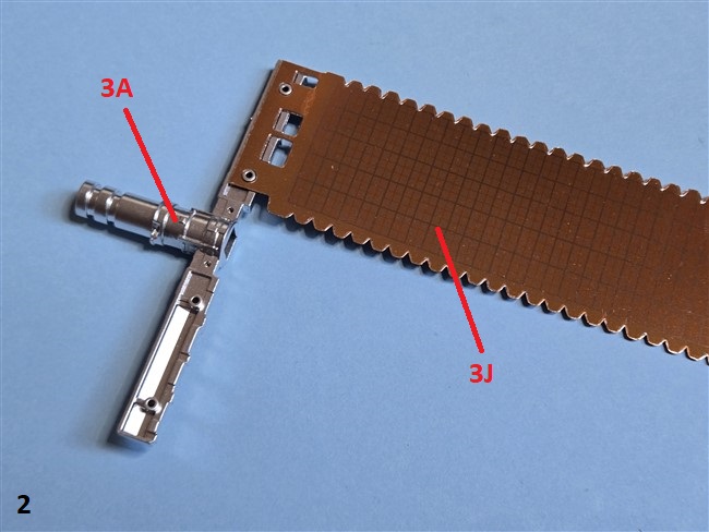

Carefully press the solar panel 3J onto the mounting bar 3A as shown in Pic 2. Then place the part 3E over the solar panel and fix it in place using 2 x MS4 screws, Pic 3.

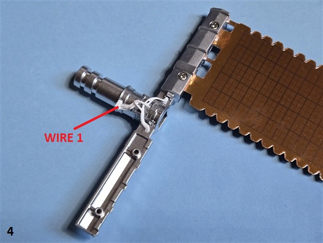

Finally, press the part WIRE 1 into position as indicated in Pic 4.

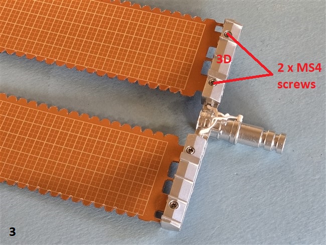

The next update for the ISS is here, with issue 65.
Parts supplied.....Pic 1, you will also need the assembly from the end of the last update.

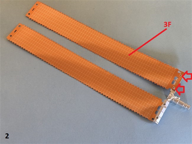

With the previous assembly on the table, add the solar panel 3F as shown in Pic 2.
Then add the retaining piece 3D and secure the parts together using 2 x MS4 screws, Pic 3. The central spar 3C can be added now as in Pic 4, but it will not be fixed in position until the next issue.

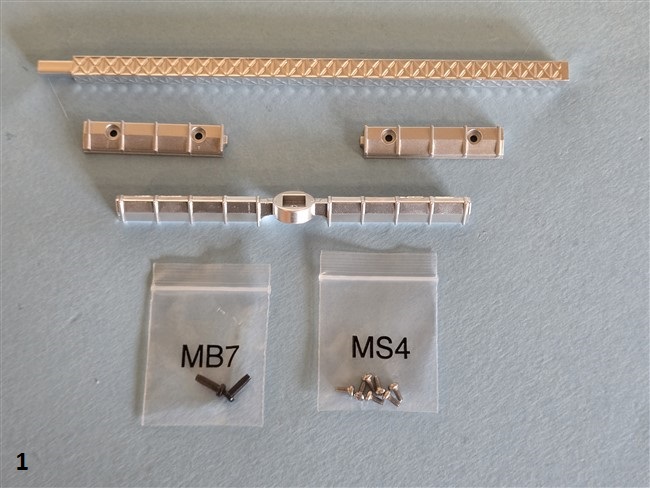

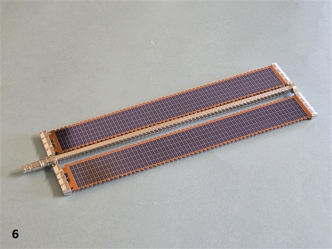

I`m back with update #66.
Parts supplied.....Pic 1, you will also need the solar panel from the previous update.

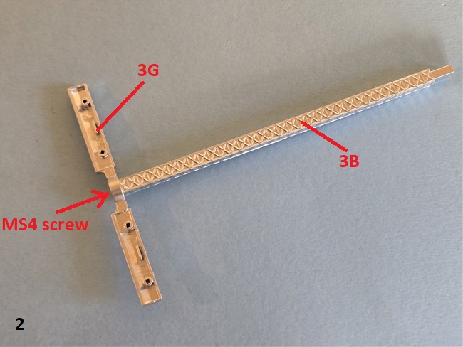

Take parts 3B and 3G and fix them together using an MS4 screw as shown in Pic 2.

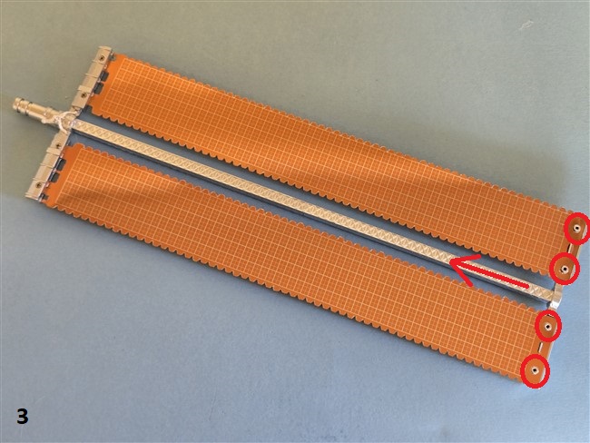

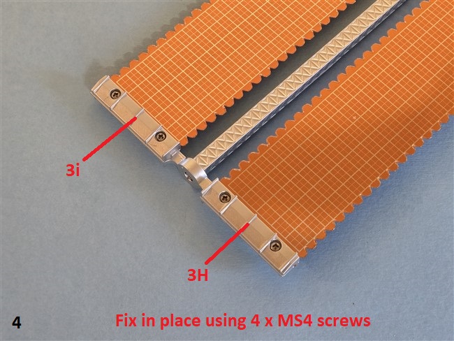

Retrieve the assembly from issue 65 and insert the new centre/end bar as shown in Pic 3. NOTE: Be very careful, when pressing the foil panels onto the studs of the end bar. To keep the foil panels in place, add the end caps 3H and 3i, fixing them with 4 x MS4 screws as in Pic 4.

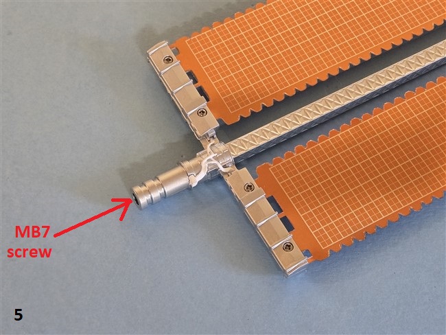

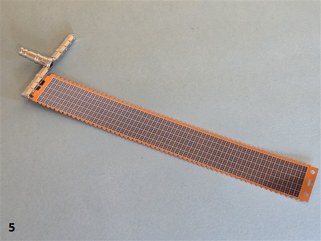

Finally, add the MB7 screw into the end spindle to tension the foil panels, Pic 5. DO NOT over tension the foils, or damage will occur.

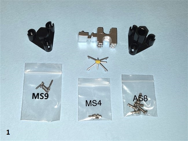

Here`s the next update for the ISS with Issue 67.
In this issue we connect the completed solar panel to the main spar and add some fittings to the base extension.
Parts supplied.....Pic 1, you will also need the base and spar assemblies from issue 63 and the solar panel from issue 66.

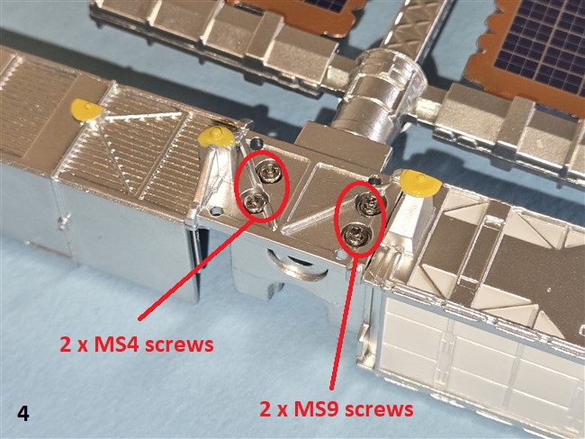

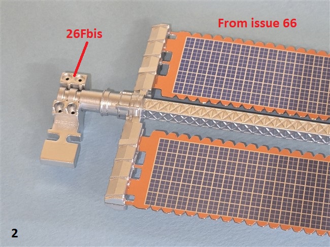

Start by positioning the solar panel into the support 26Fbis as shown in Pic 2. Then, put the spar assembly from issue 63 on the table and lay the parts into place as indicated in Pic 3.

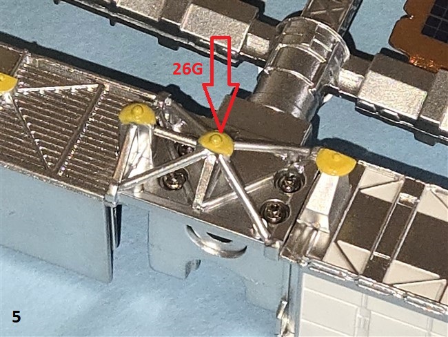

At this point there is a printed instruction error. The assembled parts you have on the table are fixed by only 4 screws, not 6. So use 2 x MS9 screws and 2 x MS4 screws as shown in Pic 4. To finish this part of the update, press fit the four corner pins of part 26G into the centre spar, Pic 5.

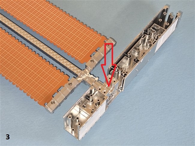

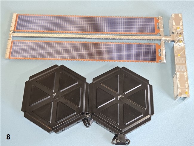

You now need the base assembly from issue 63 on the table. Fit the connector parts, BASE 2 and BASE 11 and secure them with 3 x BIG AS8 screws as in Pic 6. Your base assembly should be as shown in Pic 7, with Pic 8 showing the end of this issue.

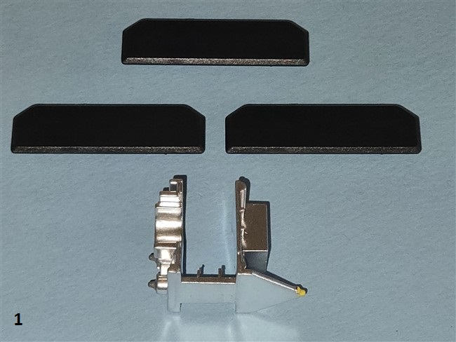

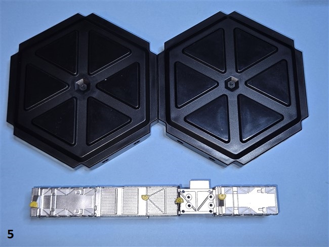

We start this update with the base assembly from the last update and add the 3 x BASE 12 parts as shown in Pic 2.

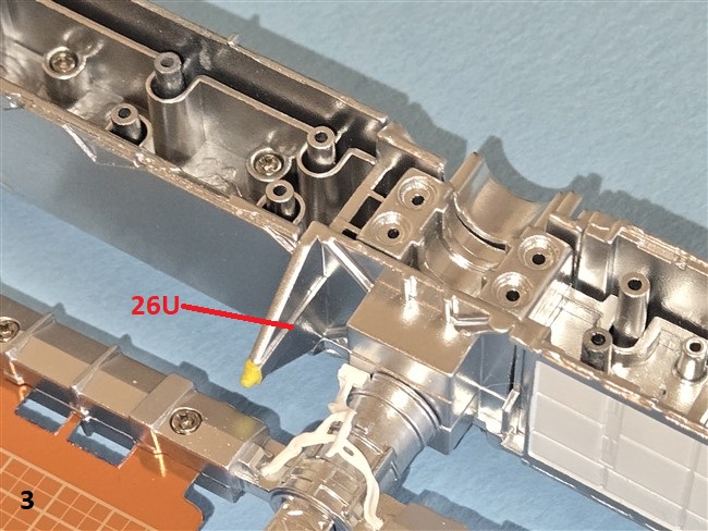

Now, with the solar panel assembly, press the part 26U into place as shown in Pic 3.

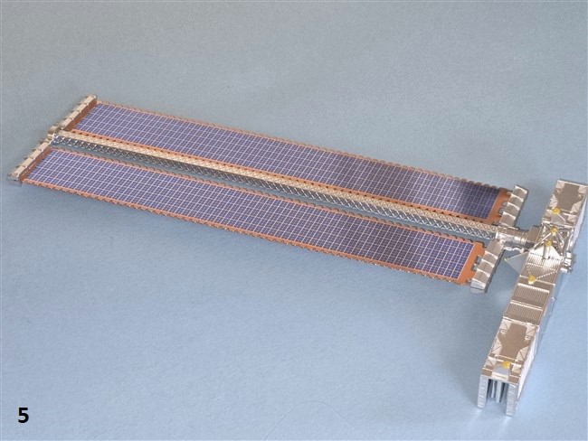

That`s all for this update. Pics 4 and 5 show how the assemblies should look now.
