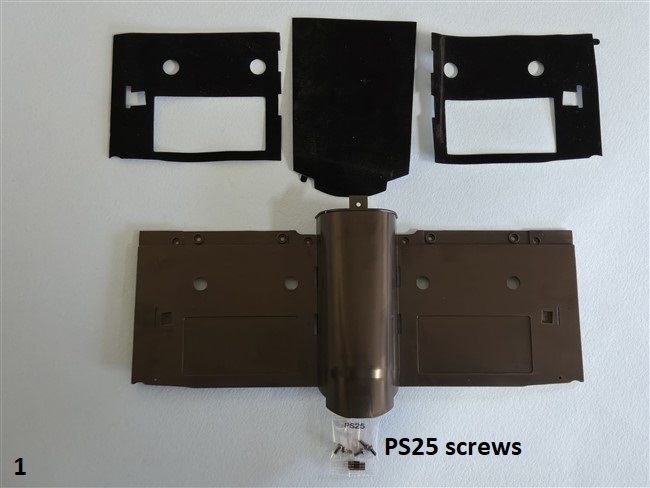

Issue 64 covers the rear inner floor and carpets.
Parts supplied.....Pic 1. You will also need the front floor with the attached dashboard from the previous pack.

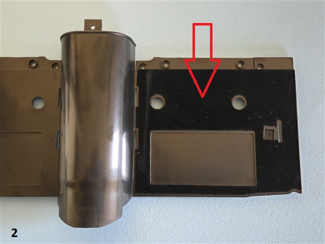

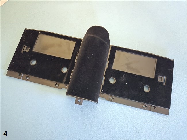

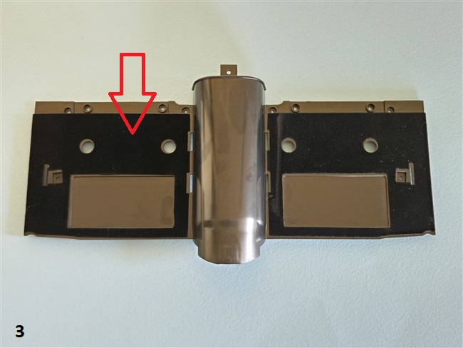

Start by placing the right/rear carpet 64-D onto the rear floor 64-A as shown in Pic 2. Then add the left carpet 64-B in the same way as shown in Pic 3. The rear floor with both carpets attached is shown in Pic 4.

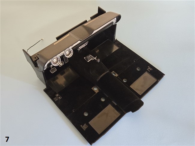

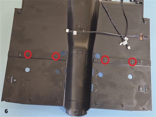

Now retrieve the forward floor with the dash from the previous pack and place it together with the rear floor as shown in Pic 5. Hold the floor panels together, turn them over and fix them together using 4 x PS 25 screws as in Pic 6.
That completes this update as in Pic 7, with the next update coming soon.

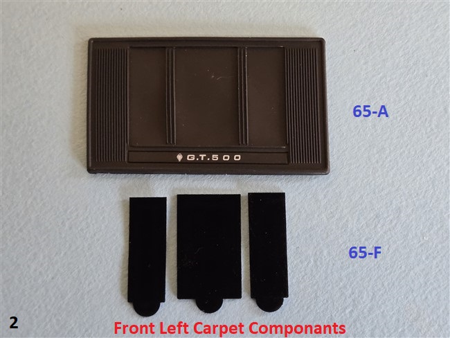

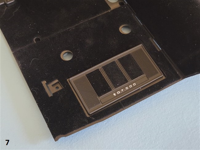

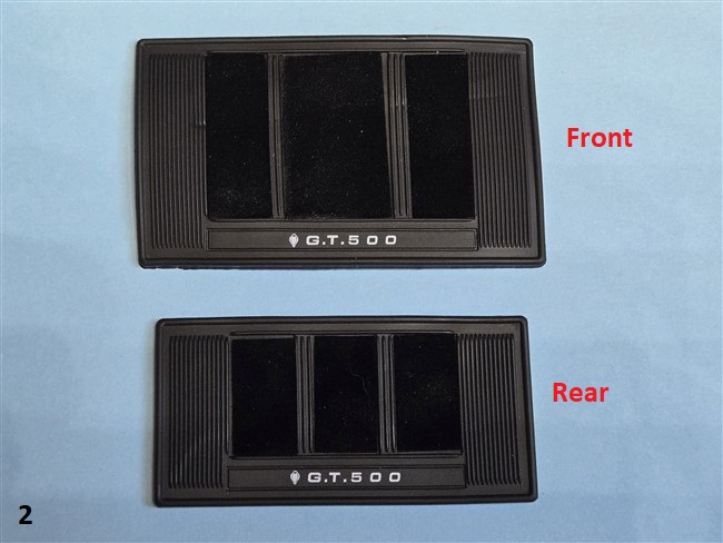

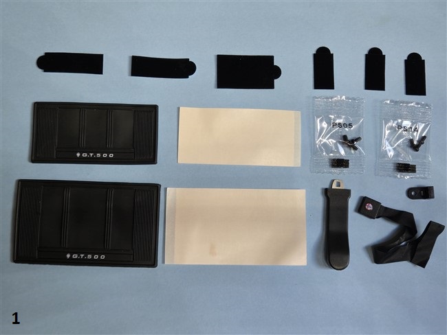

Part A: All parts supplied.....Pic 1, you will also need the front floor/dashboard assembly from issue 64.

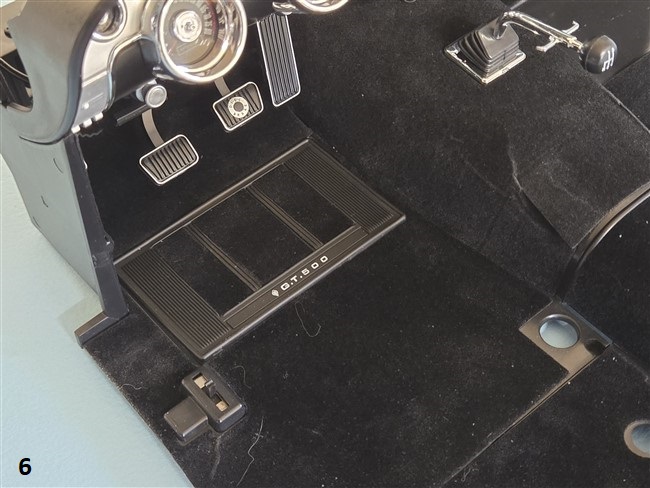

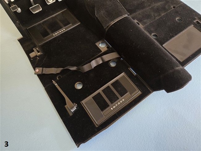

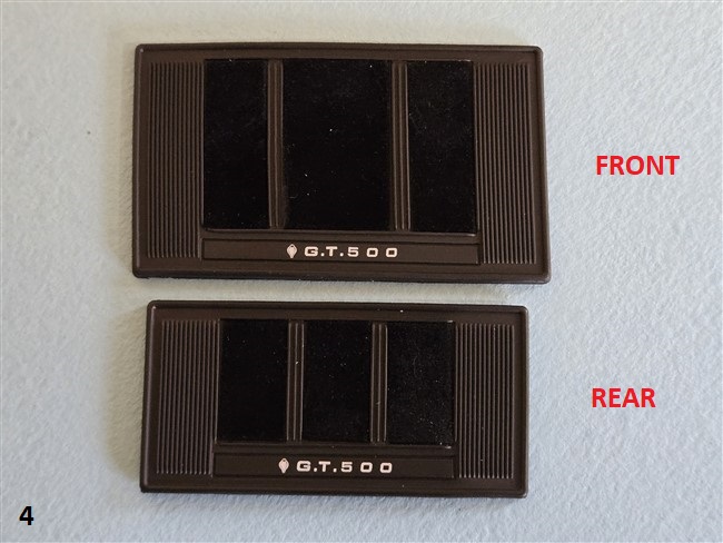

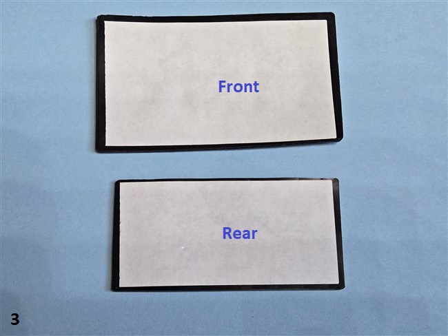

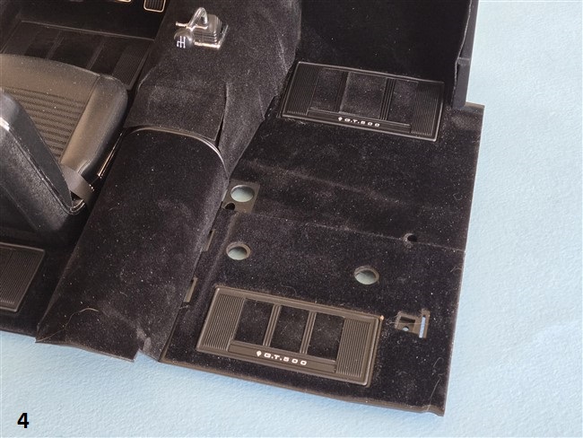

We start with the assembly and fitting of the drivers side (left) carpets. Match up the carpet pieces with the rubber mats as shown in Pics 2 and 3. Remove the backing paper from each carpet piece in turn and stick them into position on the rubber mats as in Pic 4.

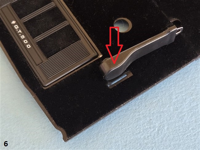

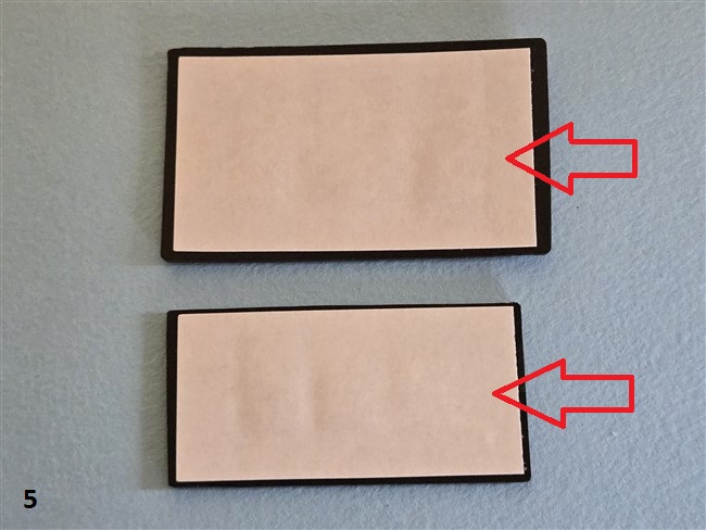

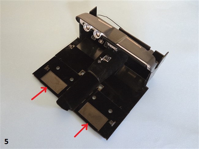

Note that the carpets have a paper backing (Pic 5), remove it from the larger one and position it on the floor as shown in Pic 6, then repeat with the smaller one and position that one as shown in Pic 7.

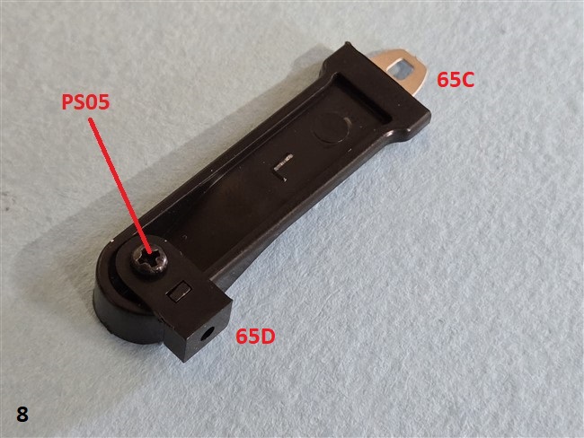

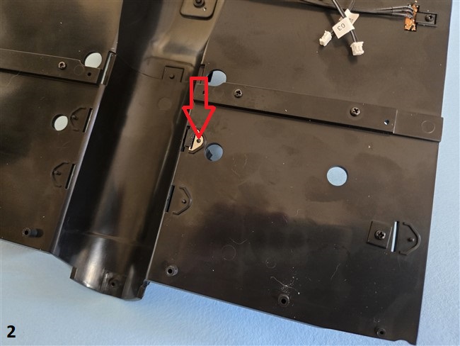

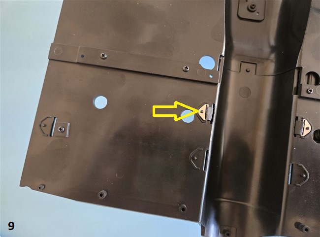

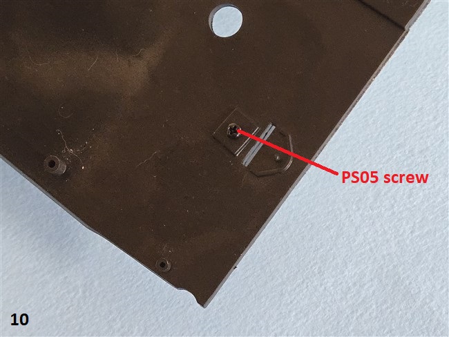

Next, we assemble the first parts of the drivers seatbelt. Place the anchour bracket 65D onto the seatbelt anchor 65C and fix them together using a PS05 screw, as shown in Pic 8. Hold the anchor assembly in the position shown in Pic 9 and fix it in place from under the floor, using another PS05 screw, as in Pic 10.

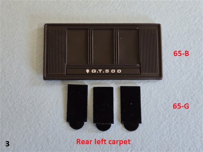

I`m back with Issue 65 part B. Parts supplied will be those left over from part A and you will also need the final assembly from part A and the drivers seat.

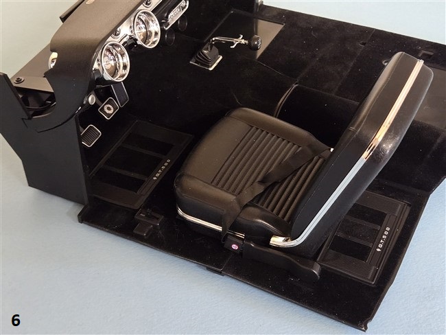

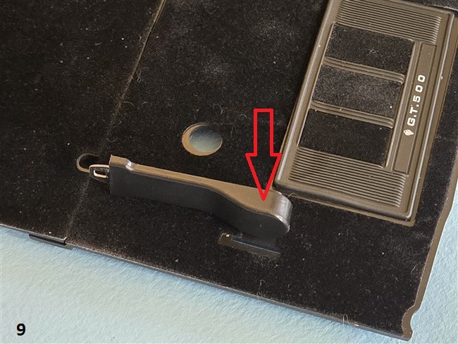

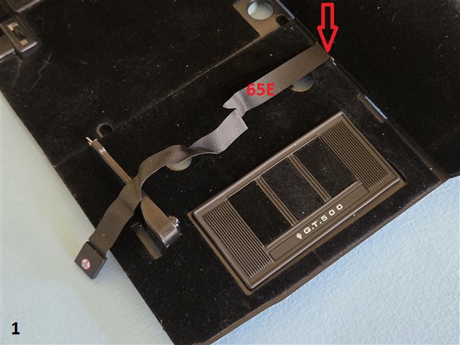

We start with the floor/dashboard assembly from the previous post and the seatbelt part 65E. Making sure that the seatbelt is the correct way up, feed the triangular bracket through the floor as shown in Pic 1. Now, whilst holding the seatbelt in position, turn the floor over and carefully press the triangular bracket onto the pin as shown in Pic 2. The seatbelt fitted in position is shown in Pic 3.

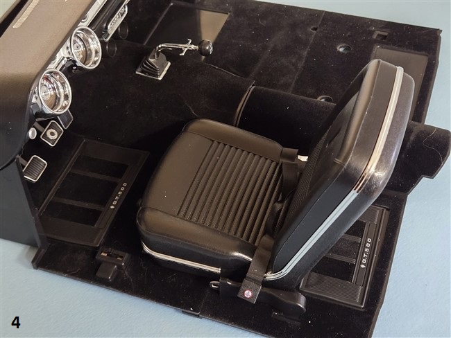

Now put the drivers seat in position, being sure not to trap the belt underneath it, as shown in Pic 4. Hold the seat in place, turn the floor over and fix the seat in position using 2 x PS14 screws, Pic 5.

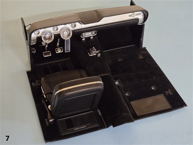

That`s all for Issue 65, see Pics 6 and 7. We are also at the mid-point of this build. Second half starting soon.

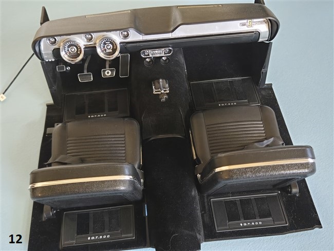

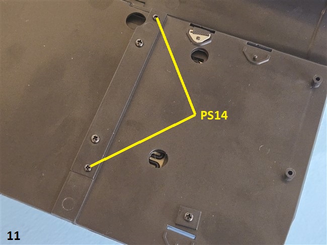

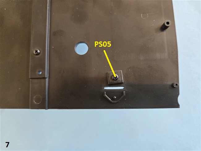

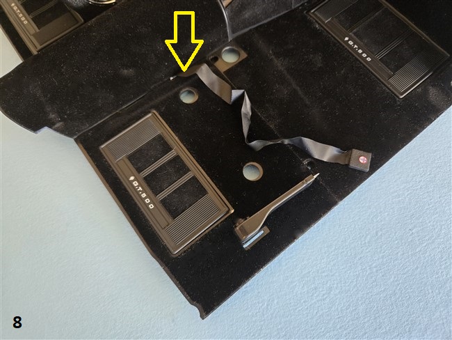

Here we are with the update for Issue 66. We will fit the front right passenger seat and associated parts, which is a near copy of the drivers seat from the previous issue.

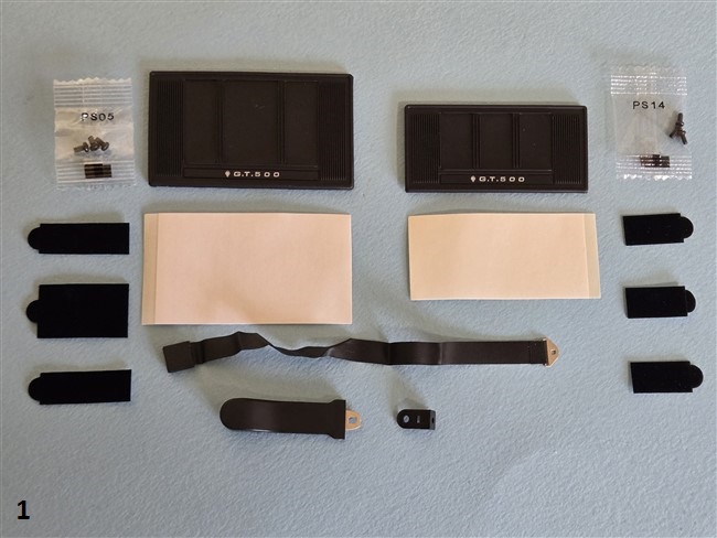

Parts supplied.....Pic 1, you will also need the passenger seat assembled earlier.
The front and rear carpets (same as before) are shown in Pic 2, with the fixing tape shown in Pic 3 and positioned as in Pic 4.

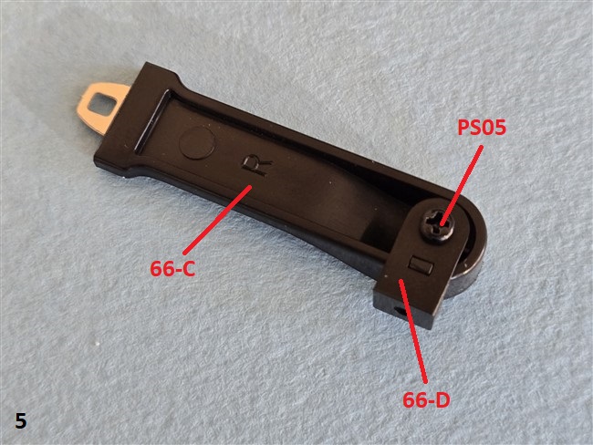

The seatbelt anchor assembly is shown in Pic 5, its positioning in Pic 6 and final fixing in Pic 7.
Having made sure that you have the seatbelt 66E the correct way up, pass the triangular bracket through the floor as in Pic 8 and carefully press the bracket onto the stud as in Pic 9.

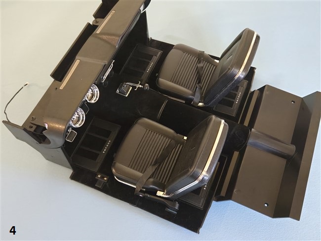

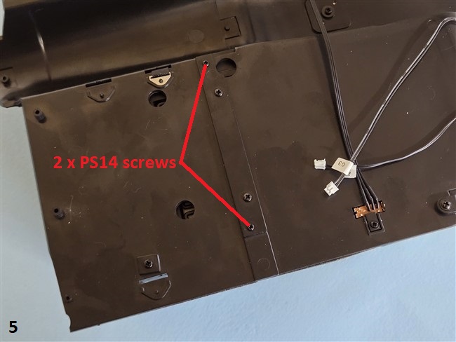

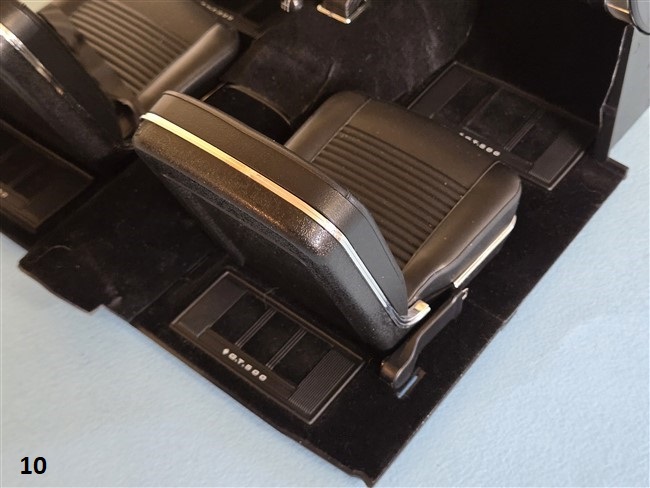

Position the seatbelt out of the way and place the passenger seat into its position, as in Pic 10. Hold the seat in place, turn the floor over and fix the seat in position using 2 x PS14 screws, Pic 11.
That`s all for this update, Pic 12.
(Derek) Admin

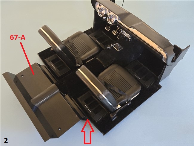

Time to update the Biggun again, this time with Issue 67.
Here we add the rear seat support.

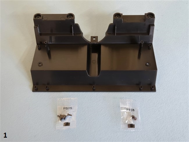

Parts supplied.....Pic1, you will also need the front passenger assembly from the last update.

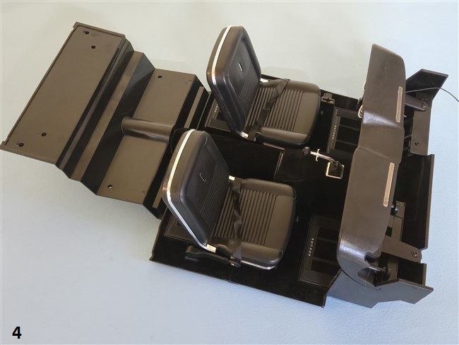

The large panel 67A is added to the assembly from the previous update, as shown in Pic 2.
Carefully turn the parts over and fix them together using 4 x PS25 screws and a single PS08 screw, as shown in Pic 3. That`s all for this update, Pic 4.

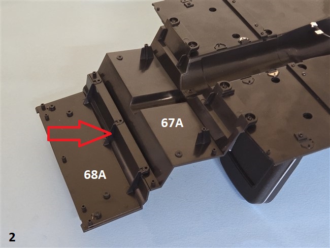

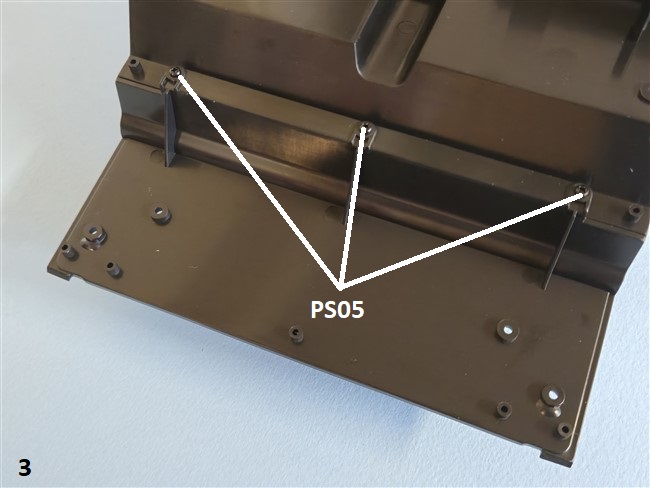

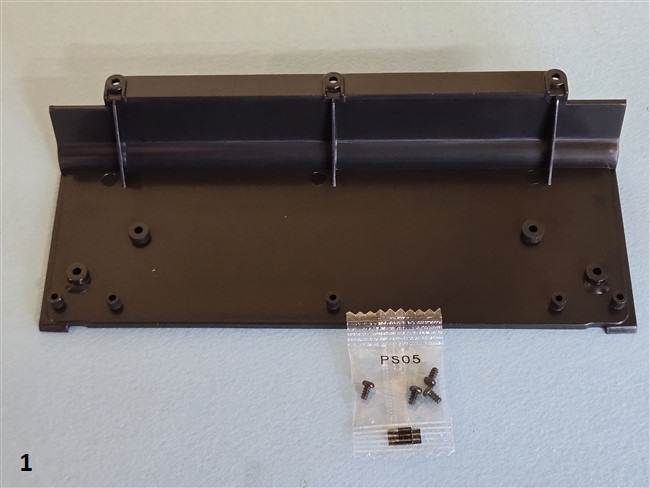

Here we are with the last update for this pack, Issue 68.
Parts supplied.....Pic 1, you will also need the assembly from the last update.
Start with the assembly from the last update and place it upside down on the table. Then add the part 68A as shown in Pic 2.
Secure the floor panel in place, using 3 x PS05 screws, as indicated in Pic 3. That`s all for this issue and pack, with the final assembly shown in Pic 4.
