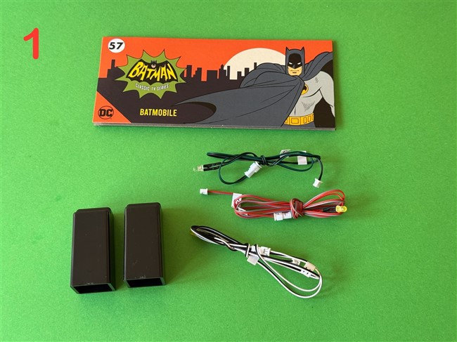

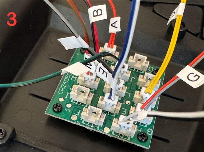

#1 Posted : 11 February 2025 10:46:01
Issue 57
Picture 1 shows the parts for this issue.

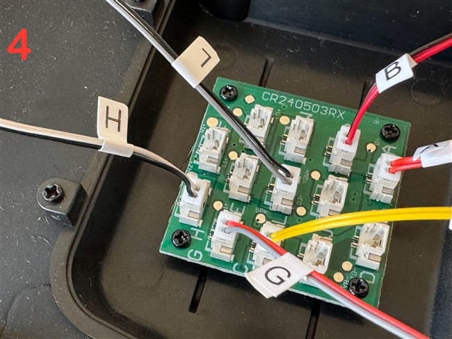

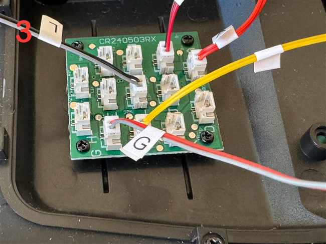

Connecting the Cables
Take the front turn left signal LED, (57B) which is labelled “G”, picture 2 and connect it to the “G” socket as shown in picture 3. Next, take the front right turn signal LED (57C) and place it into the “H” socket, picture 4.
Finally, take the afterburn LED (57A) and place it into the “J” socket, picture 5.

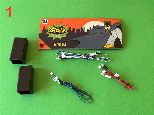

#2 Posted : 12 February 2025 19:56:47
Issue 58

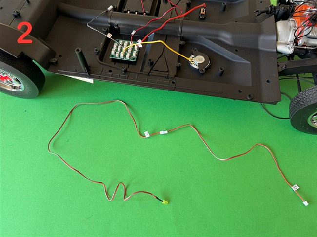

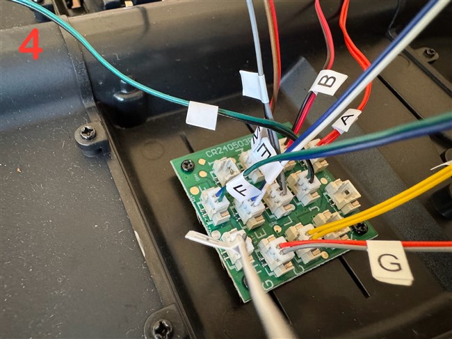

Take the detector scope LED, (58A) which is labelled “M”, and connect it to the “M” socket as shown in picture 2. Next, take the rear left turn signal LED (58B) and place it into the “E” socket, picture 3.
Take the rear right turn signal LED (58C) and place it into the “F” socket, picture 4.

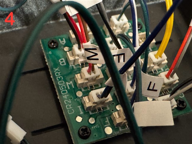

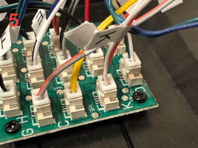

#3 Posted : 16 February 2025 21:02:33

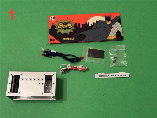

Issue 59

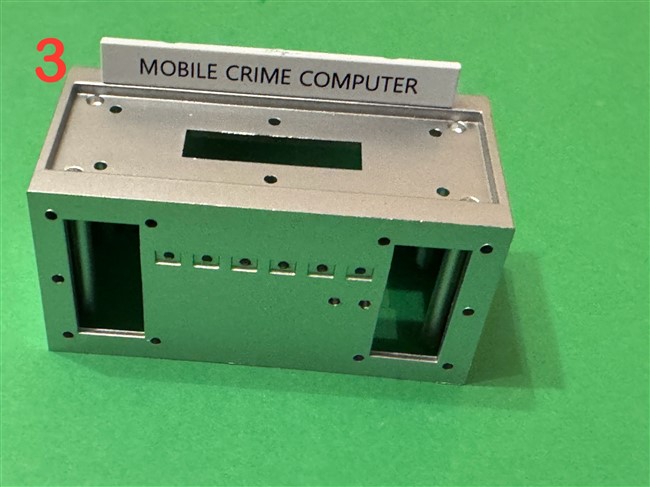

Assembling the Mobile Crime Computer
Take the crime computer sign (59B) and secure it to the computer base (59A) using 2 x AP screws, picture 2 and 3.
Completing the PCB

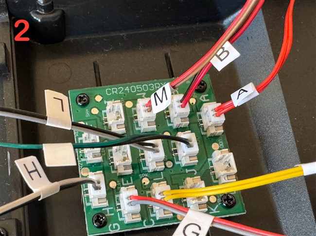

Take the rear LED (59C) and plug it into the PCB slot “I”, picture 4. Now plug the instrument light (59D) into the “K” slot, picture 5.
Securing the Cables
Secure the cables using 3 of the stickers provided.

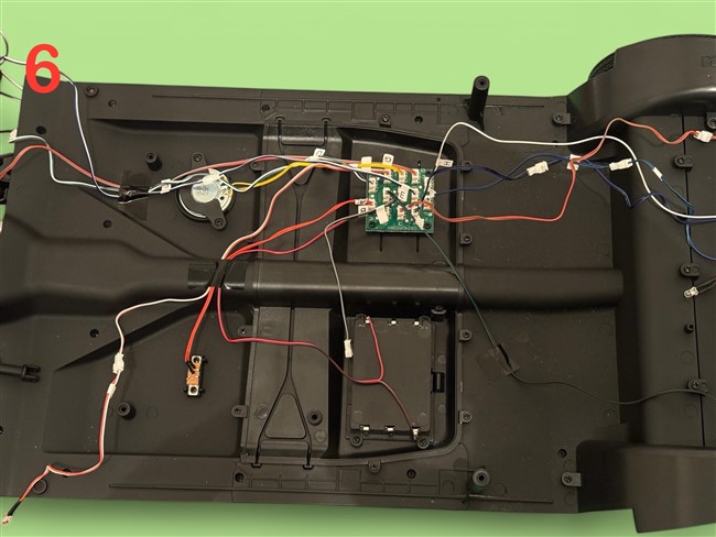

The best way to sort them out is to have all the front cables, stuck with one sticker, which is placed next to the speaker. The wires are as follows:
M-Detector Scope
D-Right Headlight
F-Right Turn Signal
D-Left Headlight
E-Left Turn Signal
K-Instrument LED
The switch and power cable are stuck down together.

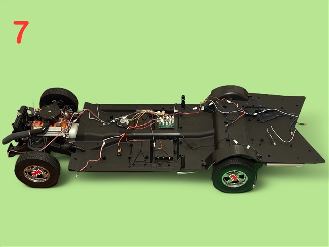

The Rear Lights are as follows:
H-Right Turn Signal
I-Rear Lights and Brake Lights
G-Left Turn Signal
J-Afterburn LED
L-Beacon Light
The easiest way to organise the lights in the right order is to insert 3 x AAA batteries in the battery compartment and a CR2032 battery in the remote control. Flick the switch on the underside to the ON position and test the remote control, pressing the buttons to make sure all the lights are working. This will also help ascertain the position of the wires and lights. Pictures 6 and 7 shows the wiring in their organised position.

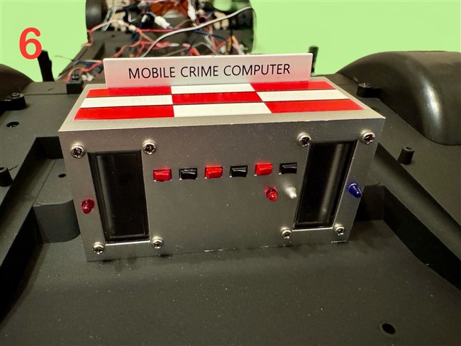

#4 Posted : 17 February 2025 23:29:52
Issue 60

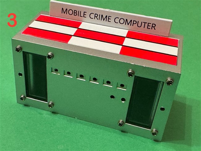

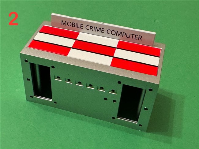

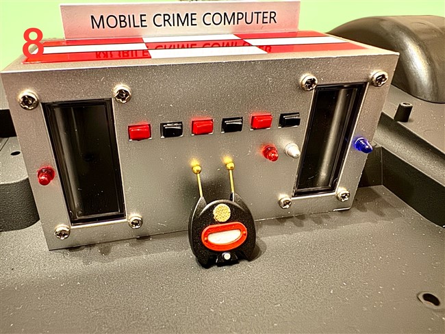

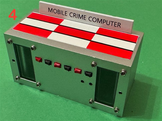

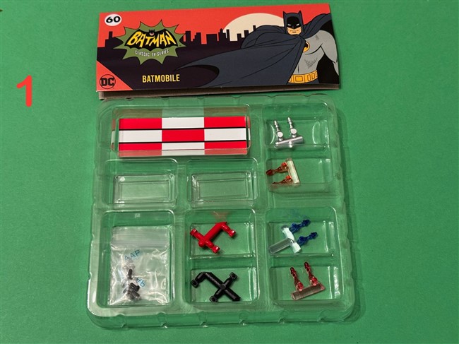

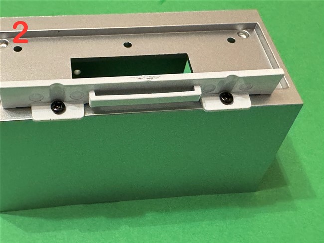

Take the red and white computer screen (60F) and push fit it into the top of the mobile crime computer body, picture 2.
Use 8 x AAP screws to attach the two computer windows (60A) to the front as shown in picture 3.

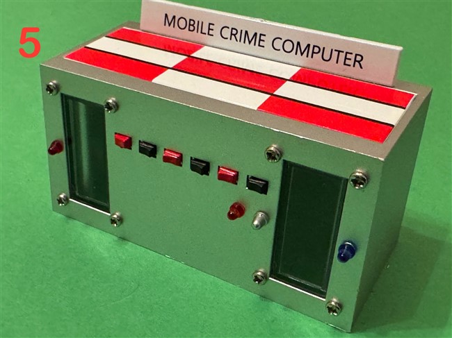

Carefully remove the six computer switches (60G) from their sprues and push the pins on the back of the switches in place on the front of the computer body. Place the switches in alternate colours starting with the red on the far right and black on the far left, picture 4.
Remove the different coloured knobs from their sprues and push them in place in the holes on the front of the computer body. The colour sequence is, from the left red, orange, silver and blue as shown in picture 5.

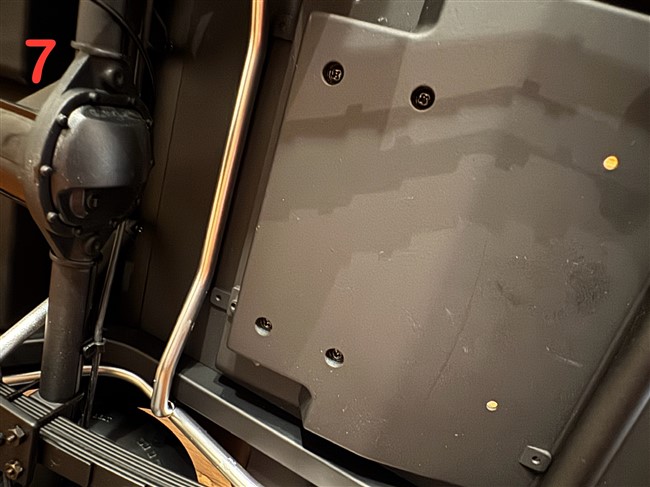

Take the assembly and fix it to the rear floor pan, placing it over the four posts. Turn the whole assembly over and secure the crime computer using 4 x AP screws, pictures 6 and 7.
Picture 8 shows the complete assembly for this issue, complete with my Bat Radio I made for this kit.

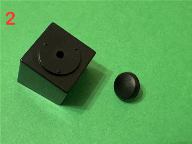

#5 Posted : 18 February 2025 21:20:03
Issue 61

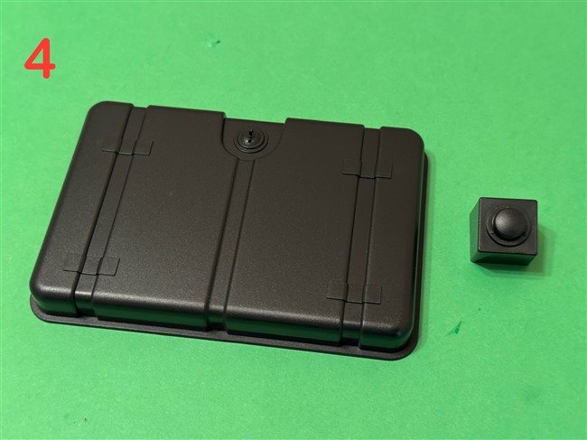

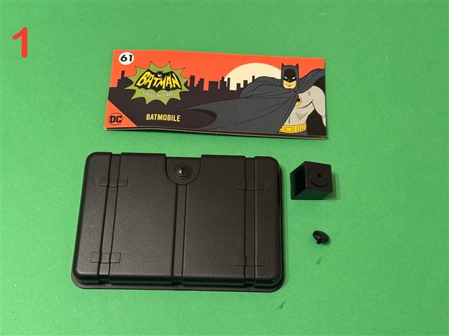

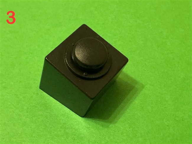

Assembling the Fuel Tank
Take the fuel filler cap (61C) and with the pin on its reverse side, push it into the tank filler pipe (61B), picture 2 and 3.
Picture 4 shows the assembly for this issue.

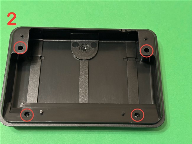

#6 Posted : 18 February 2025 21:21:51

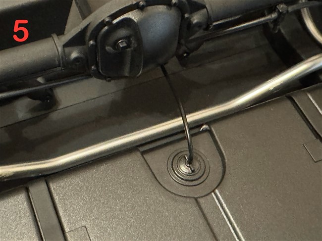

Issue 62

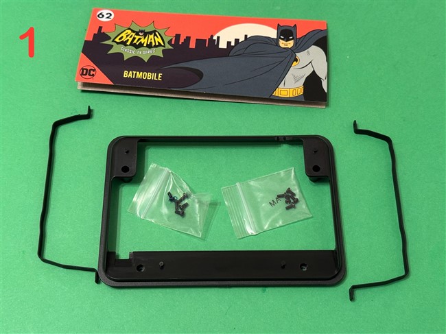

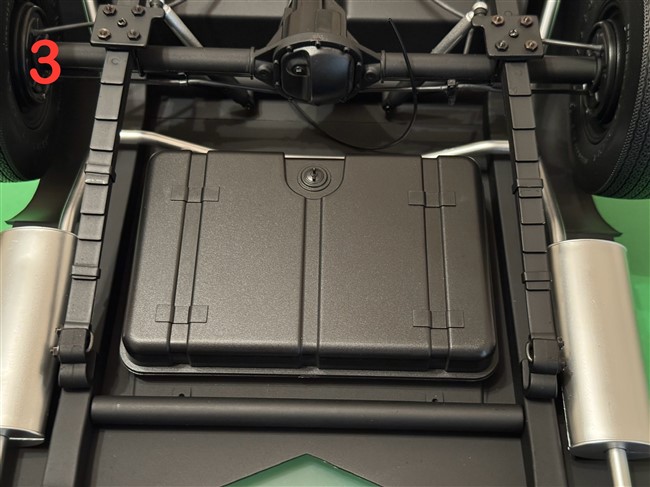

Completing the Fuel Tank

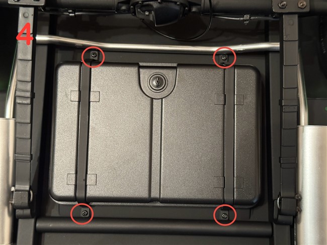

Take the fuel tank bottom from the previous issue and place it on the tank top (62A) and secure it with 4 x AP screws, picture 2.
Retrieve the car assembly and carefully turn it over. Place the fuel tank assembly and place it as shown in picture 3.
Take the two fuel brackets (62B) and mount them as shown in picture 4, securing the fuel tank in place by using 4 x AM screws.
Finally, take the loose end of the fuel line and push fit it to the fuel tank bottom picture 5.
