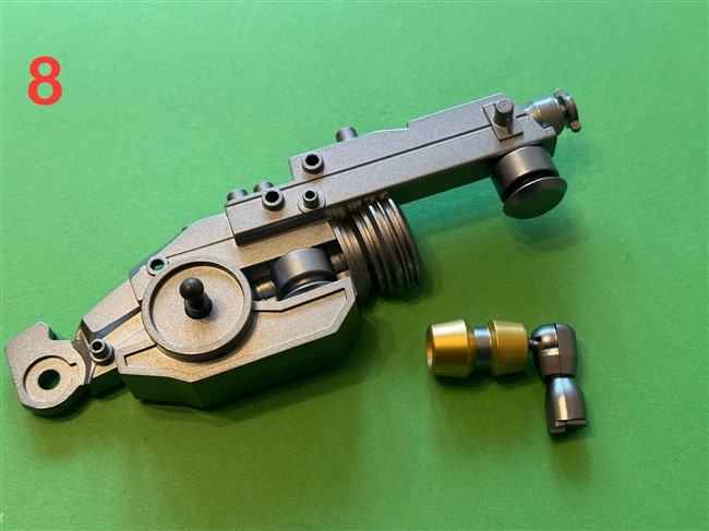

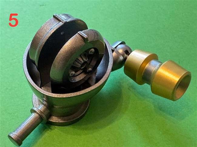

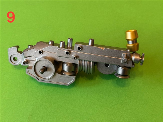

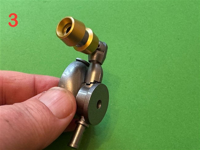

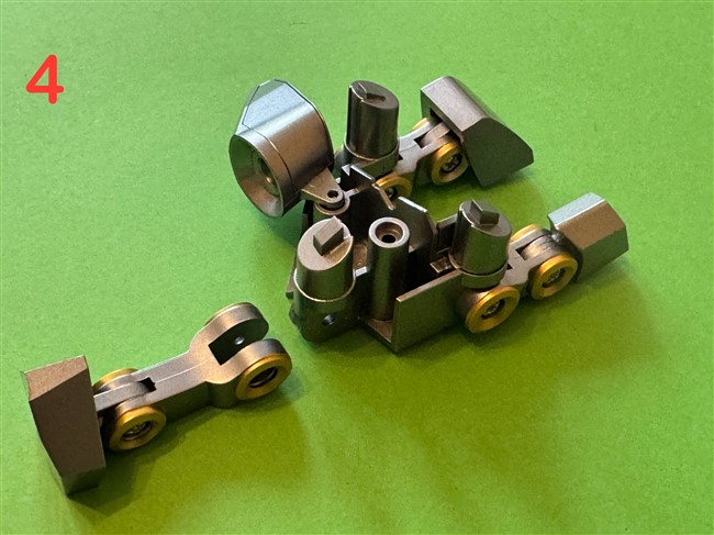

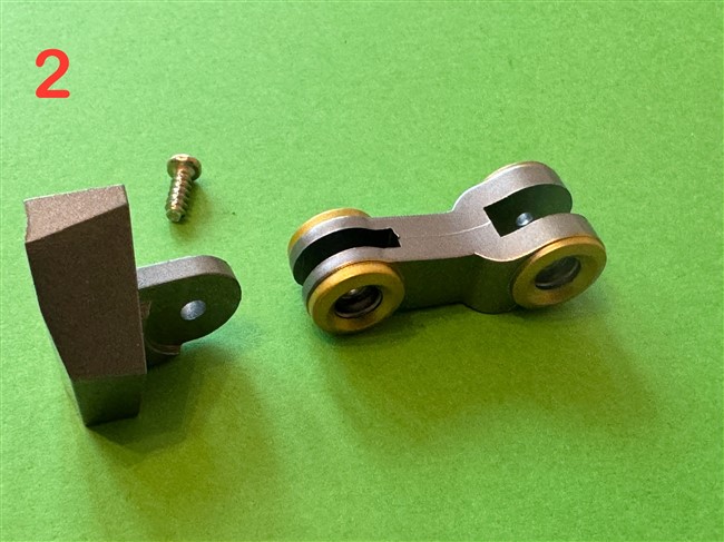

#1 Posted : 18 January 2025 18:21:30
Issue 82

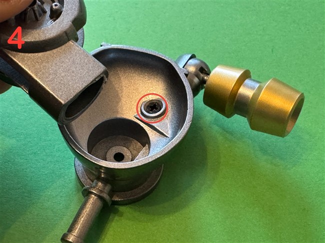

Picture 1 shows the parts for this issue.

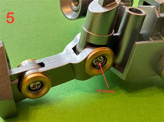

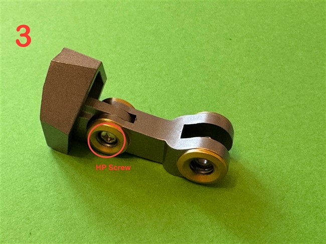

Fit the rear stabilizer from issue 81 into the stabilizer joint (82C) at the narrowest point, and secure with an HP screw, pictures 2 and 3. Now secure the assembly to the assembly from issue 81 and secure the joint with an FP screw, pictures 4 and 5.

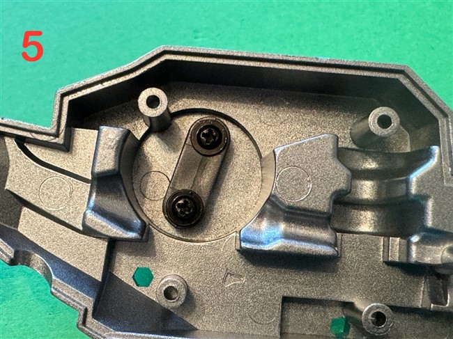

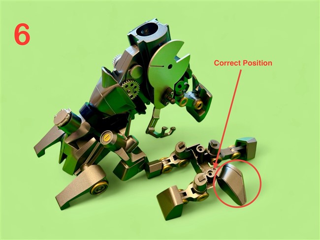

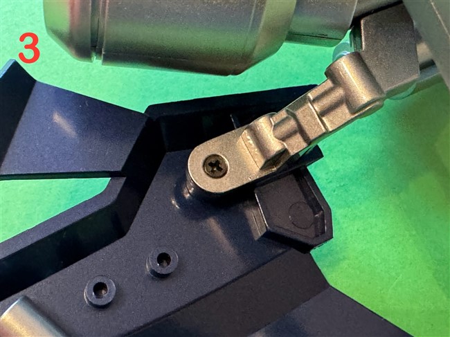

Please Note: In issue 78, I fitted the side turbine, (78E) into the wrong post. Although I show where this was to be secured correctly in picture 6 of issue 78, my eyes must have wandered and secured it into the adjacent post instead.
The next picture 6 shows that I have moved it to its correct position.

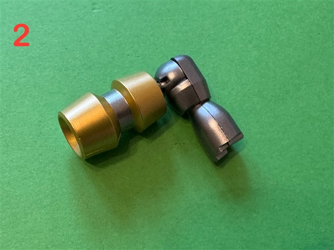

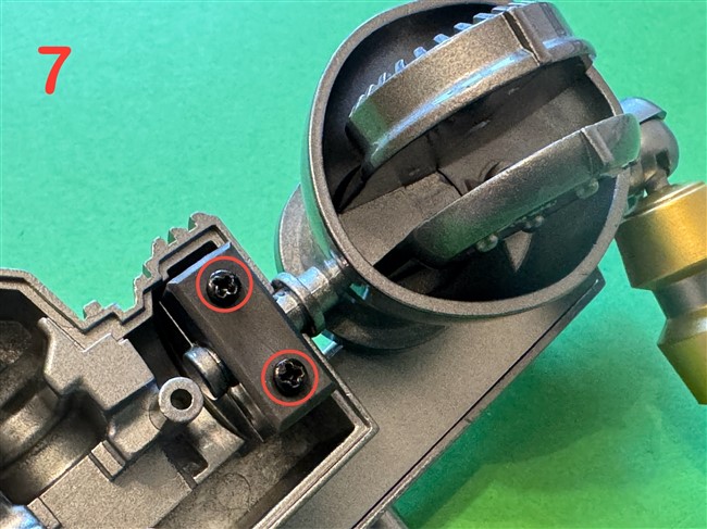

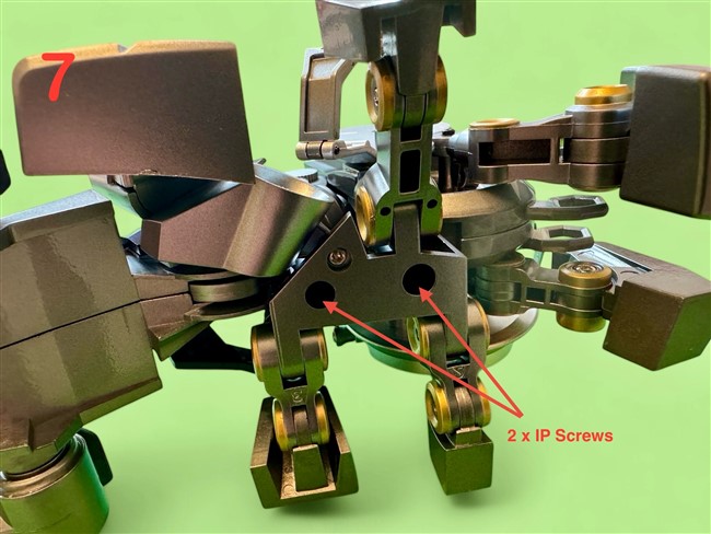

Secure this assembly to the underside of the foot using 2 x IP screws as shown in picture 7.
Snap the upper end of the bridge (82D) onto the top of the foot as shown in picture 8.
Picture 9 shows the complete assembly for this issue.

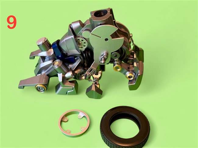

#2 Posted : 19 January 2025 17:06:37
Issue 83

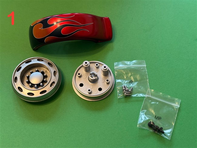

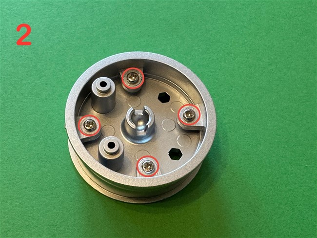

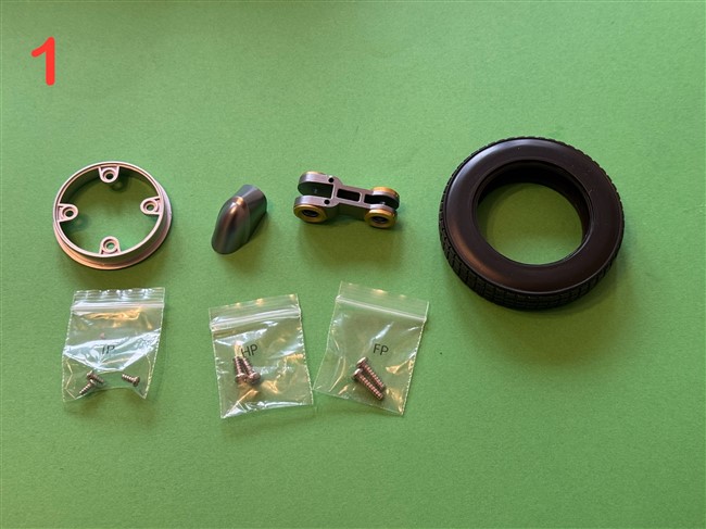

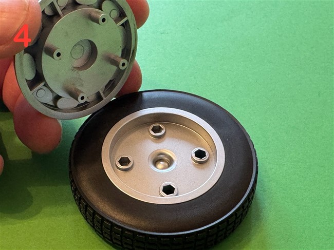

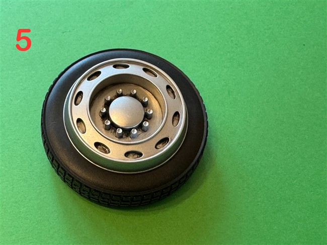

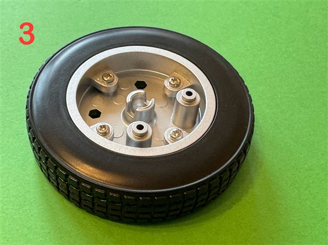

Push together the two parts of the rim (82B) and (83C) and secure them together using 4 x IP screws, picture 2. Fit the rim inside the tyre (82A), picture 3. You may want to warm the tyre up using hot water to make it more pliable to make it fit over the rim easier.
Press fit the hubcap (83C) onto the side of the rim as shown in pictures 4 and 5.

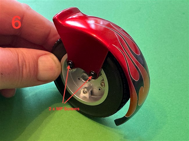

Place the fender (83A) onto the tyre, securing it with 2 x MP screws, picture 6.

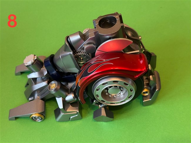

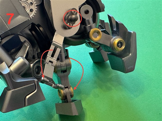

Rotate the two parts down as arrowed in picture 7 and push the wheel assembly onto the ball joint, circled in the same picture.
Picture 8 shows the complete assembly for this issue.

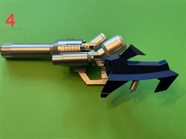

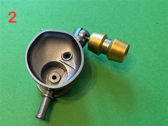

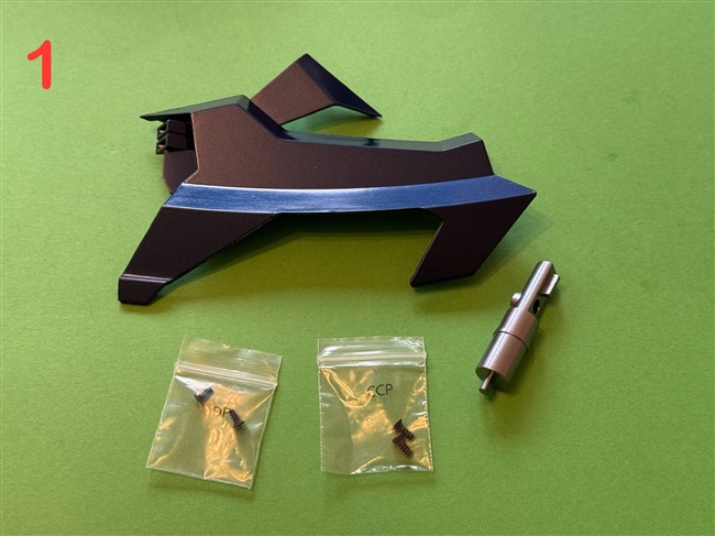

#3 Posted : 20 January 2025 10:34:12
Issue 84

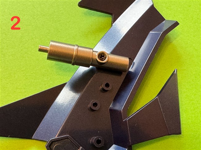

Fit the shield rod (84B) onto the inside face of the shield (84A) and secure it a DP screw, picture 2.
Take the blaster assembly from issue 76 and fit the shield onto the post under the rear tank of the blaster and secure using a CCP screw, picture 3.
Picture 4 shows the complete assembly for this issue.

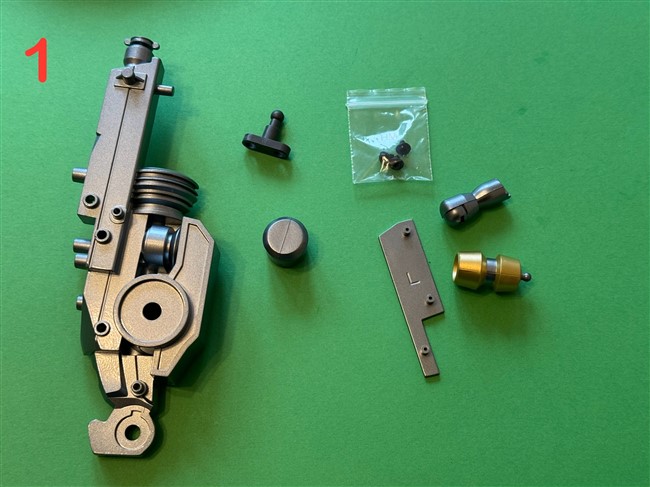

#4 Posted : 21 January 2025 10:42:50
Issue 85
Assembling the Left Leg

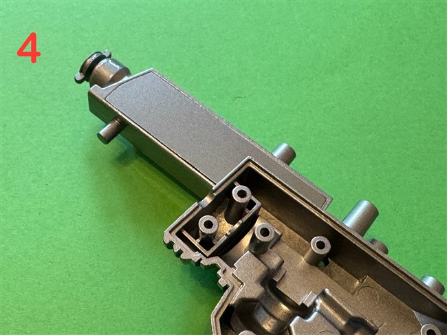

Fit the ball joint of the cylinder (85C) into the cylinder bracket (85E) as shown in pictures 2.

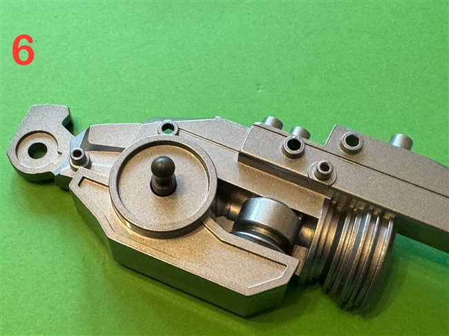

Next, fit the plate (85B) to the thigh structure (85A) as shown in pictures 3 and 4, push fitting it in place with a little pressure.
Now fit the ball joint (85F) using 2xCM screws, pictures 5 and 6

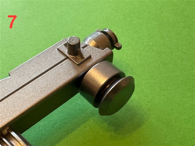

Place the left leg frame detail (85D) on the top pin as shown in picture 7.
Picture 8 shows the final assemble for this issue.

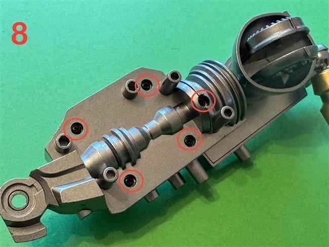

#5 Posted : 25 January 2025 17:53:28
Issue 86

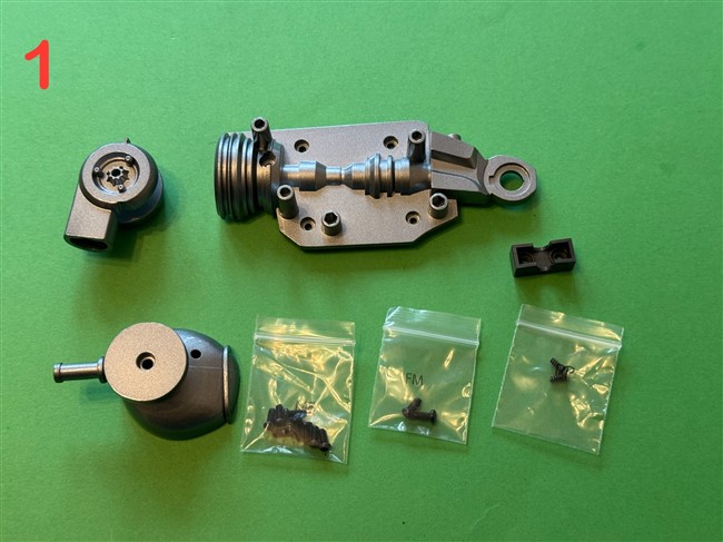

Picture 1. shows the parts with this issue.

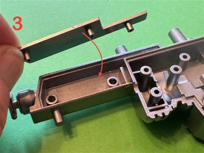

Recover the cylinder from issue 85 and fit to the hip joint (86B) using a PP screw as shown in pictures 2 and 3.
Fit the joint to the assembly (86C) as shown in pictures 4 and 5, securing with an FM screw.

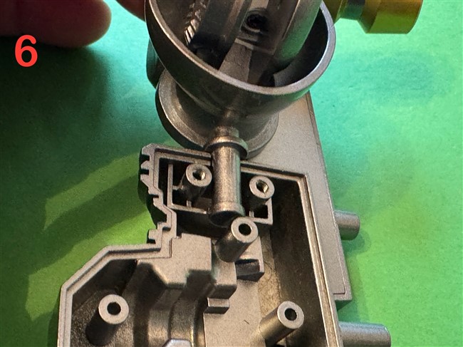

Next fit the joint assembly to the thigh structure as shown in picture 6, noting the orientation of the part. Hold in place a fit the support bracket (86D) over the hip joint that is placed in the thigh and secure with 2 x BM screws, picture 7.
Finally, add the lower thigh plate (86A), as shown in picture 8 and secure with 5 x BM screws seen in picture 9.
Picture 10 shows the final assembly for this issue.
