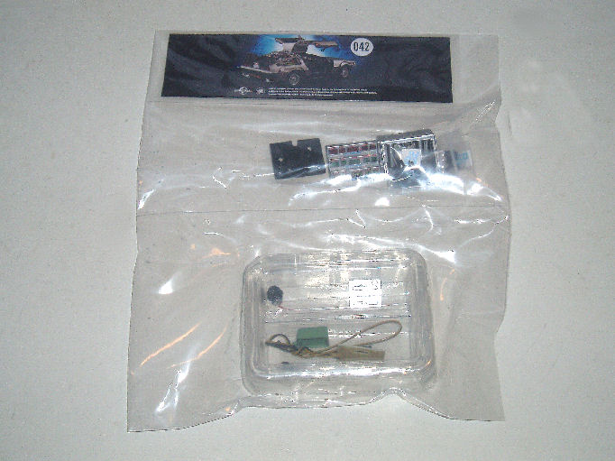

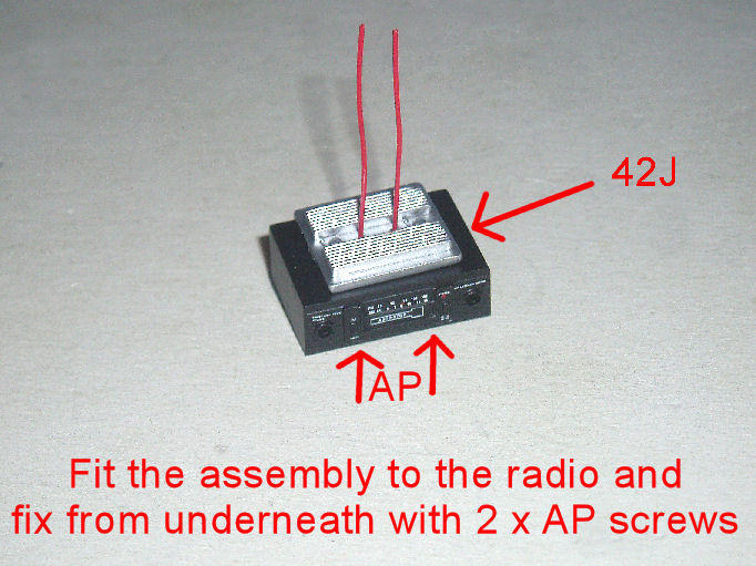

STAGE 42A:
These parts will allow you to assemble the time circuit console.

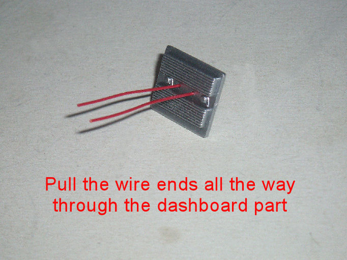

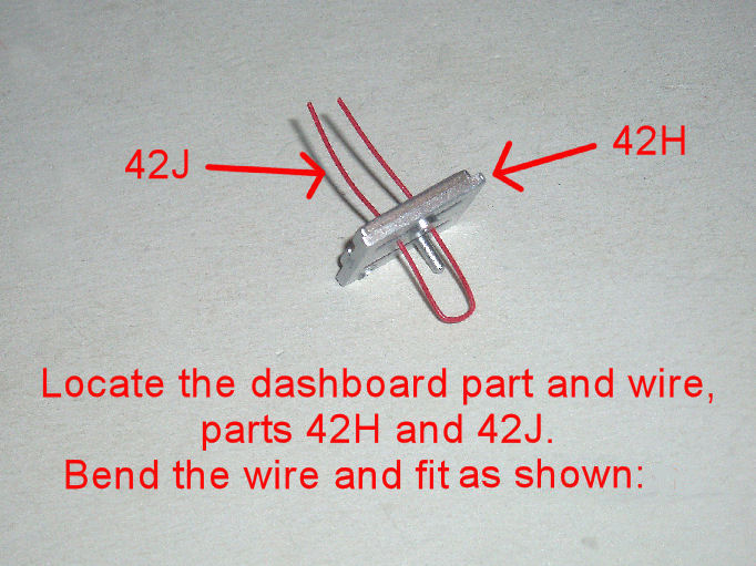

Locate the radio vents and the wire, parts 42H and 42J.
Bend the wire in half and insert the two ends through the holes in the radio vent plate from beneath.
Fit the vent plate to the top of the cassette/radio, part 42J and fix from beneath with 1 x AP screw.

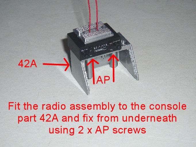

Push the two knobs, parts 42F into the front of the cassette/radio.
Fit the radio to the top of the console, part 42A and fix from beneath with 2 x AP screws.
Press the compass, part 42E into the hole in the top of the console and fix with 1 x AP screw from beneath.

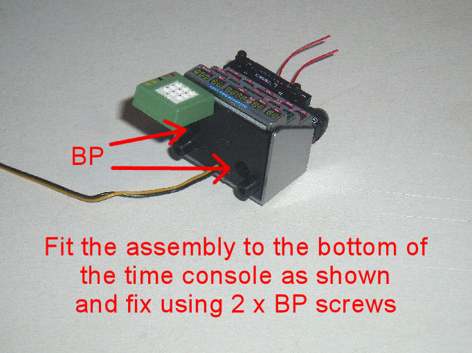

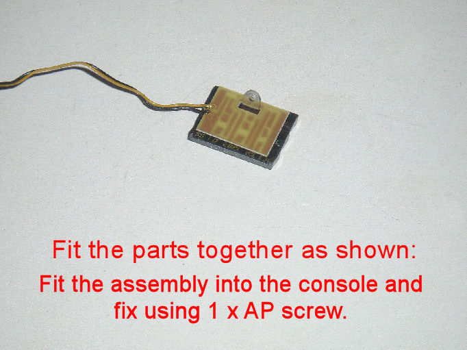

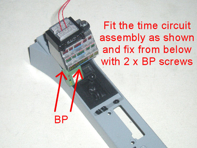

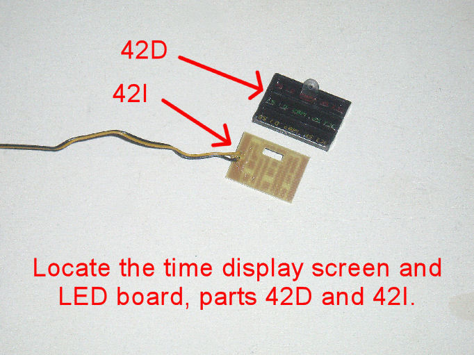

STAGE 42B:
Fit the LED panel, part 42I over the tab on the back of the time circuit display, part 42D.
Fit the assembly into the front of the console, part 42A.

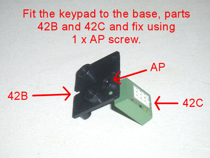

Fit the keypad to the console base, parts 42C and 42B and fix using 1 x AP screw from beneath.
Fit the assembly to the underside of the console and fix using 2 x BP screws.

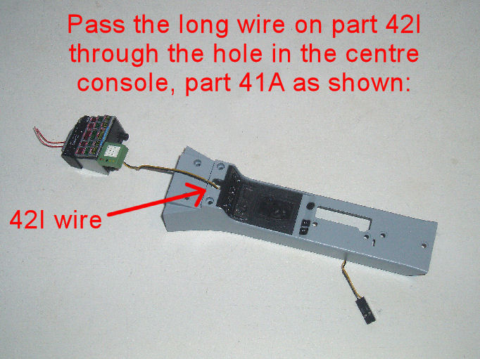

Retrieve the main centre console, part 41A from the previous stage and pass the wire on part 42I through the small hole near the front.
Fit the time circuit console to the top of the main console and fix from below using 2 x BP screws.

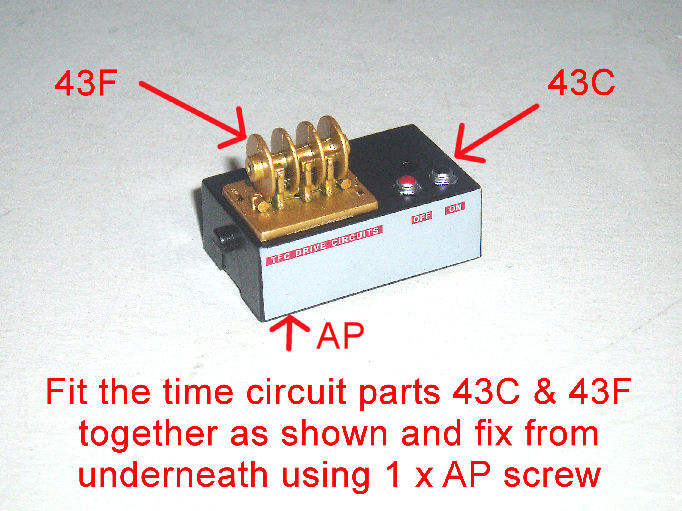

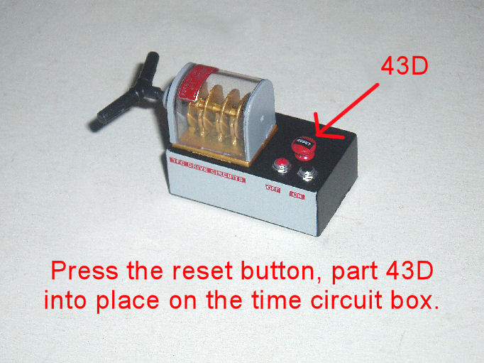

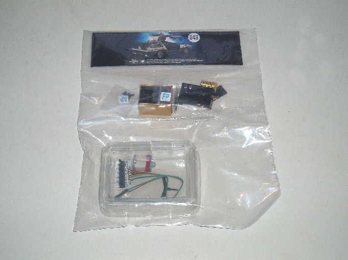

STAGE 43A:
These parts will allow you to assemble more of the time circuits.
Fit the time circuits and box, parts 43F and 43C together and fix from underneath using 1 x AP screw.

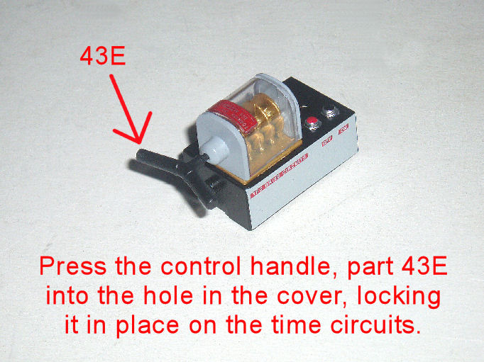

Fit the clear cover, part 43G over the time circuits, part 43F.
Press the control handle, part 43E into the hole in the front of the cover, part 43G which will lock the cover in place.
Press the reset button, part 43D into the hole in the top of the box, part 43C.

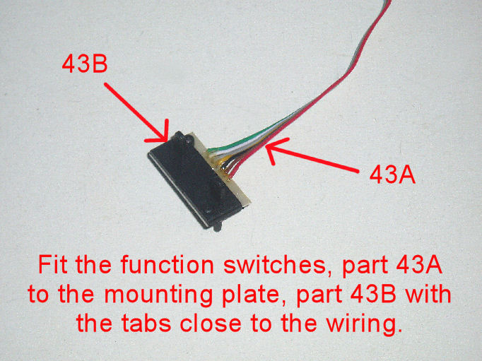

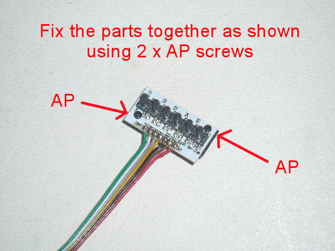

Fit the switch panel and mounting bracket, parts 43A and 43B together, with the tabs on the mounting panel closer to the wiring.
Fix the parts together with 2 x AP screws.

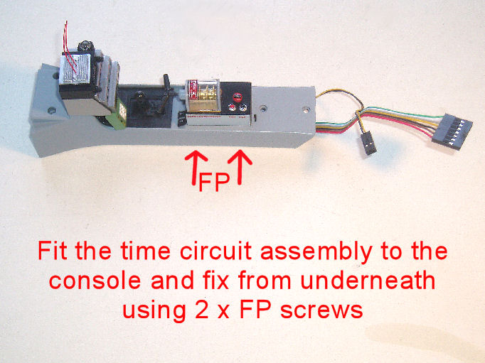

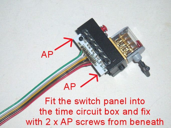

STAGE 43B:
Fit the assembly into the time circuit box, part 43C and fix using 2 x AP screws from underneath.

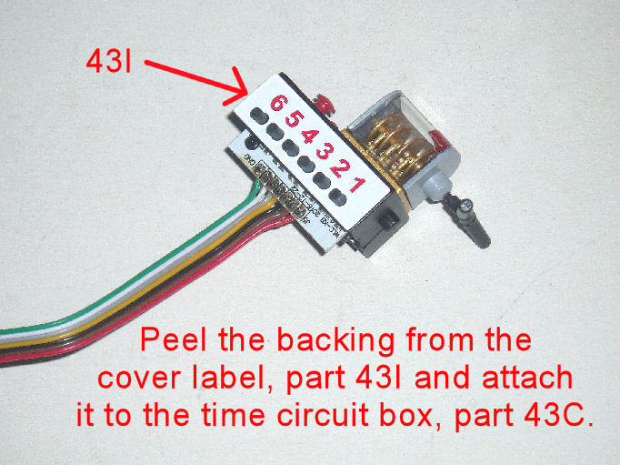

Peel the backing paper from the switch label plate, part 43I and attach it to the switch plate on the time circuit box.

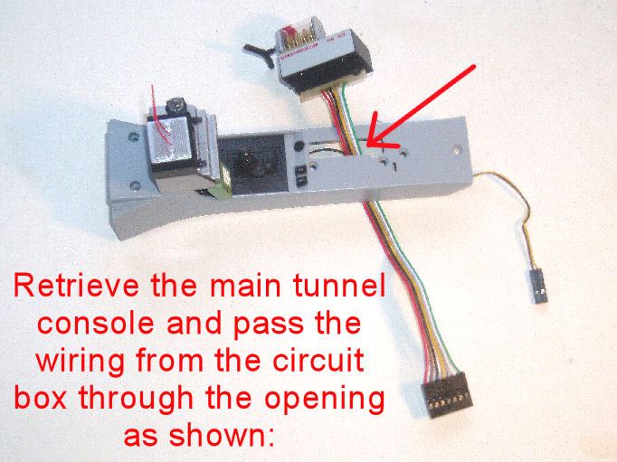

Retrieve the main centre console and fit the wiring from the switches through the rectangular hole in the console.
Attach the time circuit assembly to the console and fix from underneath using 2 x FP screws.

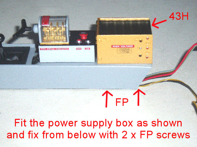

Fit the power unit, part 43H to the end of the console and fix from underneath using 2 x FP screws.
The part will only fit one way.

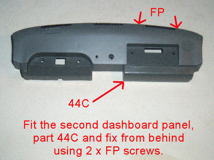

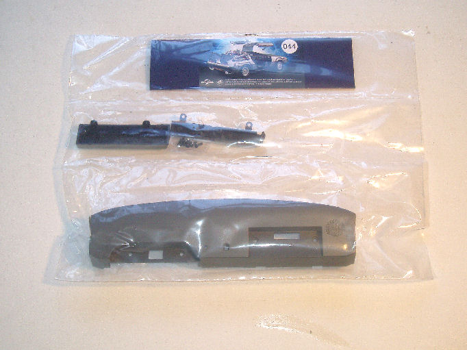

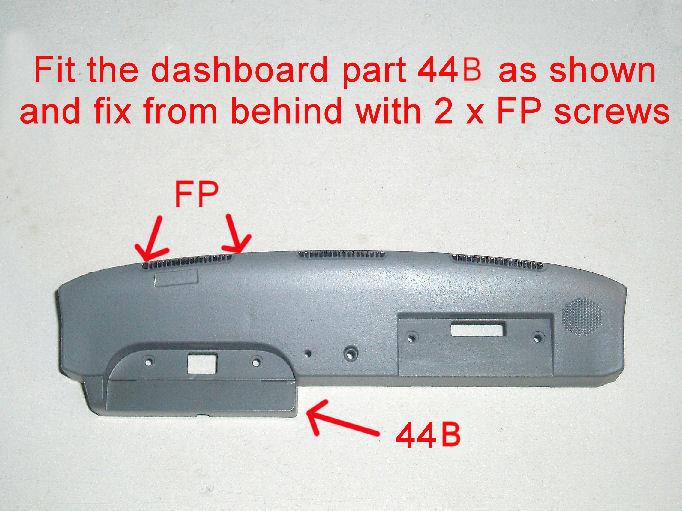

STAGE 44:
These parts will allow you to begin assembling the dashboard.

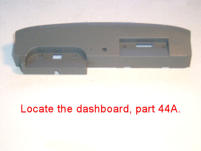

Locate the three dashboard parts, 44A, 44B and 44C.
Fit the ā€˜L’ shaped dashboard part 44B to the left side of the main dashboard, part 44A and fix from behind using 2 x FP screws.
Fit the other dashboard part 44C to the right side of the main dashboard, part 44A and fix from behind using 2 x FP screws.

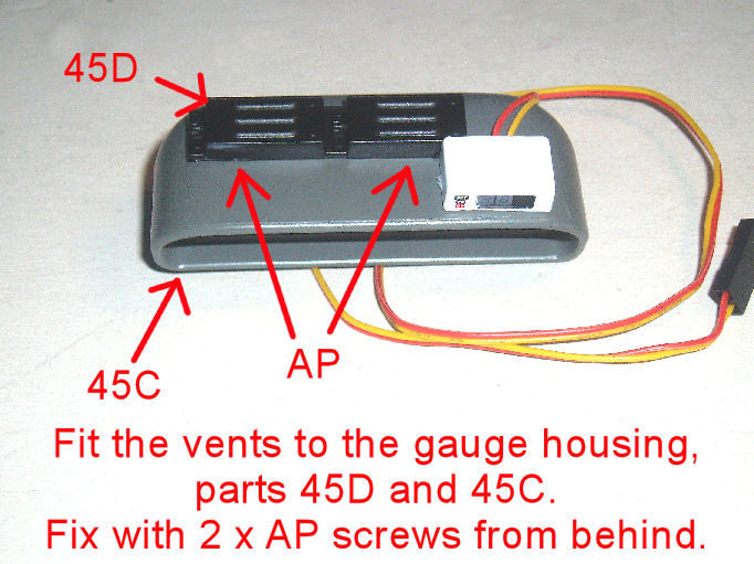

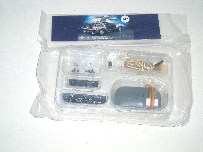

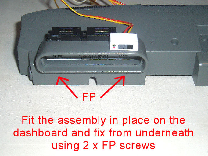

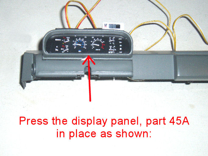

STAGE 45:
These parts will allow you to assemble more of the dashboard.
Fit the vents to the top of the gauge housing, parts 45C and 45D and fix from underneath using 2 x AP screws.

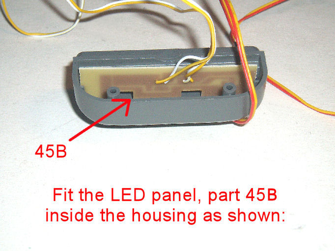

Fit the LED panel, part 45B inside the housing.
It will only fit one way.

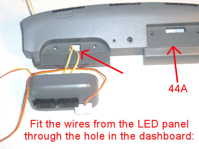

Retrieve the dashboard, part 44A and fit the housing assembly in place, passing the LED wires through the rectangular hole.
Fix using 2 x FP screws from underneath.

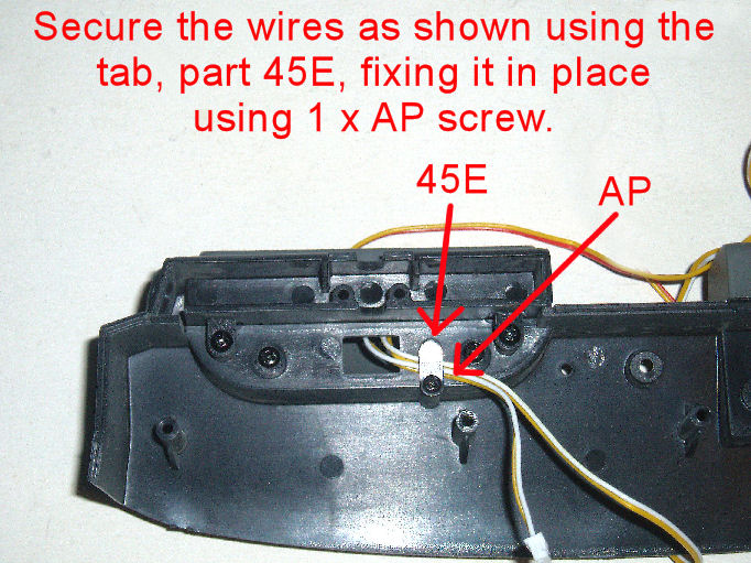

Turn the dashboard over and secure the wires using the small tab, part 45E and secure using 1 x AP screw.
Press the gauge display panel, part 45A into place in the front of the gauge housing.

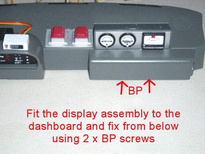

#7 Posted : 08 December 2024 13:35:48
Posts: 5,188
Points: 15,713

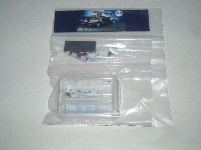

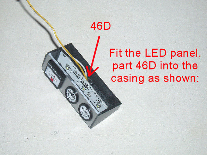

STAGE 46:

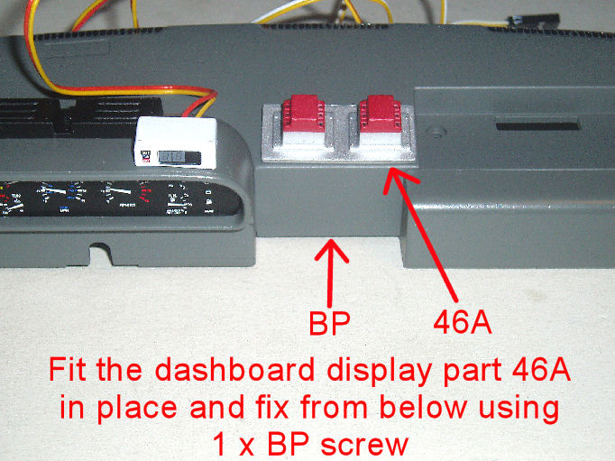

Retrieve the dashboard assembly and locate the display part 46A.
Fit it to the top centre of the dashboard. It will only fit one way.
Fix from underneath using 1 x BP screw.

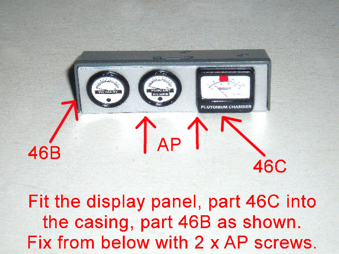

Locate the display panel parts 46B and 46C.
Fit the parts together and fix from inside with 2 x AP screws.

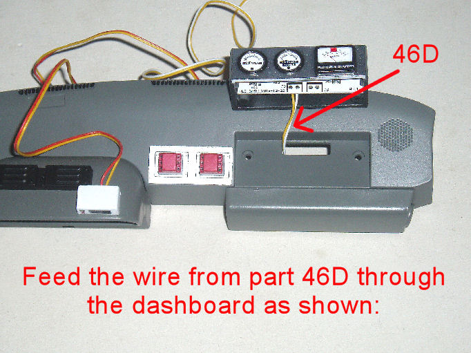

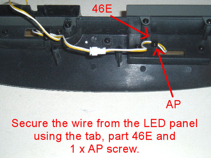

Fit the LED panel, part 46D inside the assembly. It will only fit one way.
Pass the wire from the LED panel, part 46D through the rectangular hole in the top right of the dashboard assembly.
Fit the display housing and panel to the top of the dashboard and fix from below using 2 x BP screw.
From underneath the dashboard, connect the plug and socket from parts 45B and 46D.
Secure the wire from the LED panel, part 46D in place using the small tab, part 46E and 1 x AP screw.
