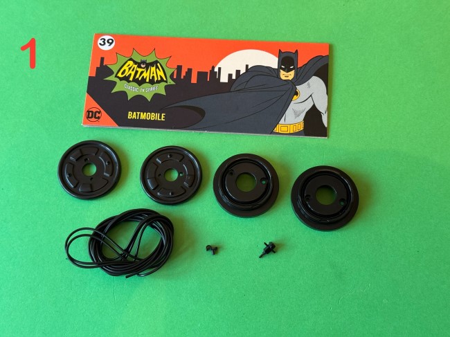

Issue 39
Picture 1 shows the parts for this issue.

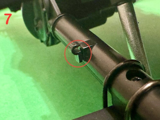

Assembling the Rear Brake Drums and Brake Cables
First cut the Cable (39D) for the brake line into four pieces at set out below.
1 Piece at 50mm
1 Piece at 150mm
3 Pieces at 500mm
Tip: If the cables have lots of kinks in them, particularly the 500mm cables, place them in hot water, NOT boiling, and carefully using your hands, work the cables to remove the kinks.

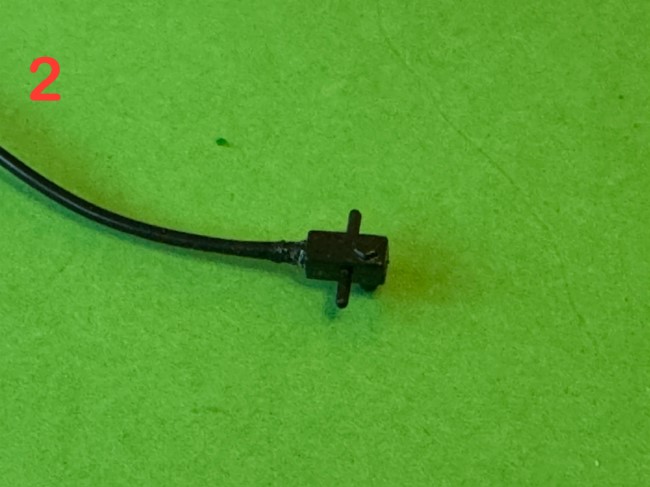

Take the first 500mm cable and place one end onto the brake hose junction (39E), picture 2. Note: I used a little quick drying glue to hold the cables in place, this is purely a personal preference.

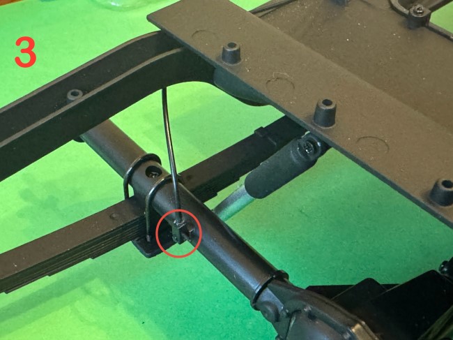

Place the assembly into the pin on the rear axle on the left-hand side, picture 3.

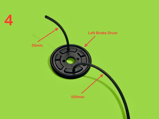

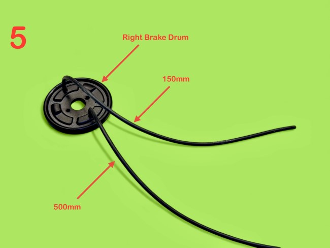

Take the left-hand brake drum (39A), this will have an “L” on the inside of the part and attach the 50mm cable to the top and one of the 500mm cables at the bottom as shown in picture 4. Note the orientation of the brake drum. Next, take the right-hand side brake drum, this has the letter “R” on the inside, and attach the 150mm cable at the top and the last 500mm cable at the bottom. Again, note the orientation of the brake drum, picture 5.

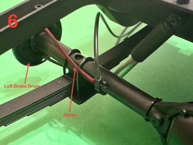

Place the left brake drum onto the onto the rear axle, pushing the two pins into the holes. Next, attach the 50mm cable to the brake hose junction as shown in picture 6.
Push the rear brake line bracket (39F) into the hole on the rear axle as shown in picture 7.

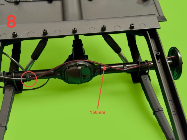

Attach the right-hand brake drum to the right side of the axle in the way as you did with the left side. Take the 150mm cable and feed it through the bracket, over the rear gear box and into the brake hose junction as shown in picture 8.

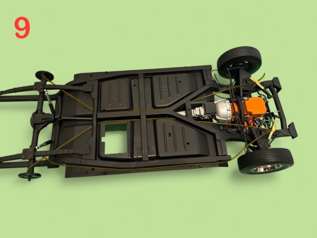

Feed the three 500mm cables through the underside of the floor pan as highlighted in yellow in picture 9. Note: I used some tape to hold the ends of the cables to the assembly.

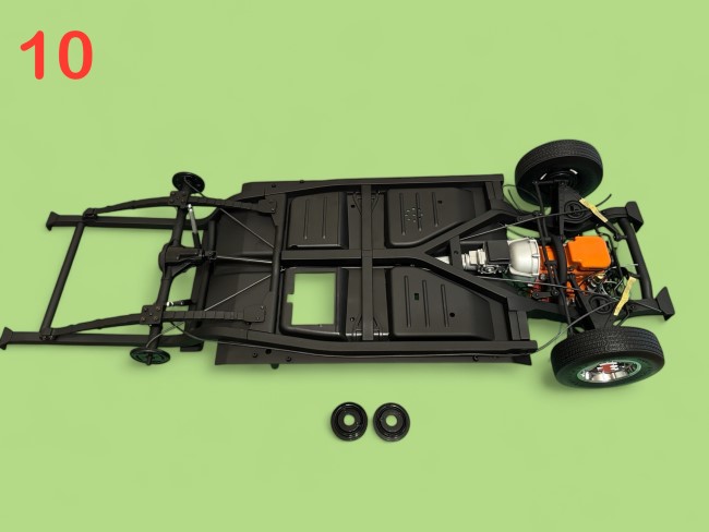

Pictures 10 shows the complete assembly for this issue.

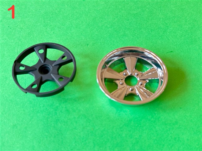

Turn the outer wheel (40A) over so that the inside is facing you, then slot the centre wheel (40B) over the five screw posts, picture 2.

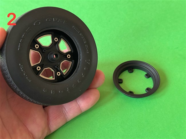

#3 Posted : 27 October 2024 19:28:31
Issue 41

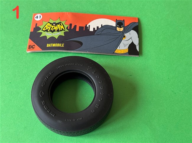

Fitting the Tyre

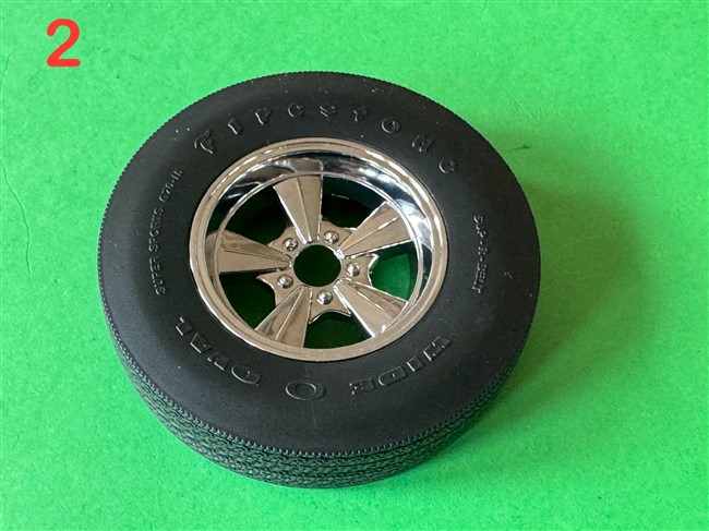

To fit the tyre, simple slot it over the wheel parts from issue 40, picture 2.

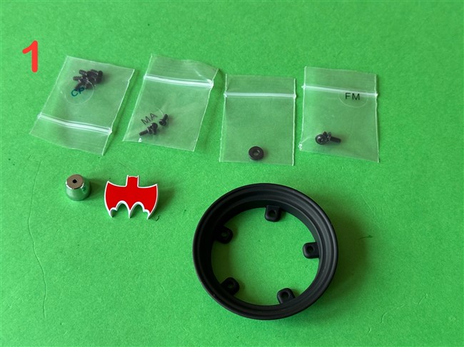

Assembling the Wheel

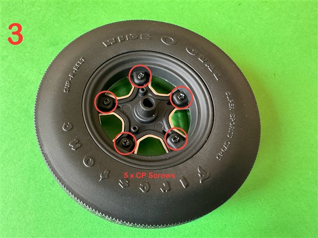

Take the wheel assembly from the previous two issues and push the inner wheel into the centre (42C) lining up the five tabs with the screw holes, picture 2. Secure in place using 5 x CP screws, picture 3.

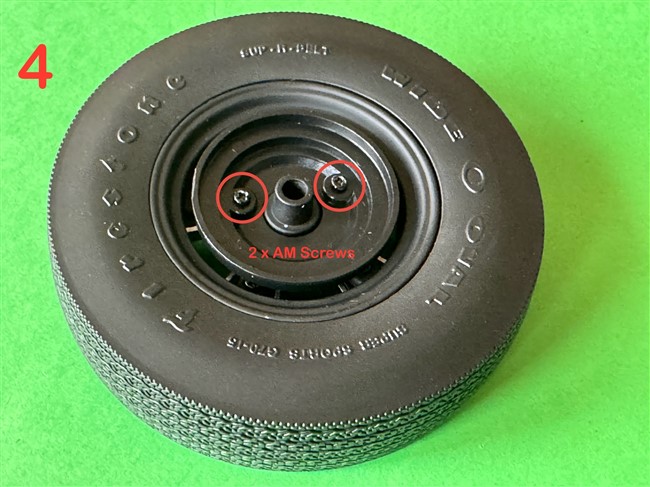

Take one of the backing plates (39C) from issue 39 and secure it to the two posts on the rear of the outer wheel using 2 x AM screws, picture 4.

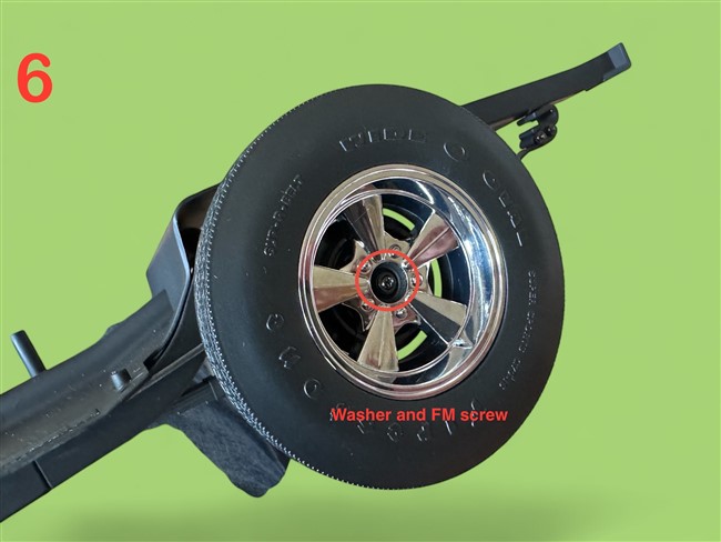

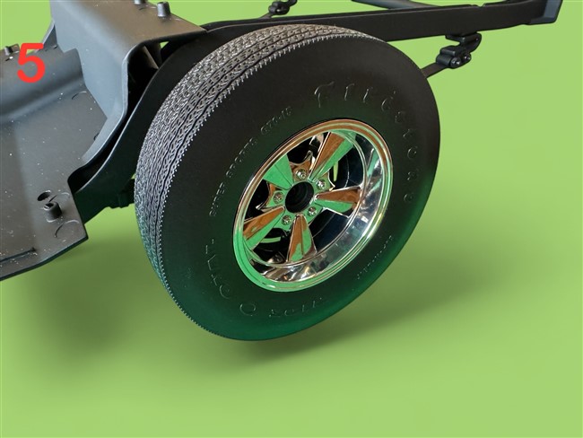

Now place the wheel assembly to the left side of the rear axle, picture 5 and secure it in place using the gasket (42D) and an FM screw, picture 6.

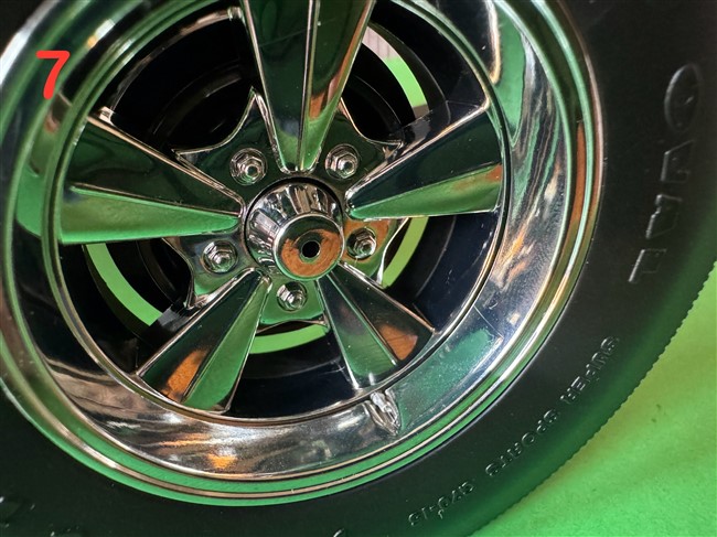

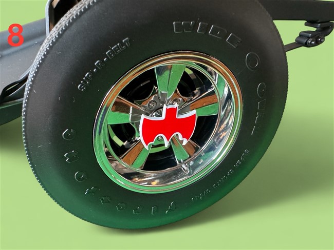

Push fit the centre cap base (42B) into the centre of the wheel, picture 7, followed by the batman cap (42A) into the hole on the centre cap, picture 8.

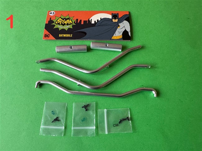

#5 Posted : 29 October 2024 20:18:39
Issue 43
Assembling the Exhaust Pipes

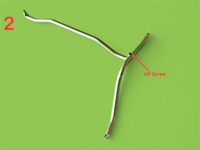

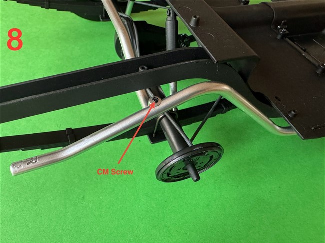

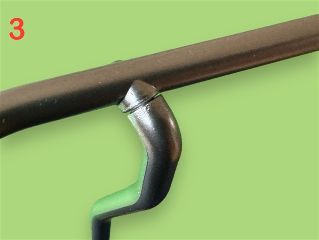

Attach the left exhaust pipe (43A) and secure it to the exhaust pipe frame (43C) using a KP screw, picture 2. Note the connecting parts are angled. Picture 3 shows how it should look when connected. The left and right exhaust pipes also have the letter “L” and “R” on them at the ends.

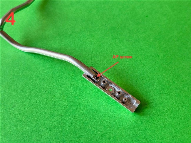

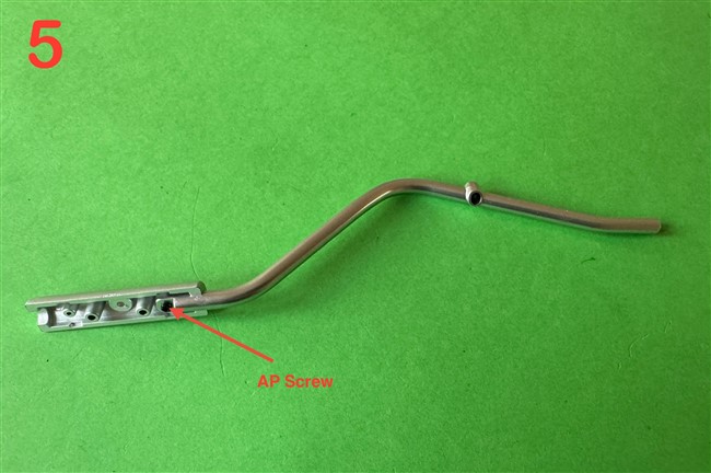

Attach one of the muffler tops (43D) to the exhaust pipe using an AP screw as shown in picture 4. Attach the other muffler top to the right exhaust pipe (43B) in the same way, picture 5.

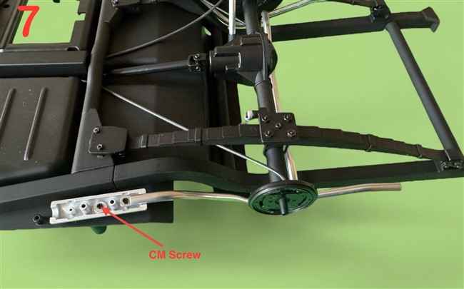

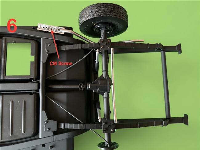

Feed the left exhaust assembly through the rear of the vehicle as shown in picture 6, attaching the muffler to the floor pan with a CM screw. Next, attach the right-hand exhaust pipe in the same way by securing the muffler to the floor pan with a CM screw, picture 7.
Turn the whole model assembly over and attach the right-hand exhaust pipe to the exhaust pipe frame using a KP screw, picture 8.

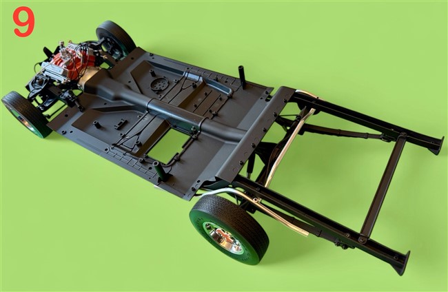

Picture 9 shows the complete assembly for this stage.

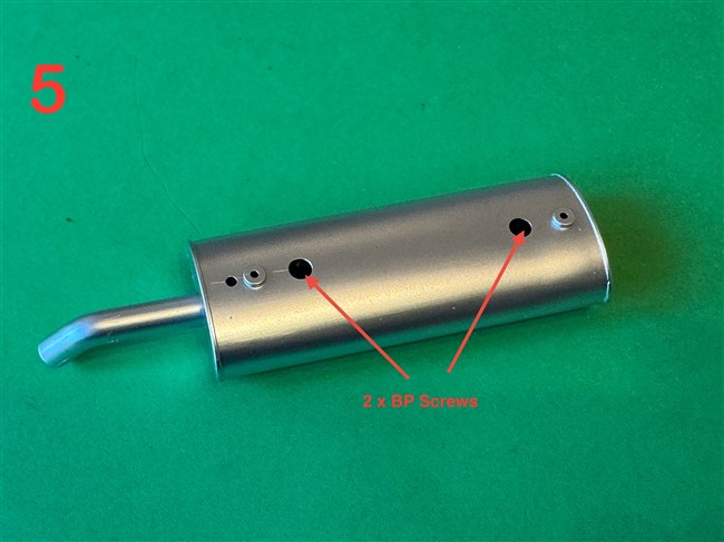

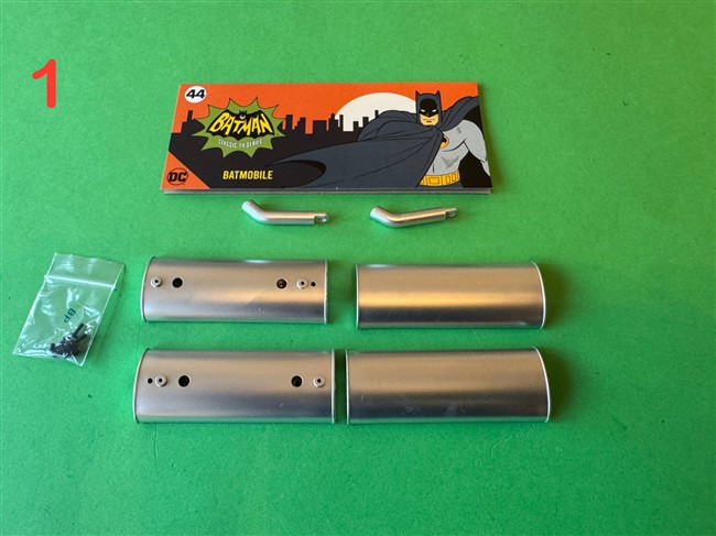

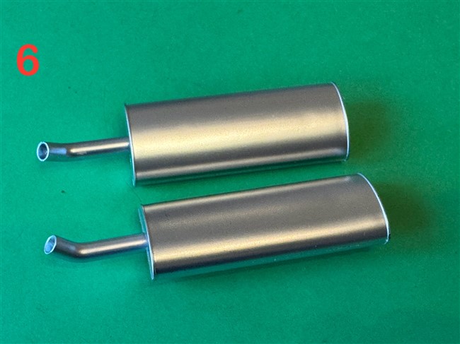

#6 Posted : 30 October 2024 20:29:20
Issue 44
Assembling the Exhaust Resonators

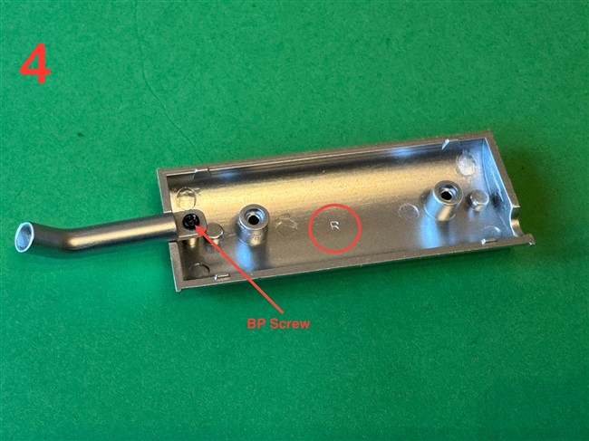

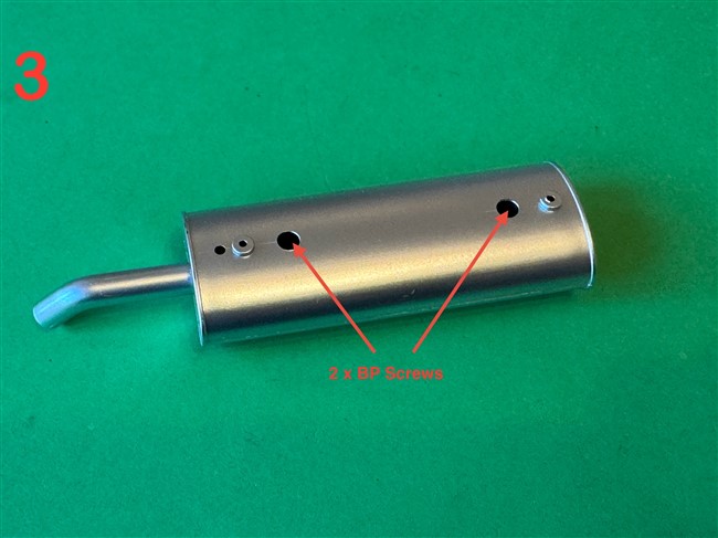

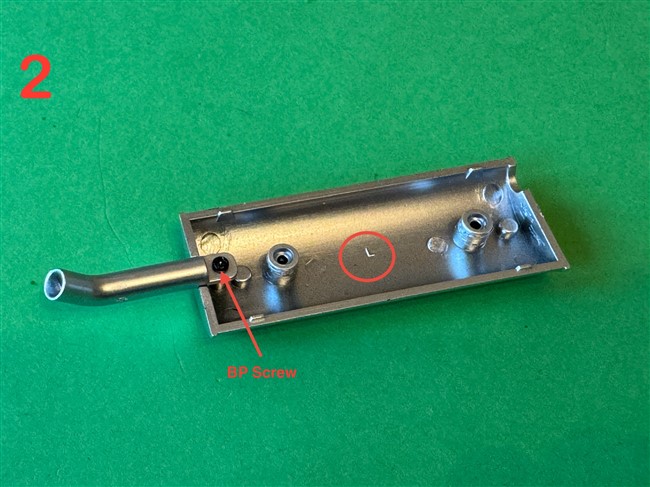

Take the left resonator (44A) and using a BP screw attach one of the tailpipes (44E) as shown in picture 2. Note the left and right resonators have an “L” and “R” placed on the inside of the part.
Take the cover for the left resonator (44C) and secure it in place using 2 x BP screws, picture 3.
Do the same with the right resonator as shown in pictures 4 and 5.
Picture 6 shows the complete assembly for this stage.
