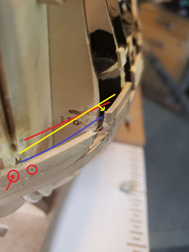

Hi John,Blink
I downloaded the original pic that appeared and have studied it. Now I`m no master model ship builder, so I cordially invite some of our much more experienced builders to pitch in and help John out. That said from my limited experience, what I see is a fairing error. Rib 11 has been over faired, hence the planks are not touching it. I will be looking for some diagrams to explain fairing for you, so don`t do anything for now until we can get you the best possible advise.
I have attached an edited form of your original Pic and these are my observations for anyone else to comment on.
Your fairing seems to be following the Red line, hence the plank does not touch rib 11. The yellow is nearer to where the plank should be going, but rib 11 will need packing out. The Blue line is nearer the mark as best as I can show on a Pic.
Now a question for you.
In the small Red circle, is that the pin holding the plank in place. It should be nearer to where the circle with the arrow is.
Now the rule of fairing as I remember it is as follows: The full width of the plank, should be in full contact with the width of the rib. I am going to endeavour to find some schematic drawings of what I mean, so for now just hold fire and we will see what we can find to help. Its not beyond redemption, so don`t panic.
(Derek) Admin

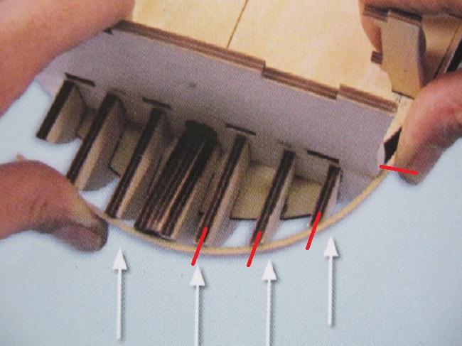

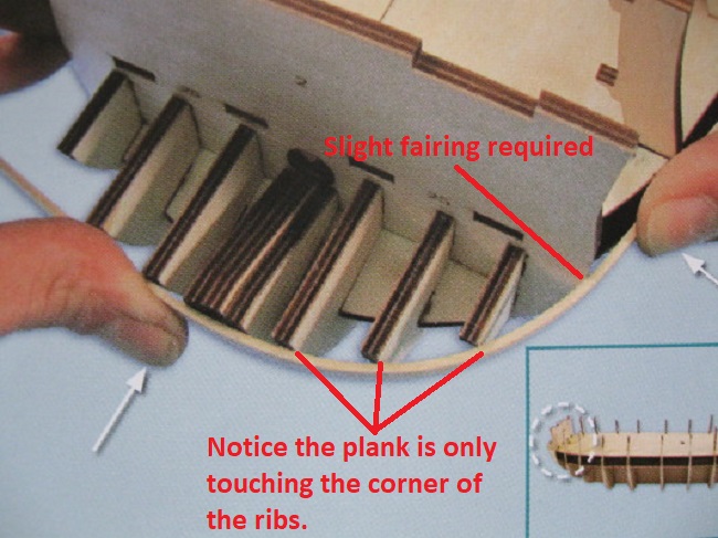

I have found a couple of pics on the forum that should explain fairing of the ribs a little better.
The first shows how the plank sits on the ribs without fairing. Note there is very limited contact to the ribs.
The second shows the ribs properly faired, so the plank is in full contact with the ribs. The RED lines indicate the angle of the pins so they attach to the meat of the rib in each instance.
You need to check the full length of each plank and move a test plank up and down the ribs as fairing is different for each plank across each rib. Watching the contact point on each rib shows how much fairing is needed.
Hope this helps.

I see what you are talking about. I think I'll go ahead and remove the rest of the bow planks and start over. Hopefully I can reuse the planks and rebend slightly. I'll also pack rib 11 back out with some putty, cardstock etc.
Once the glue is dried, I've been taking the pins out. What you see there is the pin hole itself.
Thanks,
--John
#24 Posted : 07 July 2024 21:17:29
Thanks,
--John
Hi John, BigGrin
Its very difficult to show how this should be done, but I`m sure you will get there if you understand what I`ve said so far. As for packing, I personally would not use putty, because as you press and pin against it, it will crumble and fall out. (Back to square one). The best would be thin strip wood in layers if needed to build up the widest points.
Take care and plan ahead. When the fairing is correct the pinning becomes easier as you are pinning into solid wood, not through it at a bad angle.
(Derek) Admin
