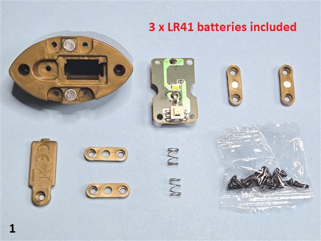

Here we go with the update for Issue 74, where we will complete the Soul Stone.

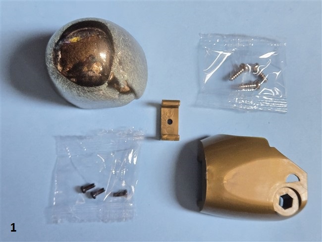

Parts supplied.....Pic 1. You will also need the parts supplied in Issue 73 and the main model on the stand.

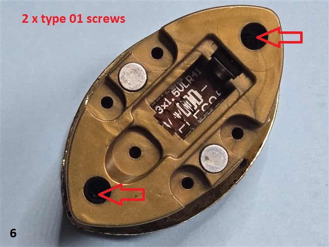

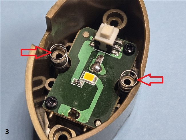

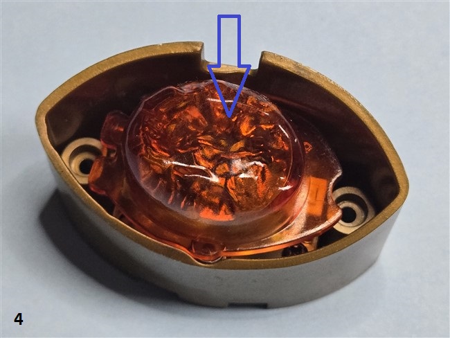

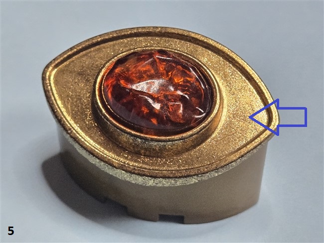

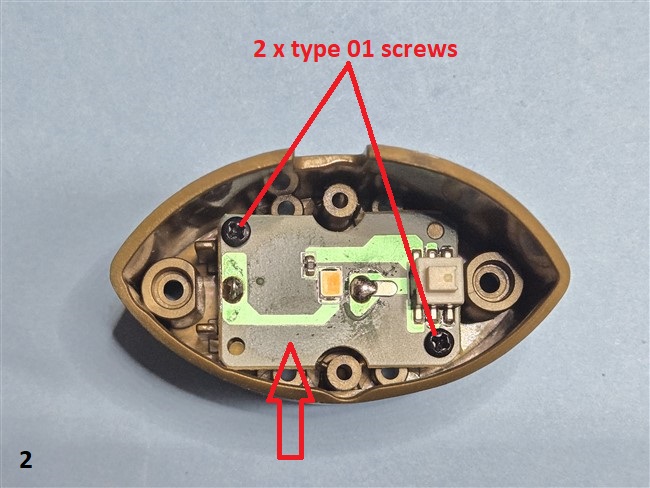

Start by placing the circuit board ELEC 05 inside the part B74 and fix it in position using 2 x type 01 screws, Pic 2. Then place a spring over the two posts as shown in Pic 3. Next place the coloured lens B05 (from issue 73), inside the assembly using the orientation shown in Pic 4. Then place the cover A88 (also from issue 73) over the lens, Pic 5. Now whilst holding the parts together, turn the assembly over and fix it together using 2 x type 01 screws, Pic 6.

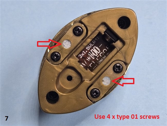

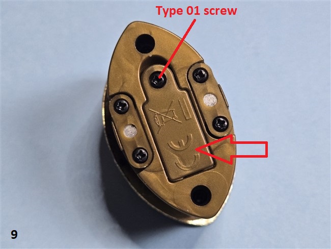

Its now time to fit the 3 x LR41 batteries (supplied) and it should be noted that the + side of each cell should be nearest the spring end of the holder. Pic 8. With the batteries in place, fit the battery retainer D01 over the batteries and fix it in place using a type 01 screw, Pic 9.

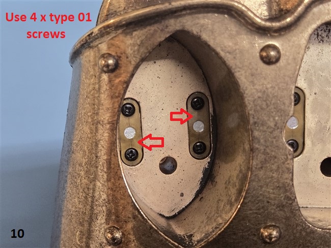

With the Soul Stone completed, fit the two parts D02 (with magnets) inside the left hand aperture and fix them using 4 x type 01 screws, as in Pic 10.

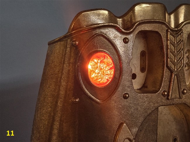

You can now position the Soul Stone in place and test the light by pressing the stone. Pic 11.

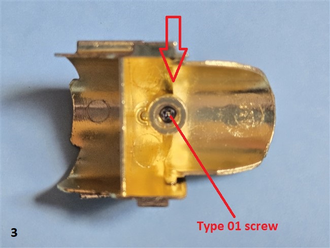

Not much to do here. Take the parts A36 and A37 as shown in Pic 2. Then place A36 inside A37 by lowering directly from above and fix it in place using a type 01 screw, Pic 3.

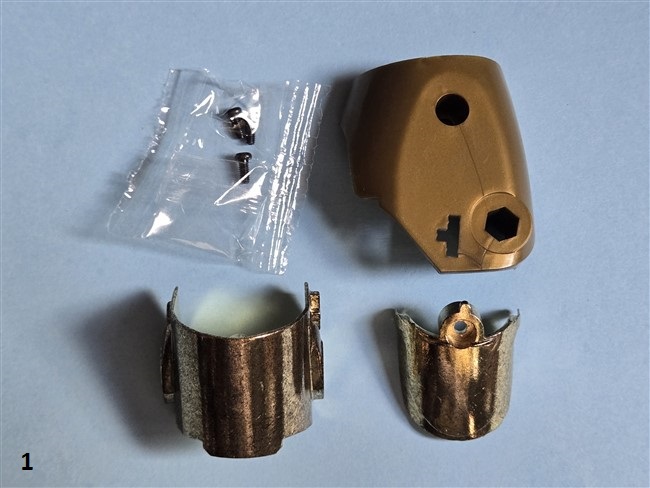

Parts supplied.....Pic 1, you will also need the assembly from issue 75 and the unused part C30 from the same issue.

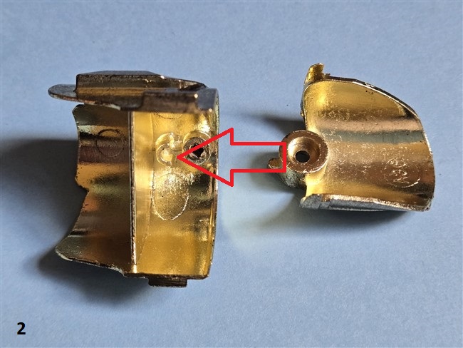

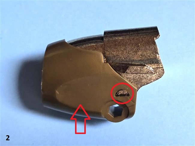

To start, take the assembly from issue 75 and position part C31 onto its side. Make sure the semi circular pin locates in the same shaped hole as shown in Pic 2.

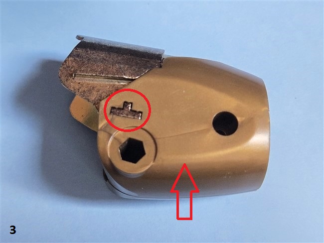

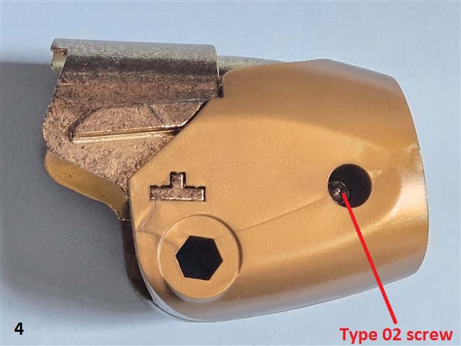

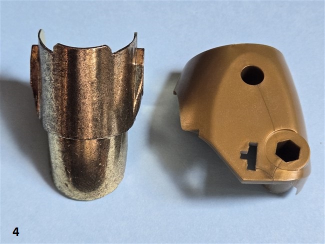

Next place the unused part C30 from issue 75, onto the other side of the assembly. Make sure that the "T" shaped pin fits into the relevant hole as in Pic 3. Then fix the parts together, using a type 02 screw as in Pic 4.

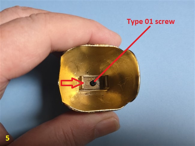

Now position the part D04 inside the finger tip A38 and fix it in place using a type 01 screw, Pic 5.

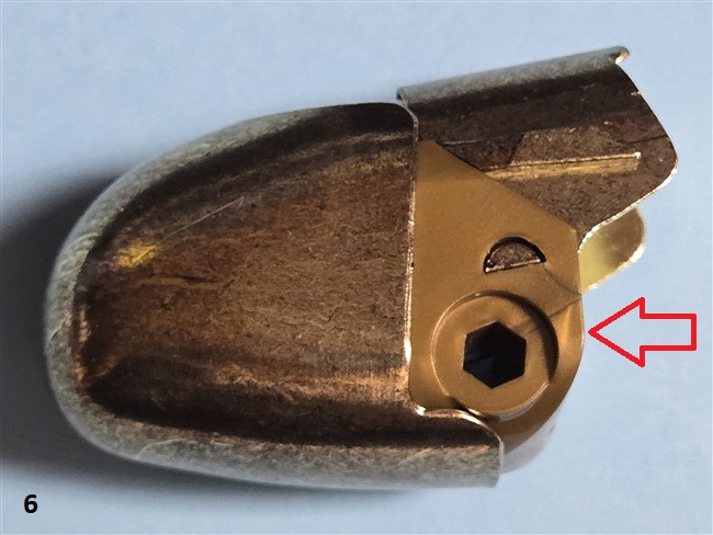

Finally, press the finger assembly into the finger tip until they click together, as shown in Pic 6.
